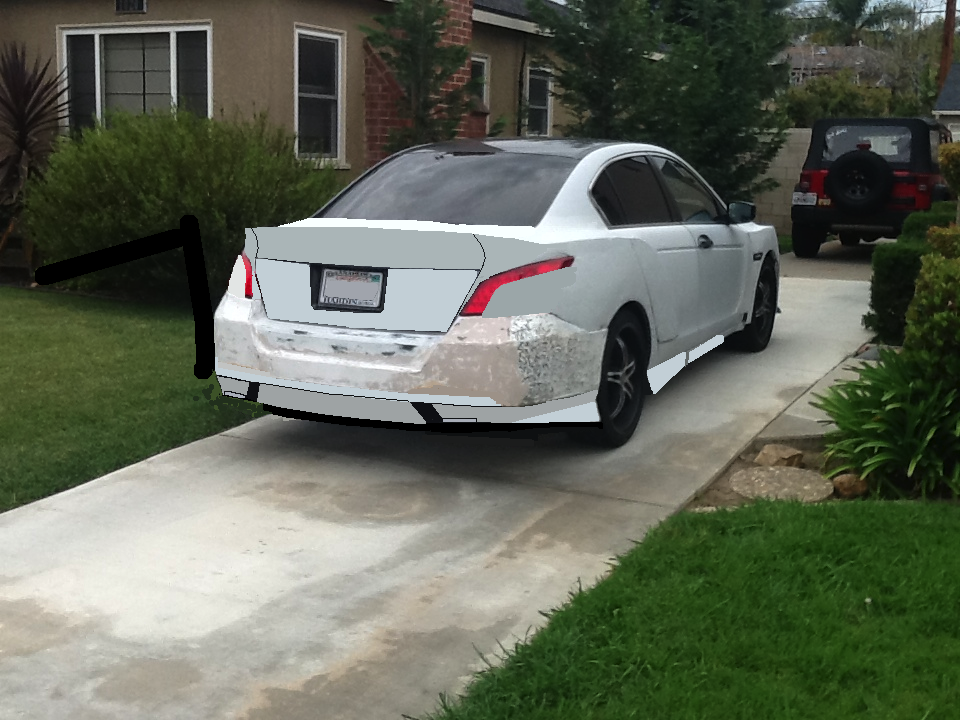

heres a more vip less race car rear end what you think?

Hey What,
I have been following your thread since day one and I like the choices and decisions you have made.
The whole body is coming a long nicely. The only thing that didn't flow IMHO was the side skirt.

Originally Posted by timemachine
Hey What,
Thanks. Nice work on the pic. The skirt you put up looks good it looks easy to make and I'll see if I can make it work. As for now this week and last week I've been finding work. My right headlight came in on Monday so I hope to finish them by this weekend. Haha also my name is joe.

i'm with Timemachine, his photoshop looks like how i'd imagine it...with different wheels of course

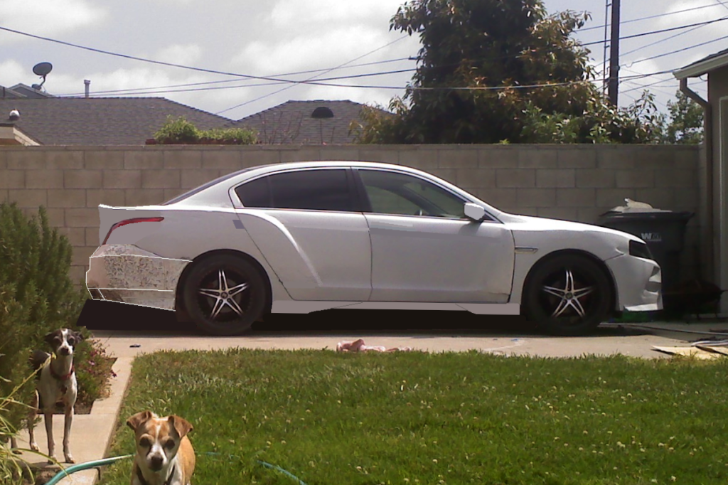

Maybe you mentioned it...but, how do you plan to attach the fiberglass panels permanently to the rear quarter panels? Fiberglass will NOT permanently bond metal...it WILL crack after a year or so. This is why most wide body kit "rear over panels" are riveted on. Just curious...keep up the great work!
Well all of the premade wide body kits i've seen use body filler or something similar to hold the rear quarter. I originally thought the fiber glass would hold and if it did crack the body filler would keep the crack from reaching the paint and you say they are (riveted on) do they cover the seems with body filler?
There is nothing magical about body filler...it will crack eventually. Average length of time I've seen on fiberglassforums.com is between 6 months and 2 years. The only foolproof method to add panels to a car is to weld metal to metal or bond fiberglass to fiberglass.
Re: riveting, if you use body filler over rivets the body filler will still crack. This is why the really nice wide body rear over fenders on s2000 track cars that you see in magazines do not fill over the rivets...they just rivet and leave. Honestly I'm surprised you didn't research how you were going to attach the panels before you started on this massive project.

I see well I'll be searching for a solution if there is any.
How should I have molded the rear quarter?
Old May 13, 2012 | 12:51 PM
  #154
blackndecker's Avatar
Posts: 1,316
I am not an expert and I hope I don't come off sounding like a know it all...
But, I have been working with fiberglass for a couple years now and am starting to get into making Gelcoat molds. For molding the rear quarter panels, you have some options...
The easiest would be to use painter's tape to tape off the area of the rear that you want to build up. Wax over the tape, and then you can lay down 3 layers of 3/4 oz chop strand mat over the tape. You will have to mold the rear panels slowly starting with the horizontal surfaces because gravity will tend to pull the heavy, wet resin soaked mat down the side of the car before it sets. An alternative to painter's tape is clear packing tape...but I think this will be much more frustrating because the wet, resin soaked mat will slide off of this even easier.
Allow the fiberglass to dry and set, this will give you a fiberglass surface that you can attach your wide body kit to. Obviously you will still have to rivet this molded surface down to the car somehow...you could make some flanges that extend along the outer edge (kinda like they do for aftermarket fender flares) to sink the rivets. Honestly, I think rivets look fine and are hardly noticeable on a black or dark car.
The cars you see at SEMA with molded on wide body kits are NOT daily driven...they are trailered and don't have the stresses that a daily driver will see.
Lastly, and I am not condoning this type of behavior...and I take no responsibility for your actions, but if you happened to go and rent a similar model Honda Accord from a rental car place for a few days you could build your chop strand mat mold off that car and not have to destroy the progress you made on your own car. If you take your time and tape the donor car off well, there shouldn't be any damage incurred using this technique.

Thanks a lot blackndecker for your info. But Im already to far into this project. I'm going to continue with molding the glass into the body until I figure out what I'll do with the rear quarter and doors
Old May 13, 2012 | 03:51 PM
  #156
Posts: 1,316
What I suggested above (i.e. getting a donor car and molding the panels) could easily be accomplished without a major set back in your work. You could then carve the panels on your car to have attachment seams.
You will kick yourself after spending what appears to be the better part of a year (and likely enduring much ridicule behind the wheel) only to have all your hardwork and money (materials, paint, etc) ruined when cracks develop. Trust me, body filler will not last long on a daily driver. Plus, you will not be able to sell the car with cracked body filler smeared all over it...so you may as well do it once and do it right. My 2 cents.
