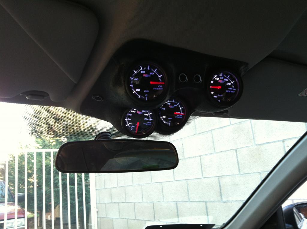

another update this pic is from the drivers seat. from my view you can see that a little bit of the boost and air press are cut off

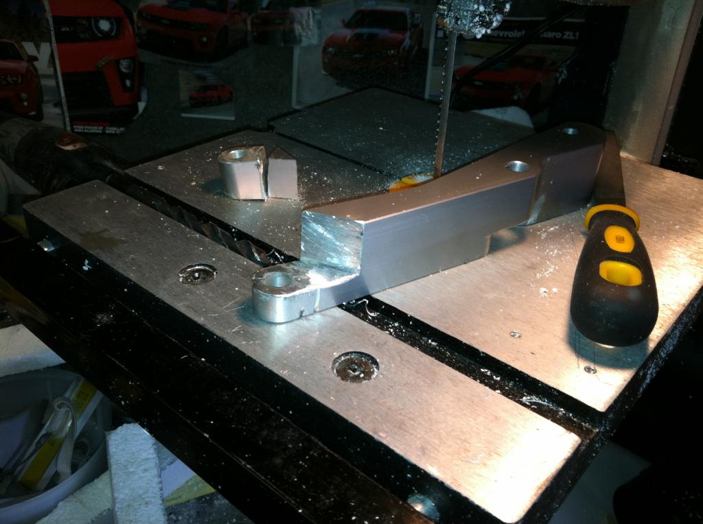

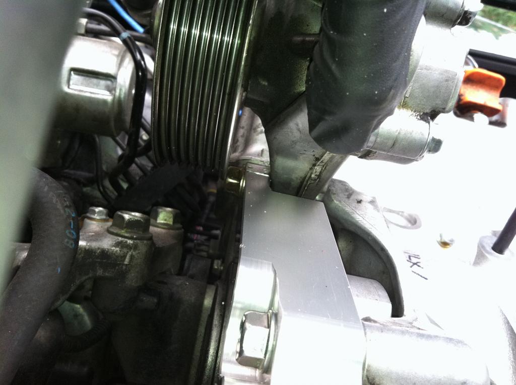

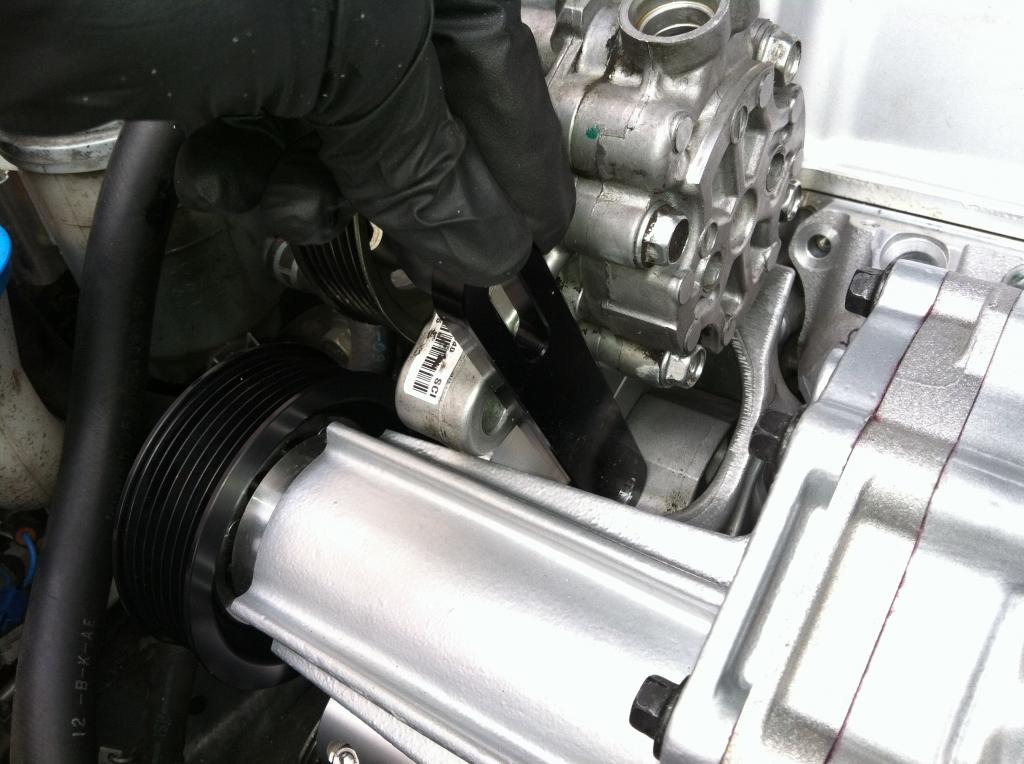

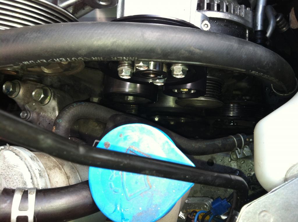

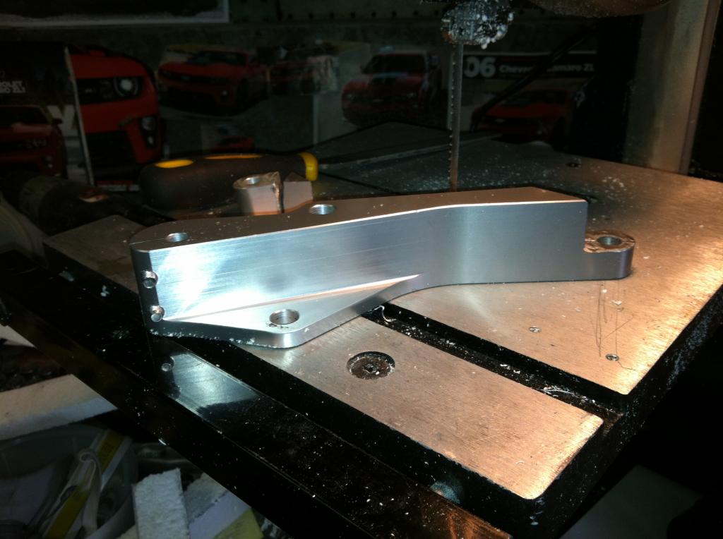

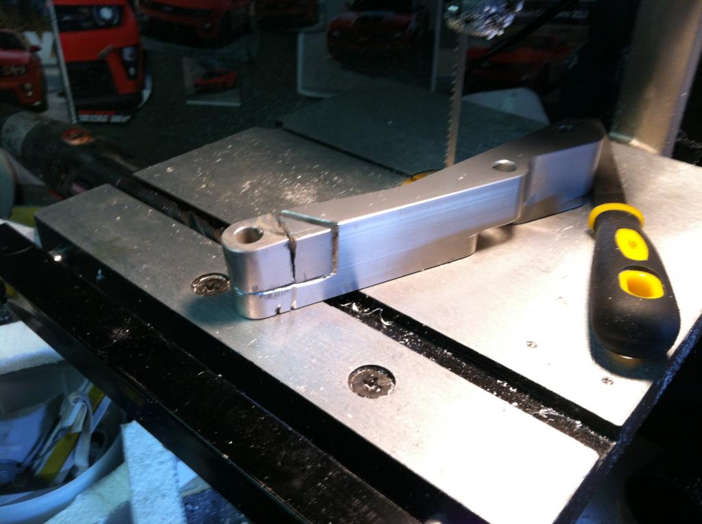

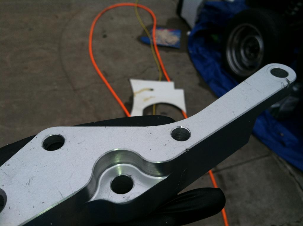

so here is my install
so to start off tsx has an e.p.s.so in order to fit my power steering pump i had to modify the bracket that will take its place
with my new bracket half of the pump is air born
pulleys are straight
the other bracket for the ps pump
im not sure if you can see all them but i now have 8 pulleys lol
