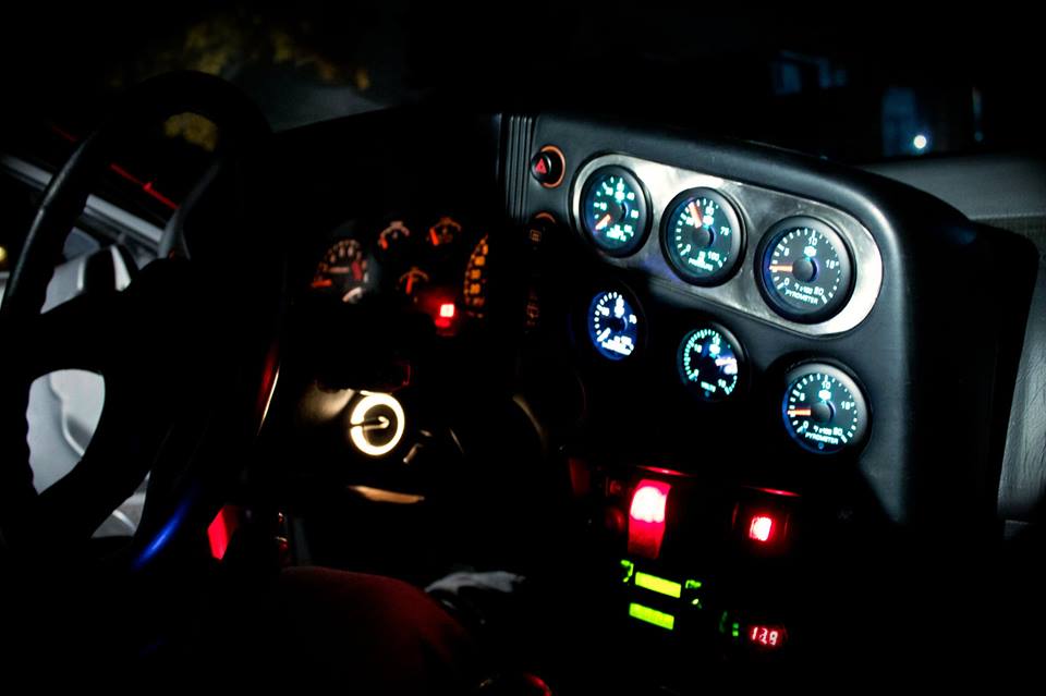

You can put an EGT bung in your stock manifold.. and yes timing is pulled with excessive coolant temps. This is done by the Fit (GD/GE and most, if not all EFI cars) from the factory.
I'm a believer in monitoring EGTs on performance applications, the 1G has probes both pre- and post-turbine. The two gauges on the right:
I know many folks consider them obsolete now that we have Wideband UEGOs available for private use.
Consider what obsolete? Having an EGT and a Wideband?
That EGTs are obsolete now that we have Widebands. A tremendous amount of people have tried to tell me this.
They are best used together as far as I'm concerned.
Just wait till they see the Cylinder Head Temp probe I'm installing later this winter..

I guess I am old school for wanting to watch the EGT. All my older cars, even the normal aspirated have EGT sensor on them. The factory EGT sensor wiring in one of my NA car is stainless steel. Soldering stainless steel is a bitch because you need a stainless steel flux, silver solder and a high soldering iron temperature. Installing a pair of performance header in the car was no fun because the engine bay is tight and both the EGT sensor and the O2 sensors stainless steel wiring have to be extended.
Yeah when I have more time I will install an EGT sensor. There is plenty of room under the Honda Fit engine bay with the Sprintex supercharger. Pulling out the exhaust manifold probably would not be so bad. There will even more room if I get rid of the stock air box and install a DIY air intake.
Agreed. EGT's are key to getting the ignition timing perfectly.

+1 EGT
Great even for very mild builds. Lets you know when you have strung out the most you can while keeping a good margin of error/reliability
