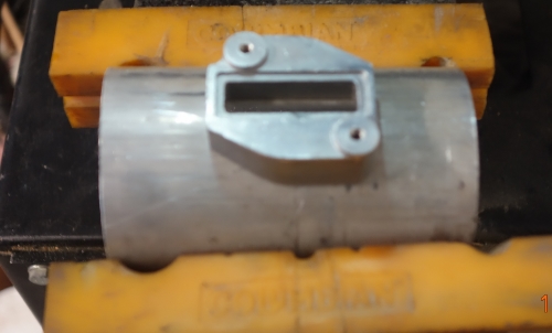

Anyway. The car is slowly coming alive! I'm getting a MAF code (p0103) for too much air!! I need a larger intake to compensate.

I'm not sure what year your Fit is but you can use a maf sensor housing out of a Honda Civic of the same year (Example LX...not a Si). For example, I looked up the maf sensor for a 2009 Fit manual. It is 37980-RNA-A01. I looked up the maf sensor for the 2009 1.8ltr Honda Civic LX and it is the same number. So all this means is that your maf table will need to be recalibrated for the wider opening of the LX housing, using Ktuner. Just get an LX maf sensor housing, cut it out and install your maf sensor in it. Voila!
Hmmm....good idea. I was thinking of a 3" pipe MAF adapter. But this sounds like an alternative.

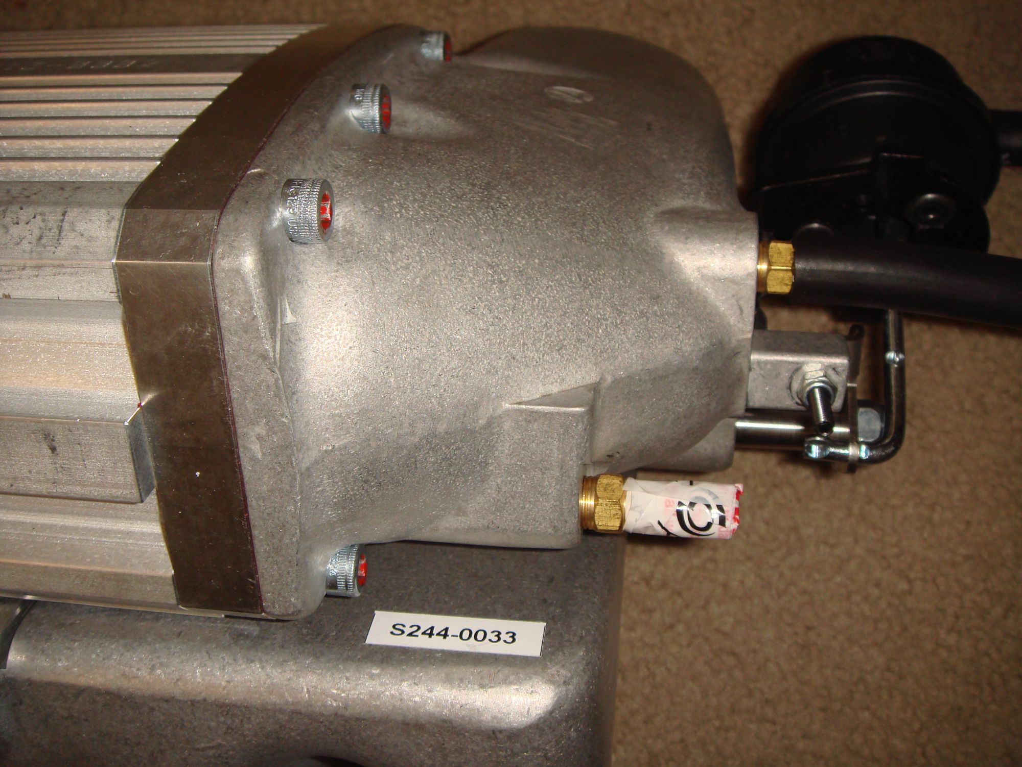

Hi guys,
Aren't on the instruction for sprintex install,
that you suppose to route the hose from the PCV valve back to the Sprintex Unit
(to be exact to the nipple on the right side of the supercharger like on the picture below, the one that is still covered with sprintex seal)?
note: below is the picture of my sprintex unit...
