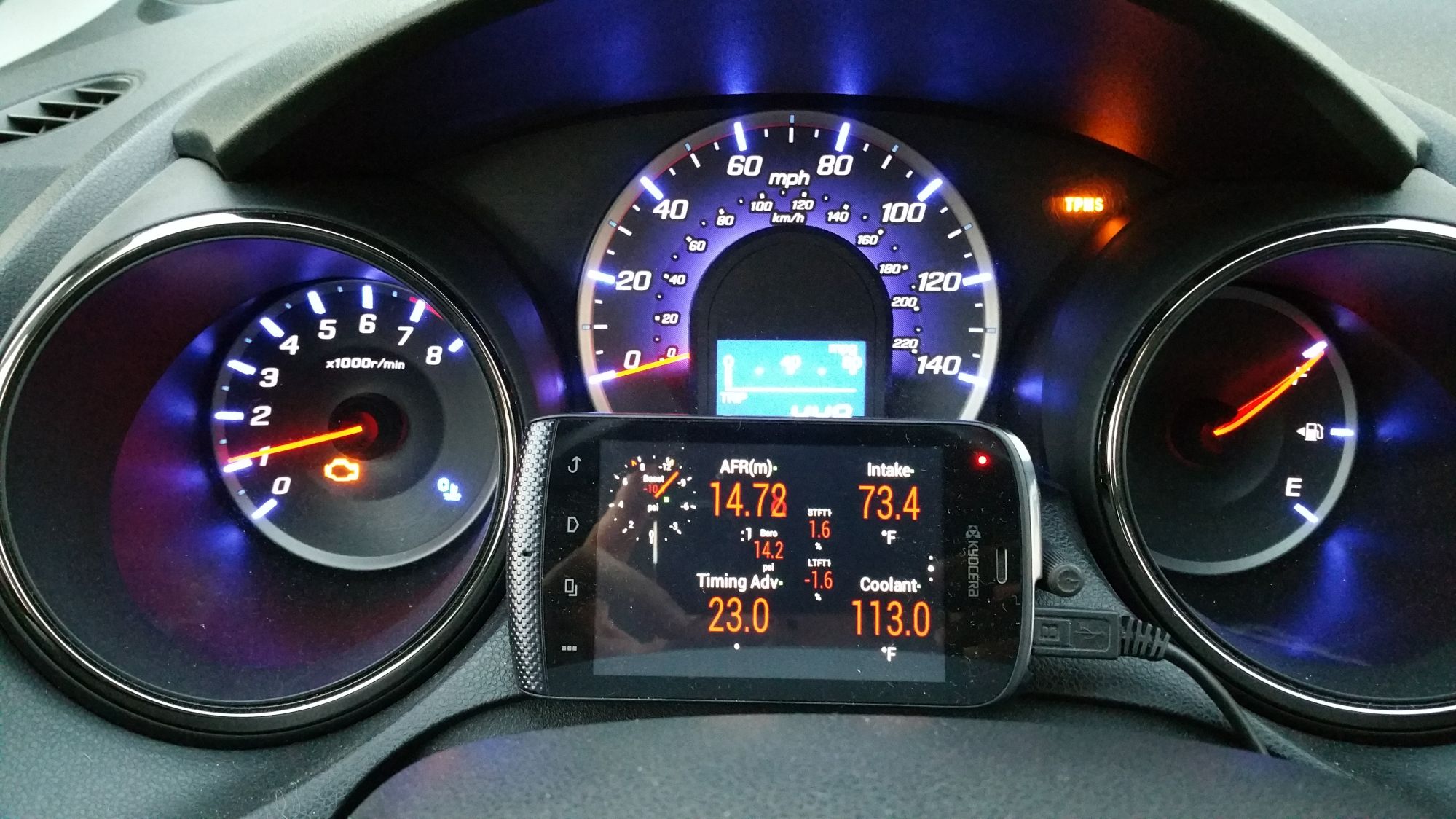

Goobers, I picked up a spare phone ($20 at Target on clearance). If you set it up correctly it will turn on and off with the ignition, and it charges enough while driving to keep it running. I have not missed my UG.
Here is how I mounted it:

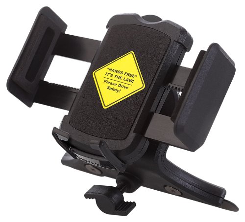

Amazon.com: Mountek nGroove Universal CD Slot Mount for Cell Phones and GPS Devices: MP3 Players & Accessories Amazon.com: Mountek nGroove Universal CD Slot Mount for Cell Phones and GPS Devices: MP3 Players & Accessories
I use this. I don't even have a CD burner in any of my computers, and I just stream stuff via bluetooth anyway. Should work well to mount any kind of phone.

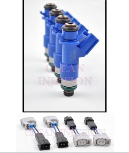

These are the RDX injectors I got (w/ adapters). You can find them on ebay.

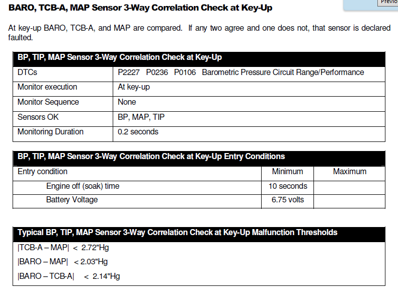

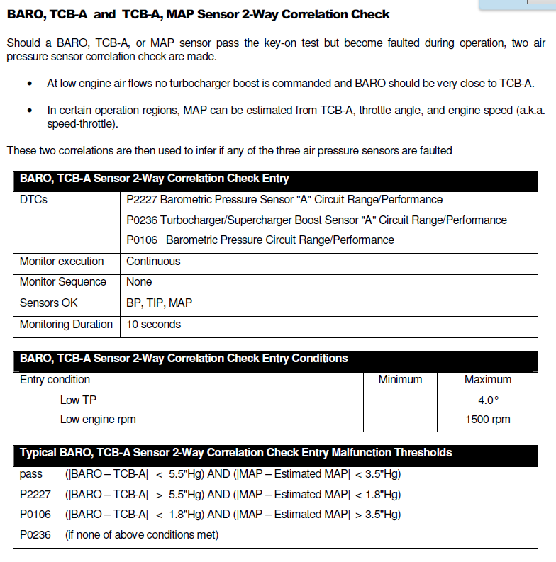

^ Its not a sensor voltage range issue, there are separate codes for those. P2227 seems to be a correlation test between measured pressure sensors and calculated pressure. The conditions of the fault are proving hard to find. I have looked at the SAE J1979 and J2012, EPA, and CARB standards, no helpful details there. The most info I found was in some Ford document:
Something like this, but Honda specific might be useful.
Also Sprintex is having a 10% off black Friday sale
Attached Thumbnails Sprintex Supercharger Install-80-capture1_8b70b89aa1bcd2b8017251f3b3f69f3a2e389c29.png   Sprintex Supercharger Install-80-capture2_ec90631f2a0e04fae197ee118ca89108c2c8cc2b.png
Old Nov 25, 2015 | 04:27 PM
  #939
Goobers's Avatar
Posts: 4,295
From: Wandering around.
You did read the end part of my post, right? Where I said I have the service manual for the Fit and it specifies that you check for P0107, P0108, P1128 and/or P1129 codes?
Those ARE definite MAP sensor codes.
The point of it, is that these codes, when cleared, can ALSO clear a P2227 code in some cases, according to the service manual.
Here's a post from some 5 years ago, where the car tripped the same P2227 code, with no mention of even the four codes I mentioned... and it was because of a damaged MAP sensor. https://www.fitfreak.net/forums/fit-...tml#post863645
I get that the ECU is tuned with the MAP sensor in the post-blower location and you guys are afraid of blowing the engine or what have you if you put the sensor in the pre-blower (factory) location to test. In addition, it cost time/money to have to even temporarily tuned to a safe map in an effort to test a pre-blower MAP location.
But you guys do realize that of the few people I've seen with P2227 codes, 1 had a damaged MAP sensor, and two (you guys) MOVED the MAP sensor.
That said... I won't be continuing this topic. You guys test or don't test, up to you.
