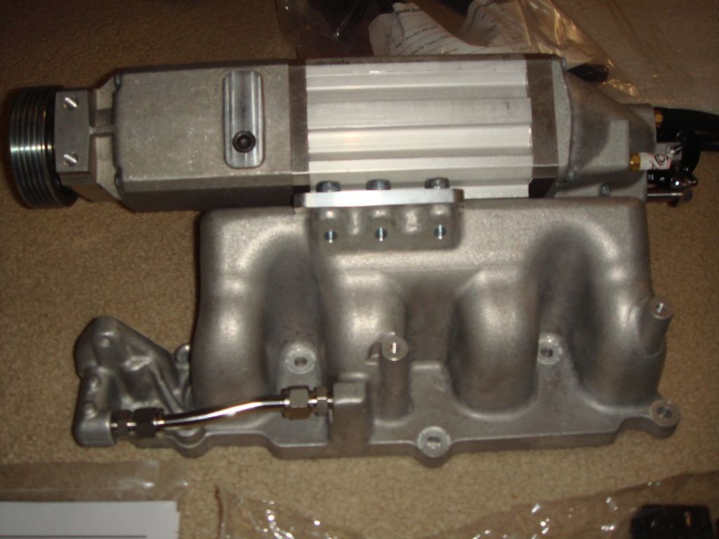

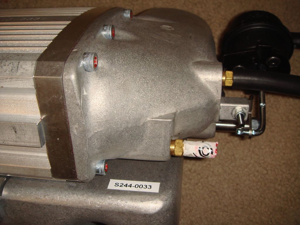

I do have few questions,
First I want to make sure mine is for the USDM Version with EGR,
can you guys please check based on the pictures below that
mine is really the right USDM version with EGR:
The reason I worry because on the packing list on the packaging
it say NON EGR Version
Ok it say Honda Jazz (Concept-2) NON-EGR Supercharger kit
Top Level 244A1011,
here it is:
I hope this is just because Sprintex print the wrong packing list.
because based from the pictures on the installation manual.
it looks like mine is the correct USDM with EGR version.
Second,

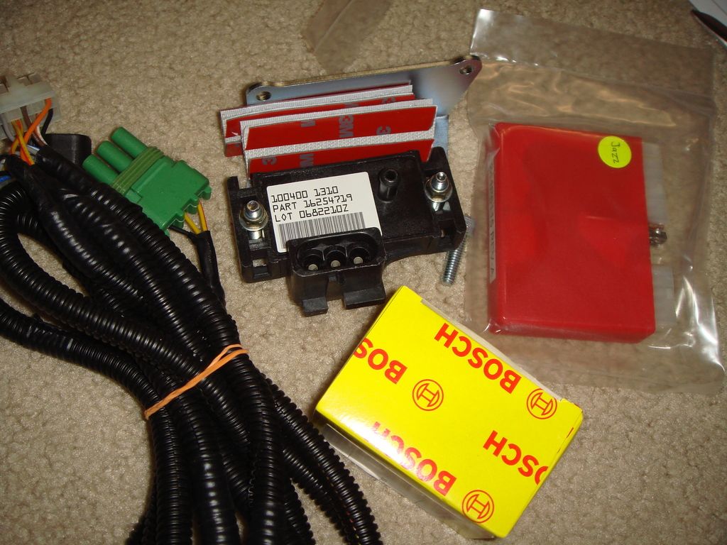

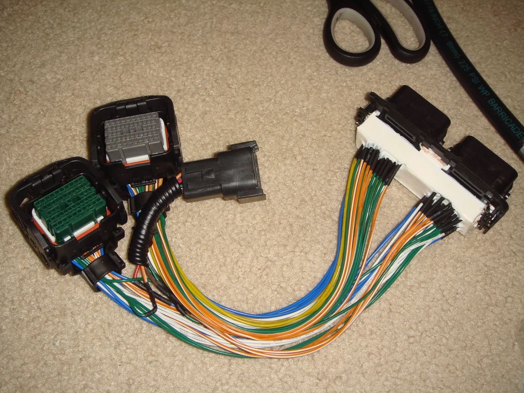

I think mine is the NEW CONCEPT-2
because on the packing list it say
Honda Jazz PLUG & PLAY Wiring Harness,
and it also have the TMAP Sensor !!!
Please take a look at this pictures below,
and tell me if you guys have this kind of wiring
in your kit or not...
but, hmmm
I think mine is really plug and play
since there is no open cable/wire to connect/splice
to factory ECU...
Is this Plug and Play Cable?
How about this cable,
it have connection to the SMT8 and to the Plug and Play
Cable too, and it came with the Tmap sensor !!!
Now if this is all truly the new Plug and Play wiring system,
hopefully it is fully compatible with USDM Honda Fit,
since it is suppose to be Honda Jazz NON-EGR as printed
on the packing list...
What do you guys think?

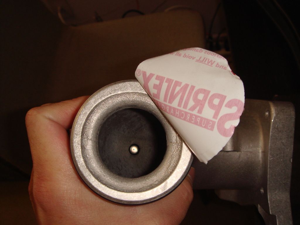

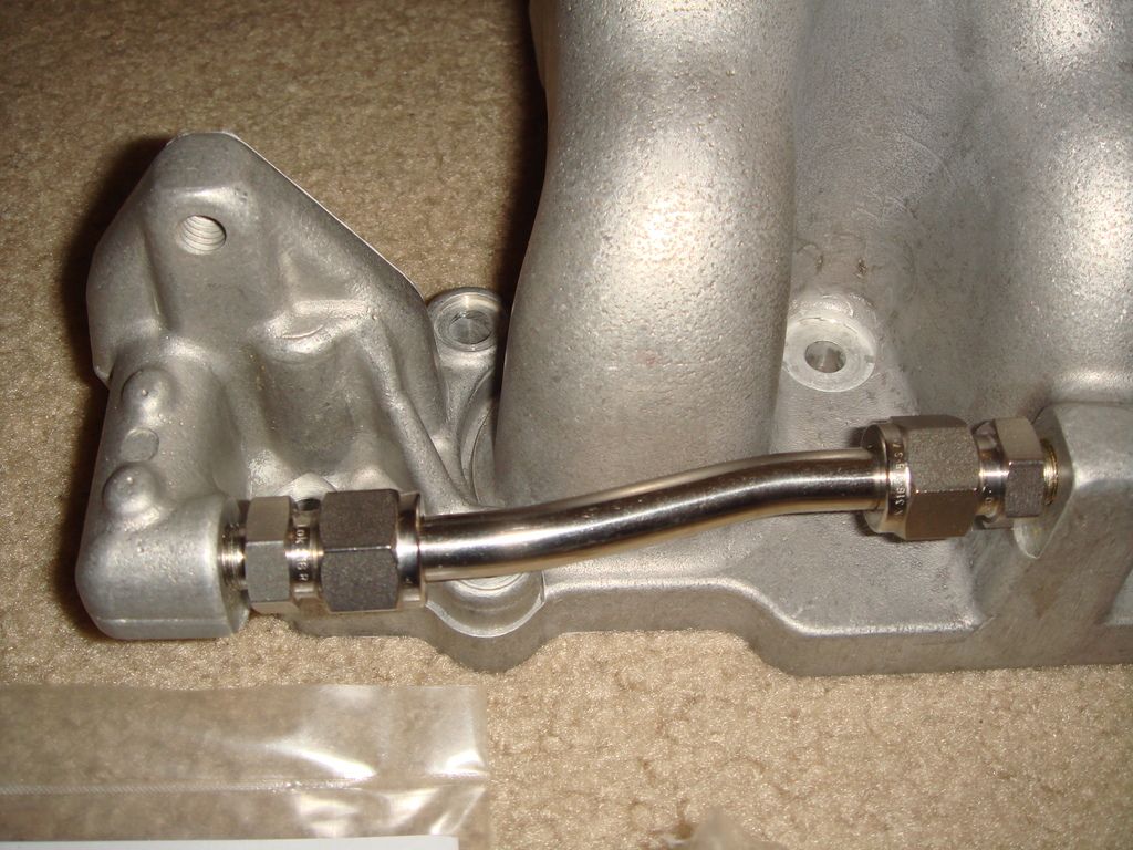

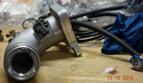

On the other hand, look like Sprintex make modification to the INLET RESTRICTOR,
I remember the old version had 3 weld that can be grind so it became NON Restricted,
this version, the restrictor is CAST into the whole intake,...
so It is NOT possible to open the restrictor as easily unless a machine shop do it for me
here are the pictures:
vs. the older version:
Attached Thumbnails Sprintex Supercharger Install-80-dsc09652_0823cf73f6da4c36629b95d882fdc15ffa70ca2b.jpg   Sprintex Supercharger Install-80-44f493cb_2ed0_4475_ae85_3d86fa476c4b_zps0b019925_82d8d7c702c7dcbf738b5bef5915f5a8c3e2e49a.jpg

^ Looks like all the EGR mounting is there, you should be OK. There are no plugs in the holes to the EGR itself , are there?
That plug and play harness will sure make things easier!
So you gonna give the SMT8L a shot?
That inlet restriction kinda sucks. Just more grinding though!

Hi Guys,
From what I understand, both of you run the MAP Sensor to read the boost by connecting it to the Sprintex Intake Manifold (after blower) vacuum lines, I don't think My Concept-2 version have that though...
How about this vacuum outlet on this picture below,
I am talking about that brass nipple that are still covered with SEAL?
can it be used for the MAP sensor?
Is it after blower?
If it is NOT after blower, then anybody here know
where I can get a MAP Sensor and Boost Gauge connected?
Sorry for all this silly/basic questions,
I had not done a lot of research myself since I just received this kit
yesterday...
EDIT: I finally read the install manual, and mine had the T-MAP sensor bolted
directly to the intake port on the sprintex... so I think this solve the problem
for MAP sensor reading, but how about boost gauge... my guess is
connect to engine block vacuum line or something like that...
this going to be an adventure for me, never have a car modified with aftermarket
turbo or supercharger kit before
Thanks
Attached Thumbnails Sprintex Supercharger Install-80-dsc09653_9e4372326758fab6a9416a809eccc16842cd83a5.jpg

Also in reference to your MAP sensor questions: Some of the CRZ guys have the TMAP sensor manifold and have discovered they can fit the factory MAP sensor in the TMAP opening with the addition of an o-ring.

BMW Alpina, You can use a digital boost gauge that will calculate boost off of the MAP sensor readings, read back a few pages and we discussed using our phones to accomplish this. Not sure what the T-Map hole looks like but I bet you could rig something up and buy a T connector and run two vaccum lines off of it.

and Portron that idea about getting the boost reading via vacuum hose
from the T-MAp hole is a good idea, I just haveto find the fitting/machine one. Thanks
