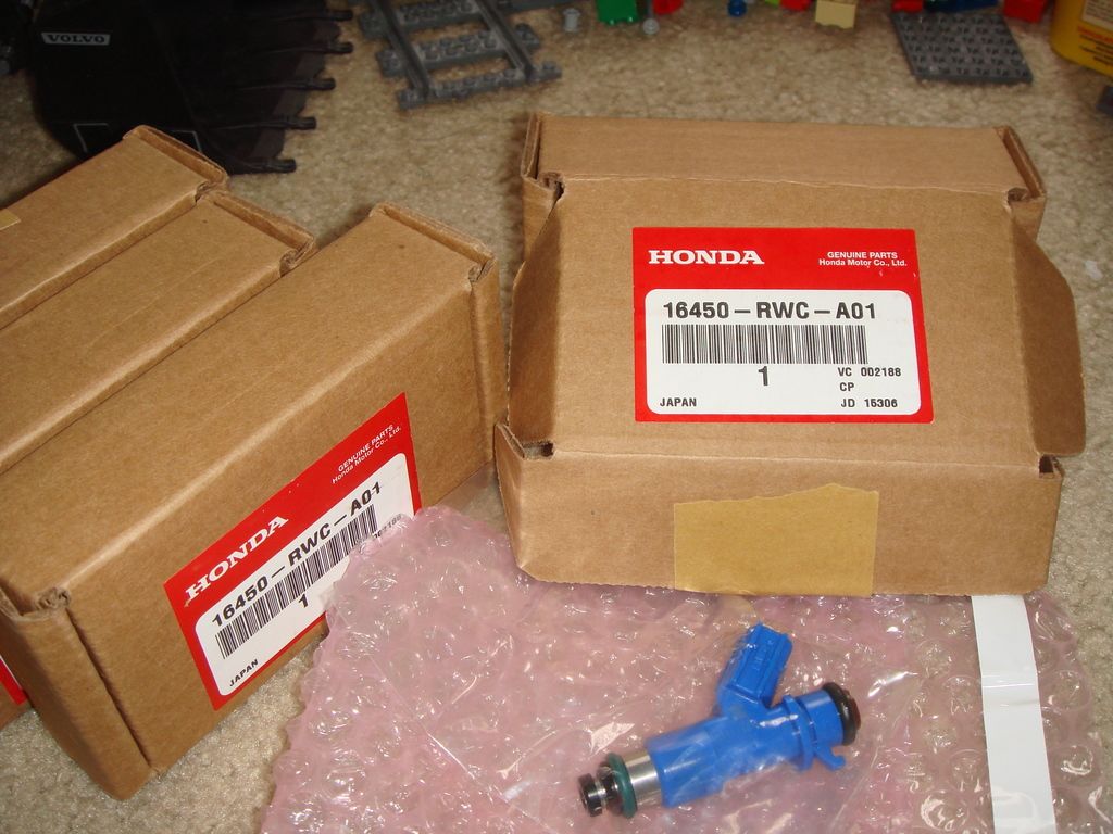

My Acura RDX Injector arrived yesterday:
Still have to go to exhaust shop to do custom exhaust,
buy all new gasket from Bernardi Honda (just want to make sure eventhough
Sprintex install manual say to reuse old intake manifold gasket)...
bore out the Sprintex restrictor...
either Polish or Paint/powder coat the sprintex supercharger housing in Dark Grey
or Black color... (still undecided)...
find solutions for the MAP sensor (after boost) since my Sprntex is the concept 2,
then install DEFI boost meter, DEFI water temp gauge and use the Garage Amis
custom pod above the spedometer which I already have...
then if after I done all the above which should be around end of March...
and K-Tuner still do not have all the beta features (expanded map and injector resizing), the I will be force to buy the boomslang wiring and AEM F/IC-6...
Hopefully K-Tuner is ready so I can just buy K-Tuner... by around March (or hopefully earlier)....
can you take measurements of that injector ? reason I ask that is idental to the R35 GT-R injectors......

Originally Posted by racer986jec
whats the cc's on the injectors ?
Hello,
These Acura RDX injectors are rated for 410cc (at 38 psi) and 550cc (at 70psi)

Originally Posted by Boostedtaco
It was Goobers, thanks for the tip.
Hmm, he just ran a larger fuel pump. I wonder if just running the RDX injectors would be okay. Unless the injectors are too big for starting and/or driving.
The RDX Injector is 410cc, while the stock injector is 185cc.
I think it would be a problem...
I thought so too, i'm still waiting to see if Ktuner is instock. There's some for the 11-13 fits?
If its out of stock, i'll run the accord 310cc injectors and see if that'll work.
when you say in stock, do you mean the injector?
if yes, then just buy the injector from Bernardi Honda.
I bought it from them and cheaper then from anybody else on the internet,
plus you know for sure it is original genuine honda parts if you buy from Bernardi Honda.
I also buy the wire adaptor needed to adapt the RDX to Fit injector clip from Jackson Racing,
so you won't have to modify anything on the clip.

Custom OEM Fuel Injectors from FiveOMotorsport (No relation just got good service in the past...)
Since there is no such thing as a real Honda injector,,, They buy them from Bosch / Siemons / Delphi just like every body else....
Nothing like matched injectors to clean up a tune..
I just check the website you provide above,
and they sell a RE-MANUFACTURED OEM Honda Injector.
I understand what you mean about no real Honda injector,
but at least if you buy from Bernardi Honda (or any other Honda authorized dealer) you know that what you buy is a REAL (meaning Genuine) and not some FAKE / Imitation product (of course unless that Honda dealer is crazy and do illegal stuff like selling fake honda parts which of course is illegal and most likely a big dealer would not risk doing)
At our Honda Fit Sprintex application, with low boost level...
I don't think a matched injector will do much difference,
I will rather have a brand new OEM Genuine Honda Parts (which of course made by Denso or Other OEM Supplier) than a USED injector that being re-manufactured by non factory.
(as you can see the website above have some policy for core deposit, which clearly mean, they got a used core injector from customer than re-manufactured them)...
for me, I rather have a brand NEW OEM Genuine Honda Injector unit that had never been used for few years inside other people engine...
even it might not be perfectly matched,
but I am sure it is within factory spec tolerance because if it work for new Acura RDX with higher horsepower application, I think it should work well with our Honda Fit.

Thats if you want a Honda injector, at the end of the day, if its just about performance, they do sell new injectors that are compatible with the Honda fitment, if you need the high flow ones. You have to talk to them on the phone if your stepping very far over the line..
For what its worth I've had numerous injectors brand new from dealers tested and they are seldom even close to matching flow. and under high boost thats not good. (In my experience ,,, everybody has a different history with different fails. )
For a high performance engine I always re-test them. Had too many fails from bad brand new parts over the years..
BMW AlPINA/Dwtaylorpdx,
So would it be worthwhile to get new Honda injectors and send them off to RC Engineering to be 'flow matched'? That way you have the best of both worlds (New injectors AND flow matched). Win/Win?
