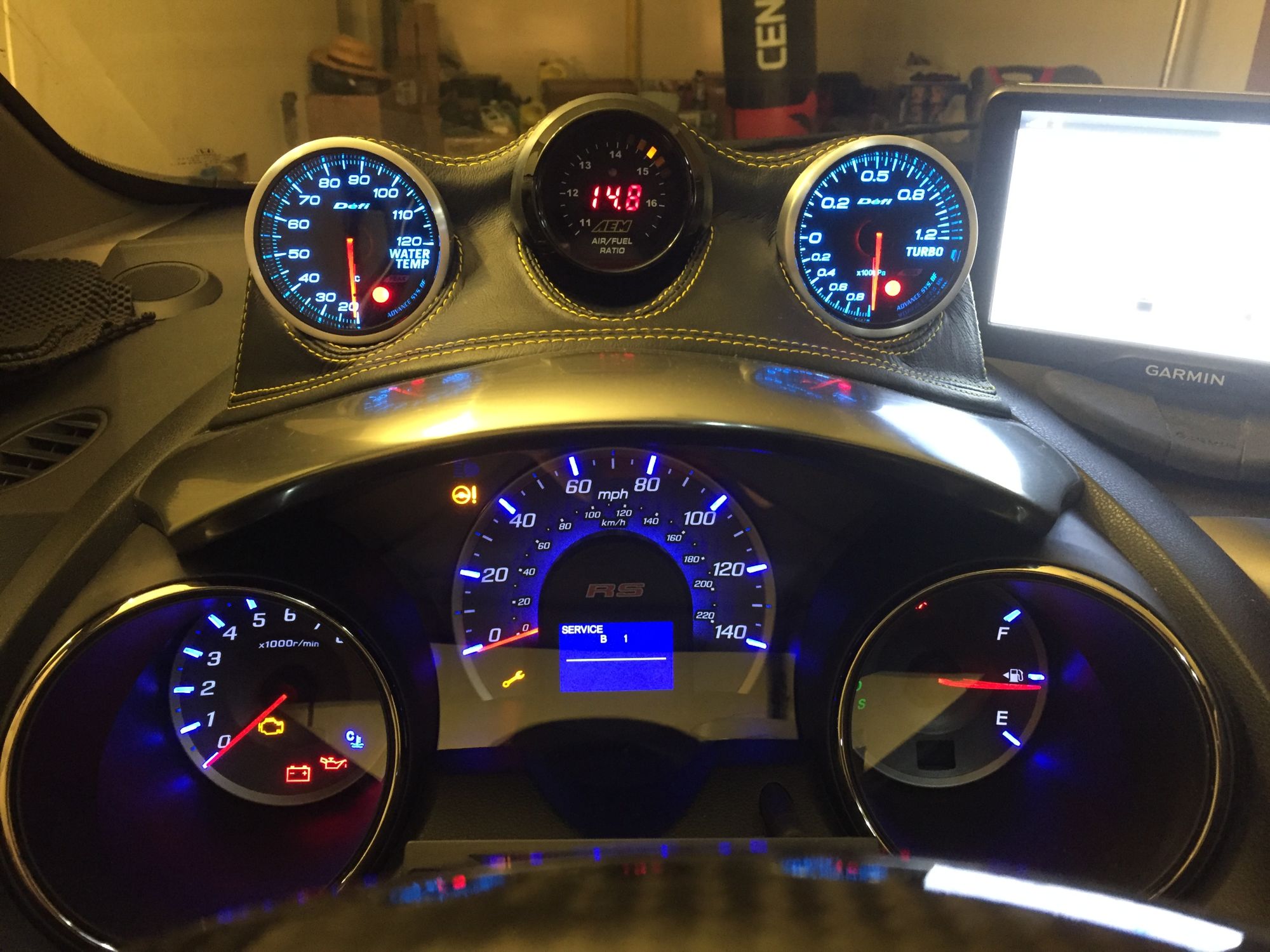

Hi Guys,
I think both of you need to have AEM UEGO Air to Fuel Ratio Meter,
so you can see the real A/F ratio...
I have the AEM UEGO meter front and center on top of my speedometer
so I can see the number all the time.
I always worry with my engine blew up due to too lean,
so I make sure it is not...
I also have the Temperature Gauge right beside the AEM UEGO,
and I watch it like a hawk too... because engine that get too hot
can also mean too lean condition...
Those 2 gauge are small investment compare to problem with engine blew up...
Attached Thumbnails Sprintex Supercharger Install-80-img_0925_d5e7f8affe14d377356ee8b27c0da1fd9882188e.jpg

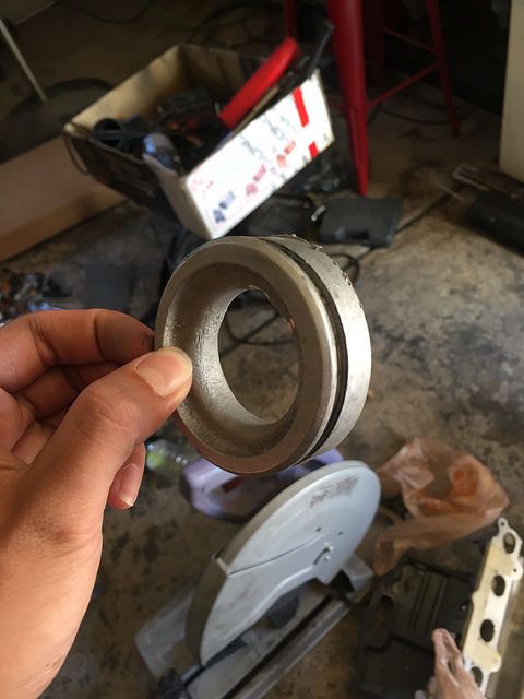

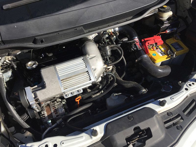

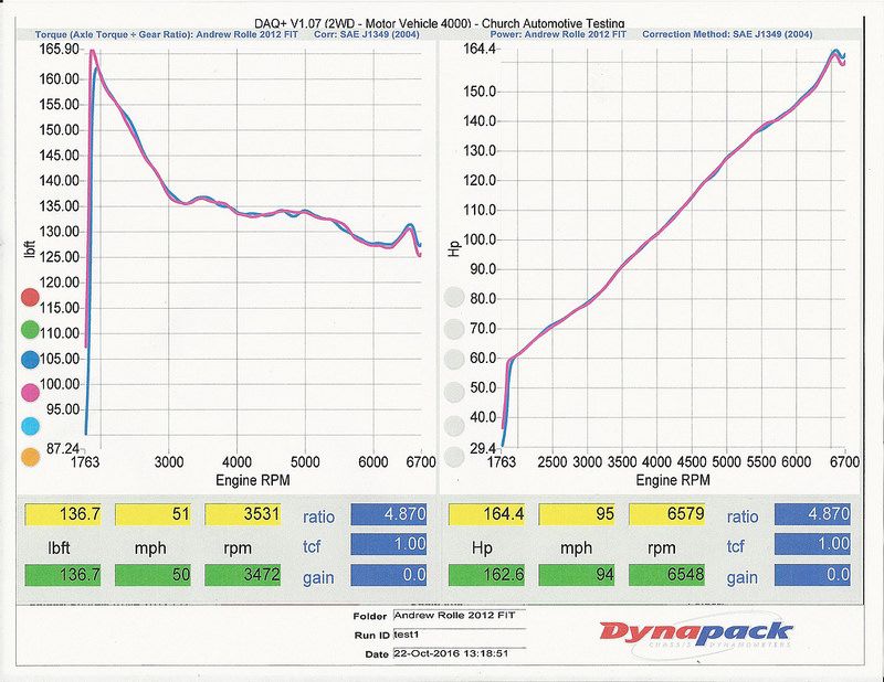

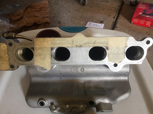

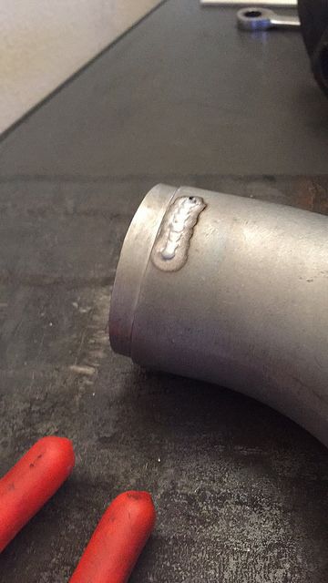

I'm now a member of the Sprintex family as of Saturday 10/22!
Installation details:
-Acura RDX 410cc Injectors
-Evo X Fuel Pump
-KTuner ECU Reflash
---Tune done by Church Automotive
-Denso IK22 spark plugs
-Port and polished lower intake manifold
-Restrictor removed from intake elbow
---Coupler used in place of the O-ring
-MAP port & 5th injector port on the intake elbow welded shut
-Injen cold air intake
-Weapon-R header
-2.25" B-Pipe w/ vibrant ultra quiet resonator and street power muffler

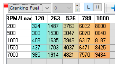

So far, so good. I had a couple issues with the RDX injectors sealing against the fuel rail but switching out the O-rings solved that issue. The Injen intake is rubbing against my battery (I upgraded to a 51r) so I'll be trimming some of the intake to bring it closer to the throttle body. I forgot to take finished pictures of all the ports sealed up along with the final pictures after the porting was done on the lower intake manifold.
Pictures / Videos
Dyno graph
0-60 time
<a data-flickr-embed="true" href="https://www.flickr.com/photos/41754576@N03/30552369205/in/dateposted-public/" title="IMG_0277"><img src="https://c6.staticflickr.com/6/5619/30552369205_7117be6784_z.jpg" width="640" height="360" alt="IMG_0277"></a>
One current issue I have noticed is a slight bog at idle when revving at 100% throttle blipping. After speaking to a couple other users and a few of my more mechanically inclined friends, seems like it's nothing to worry about since the supercharger is adding more mass onto the pulley system. It seems to bog down occasionally when the car shifts back into first gear at a rolling stop and I take off again. Not too worried about this either since it tended to do the same thing pre-supercharger.
<a data-flickr-embed="true" href="https://www.flickr.com/photos/41754576@N03/29921738194/in/dateposted-public/" title="IMG_0273"><img src="https://c3.staticflickr.com/6/5606/29921738194_c0a1c2c77a_z.jpg" width="640" height="360" alt="IMG_0273"></a>
The only other issue I have is cold starts. From what I can tell through KTuner, it seems to be a bit lean on cold starts so it has a bit of trouble initially turning over but will idle just fine. On one occasion the car threw pending codes for P0300, P0301, P0302, P0302, P0303, P0304. I haven't been able to get the car to replicate the codes besides that one occasion so far. Once the car is warm, my UG stops throwing the pending code alarms. It is definitely not misfiring, I can say that for sure. Car pulls VERY strong through all gears / RPMs.
The only other pending code I have gotten is a P0400 on two occasions. The EGR seems to be sealed to the manifold just time, so I'm not sure what's going on there. It's a generic code so I'm not too worried about it, my guess is that the added boost pressure in the manifold is throwing off the EGR flow. I could be wrong but it seems like I'm the only one that has thrown this code.
I have about 250 miles on it so far, I'll be replacing the spark plugs and oil once I get to 500 miles. It feels absolutely fantastic, it's just enough power for what the car needs. I'm very impressed by the kit so far, fingers crossed for many more happy miles to come. I also want to thank everyone I PM'd during this process! If anyone has any input for the two issues I posted above it would be much appreciated. Again, they're only pending codes and the car has yet to throw a full trouble code.
Attached Thumbnails Sprintex Supercharger Install-80-30253802300_7b1ff0e3db_z_b4e9e766c885d987833604651ce075469bb64647.jpg   Sprintex Supercharger Install-80-30253803740_fd907e9eb9_z_3bc6319d85b48c779a9658245eea49219bbd9e6e.jpg   Sprintex Supercharger Install-80-30253802830_5960d2bb27_z_633917d0b2df0c48a3bab0d17db4c6d63b469823.jpg   Sprintex Supercharger Install-80-30464825771_7f3a39d43c_c_61b18d3f204b45397e94b64cc4dba24e82605e56.jpg   Sprintex Supercharger Install-80-30435732682_b2e1d8a881_c_45e4c99b73c6efac1c4d238e1b081619f4a44617.jpg

Dyno graph

By the way, somehow your car make 16.2 more horsepower
and 9.6lbft more than mine ...
we both have AT Car, and mine is actually a 2013 with less mileage too...
this is kinda... sad hahaha
the difference was, when I tune mine, I was using IK-24 (now IK-22),
and I use T1R header plus OEM stock secondary cat,
while you are using Weapon R...
I have CR-Z Mugen Intake and you have Injen...
and of course you use K-Tuner and I use AEM FIC...
Oh, I actually have the maxbore throttle body...
hmmmm... I bet the main difference is the Weapon R and the K-Tuner...
plus my AEM F/IC-6 was tune way too rich...
Did you experience any heat soak when Church tune your car?
I tune back in July, it was summer hot...
so they had to spray water from their garden hose on top of my supercharger while Daniel tune my car...
did Daniel tune your car or Shawn himself?
The main advantage so far by tuning with AEM F/IC-6 is I never have any engine error code though...

On your issue of car too lean during cold start,
if I am not mistaken, the K-Tuner can adjust the starting fuel trim...
My car also take a bit longer/more starter motor cranking each time I want to start the car, but since AEM F/IC-6 is not capable of adjusting the starting fuel trim,
nothing much I can do with mine...
I think the gain in power is due to the secondary cat and my tune with ktuner. Aside from that, our builds are near identical considering your throttle body probably makes up for my lack of an airbox.
I totally understand what you meant by the customer service at Church - they didn't seem very happy but got the job done nonetheless. Daniel did my car also, I brought up your car when he was running into issues getting the car to idle. It was only 80 degrees during my tune so i didn't have any heat issues. It's been cold / rainy lately so I haven't encountered any hot weather yet.
As far as the error codes go, it still hasn't thrown a full code yet - only pending codes. I just took the car out again and the pending code for the P0400 came back. Still not sure what's up with that, gonna look more into the issue on other platforms. I highly doubt my EGR valve decided to randomly go bad and from what I can tell, theres no leak.

That's one thing that confuses me, as far as I know KTuner is able to adjust the starting fuel trim. I can't adjust it myself though since I don't have the refreshed map from Church. I'm going to try and contact them to get a copy of the new map and see if I can play around with the starting trims a bit for a steadier start.
From tonight, the first couple revolutions after it turns over are a little rough but the car idled just fine from there. This was with a cold start as well, UG read about 70 degrees for engine temp.
My only other comment on the car so far is how much noticeably louder the exhaust has gotten. I expected the extra supercharger whine but I didn't expect the exhaust note to change my much. I'm going to start looking into solutions to get it quieter, a little too much attention for my taste.

Good Morning,
after hearing you don't experience heat soak, and the cold ambient temp while you tune,
now I understand why mine was making much less horsepower than yours.
Once we get back to summer again (hot weather) you will feel the car is way much slower.... right now, I know for sure my car is much faster then back in July.
Yes, I agree, the absent of second cat at your car should help your car make more power, but I think it is the hot weather that really make my car make much less power than yours because Daniel had to dump so much more fuel and retard timing at that time fighting for detonation cause by heat soak...
hmmmm.... ok... I think I really need to put Aquamist Water Injection system when budget available... plus buy larger pipe MagnaFlow Direct Fit second cat... to help the flow through the second cat...
that or buy the CR-Z HKS one that came with the downpipe too...
Now regarding the map at K-Tuner,
again if I am not mistaken, some people was able to copy their base OEM Honda Map right before they flash their ecu with K-Tuner...
which mean, you can also copy your current Church Tuned Map to your laptop and make another copy of it to play around with the starting fuel trim yourself... too bad I haven't bought K-Tuner yet, so I don't know for sure, but I do plan to buy K-Tuner just to adjust the starting fuel trim...
Talking about error code that several of you guys with K-Tuner/Sprintex combo experience, I am now a bit worried about using K-Tuner though,
plus I remember few months ago they suppose to issue the revision where you can do speed density fueling, expanded map for boost (and several beta features),... and from their website, I see they had not done it...
so even if I buy I will wait until they make all their beta features available... even then I still might use my AEM F/IC-6 just because I can have dual map function with AEM F/IC-6 so I can have one map for hot weather/summer and one map for colder fall/winter/spring weather...
and just use the K-Tuner to adjust the starting fuel trim...
oh, I also experience the hesitation from standing start and I though the K-Tuner can eliminate this, actually K-Tuner should be able to eliminate this and also the dip at high 6k rpm just before redline...
but from your dyno chart it's look like it did not...
another thing that I wish Church had done is they do road tune after dyno tune just so they can experience that the car do bog down a bit from standing start, or the dip at that high 6k rpm... so they can fix it with K-tuner.

Welcome to the club Fitedonem. Looks like you are you are on the right track and doing this the right way. Hopefully you can get your map from Church. Here is my current cranking map and ECT correction maps for referance:
Attached Thumbnails Sprintex Supercharger Install-80-cranking_fuel_5594b9600aa498b0c2ce77812233e4b78d7cc8c3.png   Sprintex Supercharger Install-80-cranking_corr_7f73b7a0ce1b9ecc31765866e48164c76e2b7803.png
Thanks for the reference, I'll pass that along to Church.
