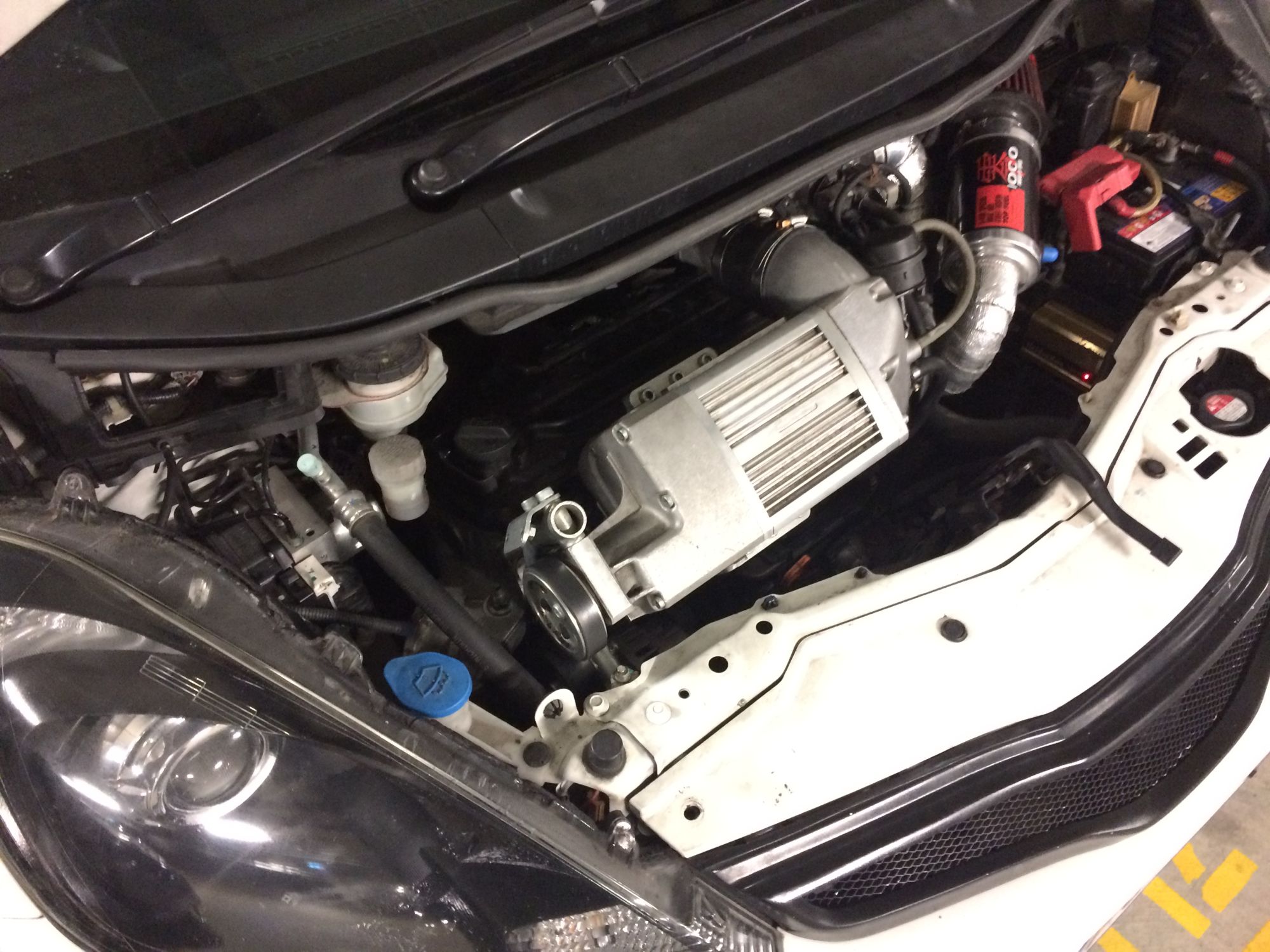

Hi all,
Joining the SC Club as well from Aus.
Running with RDX injectors, 265 denso pump and KTuner.
I am yet to get a tune as my mechanic and I are working on a tune to get it running.

Originally Posted by etfnehme
Hi all,
Hello,
Welcome to the club,
I also use the Denso 265 pump.
Do you add a Return Fuel Line?
Also
When you start your car, does it take slightly longer to start it now compare to before Sprintex?
Thanks
Old Aug 19, 2016 | 09:16 PM
  #1140
etfnehme's Avatar
Joined: Jun 2012
Posts: 9
From: Australia
Hello,
Also
Thanks
We didn't add a return fuel line.
Once we adjusted the cranking fuel, it feels like it starts faster than no SC.
