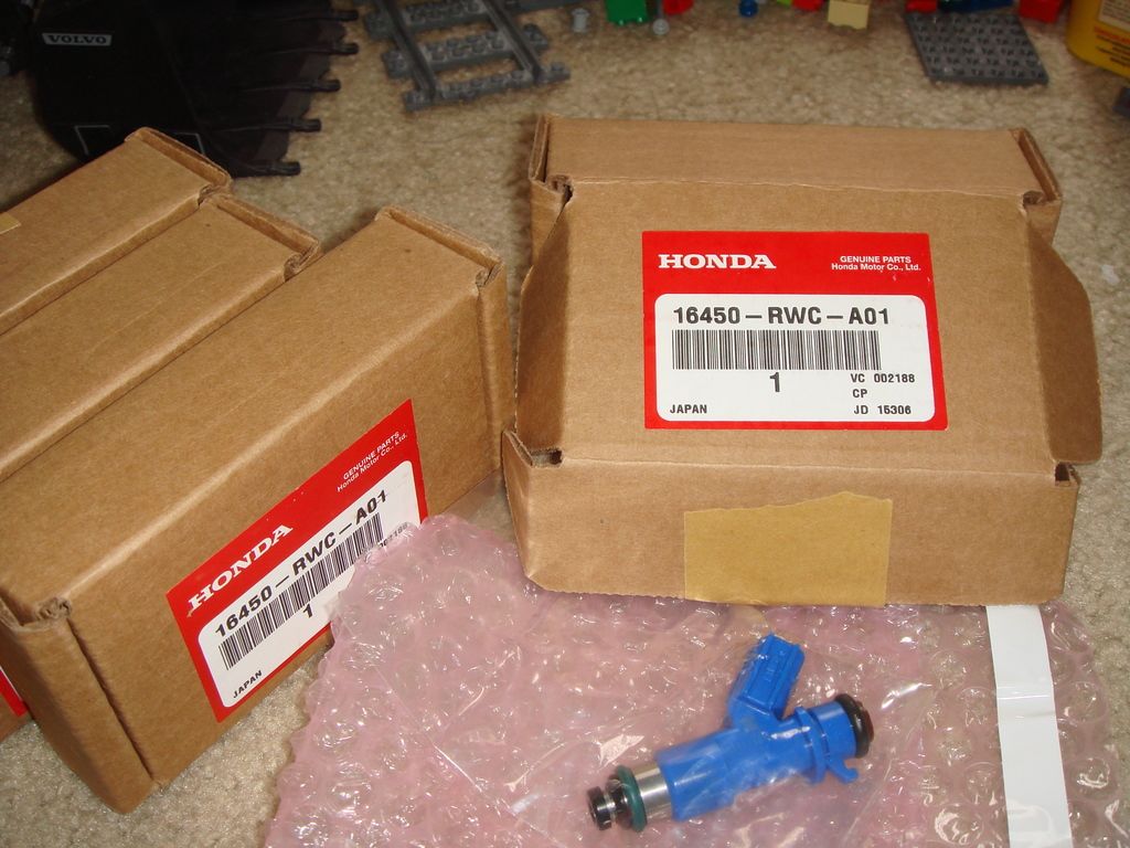

My Acura RDX Injector arrived yesterday:
Still have to go to exhaust shop to do custom exhaust,
buy all new gasket from Bernardi Honda (just want to make sure eventhough
Sprintex install manual say to reuse old intake manifold gasket)...
bore out the Sprintex restrictor...
either Polish or Paint/powder coat the sprintex supercharger housing in Dark Grey
or Black color... (still undecided)...
find solutions for the MAP sensor (after boost) since my Sprntex is the concept 2,
then install DEFI boost meter, DEFI water temp gauge and use the Garage Amis
custom pod above the spedometer which I already have...
then if after I done all the above which should be around end of March...
and K-Tuner still do not have all the beta features (expanded map and injector resizing), the I will be force to buy the boomslang wiring and AEM F/IC-6...
Hopefully K-Tuner is ready so I can just buy K-Tuner... by around March (or hopefully earlier)....

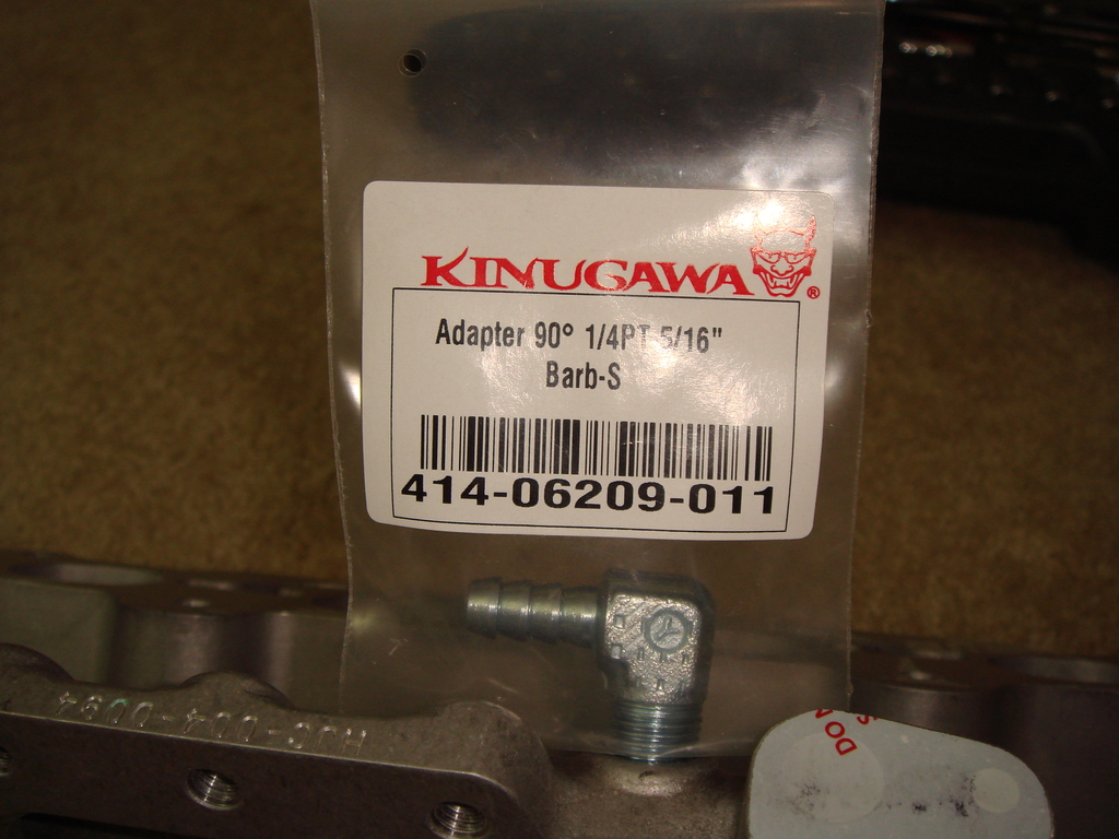

I go to the link on eBay and try to buy one,
but they run out,
so I check the source and it is Kinugawa Turbo and they sell direct online,
so I bought 2 fitting from them:
Forged Steel Adapter Fitting 90 Deg 1/4 BSPT BSP Male - 5/16" Hose Barb C12-2
I plan to use this 2 fitting for my Defi Boost Gauge (on the way),
and for AEM Water/Meth controller sensor (still not bought it yet).

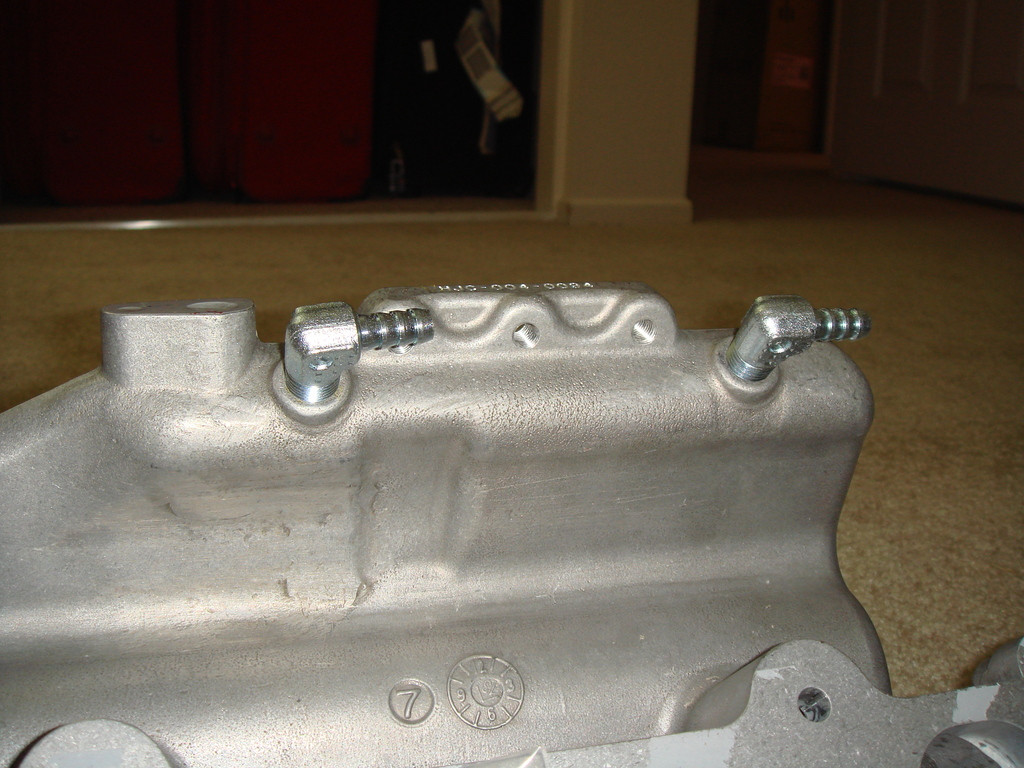

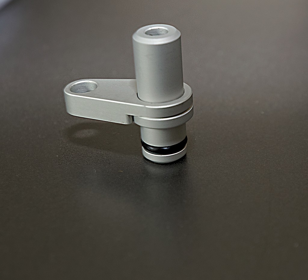

I need The original MAP sensor location on the Sprintex manifold
to act as the input for AEM F/IC-6 MAP sensor,
so I also bought this:
VitTuned Vacuum Barb Kit - Products
Hopefully it is the right size for Sprintex Map sensor opening.
Problem is I bought all 3 items above at the same time about 3 days ago,
and the Kinugawa fitting just arrived at my home today,
while the VitTuned Vacuum Barb Kit had not even ship yet...
I hope VitTuned will ship my order soon...

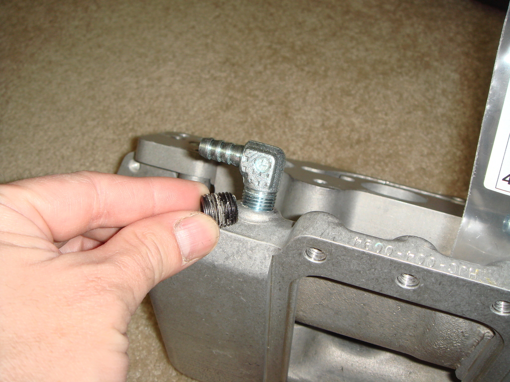

Here is the pictures of the Kinugawa fitting on my Sprintex Intake Manifold:
The Black Stopper is the Block Off Plug that came from Sprintex:

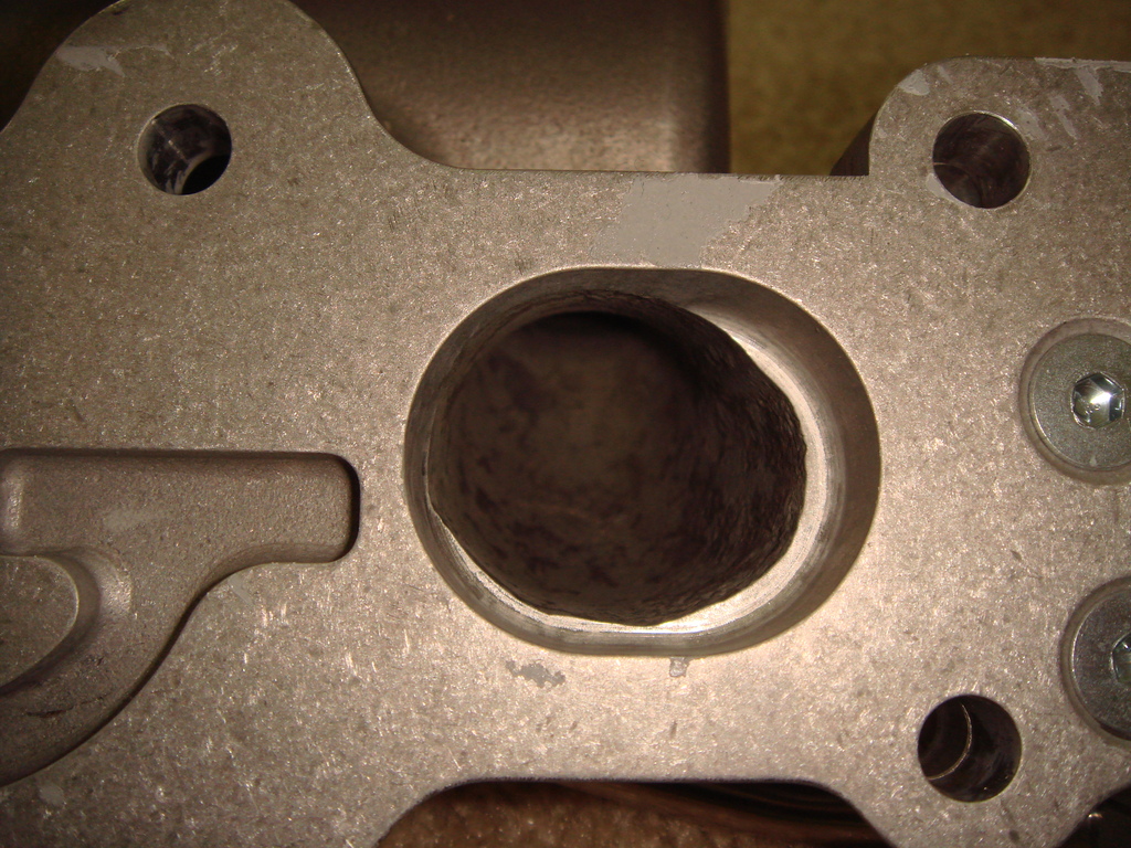

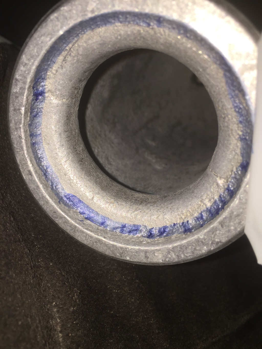

Now, I also plan to grind the restrictor on the inlet elbow and then polish the inside surface. I mark the limit to grind with blue marker:
while doing research on this I also realize
that I want to do port and polish of the intake plenum of the Sprintex,
because the casting process make the outlet of the intake plenum
to have some thick uneven surface,
here is a picture of one of the outlet of the intake plenum:
as you can see there is a lot of material that can be grind out (port and polish),
which hopefully will give a more laminar flow.
I just ordered a new intake manifold gasket from Bernardi Honda,
because I also want to do port matching with the gasket.
as soon as I get that,
I will do the port and polish...
