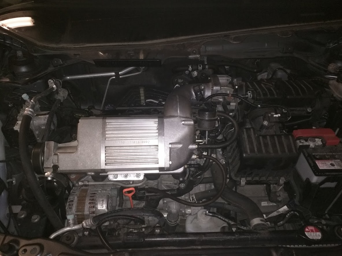

Well, I'm up on running on K-Tuner and the Sprintex kit:
2013 Fit
Sprintex Kit
Evo X Fuel Pump
RDX Turbo Injectors
I've been working with TurboGixxer using his E-Tuner service. Still have a ways to go, but it runs and drives.
I capped the vaccum port coming off the intake manifold that was used for the SMT8L map sensor, and I just blocked off the 5th injector port using a bolt in a fuel flange that I bolted up it.
A side note to anybody upgrading thier injectors with the Sprintex Kit: I bought injector clip adapters instead of removing the stock ones and inserting the pigtails... due to EXTREMELY tight clearance between the fuel rail and the intake manifold, i do NOT recommend using the adapters, just yank the stock ones out and put pigtails in.
I'm thinking I might have to take the EvoX fuel pump out again and check that damn output O-Ring, not sure if the system properly pressurizes everytime. That fuel pump lock ring is literally the worst.

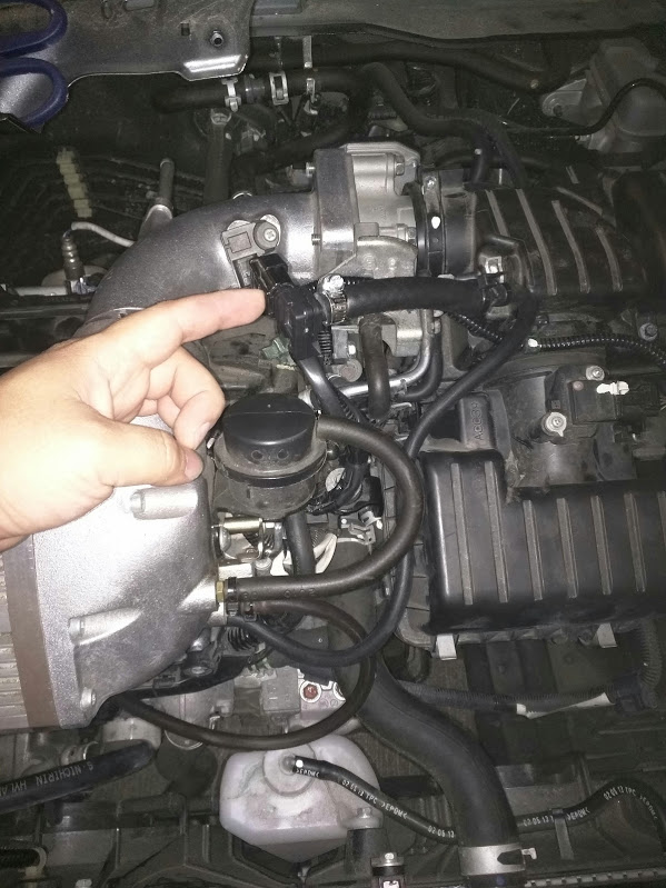

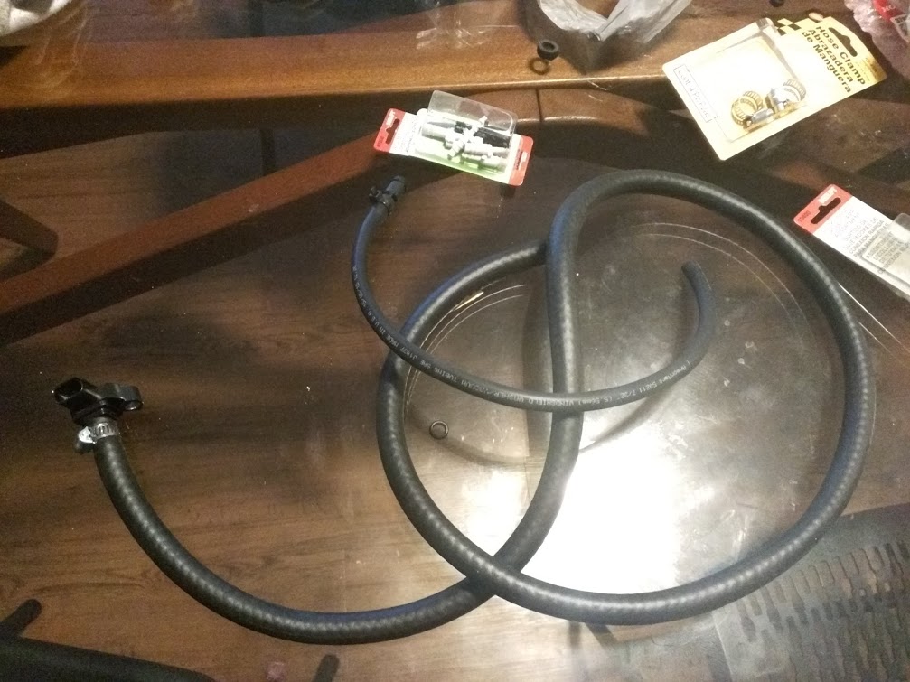

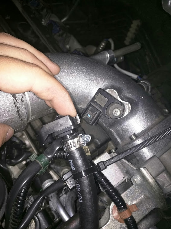

Got a 2nd map sensor at the stealership because I didn't want to wait for USPS first class mail.
Then I got two sizes of hoses and a barbed adapter to meet in the middle.
Sensor data looks like it's reading correctly post blower.
