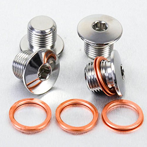

So it seems that the drainage bolt area has developed a leak.
I ordered some new bolts in the hope that it would "band-aid" the problem... which is, the bolts that go in do not have heads to seal themselves against a surface. The drain bolt is especially problematic because there's nothing stopping the bolt from going all the way in and so it completely relies on the threads to hold the oil in (and maybe some sealant if you apply some).
I had to order the bolt because apparently, the ones used in the sc are a rare size... M13, which Home Depot doesn't carry (found out last night).
Hopefully this will fit...
