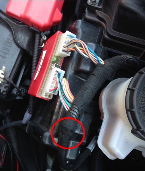

Here is the area where I wiggled the piggyback harness just a little bit and the car just died out almost instantly. No CELs thrown like i said before, just dying out. The only time it threw a CEL was then i tried to retape more with friction tape just like Sprintex used and it did not seem to like that since I may made it too tight. I removed most of the tape I placed and the car ran fine again after I cleared the CEL. Though I still think there is something loose inside that area I circled. The car does not run with that Oomph it has before. It feels sluggish when I'm hitting the gas hard. There are few times when it feels how it really supposed to run, that grunt and angry feeling where it just wants to take off.
I pointed the area to my mechanic who installed the supercharger and did the soldering and he told me that this is how the harness came and that the soldering actually happened way in the back where I couldn't even see. The soldering is not the issue. It's not even the port issue of the harness, its the friggin wires within the harness.
He will open the friction tape around that area to see how the wires are if they need to be repaired or are openly touching each other or may need replacement. Won't really know until Tuesday since he is swamped with other work.
Gary, I know you are a busy guy but I hope you are paying attention to this.
We need that plug and play harness ASAP :-)
