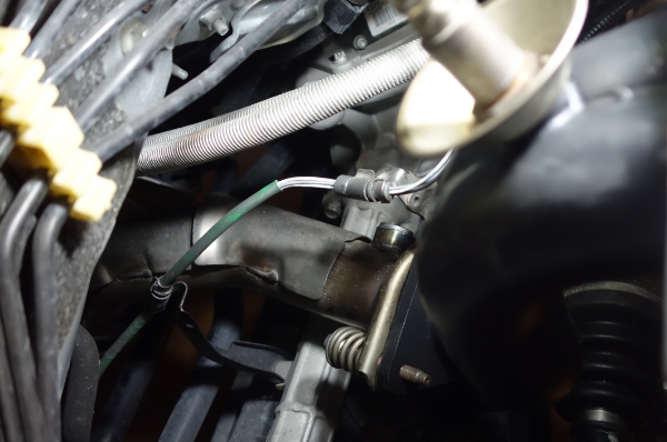

I took a day off from work today to install my T1R exhaust pipe and to drop off the secondary CAT to have an O2 bung welded. My excuse to my boss is Chinese New Year. The AEM UEGO analog wideband I ordered from Amazon should be here by middle of next week. So will a used Evo X fuel pump from a 2011 Evo X GSR. Used low mileage Evo X pumps are cheap around $60. I will install both the Evo X fuel pump and the wideband before gutting the inlet restrictor. Both the primary CAT and the secondary CAT is out. Almost time to head out to the shop and get lunch.

Plenty of space without the primary CAT. 45 minutes and $60 lighter at Proven Power the stainless steel O2 bung is welded on the drive side of the secondary CAT for a wideband O2. The secondary CAT pipe is double layer which I have never seen before. Guys at the shop suggested gutting the secondary CAT as a cheap mod to free more exhaust flow. You could definitely smell the difference without the primary CAT during initial startup to look for exhaust leaks. I have to wait for the exhaust to cool before bolting the passenger side half shaft heat shield. Test drive is tomorrow morning.
