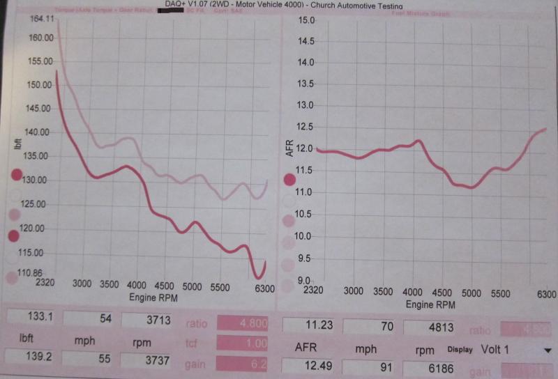

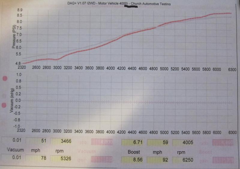

Here are my dyno results during my tuning session at Church Automotive. They use dynapack. I couldn't save my scan for some reason, so I just took pictures instead :-P
From my very limited knowledge of reading these graphs, it seems I am making more torque than hp.
When its hot, looks like I get about 150 lbs/ft of torque and about 137 Hp at around 6k rpm.
If its cold, I can get up to 164 lbs/ft and about 157 hp.
Please correct me if I am wrong on my readings. Also help me interpret the rest

Crank or to the wheels? Pretty cool all the same!

Gary, DSM, Lyon, Rick, everyone - any recommendations on a fuel pump that I should use? Goobers mentioned the Walbro 255. That one safe to use?
According to Church Auto I need a bigger fuel pump because it is not keeping up with the boost and I will go lean if I go past 6K rpm, but told to keep it under 5500 to be on the safe side. I'm thinking that Rick (1sickveilsidez) experienced the same issue when tuning at Church Auto the first time. He will likely be back for another tuning session and so will I.
Gary, you previously said that the sc can get us up to around 180 hp. I would eventually like to reach that further down the road.
It's at the crank.

I'm pretty sure that is not at the flywheel, unless they pulled your engine to put on a stand lol
Church uses Dynapacks, no? So taken at the wheel hubs. Which reads higher than a Chassis Dyno like DynoJet, and most DJs are set to read higher than Mustang Dynos.
The 597whp I made on an MD couple months ago, would make 650-660whp on a competing DJ, and would not be exaggerating to say nearly 700hp on a hub dyno.
Yes you are correct that Church uses dynapacks. Yup taken at the wheel hubs.
