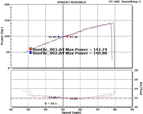

I am not sure which RPM. According to my dyno graph air fuel started to lean out at around 66 mph.

13:1 is still acceptable for a minor supercharged setup
EDIT but 12.0-12.3 would be a better goal, with a touch more timing as needed
If you did this in 3rd gear, then it would be roughly 5500 RPM, because most gears run roughly 2500-2700 RPM at a gear# times 10 speed. By that, 1st gear @10 mph. 2nd @20 mph, 3rd @ 30, etc. will all be around 2500 - 2700. So, if you were around 60mph, it would be ~5500RPM or so for 3rd.

It could very well be at around 5000 rpm. The car was dyno using third gear several weeks ago with a stock setup. Since then I have added a T1R exhaust pipe and my short ram intake. I am almost done with the AEM UEGO wideband O2 kit installation. The only thing left is to connect to the instrument lighting circuit supply voltage. I did test the wideband setup some what to confirm that it is working. At idle the car hovers around 13.5 AFR. I really want to see the AFR and the effect the bolt on has on the AFR.

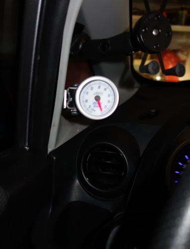

I spent some more play time with my car today after completing the AEM UEGO wideband O2 installation and installing an O2 defouler to fix the P0429 DTC. There were several opportunity to open up the car while keeping an eye on the A/F gauge. At wide open throttle it stay around 12.5 A/F through out the RPM range. Something unexpected happen when I got aggressive on the throttle to red line. Starting at around 5000 rpm I believe I heard the relieve valve, pssshhhhhh several times. First time I heard it I thought it was a exhaust leak but it an unmistakable noise of the relief valve. The pssshhhh sound is similar to my Greddy BOV in the MR2 Turbo but not as loud or aggressive. Well I hope it is the relief valve not an exhaust leak.
I Could not think of a good place to mount the AEM analog gauge so here it goes.

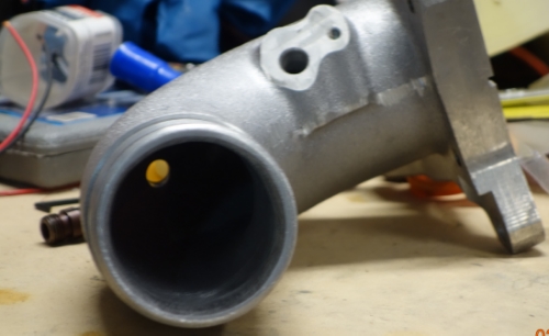

We gutted the restrictor today in the US shop car. Interesting results. No more boost, but cooler operating temps from the blower. 8.5psi on the gauge. It feels like it breathes more happily. What little ping was there is also gone, which makes sense with breathing more easily. The rest of the vehicle is still stock, but we had to at least try this. We blame spring fever . The driveability seems a lot better. It smacks me around more like it should.

^ This is interesting. Looks like you beat Steven to it. So why is it in there in the first place if it runs so good without it? Have you changed the tune?

It's a world-wide kit and Asian OE exhausts are more restrictive. They cut out the restrictor and retune over there, too. No word on their fuel pumps, though. One would think that could be a consistent problem.

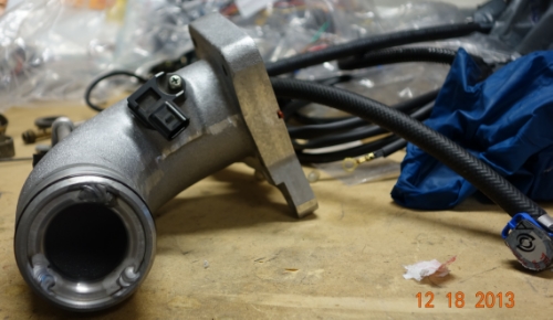

I just gutted mine today. It is too late to go for a test drive but tomorrow is another day. Tomorrow I am going to talk to the guys at Proven Power for a dyno tune next week.
