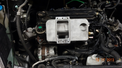

You are right. There is a separate air temperature sensor in the Sprintex supercharger manifold. It is listed in the parts packing list as air temp sensor, AT305. I found the AIT calibration table in SMT8L. The IAT sensor is above the brass hose barb in the intake manifold. It probably makes sense at high intake manifold temperature the piggy back would pull timing and dump fuel. I need to look for that in LetRipp.

Also with your temperature issues. I think you could be looking at two separate temperature sensors. The UG can see the intake temperature via OBD2 and the cars original intake air sensor, but the SMT8 can only see the new sensor (that came with the kit) that is after the compressor. So the SC is heating the air up. Mabey?
