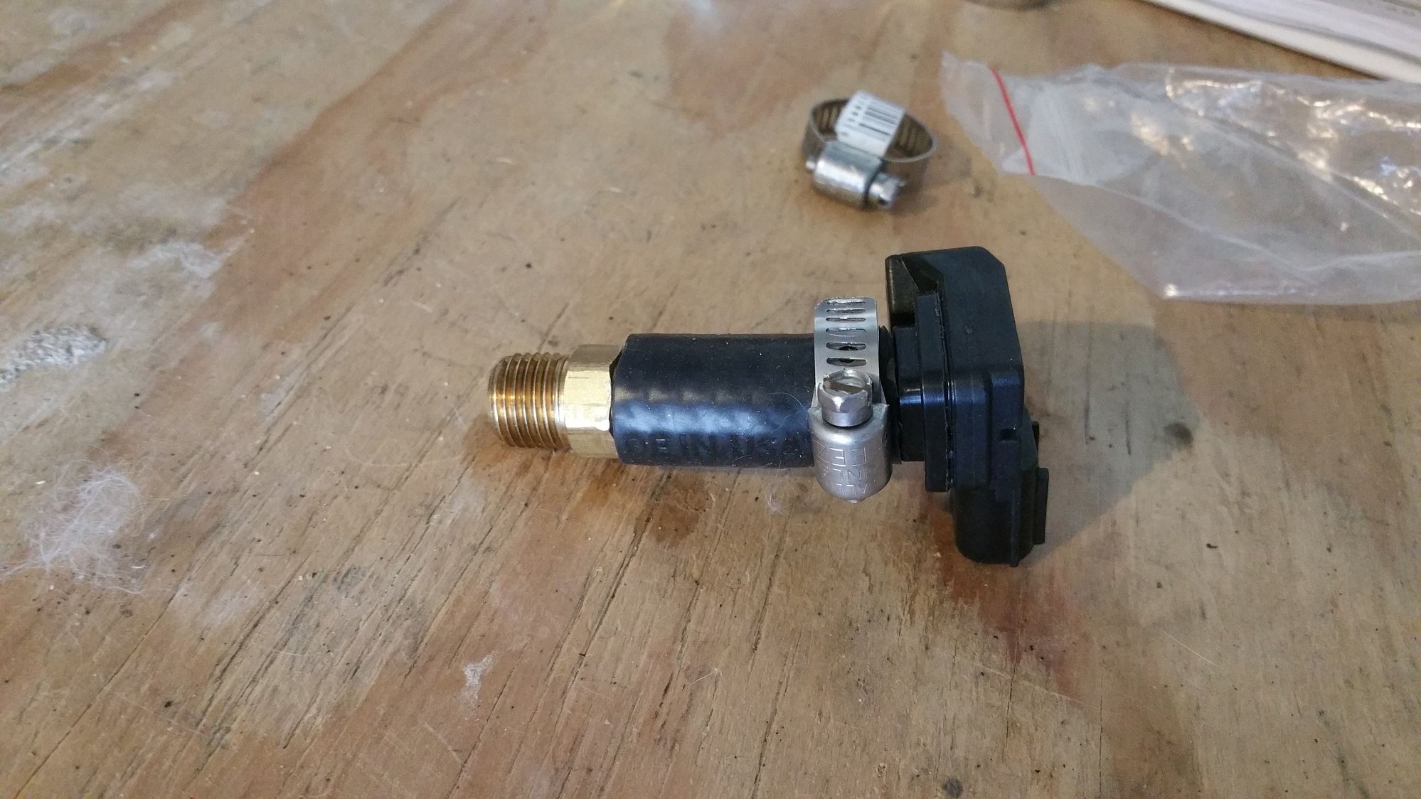

If I'm understanding this correctly, you're going to run a vacuum hose from one of the ports on the back of the blower to the map sensor?
http://i151.photobucket.com/albums/s...ps11djjzij.jpg
Same principle as a mechanical boost gauge, which is what I have hooked up to one of the ports in the back.

I have a factory map sensor hooked up to a vacuum port on the intake manifold (post blower). I left the factory MAP sensor in the intake elbow so there's not a hole there

Yeah, that makes perfect sense. Not the ideal setup, but it will definitely work.

Here is my plan, If the threads are the same as the 1/4 adapter the sprintex uses, I plan to use an 3/8 adapter and a bit of 3/8 ID heater hose.
The sprintex uses British pipe thread, so you'd need a 1/4 bspt. I've only been able to find them in 90 degree elbows to a barb.

Stupid bspt. Thanks for the heads up zf1punk. I ordered a 5pack from McMaster-Carr. So if anybody needs one, PM me.

Here is a better looking solution for plugging the old MAP sensor hole:
K-Tuned MAP PORT PLUG KTD-MAP-PLG ? HPTautosport

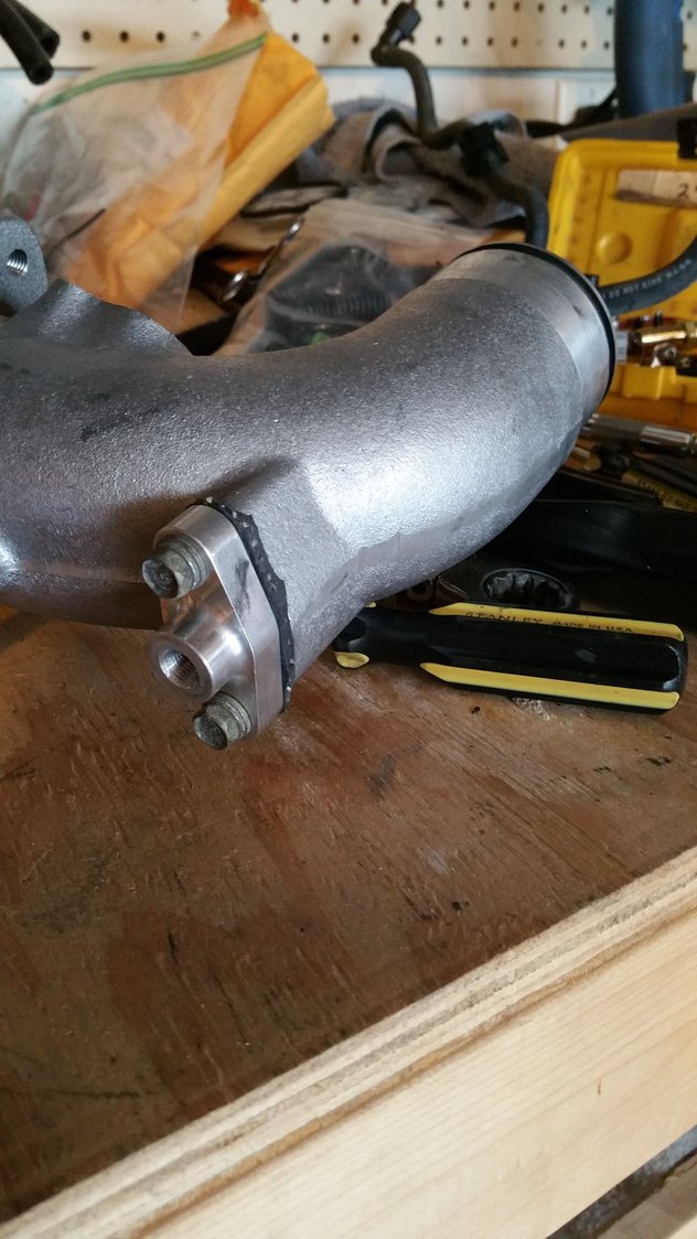

Did you left the Sprintex 5th injector to cover the holes, or
you have another idea to remove the 5th injector and cover the holes...
If yes, what parts can we use to cover the holes from removing the 5th injector?
and if we just left the 5th injector there, will the 5th injector block some of the air flow?

5. I took the 5th injector out, used a fuel fitting flange with a bolt in the m middle with loctite on it and then bolted it using the supplied bolts to the intake elbow. I can take a photo later if you want.

For blocking off the 5th injector I did this:
I used 2 shorter bolts and made a gasket out of a bit of hose.

Where did you get block off plate?
