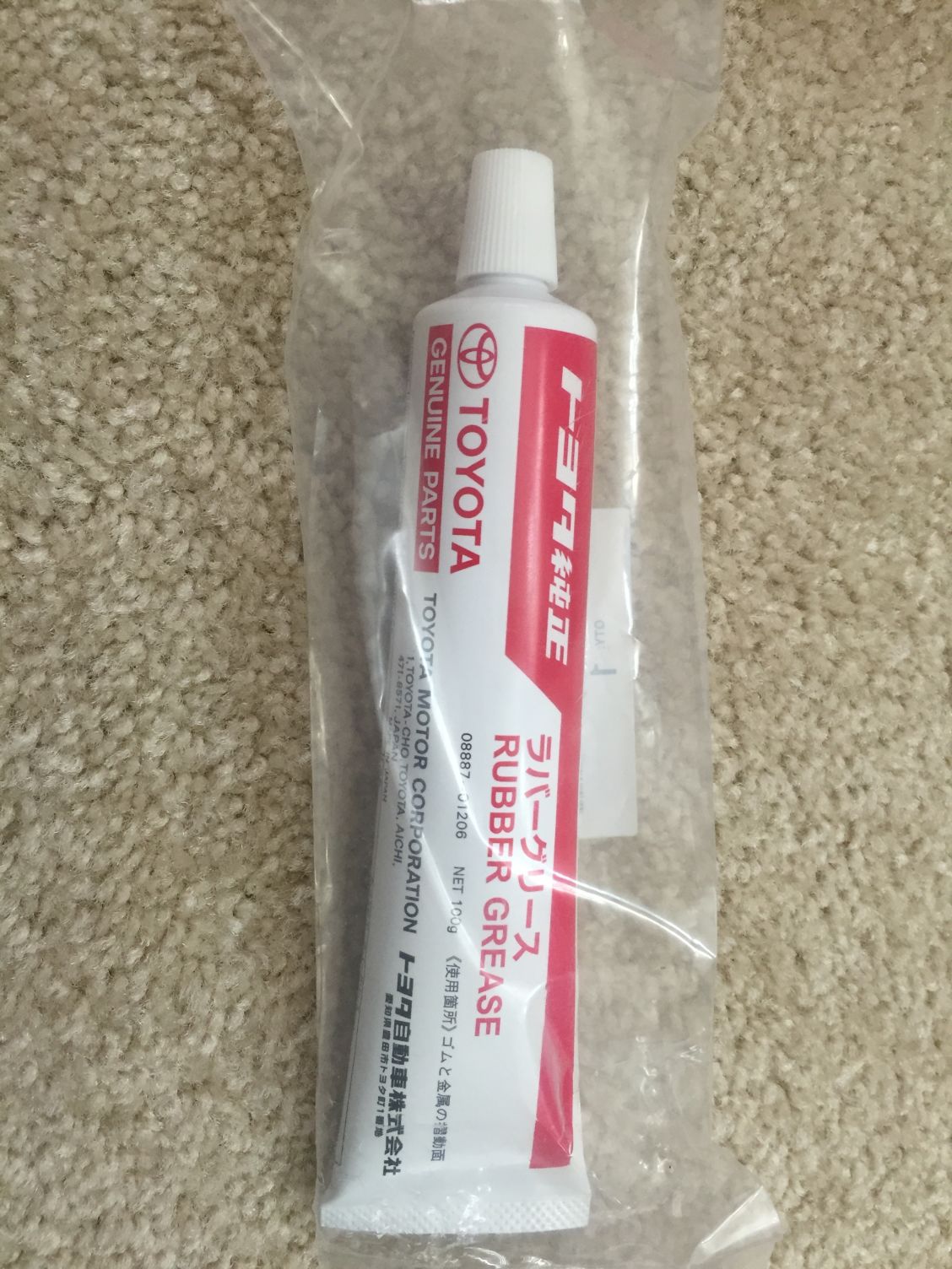

I already have a used AEM F/IC-6 but I bought another brand new unit from JEGS
so I can have back up, so if one unit broke down, I can just swap and my car will run again... Only have one car and can't avoid down time...
I also bought Toyota Rubber Grease for use when I install the intake elbow and manifold of the Sprintex.
Attached Thumbnails Sprintex Supercharger Install-80-img_0820_42a33cadd9e4e446c13f897e437dd062d471ff8f.jpg   Sprintex Supercharger Install-80-img_0821_ddc85e5e651f9f597ffdb044c5ad5e1ff8ed8892.jpg

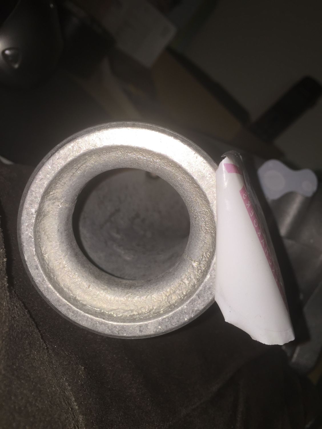

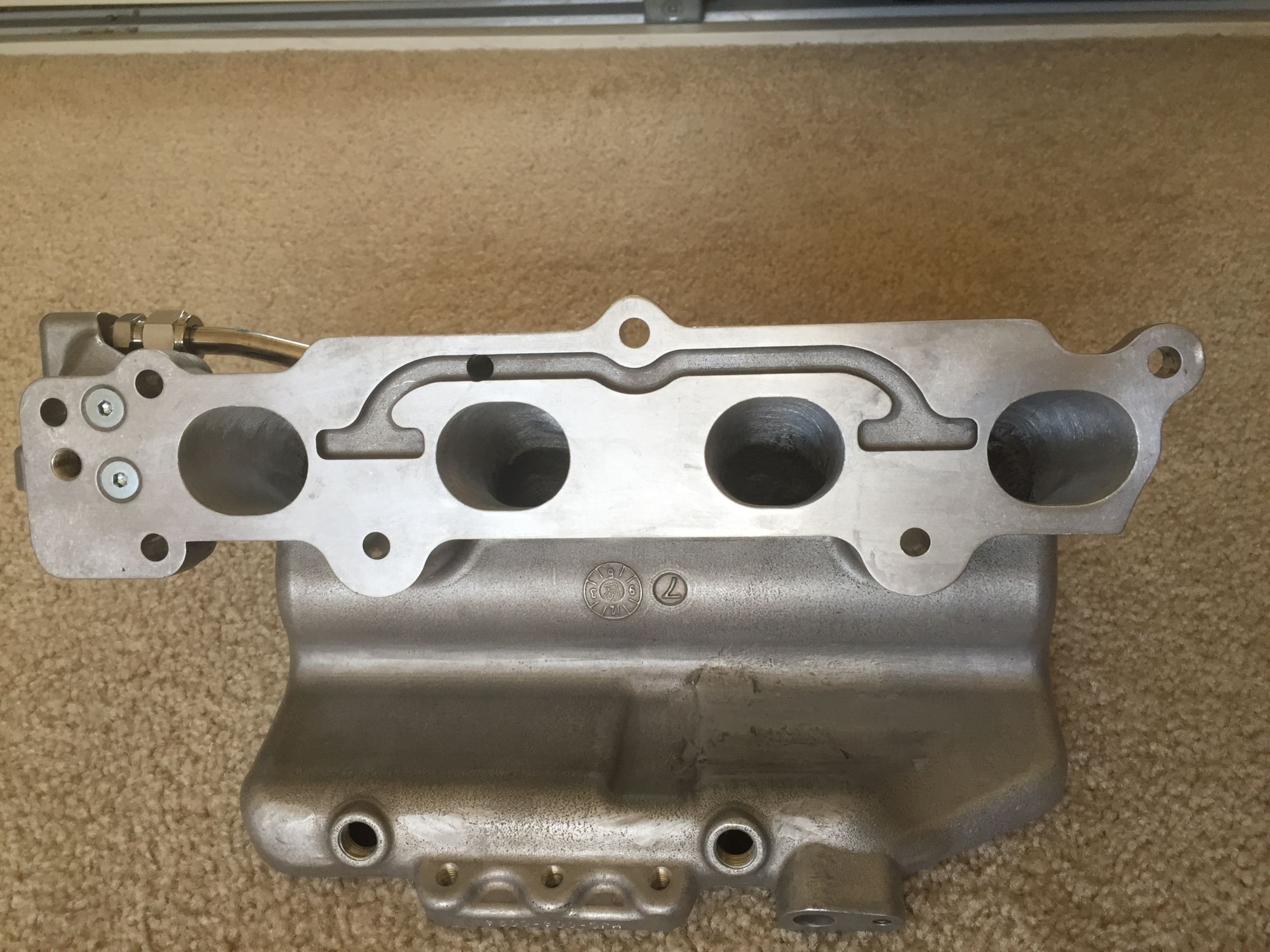

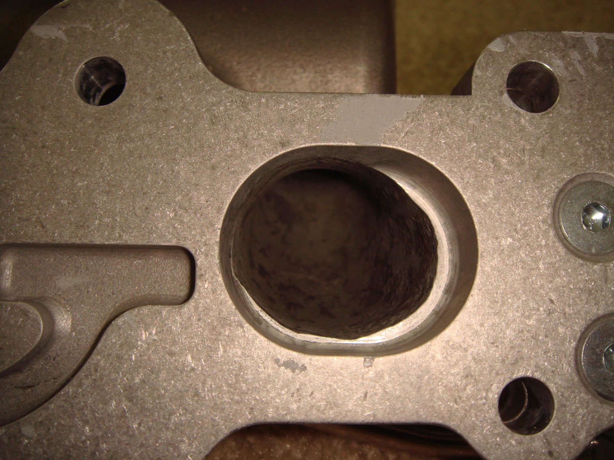

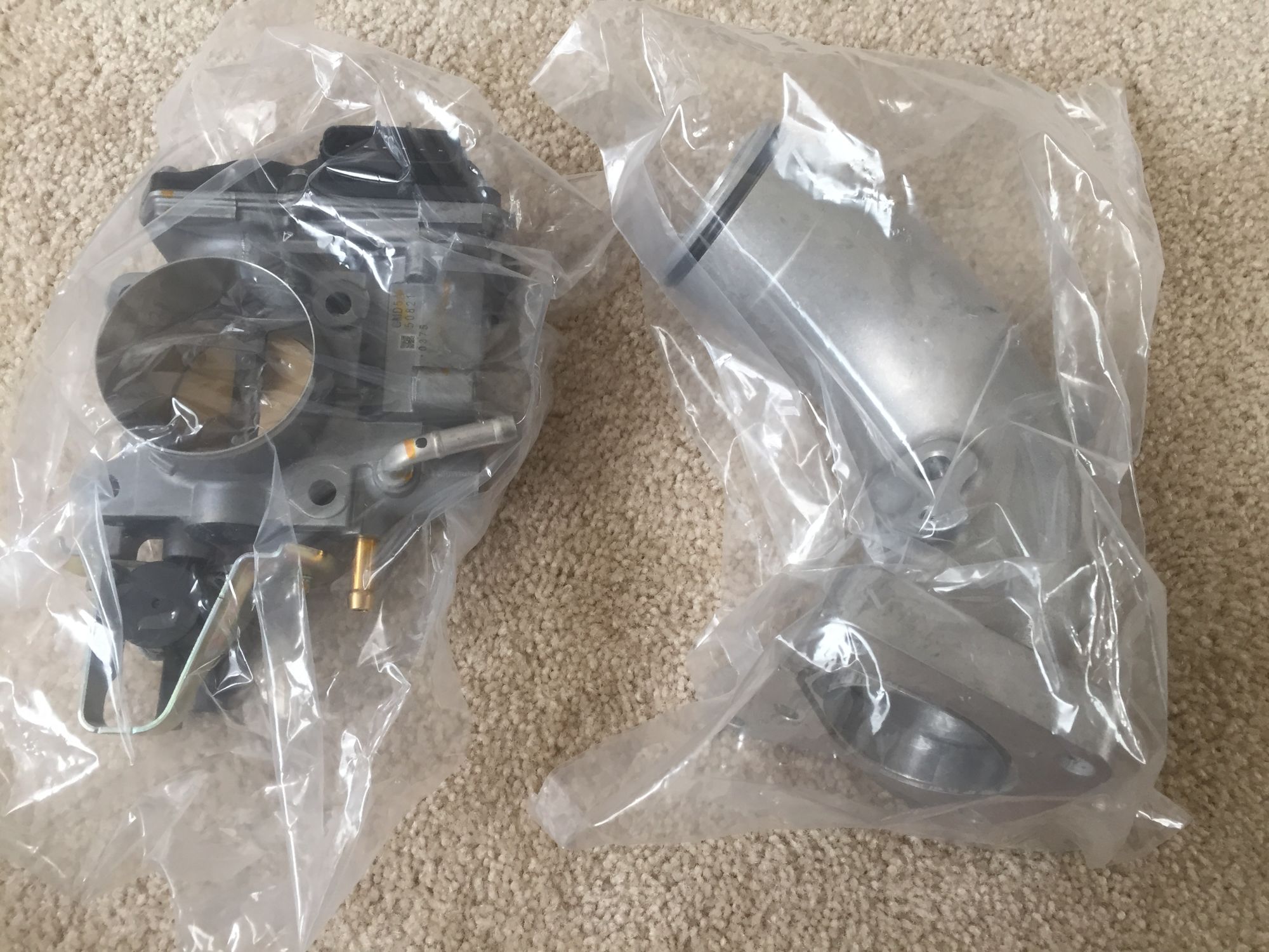

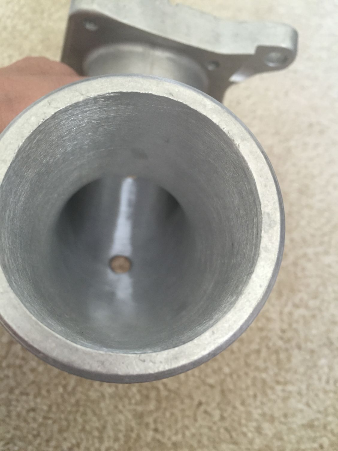

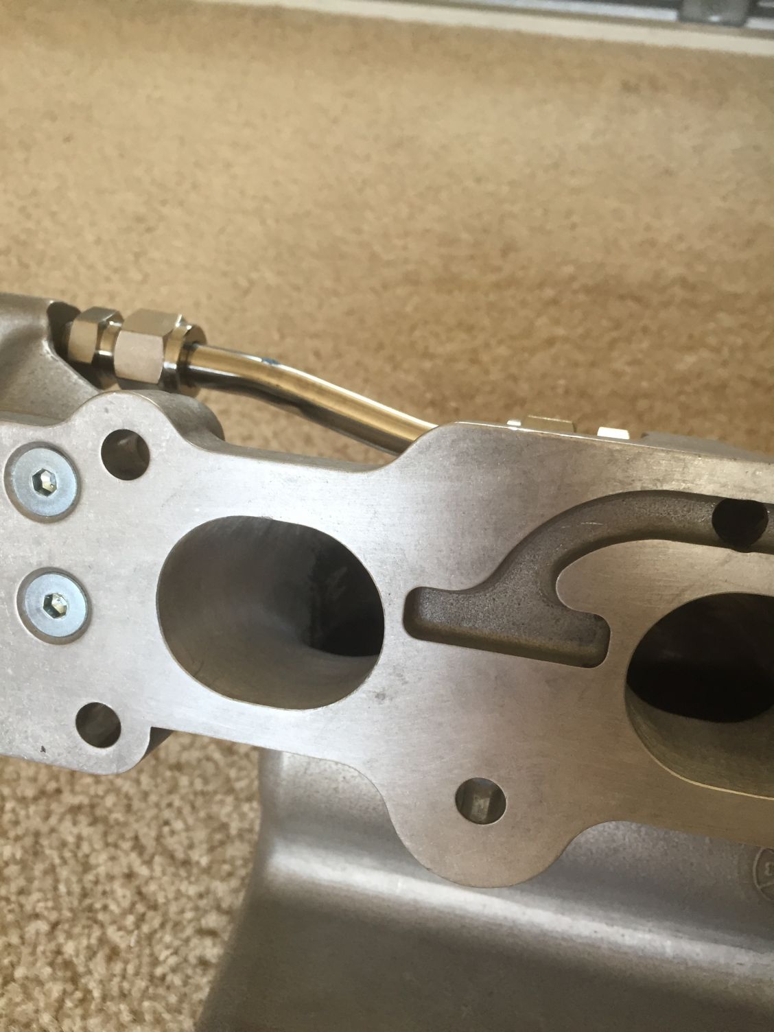

My Intake Elbow and Intake Manifold just return back from Port and Polishing,
Intake Elbow Before Porting:
After Porting
Intake Manifold Before Porting:
Intake Manifold After Porting:
Right now, I just packed the Intake Elbow and Throttle Body ready to ship out for Port, Polish and Gasket Match (between throttle body and intake elbow) and it will be done by MaxBore. Hopefully it will return back from MaxBore the first week of May...
Attached Thumbnails Sprintex Supercharger Install-80-img_0130_3e2ee935ebf5672400d8ebccf673b59de6c219c7.jpg   Sprintex Supercharger Install-80-img_0823_1e7dbf4591eb4ba5397a31508f62e3ff27d75741.jpg   Sprintex Supercharger Install-80-img_0825_287a3aeb852c7095356cbcef87eb495efadc4c28.jpg   Sprintex Supercharger Install-80-dsc09771_184705873e627c452a0f34a513ef03309ad4e85c.jpg   Sprintex Supercharger Install-80-dsc09755_a9c5f77f17e8b49d63339a1f3b5a99cc0b9fe233.jpg
Sprintex Supercharger Install-80-img_0829_a499369e885b4f4eaa184ad63a27134d8d806a50.jpg   Sprintex Supercharger Install-80-img_0827_14ca1429818825a52f30b165902d543a6f60cd42.jpg
After Porting
Man wtf, is that the stock intake manifold? Thats some sloppy Honda work if it is, time to queue to the video of some old ladies PnP the type R heads.
No, that is the Sprintex Supercharger Intake Manifold that replace the stock Honda one.

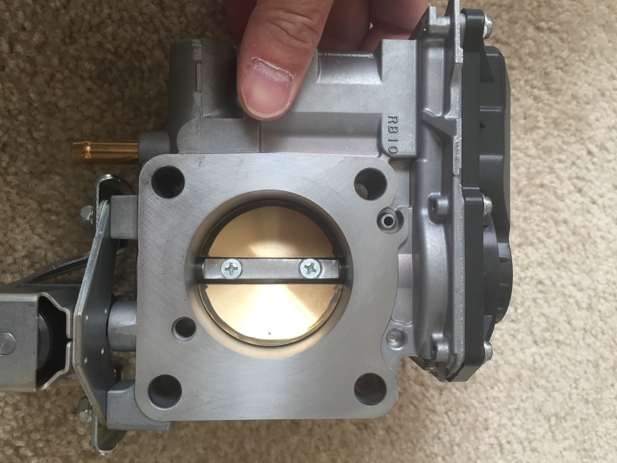

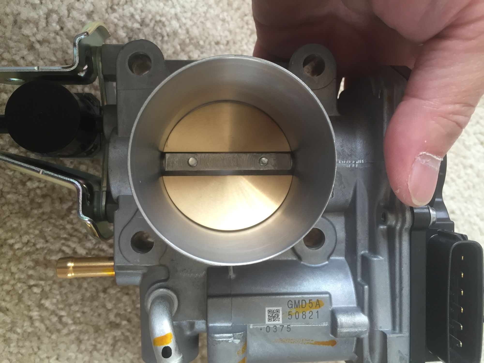

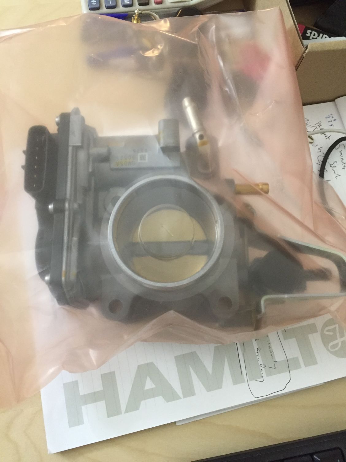

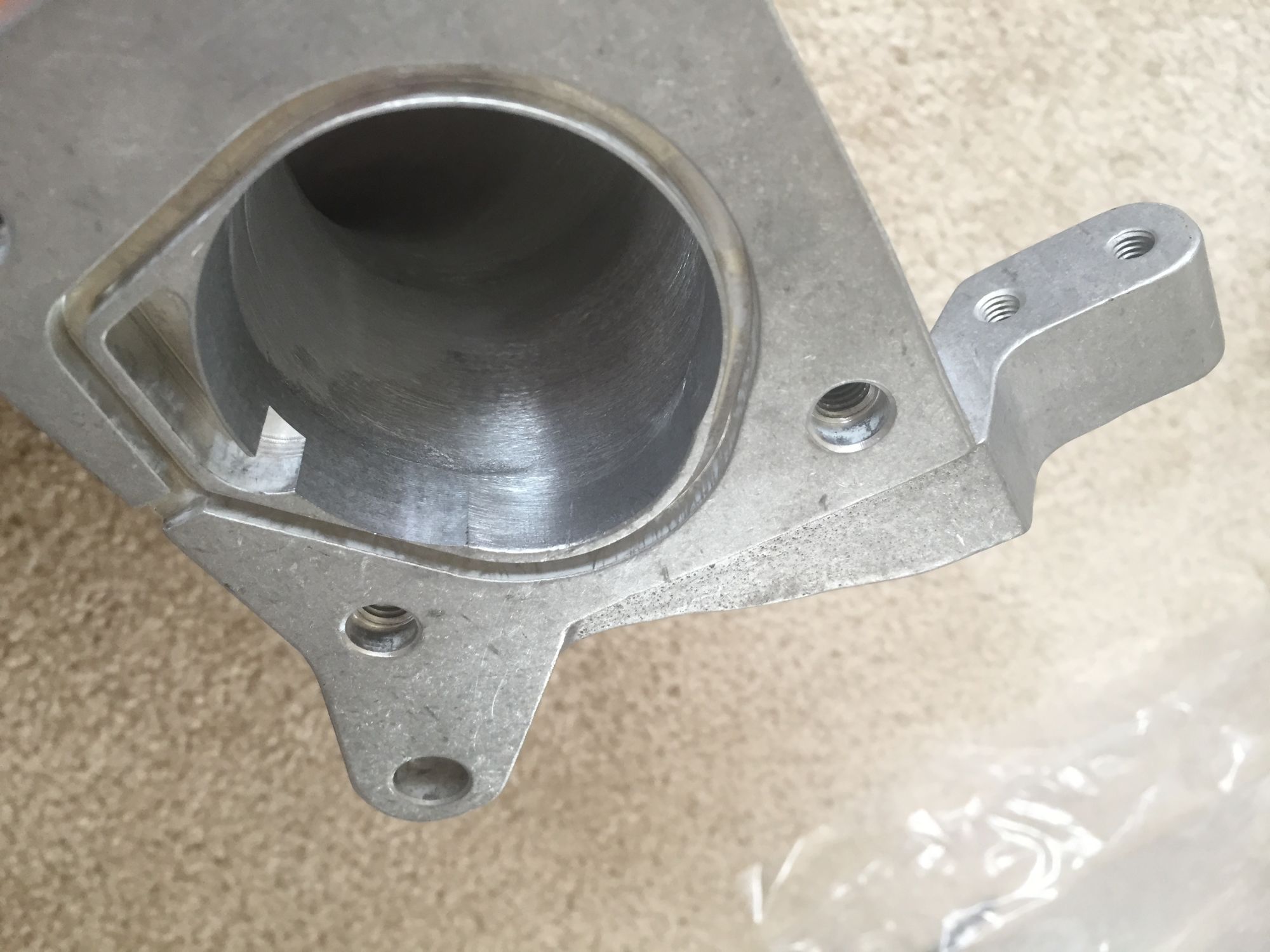

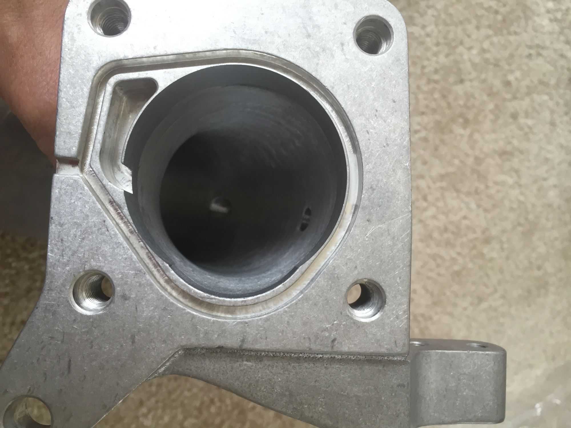

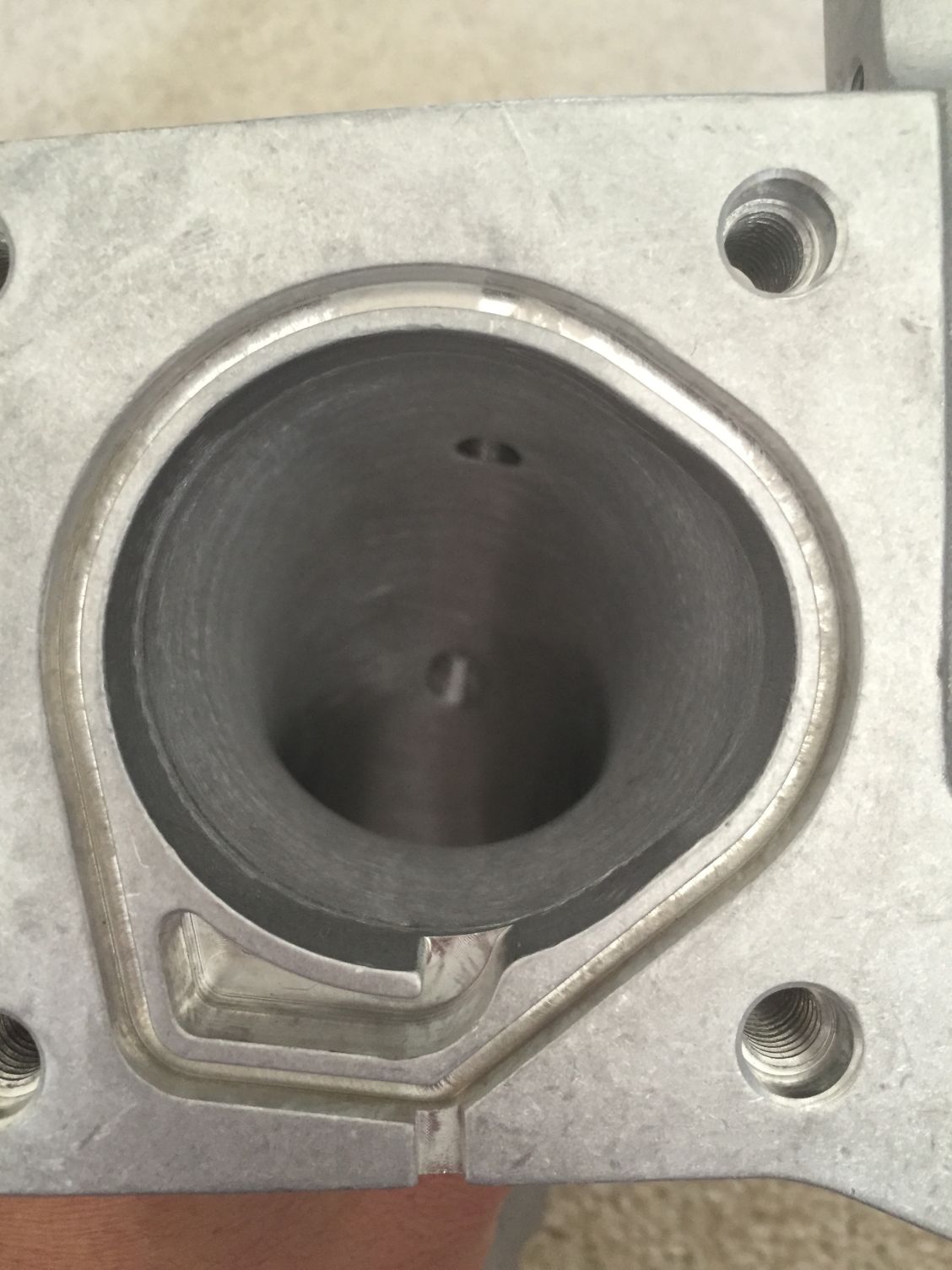

My Enlarge Throttle Body and Gasket Match to Sprintex Intake Elbow just returned from MaxBore:
Before:
After:
Attached Thumbnails Sprintex Supercharger Install-80-img_0720_578c96ed95b9b468ba252fcaaff443746910bffb.jpg   Sprintex Supercharger Install-80-img_0955_0c95f26d83a122ef36c7a6b56e960cfb6328c9cc.jpg   Sprintex Supercharger Install-80-img_0956_ff545f59298616667c2529d64271963f99284c5d.jpg   Sprintex Supercharger Install-80-img_0957_e76838795c2b7782630761b230eb65fc146fbf32.jpg   Sprintex Supercharger Install-80-img_0958_7a028b465ffc33da0ade6d0e17b713b522aeac1a.jpg
Sprintex Supercharger Install-80-img_0959_e99cfb76ebd2675775ef1129eb37fc099c3dfbda.jpg

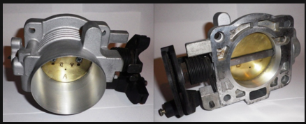

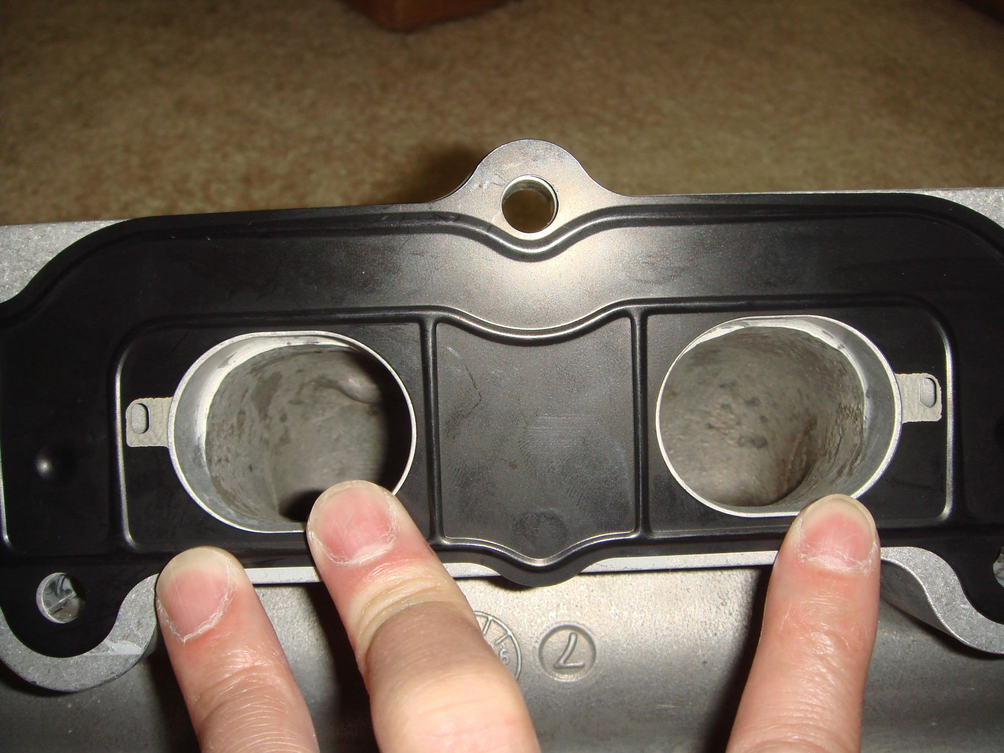

best test for the tb is to hold it up to the light and make sure no light is seeping around the tb plate (or at least no more than the stock one does). would have expected them to do a bit more work with stream lining the tb shaft (they could have cut off the top half of the shaft and counter sunk the screws directly into the plate)
edit: like this
Attached Thumbnails Sprintex Supercharger Install-80-svttb_0ae248b80b92f8e90a17ac48749562d37203e914.png

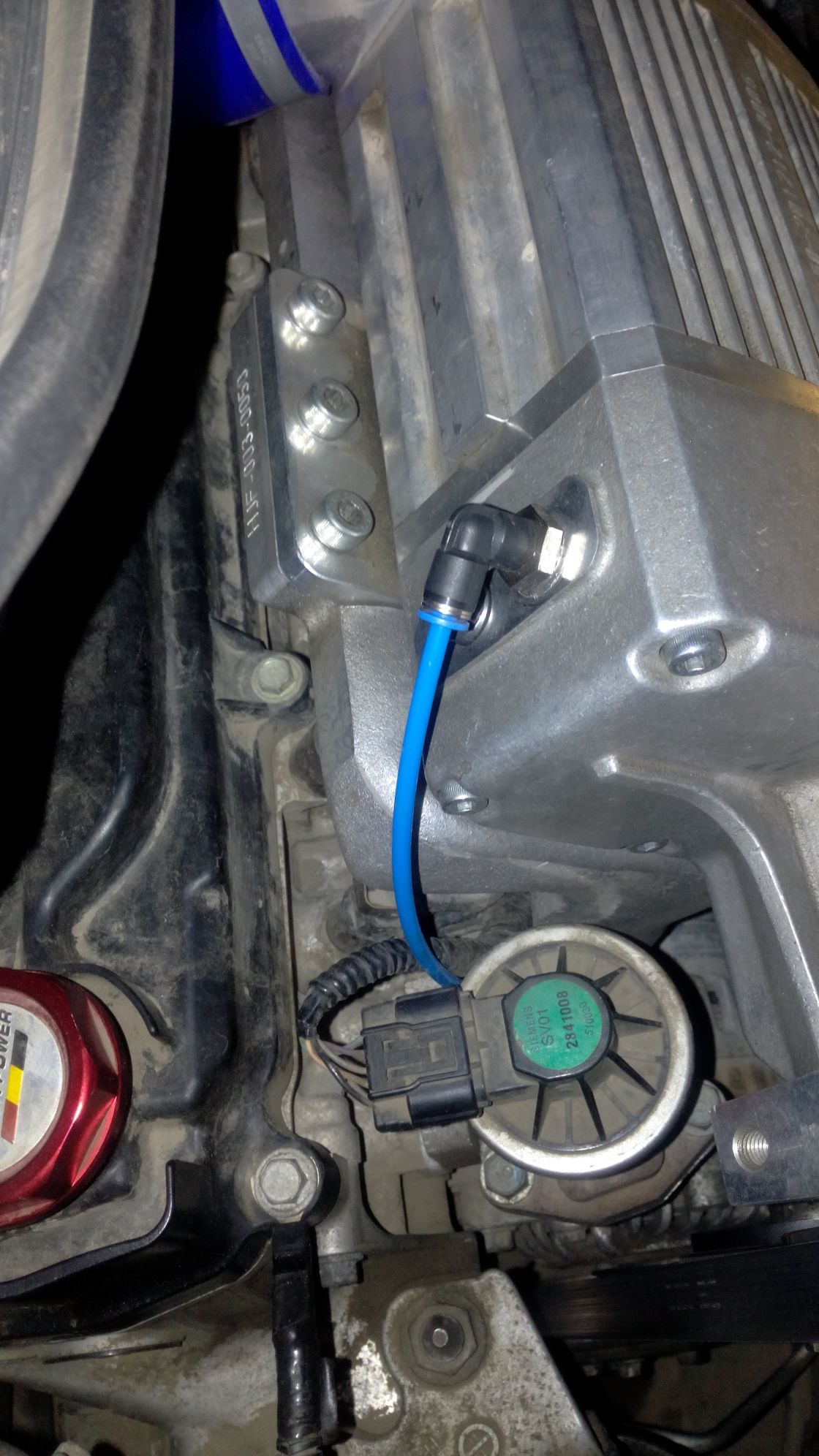

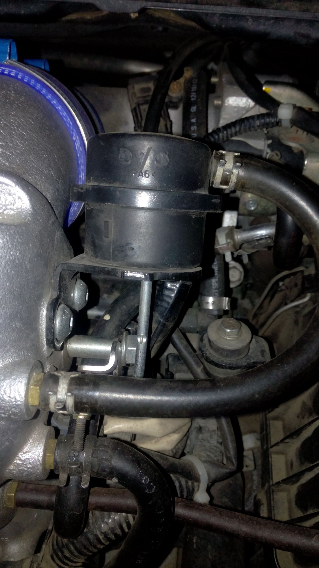

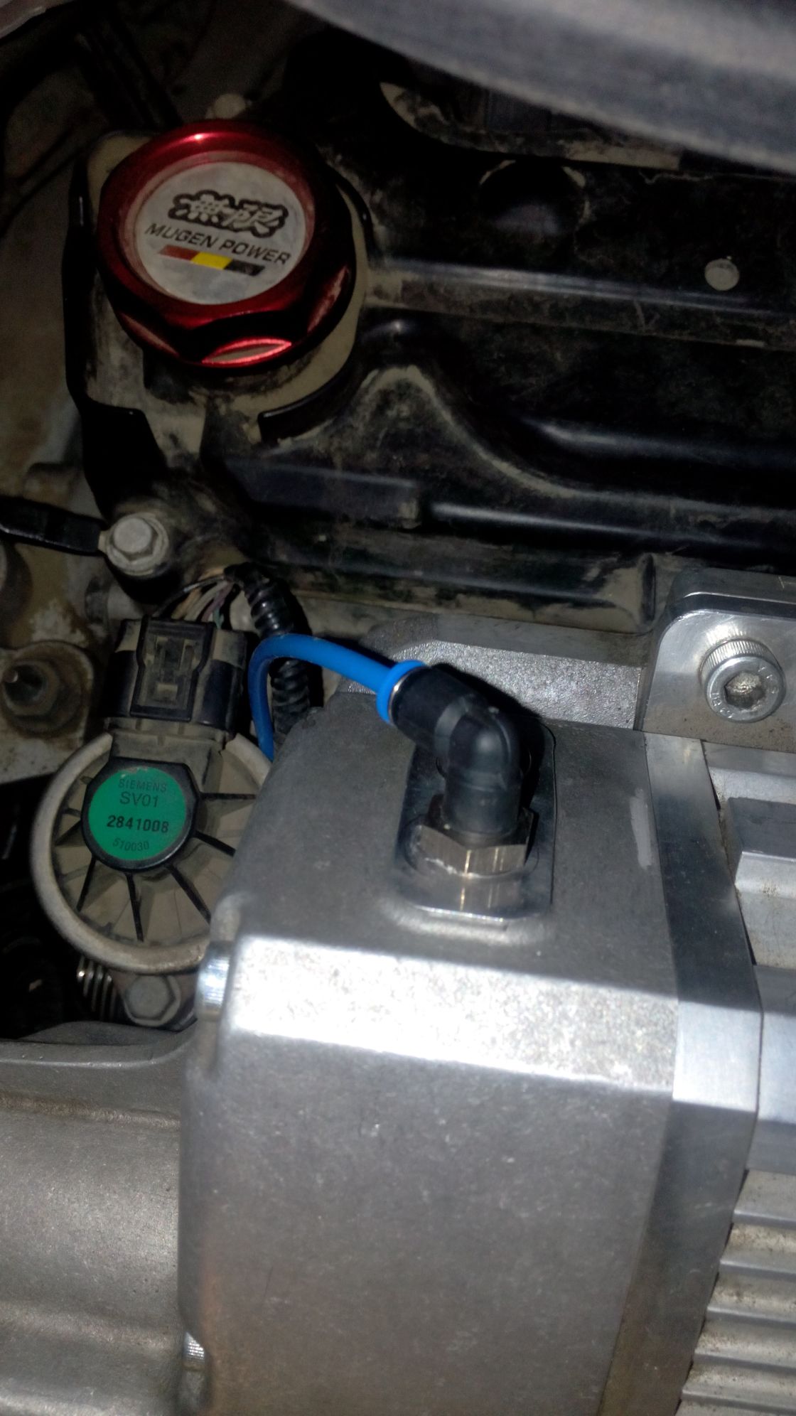

Hello!
First of all I want to apologize for my bad English...
I want to share modifications which I have made for my Sprintex S/C:
1) The most important thing is the breather for S/C gearbox. The compressor during the work strongly heats up and in its gearbox the overpressure is created which leads to leak of oil through seals - it is inevitable, eventually... So instead of a filler plug I use angular fitting (Don't remember exactly, but something like: EPL06-04) with 4mm tube.
2) When increasing the speed at high RPMs (over 3000) I felt some random pushes, as the ignition misfiring, or something in this kind. I put the clamps on the hose that connects the compressor with the restrictor and pushes are gone.
It turned out it was banal because of a suction of unaccounted air...
3) Not really important.
When replacing the oil in the compressor gearbox I put a magnet to the inner end face of the drain plug to catch the possible metal particles in the oil during work. I used a magnet from the old HKS oil filter (Code No.: 52009-AK001), which I had to saw to get a magnet. The magnet from this filter is perfect fit for the drain plug without any modifications, and since the S/C housing is made of aluminium, it is not necessary to glue the magnet to the drain plug.
Thanks!
Attached Thumbnails Sprintex Supercharger Install-80-img_20160509_192322_d8c335a9504b65e72fd73ed5b0bfaacbe734adc5.jpg   Sprintex Supercharger Install-80-img_20160509_192301_c76237a736975244ba8b114af9c3c2044e2256d3.jpg   Sprintex Supercharger Install-80-img_20160509_192206_42d951d5e1797e5506a7e2931bf2c657308280af.jpg
