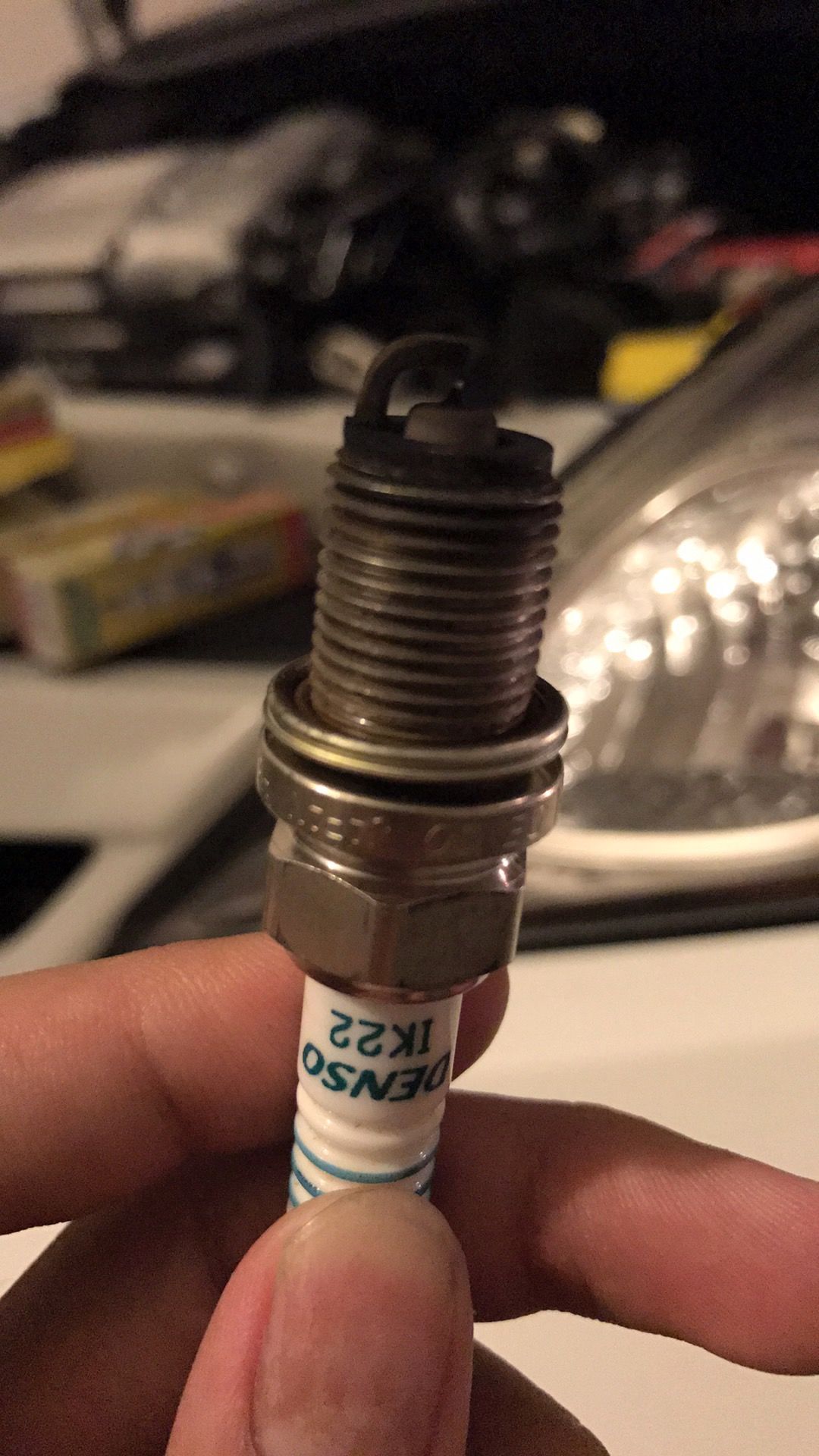

I appreciate the help so far guys. I'm about 500 miles in so far and the car has been fine besides the idling and the issues that I've already mentioned. At this point I'm convinced it has to be tuning error regardless of the tuner trying to blame it on the primary o2. Based on the UG lambda readings it seems that the o2 is responding just fine.
I did replace the plugs to see how they were doing and with how dark they already were, I'm assuming the tune really just needs to be redone. All 4 plugs looked like this. They had 2k on them before the SC and about 400 miles on them in this condition. I'll be replacing them again after the retune to see how they're holding up. I'm going to attempt to do the idle learn procedure and CKP relearn if I can. I feel like this may solve the rough idling issues before I take it back tomorrow.
Attached Thumbnails Sprintex Supercharger Install-80-img_0072_90f54f46da41a86e34e8048d94adb524b49ef569.jpg

After Tuesday's revisit with my tuner and about 200 miles in, I'm happy to report that I do not have any of the problems I previously listed.
-Starting crank fuel was corrected, no more cold start issues.
-Idling fuel trims adjusted, no more bogging or stalling out.
-EGR was disabled, no more P0400 code
I do have a residual issue, though. It seems that the ECU is operating under a different map when the car is in park. No matter what map we adjusted, the idling target AFR would not change. I'll be emailing KTuner about this. We have the current tune operating on MAP pressure at idle so the car hits the targeted AFR rather than running in closed loop and adjusting itself.
Other than that, car runs fantastic and still puts down the same numbers it did on the first dyno tune. It does run a bit more on the rich side, but this is mainly as a precaution for drivability. I'd rather have the car run rich than lean to avoid detonation and misfires. I'm keeping an eye on the short term ratios, it is much closer to spec (usually sitting between -4 to +5). Long term trim after the first 200 miles is at about -4 currently. I'll be changing the fluids out, along with the spark plugs in another 300 miles to see how everything is holding up.

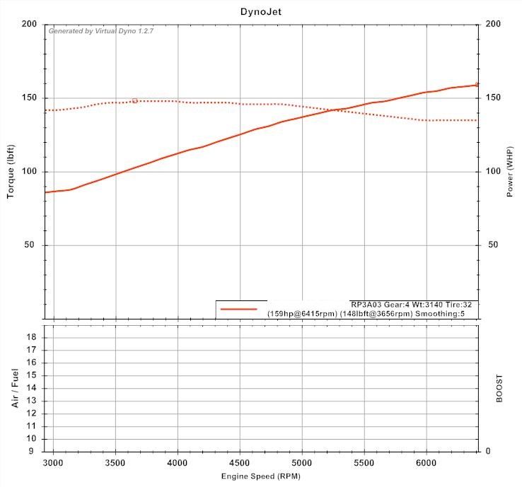

I got an e-dyno from the tuner!
Sprintex stock boost 5th injector block off
Ktuner
410cc injectors
3" short ram intake
weld in muffler
Attached Thumbnails Sprintex Supercharger Install-80-410cc_sc_speed_density_27_dyno_ecc20b0da517e1dc80991eb084bcbbbe0747e420.jpg

Successfully installed my sprintex kit with smt8 and pnp harness. Its been a few days with no issues. Install went smooth and took 3 hours including replacing spark plugs with ngk bkr7eix-11.
Car has weapon r header, yonaka catback and custom intake with stock maf housing. Running 93 octane with no obvious signs of detonation. Plan on getting tuned in a month or two.
Car is not fast by any means but the much needed additional torque is fantastic. Most important of all is my Wife is happy with the additional power and improved driveability.
