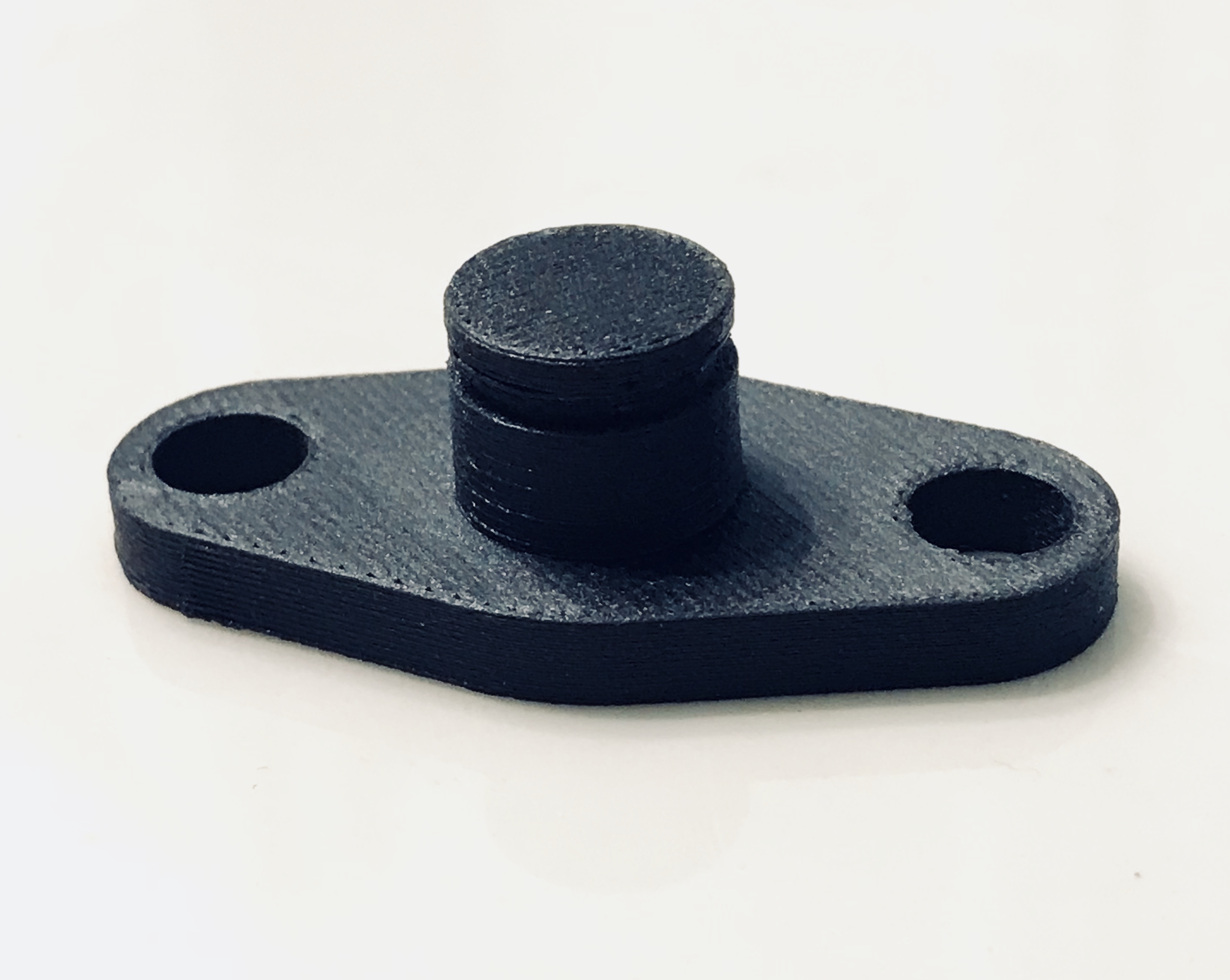

5th injector plug
Designed and printed a plug from NylonX for that 5th injector hole. Turned out great.
Could you share that? I also have a 3d printer, though I'll be using PLA (hope it canhold up). If and when I actually install the part is a different story, since it swapping out the fuel line.
On a side note, I sent my sprintex unit in for a rebuild a few weeks ago and finally got the estimate on it... $1k (labor kills).
Happy to share. https://www.thingiverse.com/thing:2796501
I would recommend picking up some PETG filament instead of using PLA. Its about the best thing you can get at a reasonable price that has high chemical and heat resistance.

Originally Posted by DanDRuiz
Where'd you send it in for a rebuild? Any particular reason as to why?
Also interested in why you needed to rebuild.
Originally Posted by Noxm09
Did your sc seals also take a shit ? lol who did you send it to ? I just had mine rebuilt and modified by Jonbondperformance and they did an amazing job.
Yup, it was seals. It leaks around the drive snout, which gets oil onto the belt... and since that belt is always moving... the whole area to the left of the SC is covered in oil.
Also sent to JBP... but as of today, it’s been three weeks in their shop and still not done.
Took two weeks just to get the inspection done.
Hopefully, they’ll be done by the end of the week so I can install it sometime next week and get my Fit back on the road.
@jonnyss, thanks for the link, I’ll see if I can pick up some of that petg, and hope it works in my printer.
