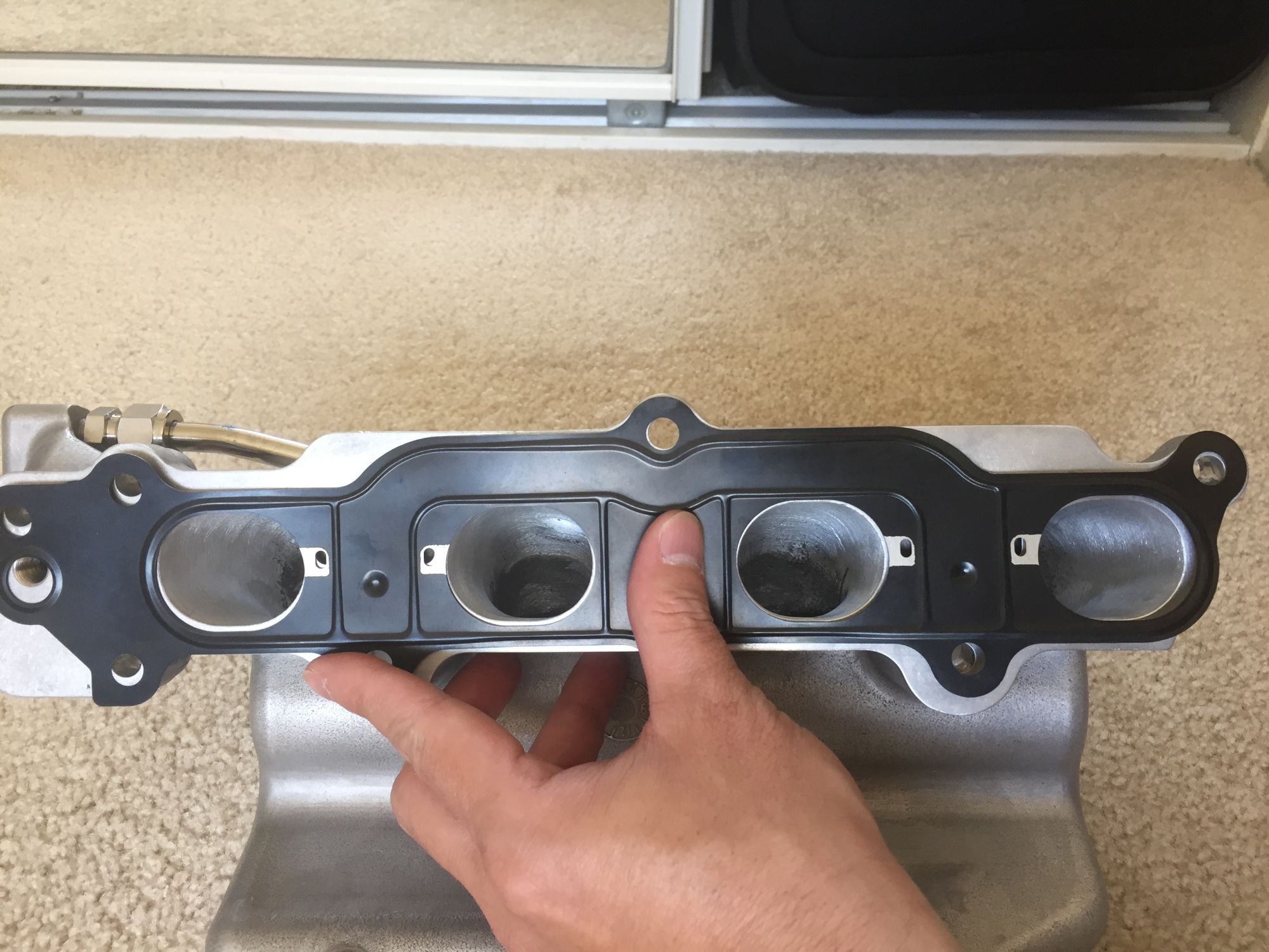

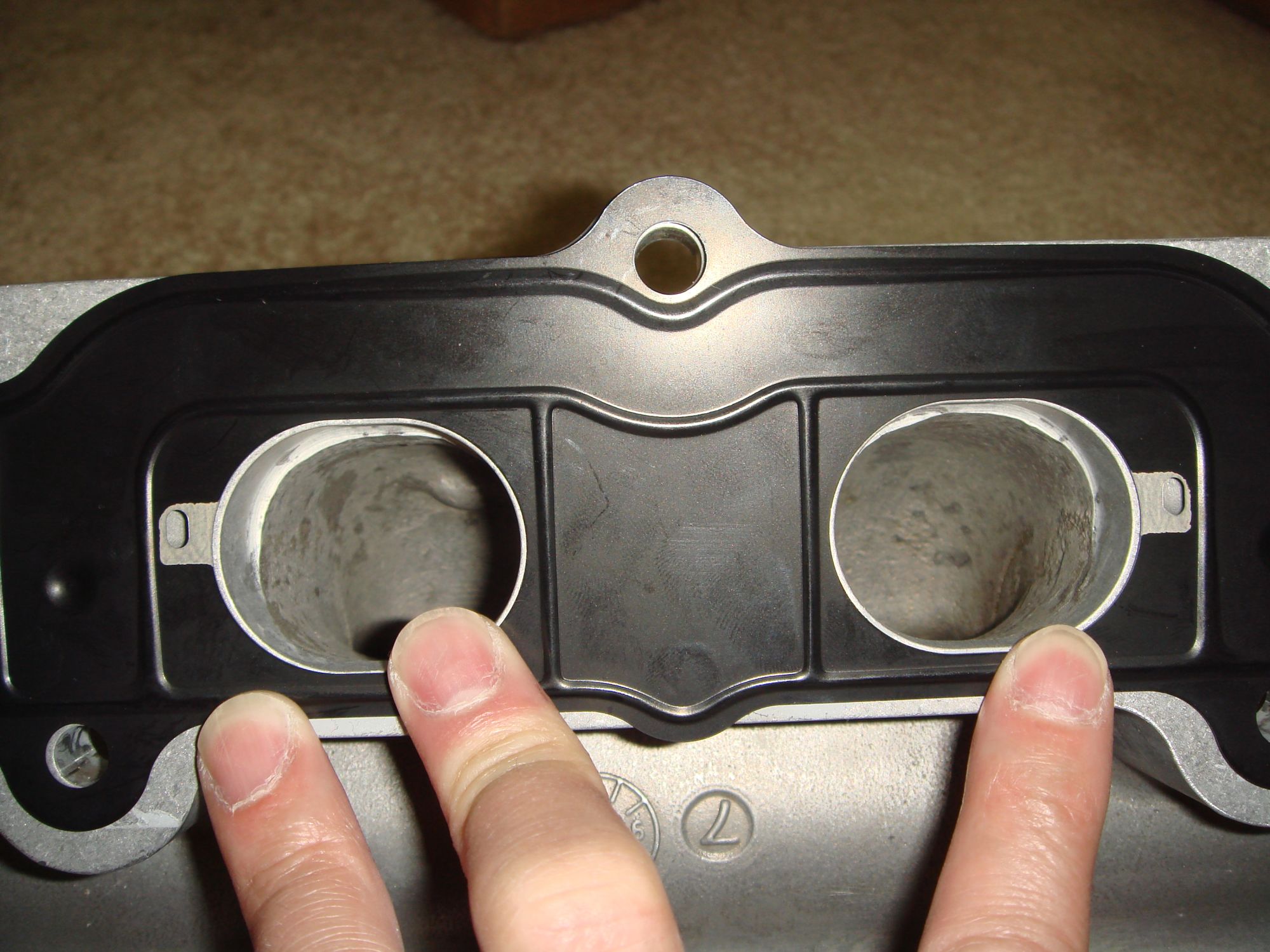

I might get to this pressure because I no longer have the restrictor on the intake elbow (just like yours right?) in addition I also POLISH the intake elbow.
I also had my throttle body bored out by maxbore, then port match with the intake elbow also by maxbore.
I do not have any 5th injector sticking into the intake elbow,
I also Port and also Polish the Sprintex lower intake manifold,
gasket port (enlarging the port) so it match the gasket of the engine block.
there are quite a lot of material that I took out from the lower intake manifold
here is the pictures of before and after:
and last,
I have a Mugen CR-Z intake airbox with the snorkel right behind the top plastic radiator cover where it have that slit opening that feed cold air from the front grill scoop.
so it must help give some kind of ram air effect there at top speed.
that is all I can think of why I manage to hit 0.65 bar...

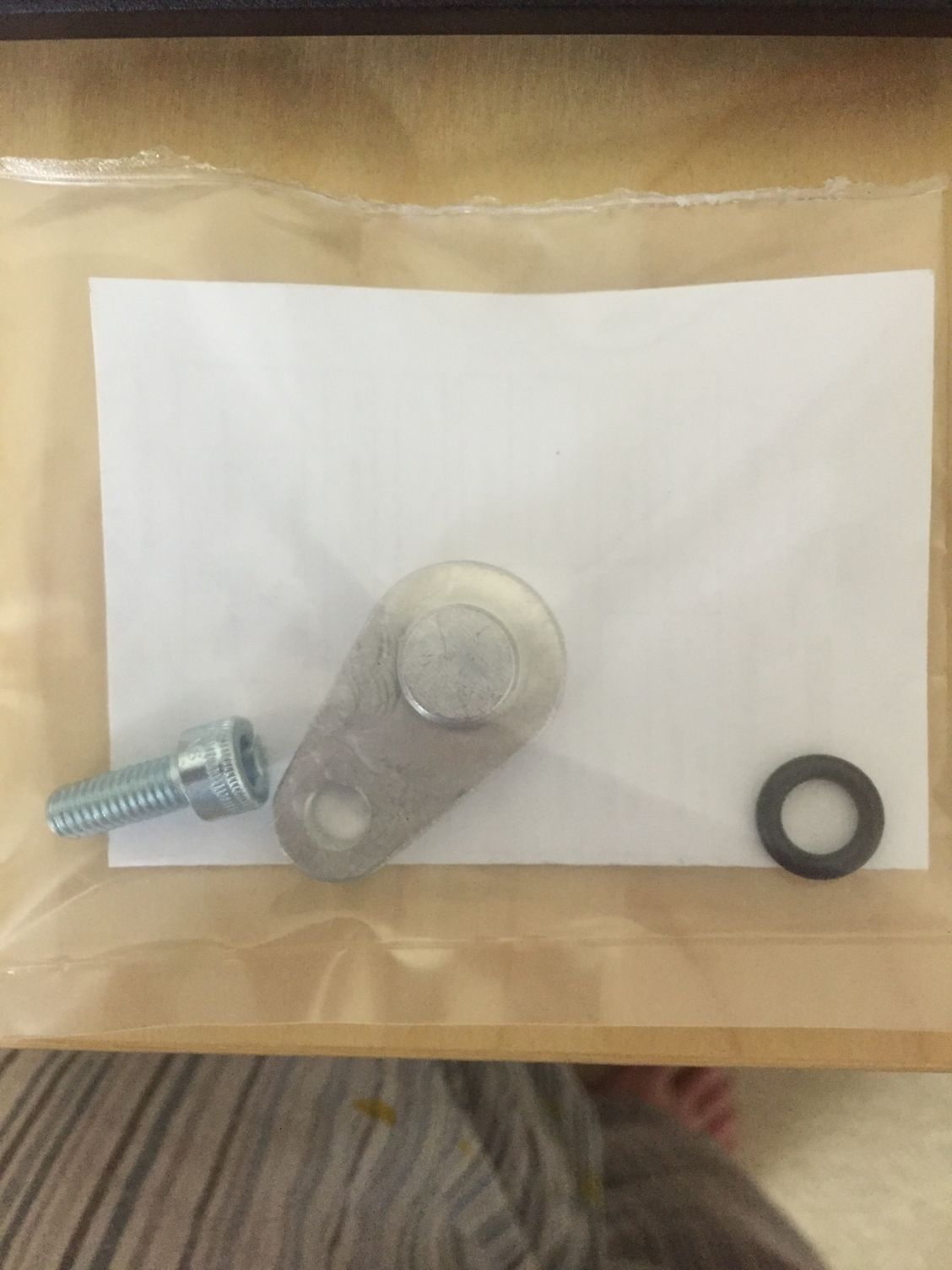

The Sprintex Original Blocking Plate that I order just arrived from Proreka Sprintex Malaysia by FedEx today.
This is the same parts that came with hardware only kit and it fit better than my current modified K-Tuned MAP blocking plate.

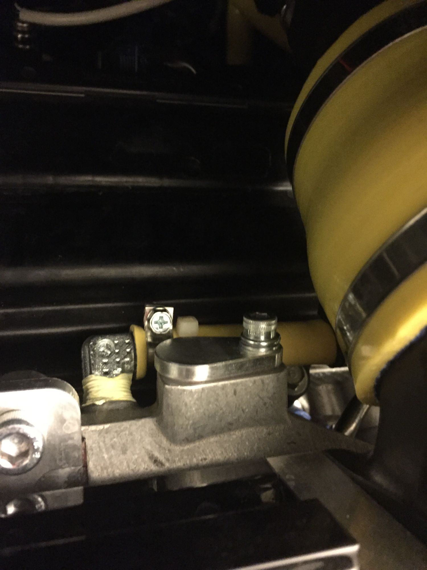

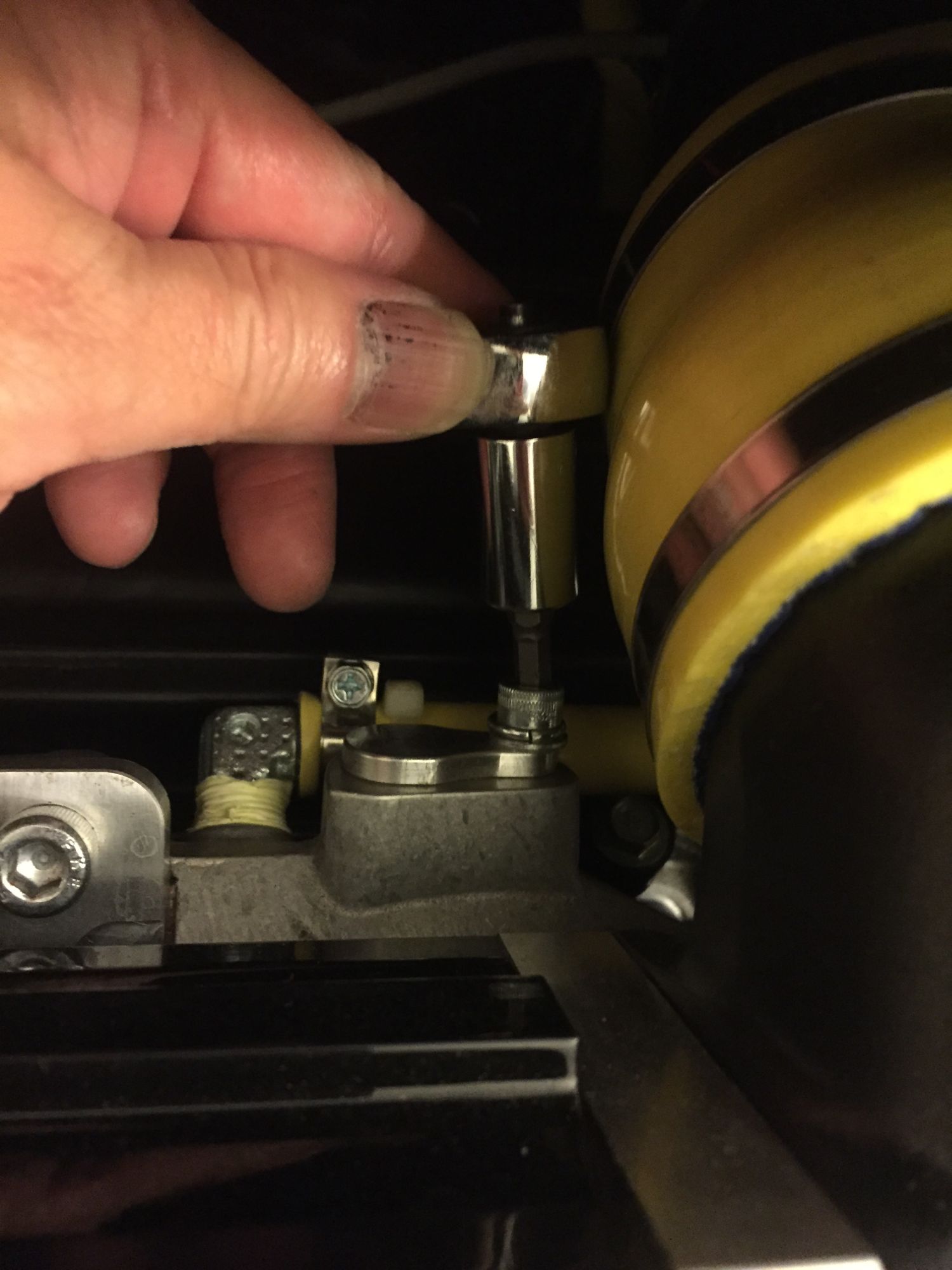

Sprintex Original MAP Blocking Plug install,
It feel and fit more snug, also it have much larger body so it cover almost
all the of the flat face on the MAP sensor opening better which should help
prevent any micro leak better.
Before with K-Tuned MAP port plug:
After Sprintex OEM MAP Blocking Plate:
Of course as usual, I apply Toyota Rubber Grease on the O-Ring before install to make sure they are not teared, then use little bit of loctite and also locking ring on the bolt to make sure they won't get loose with vibration from the supercharger

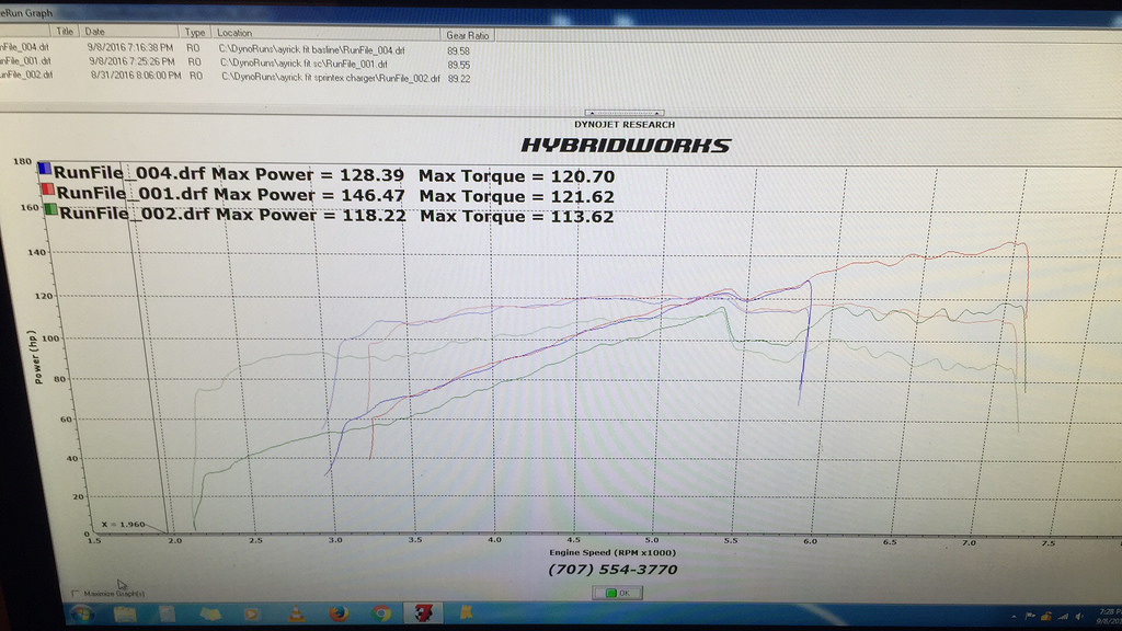

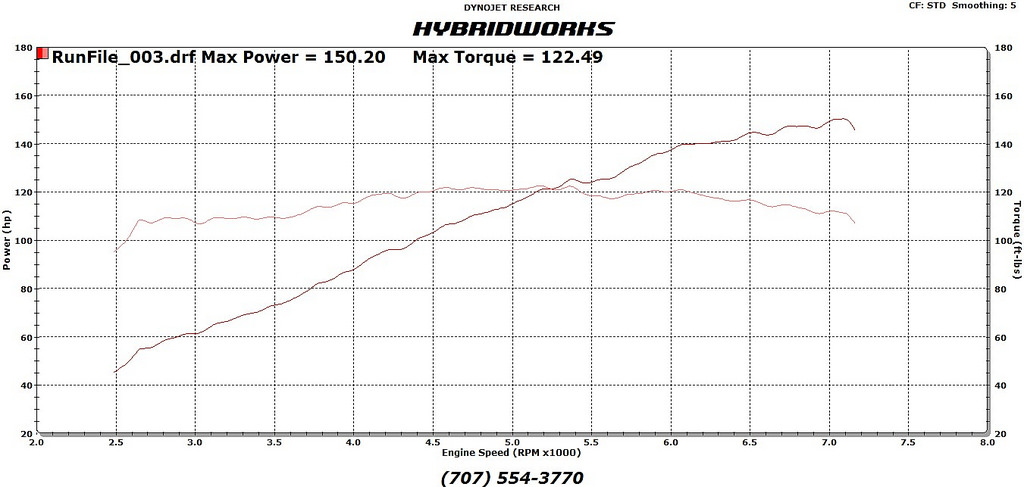

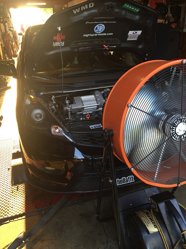

118/113 is from last week when i went to get some dyno pulls to see how my etune would do on a dyno.
150/122 was the final.

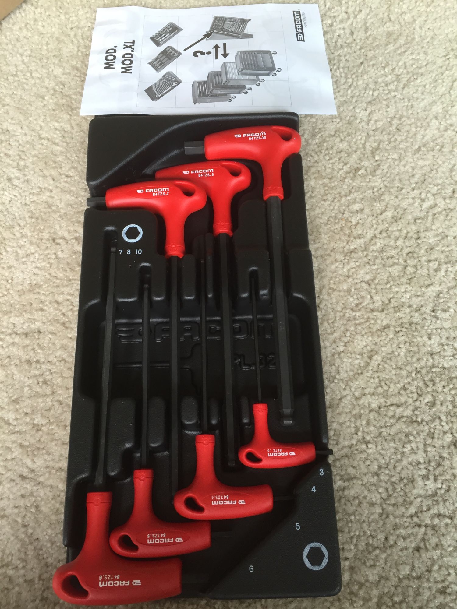

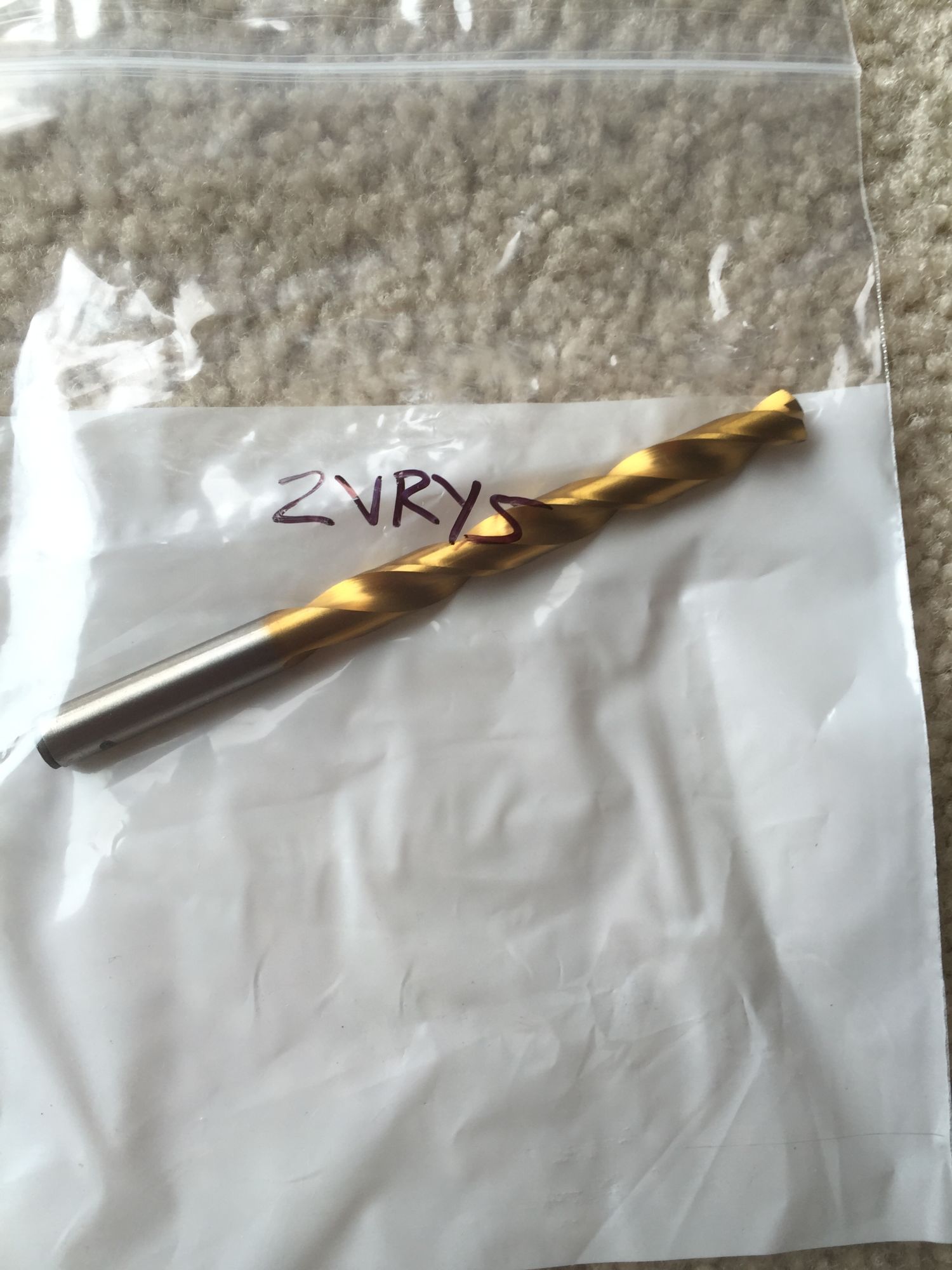

I bought this long FACOM (Made in France) Round Hex tools because I worry I will scratch my black paint on the Sprintex Supercharger, I will need to take out some of the hex bolt because I need to fix my Big 3 wiring and the bracket for it is attached to the 3 round hex bolt on the Sprintex...
I also bought this drill bits together with the Facom tools above so it qualify me for free shipping...
this drill bits will be used to drill the Sprintex Intake Elbow and tap the thread needed for the Aquamist Injector
someday when I bought the Aquamist Water/Methanol Injection System
oh,

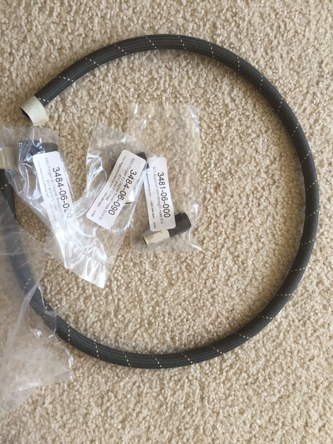

I always feel the fuel line supplied by Sprintex is kinda flimsy, especially the fitting (which I manage to broke the clip)...
so I order a Goodridge 910 Aramid Fiber (Kevlar) lightweight hose along with Goodridge 811 FORGED Fitting both in 6AN size that arrives today
