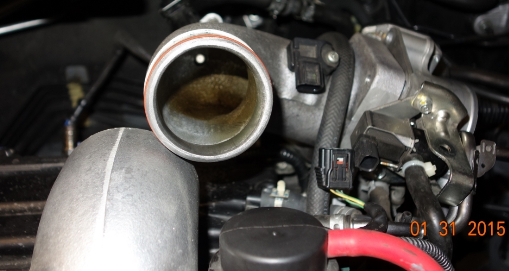

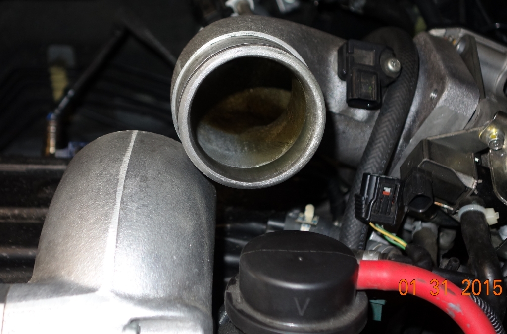

I installed the orange silicone o-ring this morning. There are no more leaks from the inlet. Every time the inlet is removed I will replace the o-ring. High short term fuel trims at idle is one symptom of inlet pipe leaking. My short fuel trim at idle with a leaky inlet pipe was around 46.
This is a picture with the Harbor Freight o-ring. The Harbor Freight o-ring has been stretched so much that you cannot see it any more.
Hi Steven,
Where did you bought the BS229 O-Ring from?

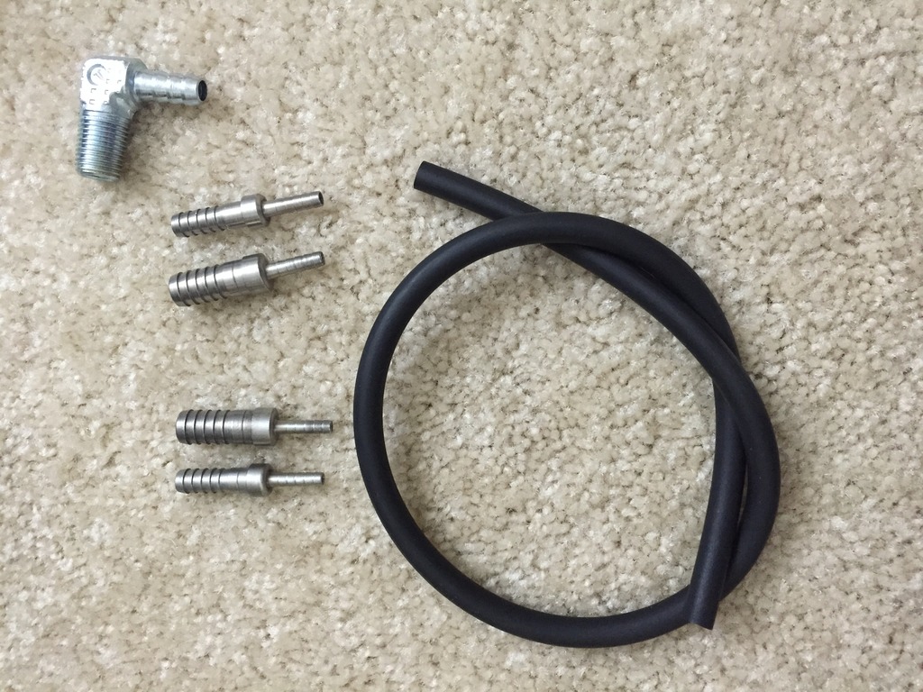

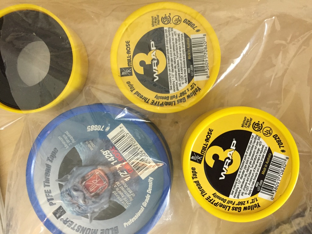

I just bought a Hose Barb Reducer because I realize
the Forged Steel Adapter Fitting 90 Deg 1/4 BSPT BSP Male - 5/16" Hose Barb C12-2
Kinugawa Barb Fitting that I bought have 5/16" Barb Outside Diameter,
while my Defi Turbo Boost Gauge hose is only 4mm Internal Diameter.
so I bought 4 type of Stainless Steel CNC Machine Reducer,
because I don't really sure which size will fit better since their sizing
is not exactly 5/16" nor 4mm...
turn out the right reducer is the 5/32" vs 3/8"
I also bought some industrial grade Teflon Tape.
Here are the pictures:

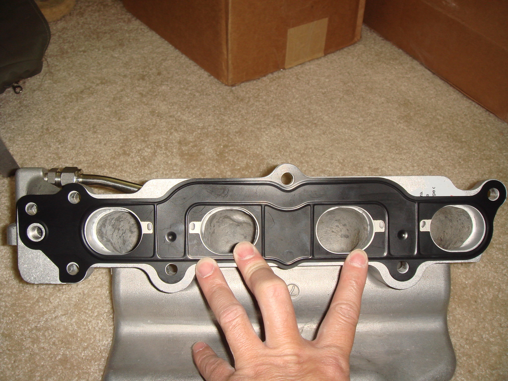

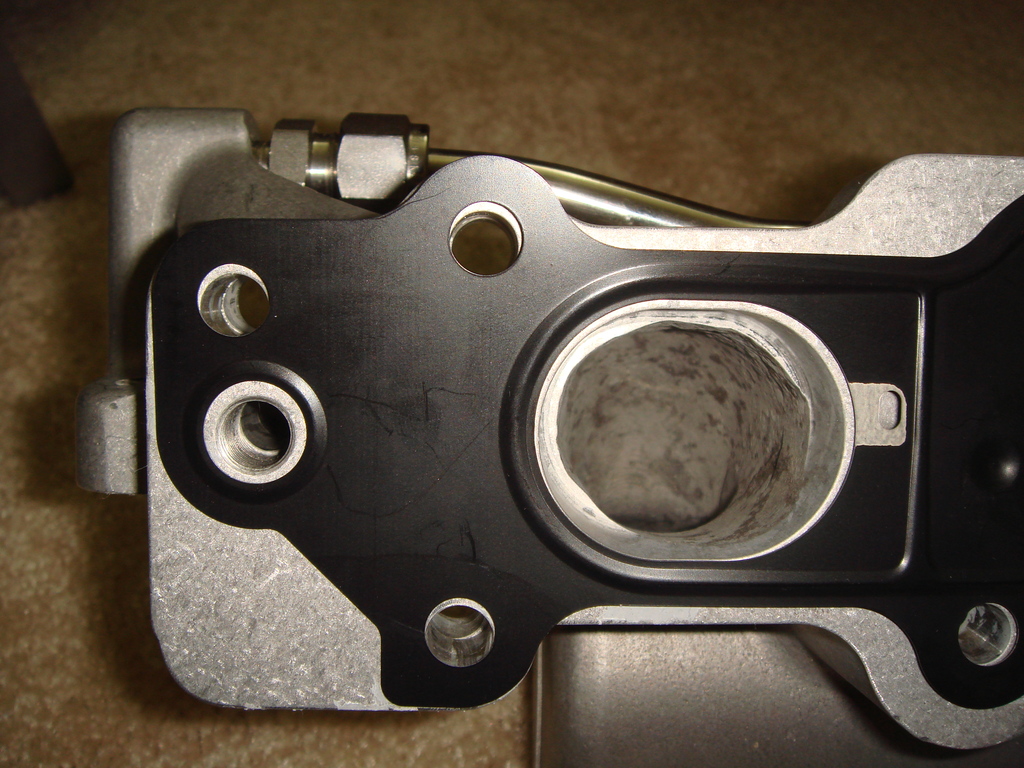

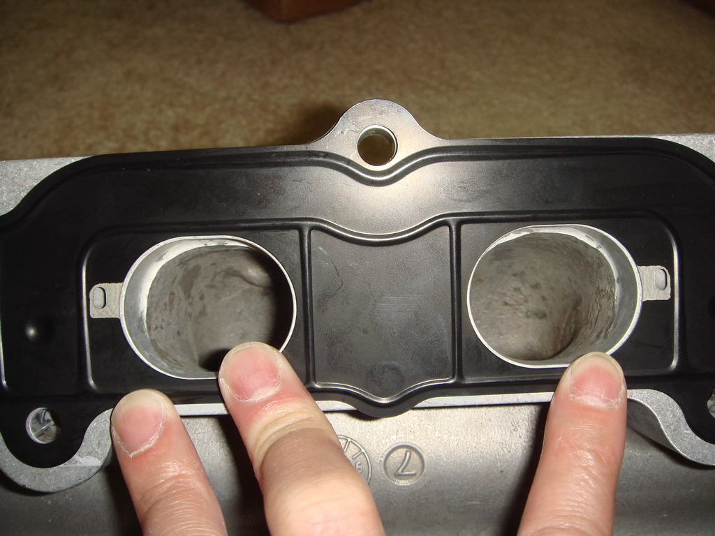

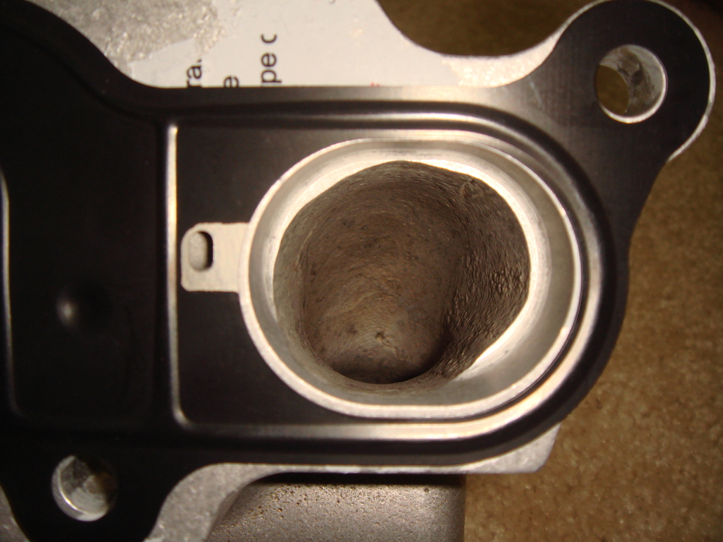

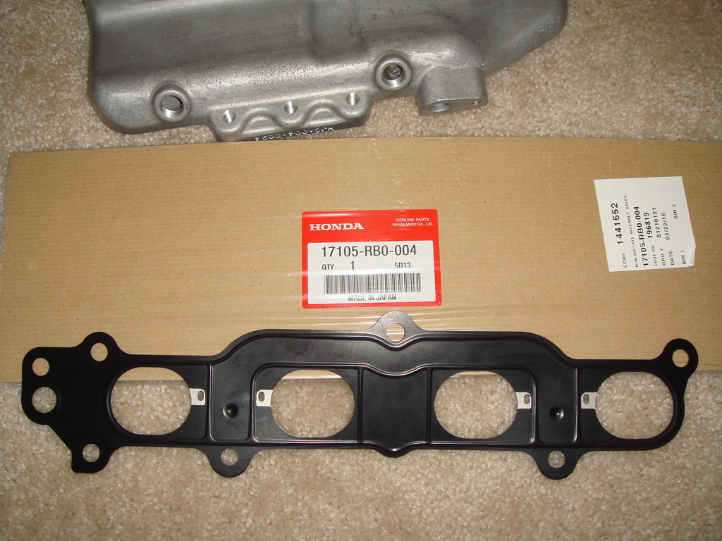

My Intake Manifold Gasket just arrived,
so I can compare the diameter of the gasket
vs. Sprintex Intake Manifold Outlet.
It looks like the left and right outlet had more material
to be ported,
while the 2 center one have less material to be ported.
Still undecided which porting service I would use...
will do more research before I decide...
