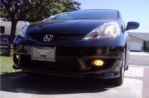

I had just put the yellow vinyl over my fogs.

got any pics?
Is it special vinyl so it doesn't burn or discolor?

I believe it is lamin-x film. I'm not too sure.

Looks good...nice job

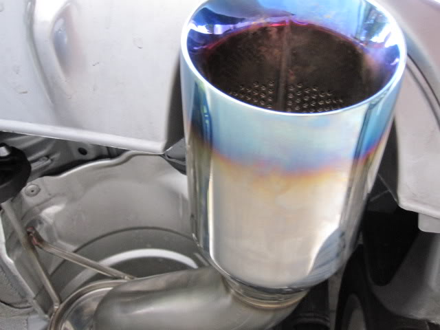

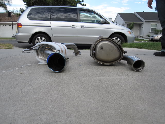

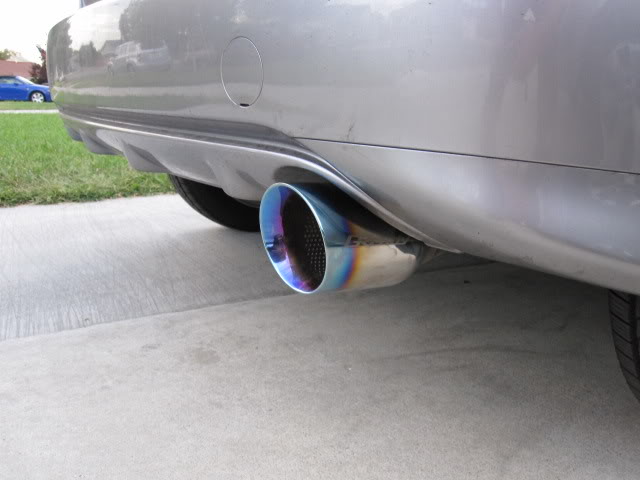

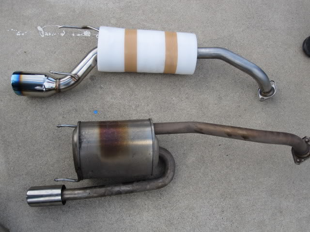

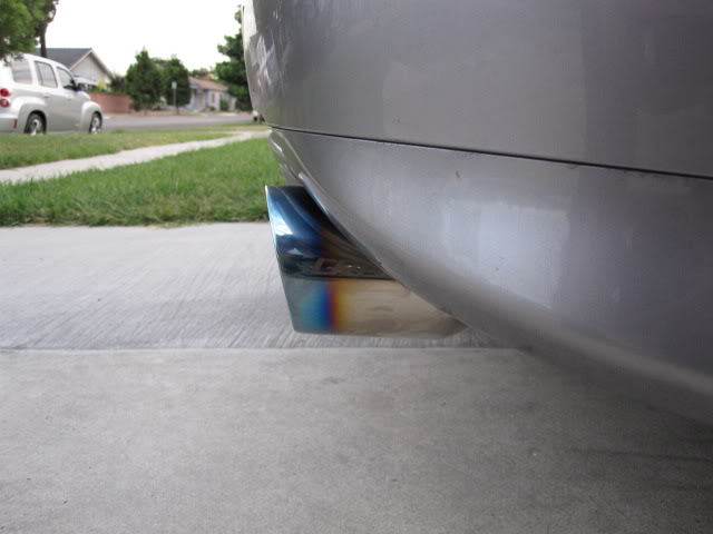

the defi gauges will be installed sometime next week i hope, juss need a few more things for the install but here is the exhaust which i installed today as well:
SE vs. Stock:

on the fit:

i was going to do a install write up but w/ pics but it is pretty easy.
so here is a quick write up:
1. raise the back right of the fit and remove the wheel
2. unbolt the stock exhaust (12mm)
3. remove the stock exhaust from rubber hangers (leave the rubber hangers on the car)
4. put the SE exhaust on the hangers
5. bolt the SE to the mid-pipe (will need extened 12mm & normal 12mm)
hope that helps

awesome exhaust looks really good
