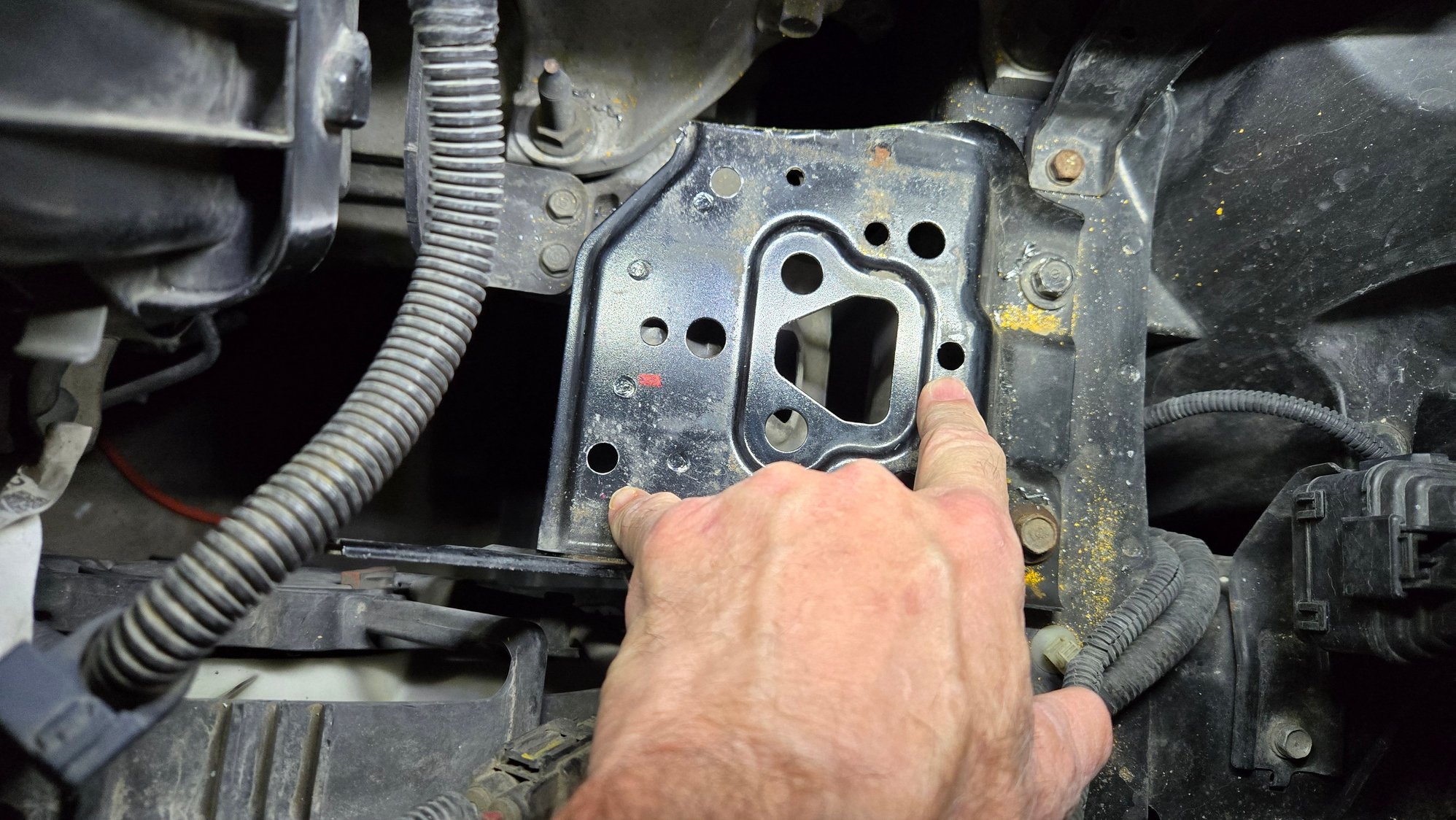

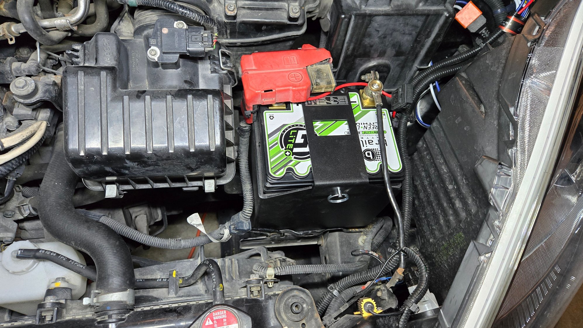

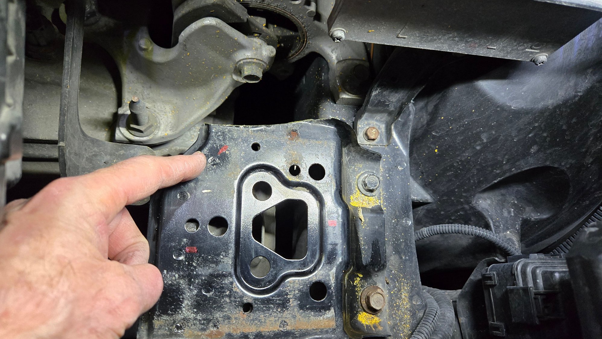

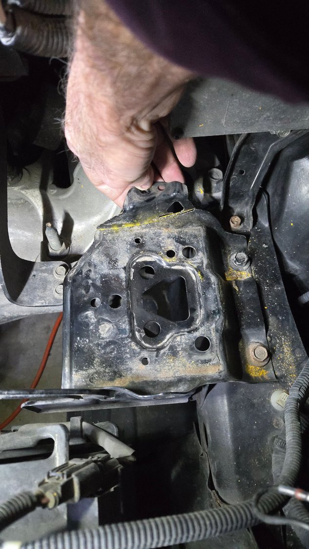

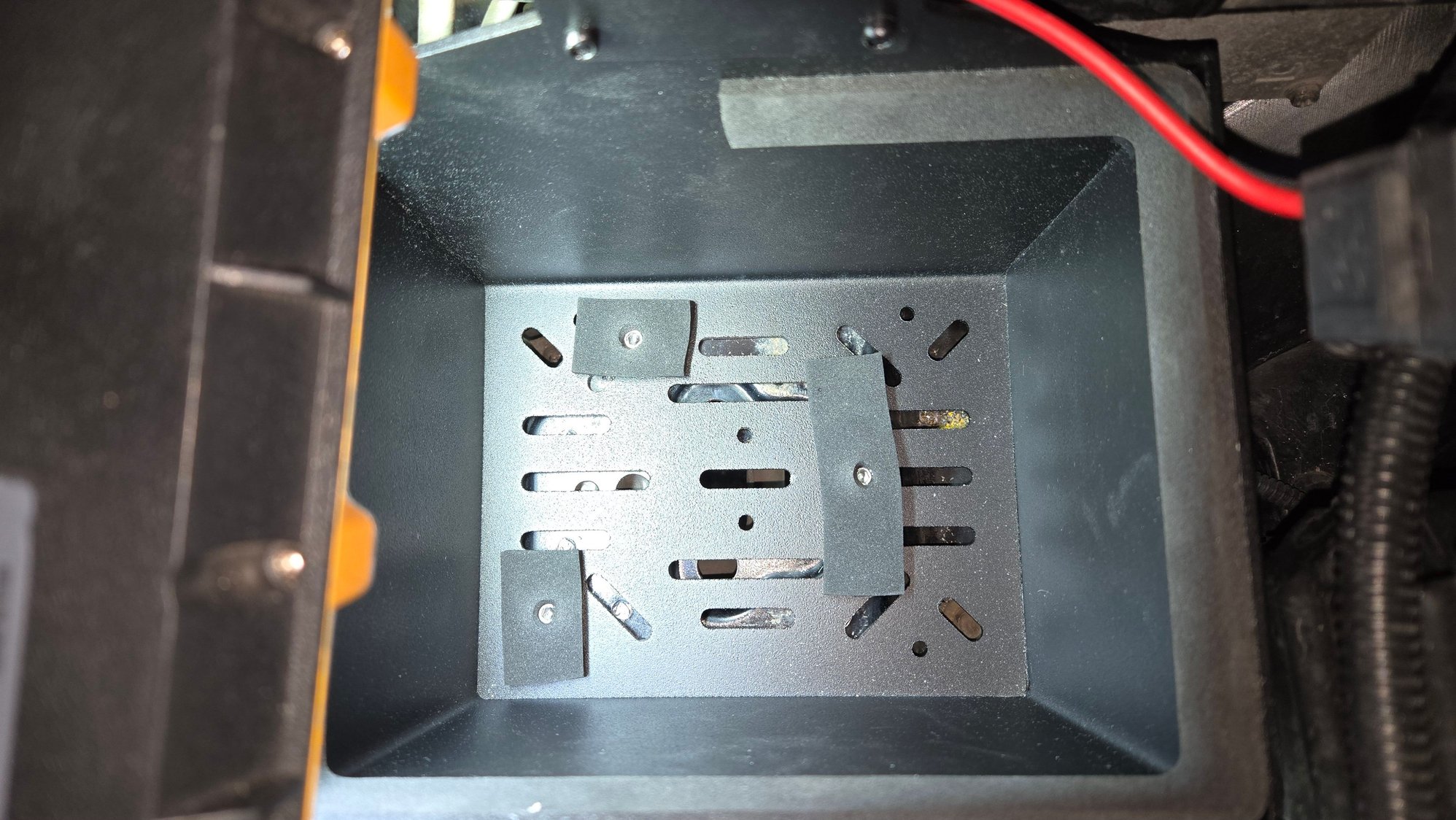

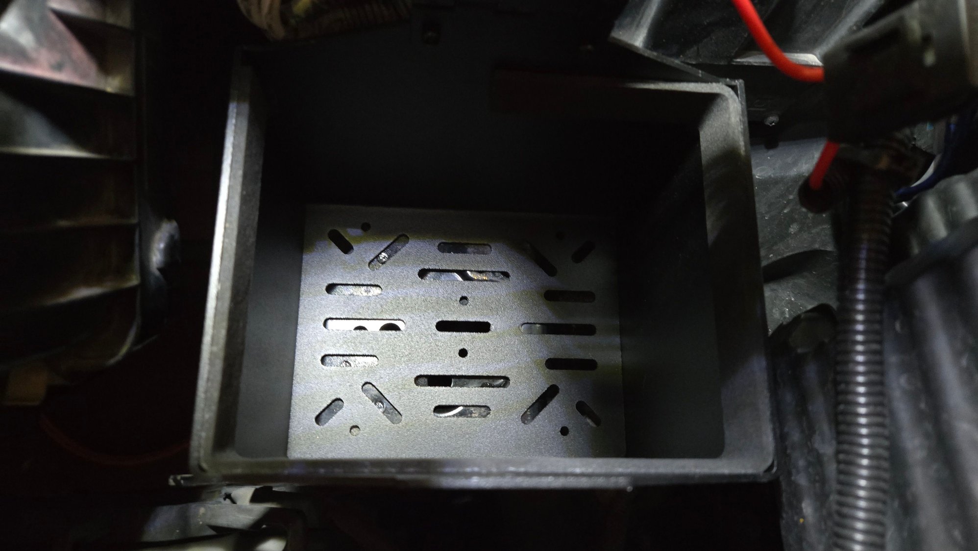

Braille G30 battery + MeLe ATX 30 battery mount.

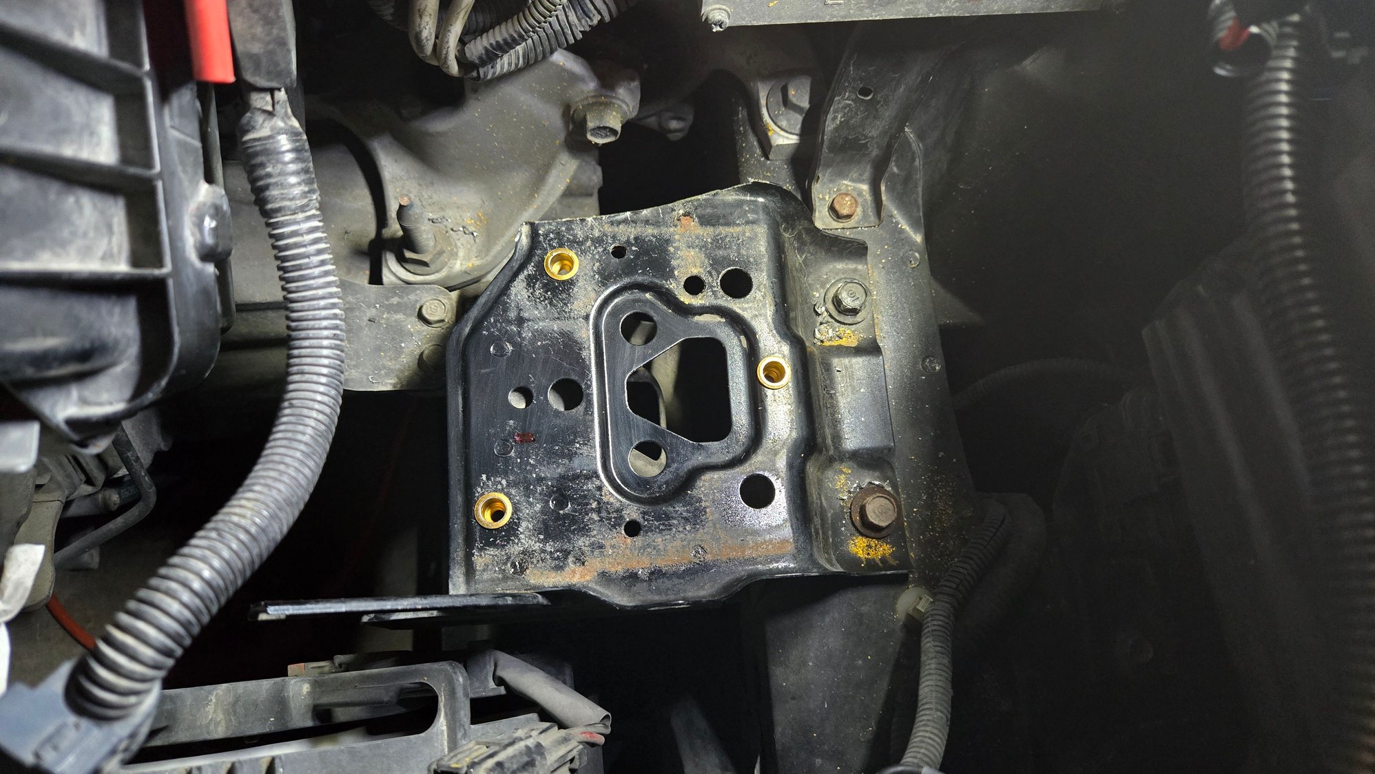

Tab that was removed from OEM bracket
Locating spots to place RivetNuts
Marks for hole location for RivetNuts
3/8" drill bit with M6 RivetNut
The 3 holes I drilled. 3rd hole is at the top left corner of the bracket - lighting makes it hard to see.
RivetNuts placed.
Bolting in the MeLe mount.
Done! Almost...
Placed rubber cushions to mitigate spot-wear of the Braille battery.
I ran into one more issue...
The battery positive terminal sat too low, and the (+) terminal clamp would not effectively attach to the battery. So placed a bunch of washers to raise the (+) battery terminal so the clamp would attach firmly and clear the MeLe mount hold-down. It's solid now.
Finished!
I inadvertently bought the wrong kind of Braille G30 battery for my 2014 Ford Fiesta ST.
Summit Racing would not take the battery back.
So I decided to make lemonade out of lemons after talking with Mitch at MeLe Design Firm to see if he might have a mount that would fit into my 2009 Fit. I took some measurements, sent them to him and he suggested the ATX 30 Rally Spec battery mount.
Series if pics shows mounting the Braille battery in the battery mount in the Fit. Had to trim a tab off the back part of the OEM bracket after removing the bucket. Drilled 3/8" holes in the bracket and used M6 RivetNuts to hold down the new mount. Overall, a pretty easy install and it removed over 15 pounds from the front of the car.

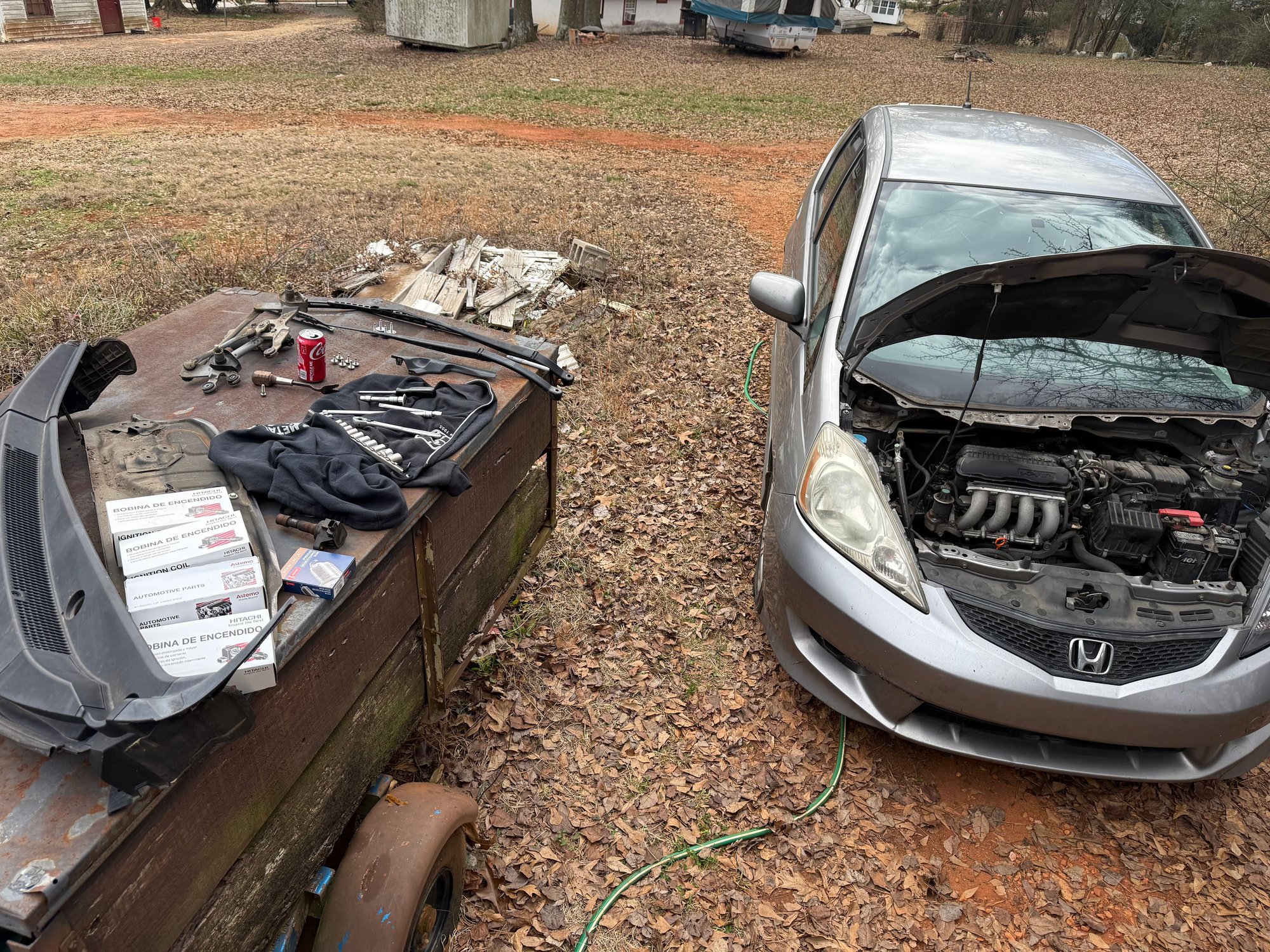

So the week before last, I decided to use the legendary words of "watch this" when launching the GE8. This was out of curiosity of how much tracción hop the recently installed Hasport 70A torque arm mount reduces...
The outer CV joint decided against it and exited the chat. So I had a local friend help me flat tow the car to work and ordered an axle from Rockauto that day.
Fast forward to last Saturday, I disassembled the vehicle to access and replace the axle. During which time various rust ridden bolts and sensors were either snapping or firmly corroded in place. At which point, I promptly became peeved and chucked a few goods that I had collected over the years.
With it all said and done, the passenger axle is replaced... along with the front struts (Bilsteins, already had Swift lowering springs)... and the knuckles (2016 CR-Z)... and front brake calipers (Hyundai Genesis Coupe Brembos)... and StopTech pads from a FK8 Civic Type R... with 3 row Nissan Rouge front rotors.
Brakes are overkill for the car at this time BUT I needed it off my lift at work and didn't feel like spending cash that day.🙃 also tossed on my CR-Z's secondary wheelset that I use for autocross up front. 17x8 Enkie TS-10s with 6mm spacers to clear the calipers wrapped in some old 225/45R17 Bridgestone RE71Rs.

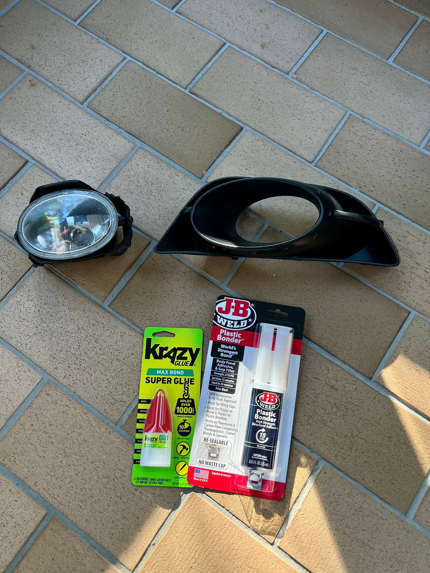

I fixed my fog lamp housing after 6 years of it being broken and not attached to the car.
more pics: https://www.fitfreak.net/forums/2nd-...m_content=post

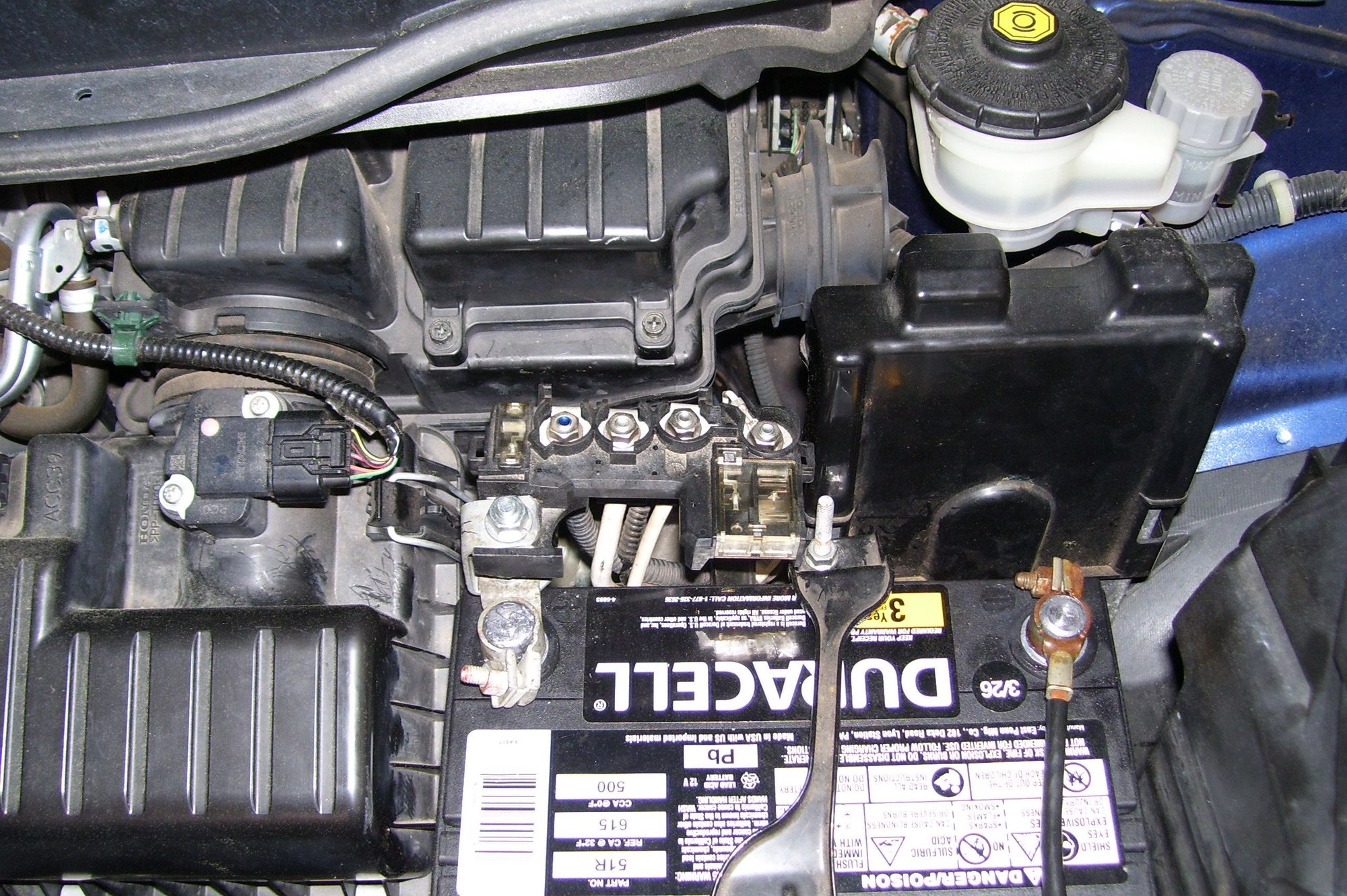

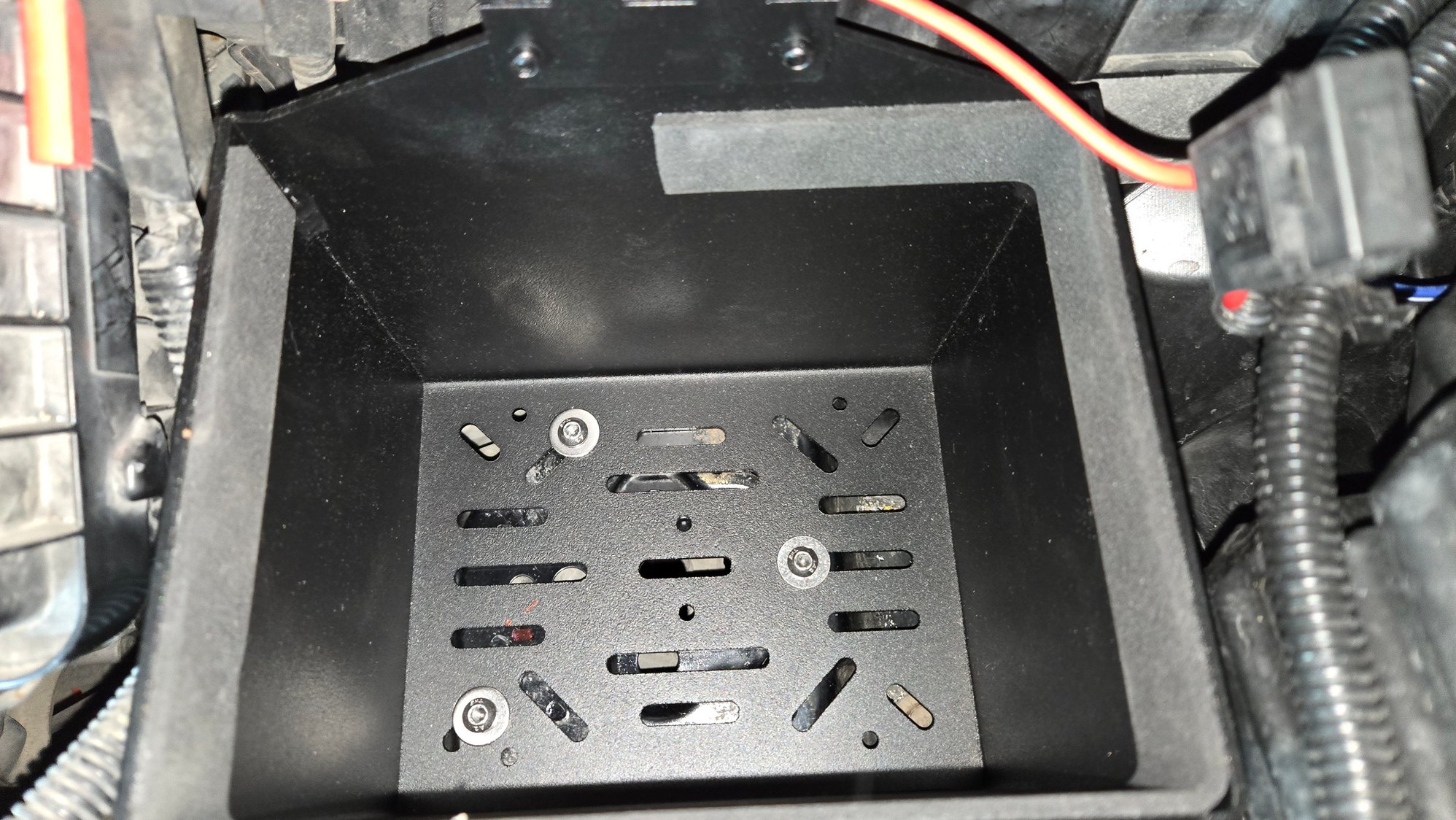

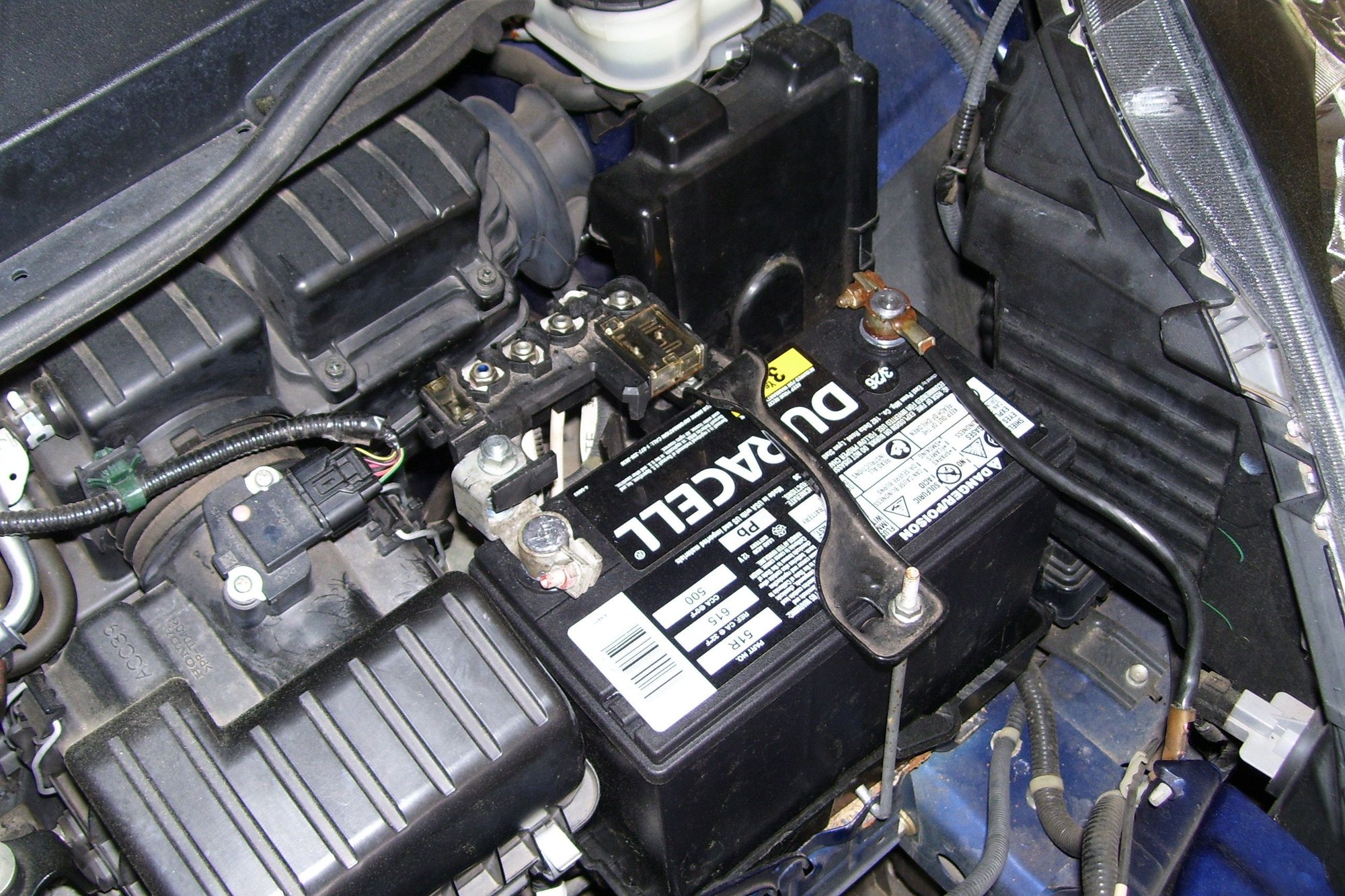

Upgraded Battery
After my OEM Honda battery (purchased in 2016!) conked out last month, I decided to install a larger battery. Trolling previous forums, I purchased an Amazon battery tray and a Duracell 51R battery. With a little trimming/modification of the tray, and the positive terminal clamp, it's a snug fit, but looks almost OEM! More CCA than the OEM, but the OEM warranty was 100 months, whereas the Duracell is only 3!!
Trimmed the plastic housing for the positive terminal clamp & rotated it ninety degrees, as there wasnt enough room with the bigger battery.
Trimmed the plastic housing for the positive terminal clamp & rotated it ninety degrees, as there wasn't enough room with the bigger battery.
Constructed a
Constructed a "C" connection to restore the power connection to the rest of the terminal block
The cover no longer snugs down over the clamp, but covers the rest of the terminal block. Snug fit, but almost looks OEM!
