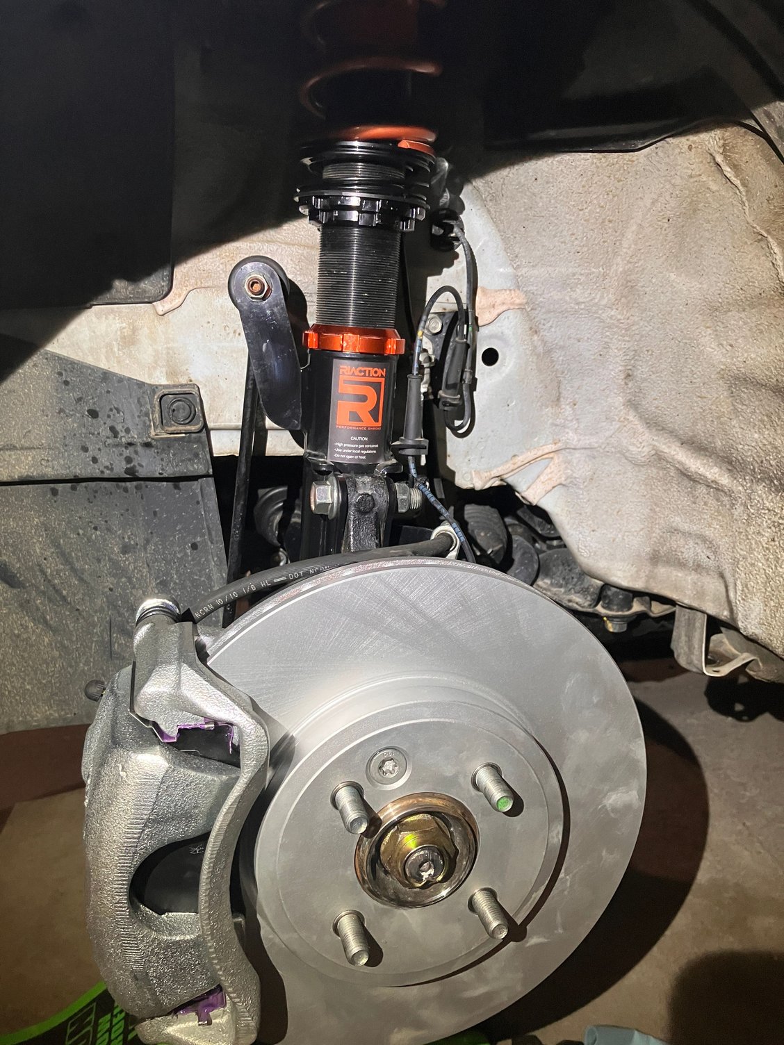

Did the ITR big brake upgrade on my GE8, I'm a little OCD so I wanted the retaining screw for the Mini Cooper rotors. The screw is an M10x1.5 and you can use an 8.5mm drill bit with an M10x1.5 tap. You need to counter sink the screw hole a little so the retaining screw can properly seat, I used a 3/4" drill bit to do that. Side note, tried installing stop tech stainless braided lines and the mounting bracket where it attaches to the hard line is completely incorrect. What the heck stop tech? Can anyone recommend a brand that actually fits?

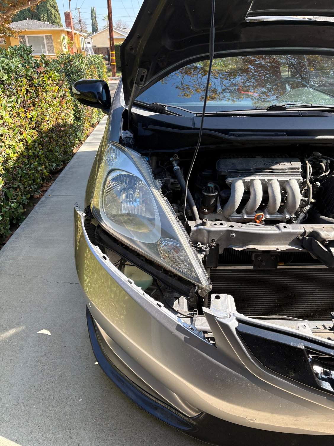

JDM headlights in! Still need to fine tune the fitment and work on the turn signals but my previous rewiring has the parking lights as the turn signals so I’m just without parking lights currently which is fine haha.

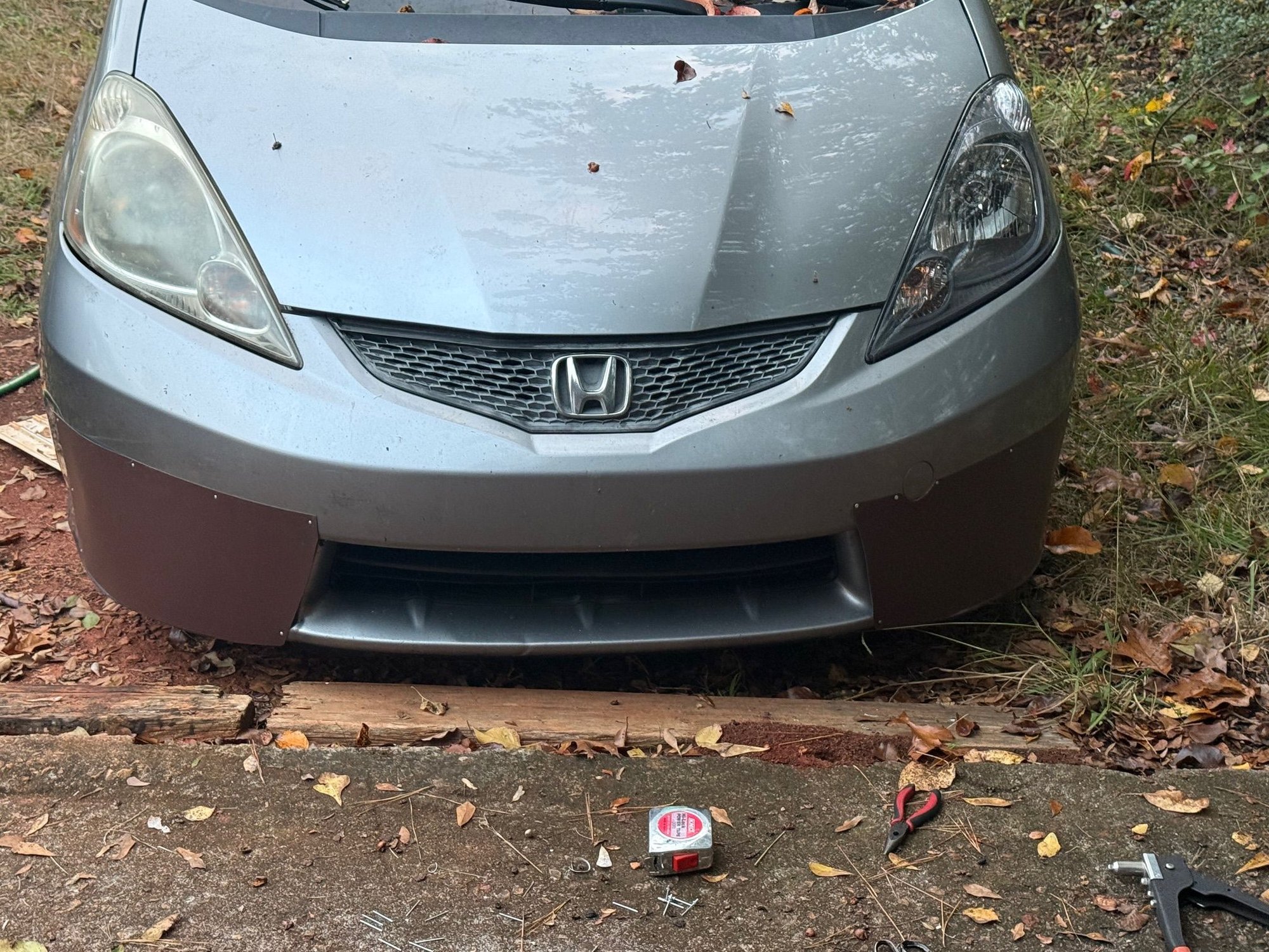

Here's what I did to mine today lol.
found a roll of what was probably used as shim stock of my dad's in the shop, it's 0.013" thick, so very light, figured what the hell... cover those big holes from the fog lights getting busted out when my brother hit some animal. I'll likely eventually replace the bumper cover later on down the road anyway once I get caught up on some things.
