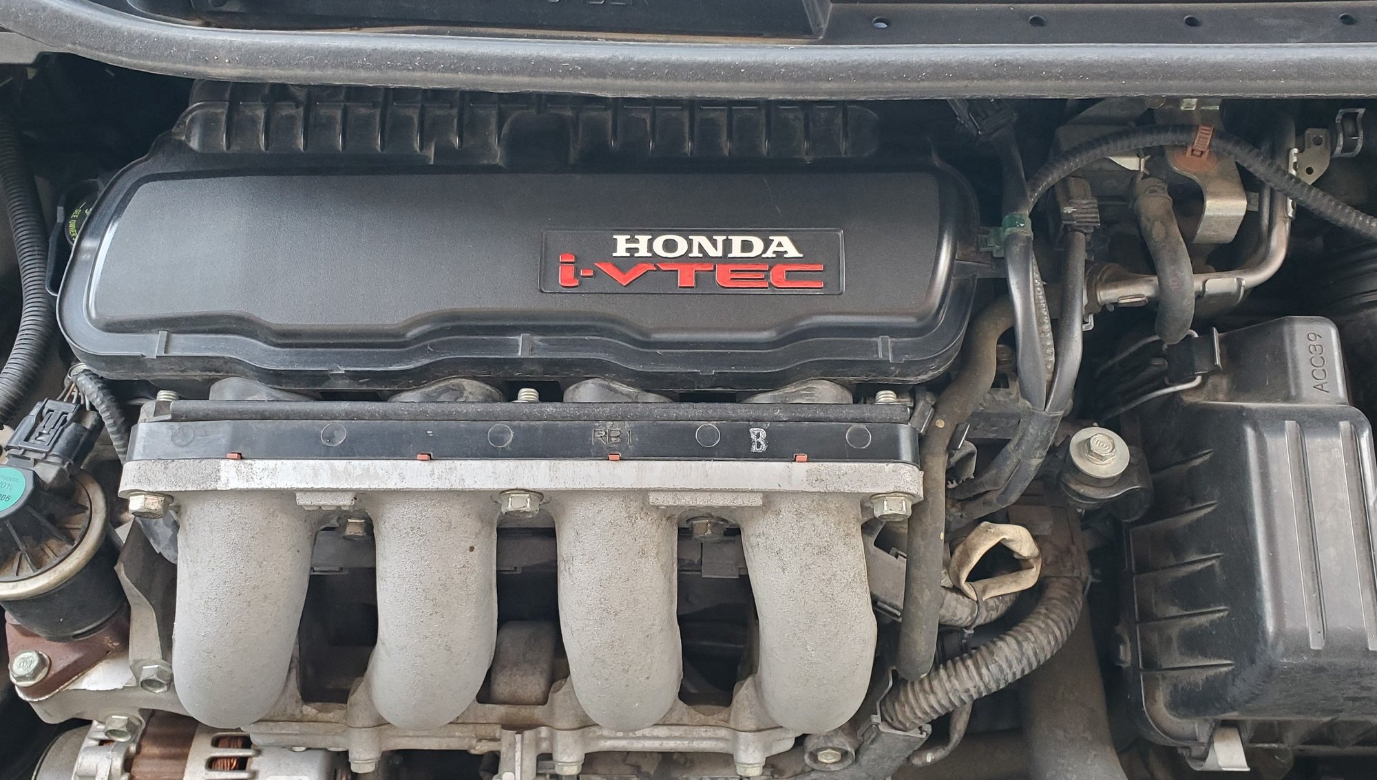

Just bought an 09, with 83,000 miles on it , $5,000. Has some cosmetic damage: rust around right wheel well, top all covered with pine pitch and it needs a new O2 sensor (got a Bosch and will install this weekend)
this is my 2nd Fit Sport , first one was totaled by a guy running a stop sign , whom then pushed me into a brand new Honda Civic (also totaled).
anyways, car isn’t bad. Really wanted another standard but all the ones I found were too expensive or had 175,000-200,000+ miles.
should I also check the spark plugs or just assume they’re good. Seems like a real PITA to do? Car is running fine.

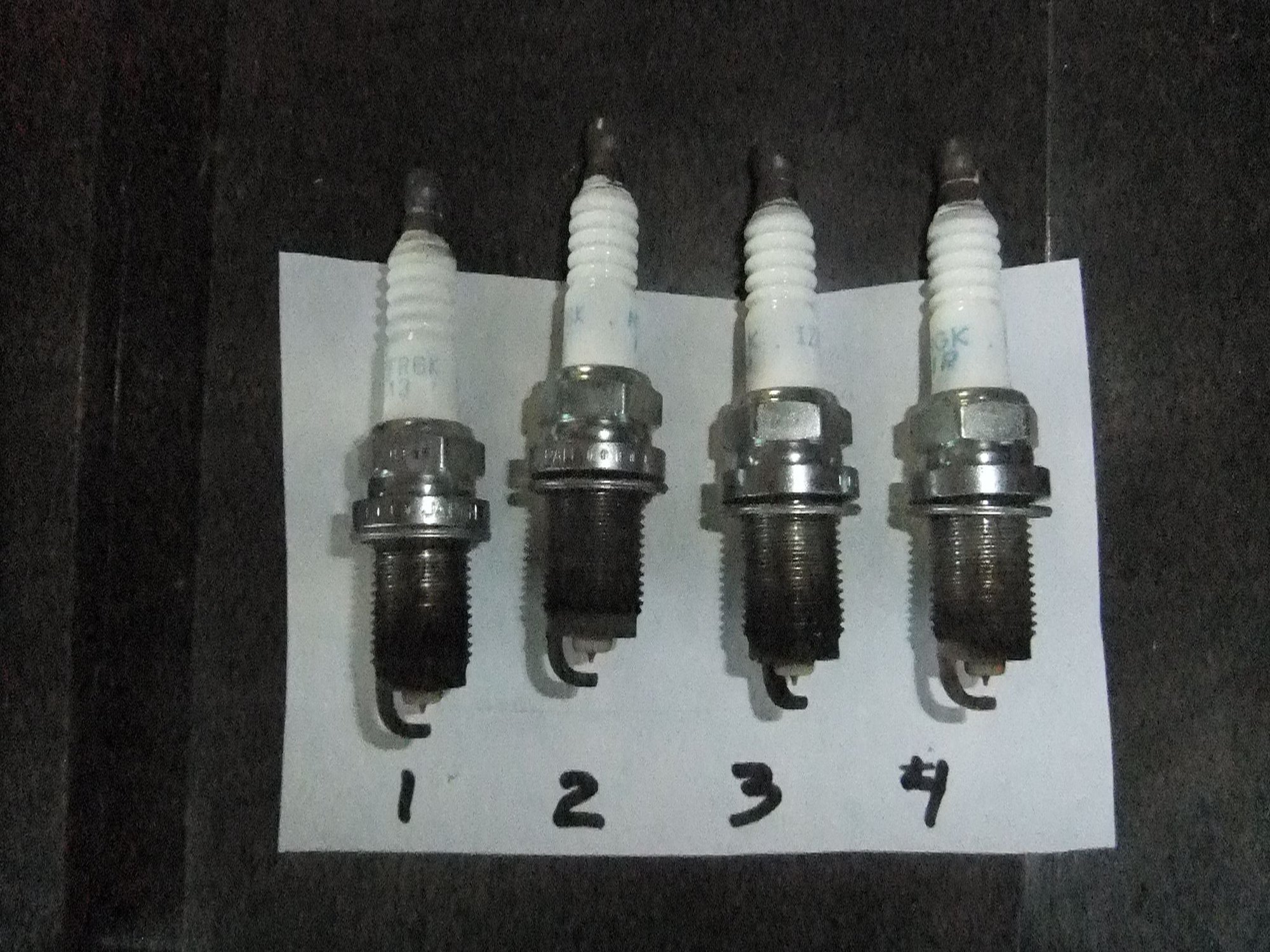

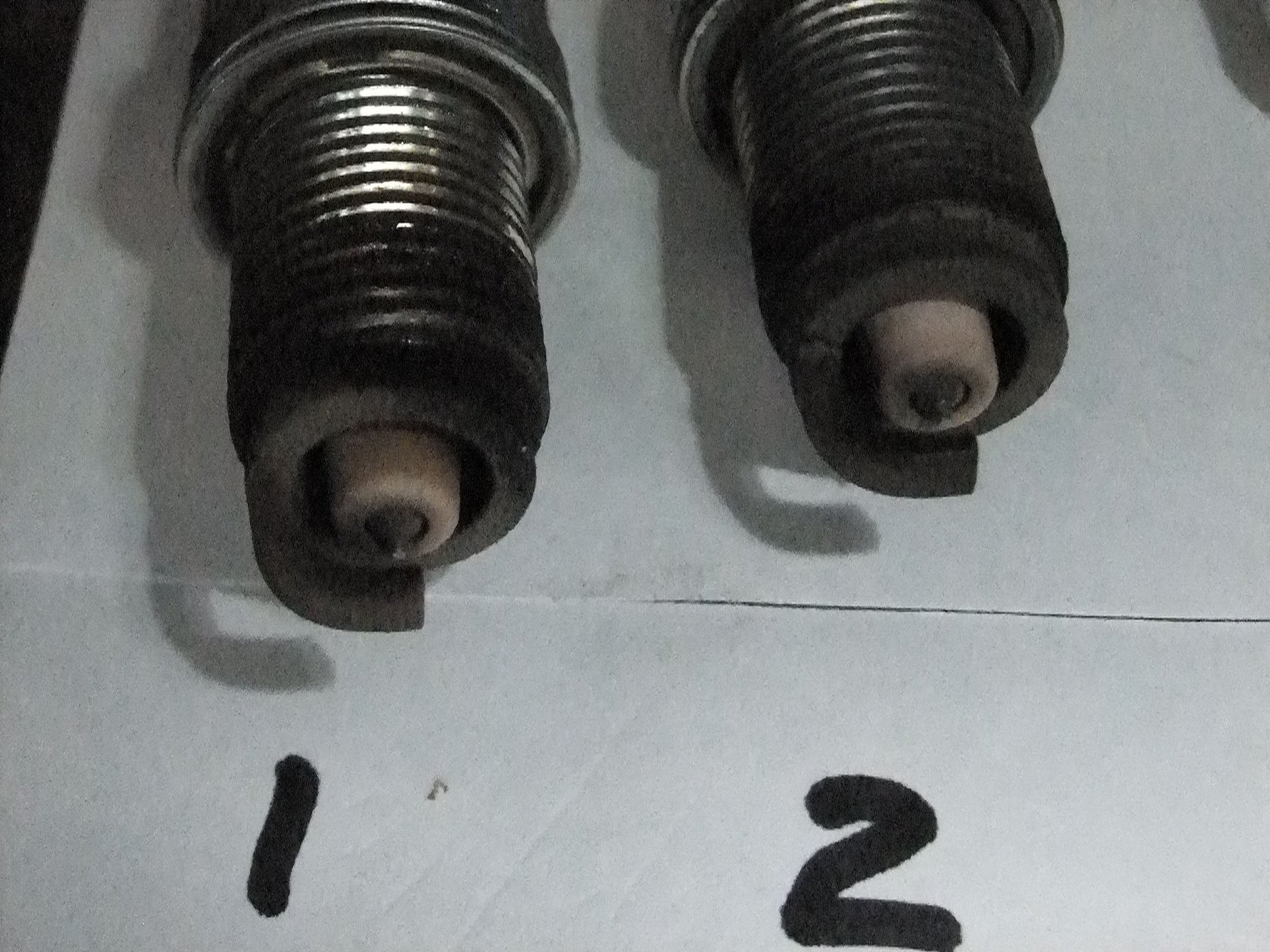

Leave the plugs alone.
I think the plugs are due around 100,000+ miles. I'm too lazy to check right now.
I replaced the plugs on my wife's 2009 Sport at 140,593 miles and they looked like they could go another 20K+. Just a little soot, but no oil and the gaps were still close to factory specs.
I replaced them with Denso SKJ20DR-M13 plugs and the car has been running fine for 37,000 miles now.
You're right. Changing the plugs is a PITA. Not hard. Just time consuming, considering all the stuff you have to remove just to get to them. Make sure you replace yours with IRIDIUM plugs. Worth the extra cost. None of the other choices last anywhere near as long.

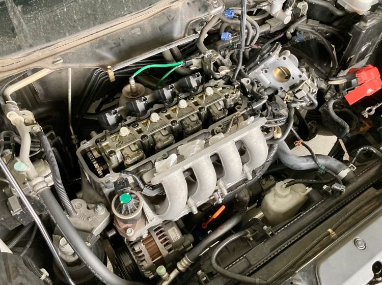

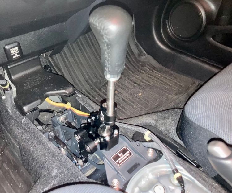

@@Pyts Thanks! Nice to see another Atlanta Fit driver 😊 Yes I should have shared photos, I don't have too many process shots but I'll share two I have.
Y'all are going to kill me but I'm covering the shifter with a boot. I'd done the Hybrid Racing shifter cable bushings and detent spring before, along with a clutch delay valve delete kit from Seb's Garage, so it's really fun to shift this thing!
The double-checking clearances was super tedious and repetitive but I'm glad I did it. Jim Misencik has another pro-tip in his video to put the feeler gauge under both valves on the cylinder you're adjusting to save time, but I didn't since knowing me I was worried I'd drop it in the engine haha...
Valve adjustment after cleaning the throttle body
Shifter height and rotation testing

Yes, often with Hybrid Racing shifters I see people leave them out and exposed. They're beautiful engineering but I personally don't want to leave it uncovered like that.
I originally did just a Buddy Club short shifter, later I came across advice to update the shifter cable bushings and detent springs too, which I did and it improved the feel and crispness. The new shifter was nice compared to the loose OEM one but I realized I wanted it to be further back and taller, so I'd been eyeing the Hybrid Racing one for a while.
My Hybrid Racing shifter is also covered with its boot as well. But such a well made piece can't go to waste. Only thing I've had to deal with is the base coming loose on two occasions and when I would put it in gear, it would bump the center console. I really torqued it down the last time and I hope it holds.
I can't wait till I have time to do the valve adjustment on my car, I feel like it will solve my often relatively poor fuel consumption. Thanks for sharing!

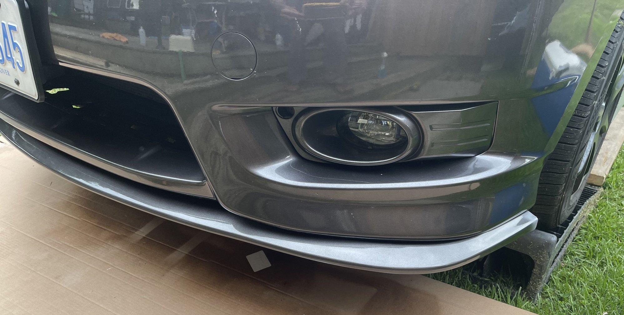

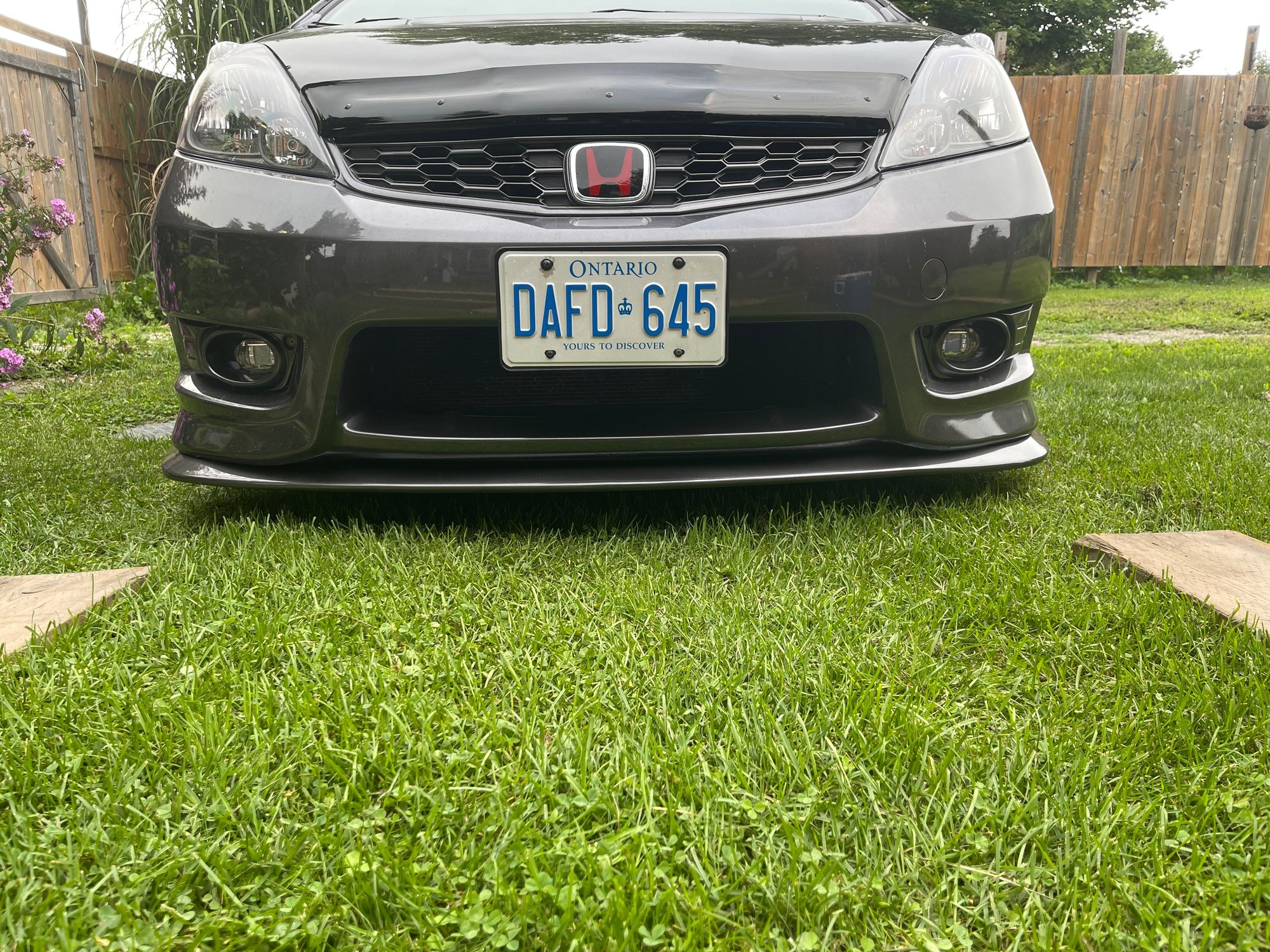

Lip..
I have seen mentions of a lip for the fit GE8...Seen this lip mentioned(06-07 SUBARU IMPREZA WRX STI - S204 FRONT LIP)...decided to give it a go..It was $95 CAD..
Had to trim ends...easy peasy..it fit like a glove...lined right up!
Used the supplied screws and it rock solid.
Good primer....2 light coats...then color match...then 2K clear...if you want it to last and be durable 2K clear is a must!
