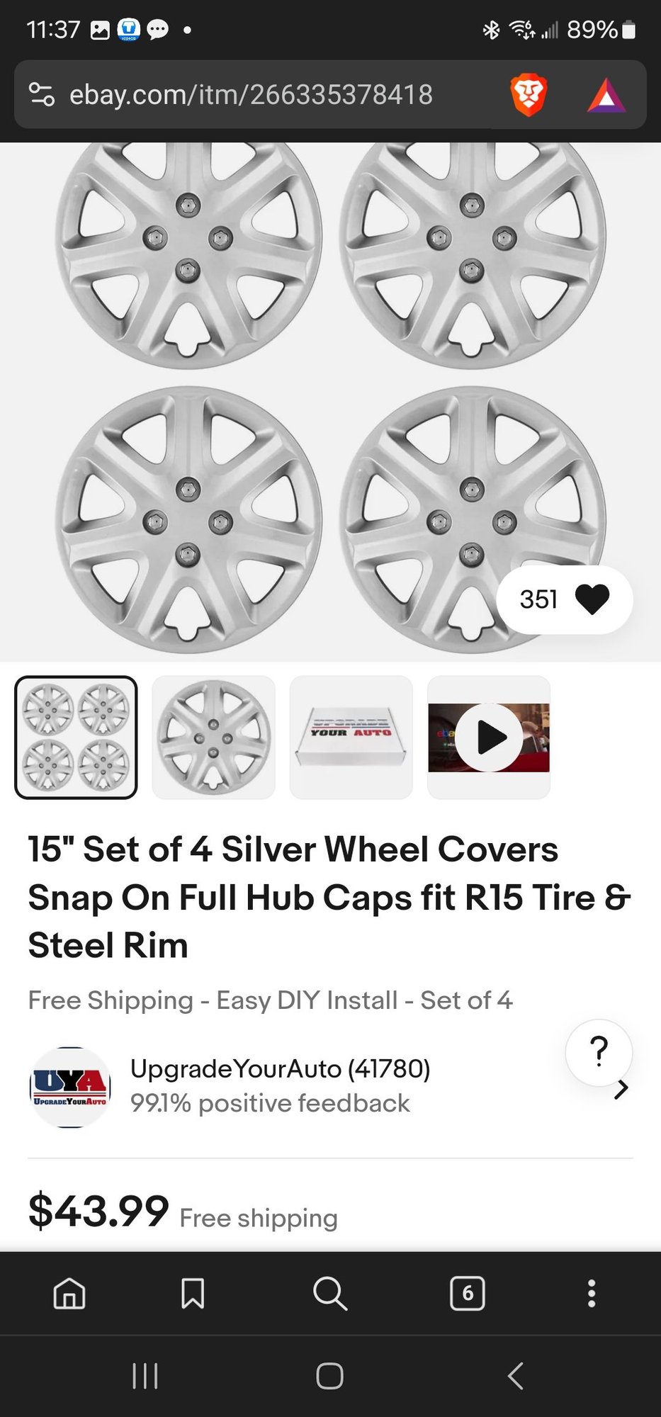

My original wheel covers were pretty bad looking, so I got a set of these, way cheaper than OEMs
https://www.ebay.com/itm/266335378418

Anyhow, thank you for the links, I was very pleasantly surprised to see how inexpensive the wheel caps were. I had looked at a site who's costs were literally 4 times that. It's nice to know that I can get a new look for MUCH cheaper should I choose, thanks!

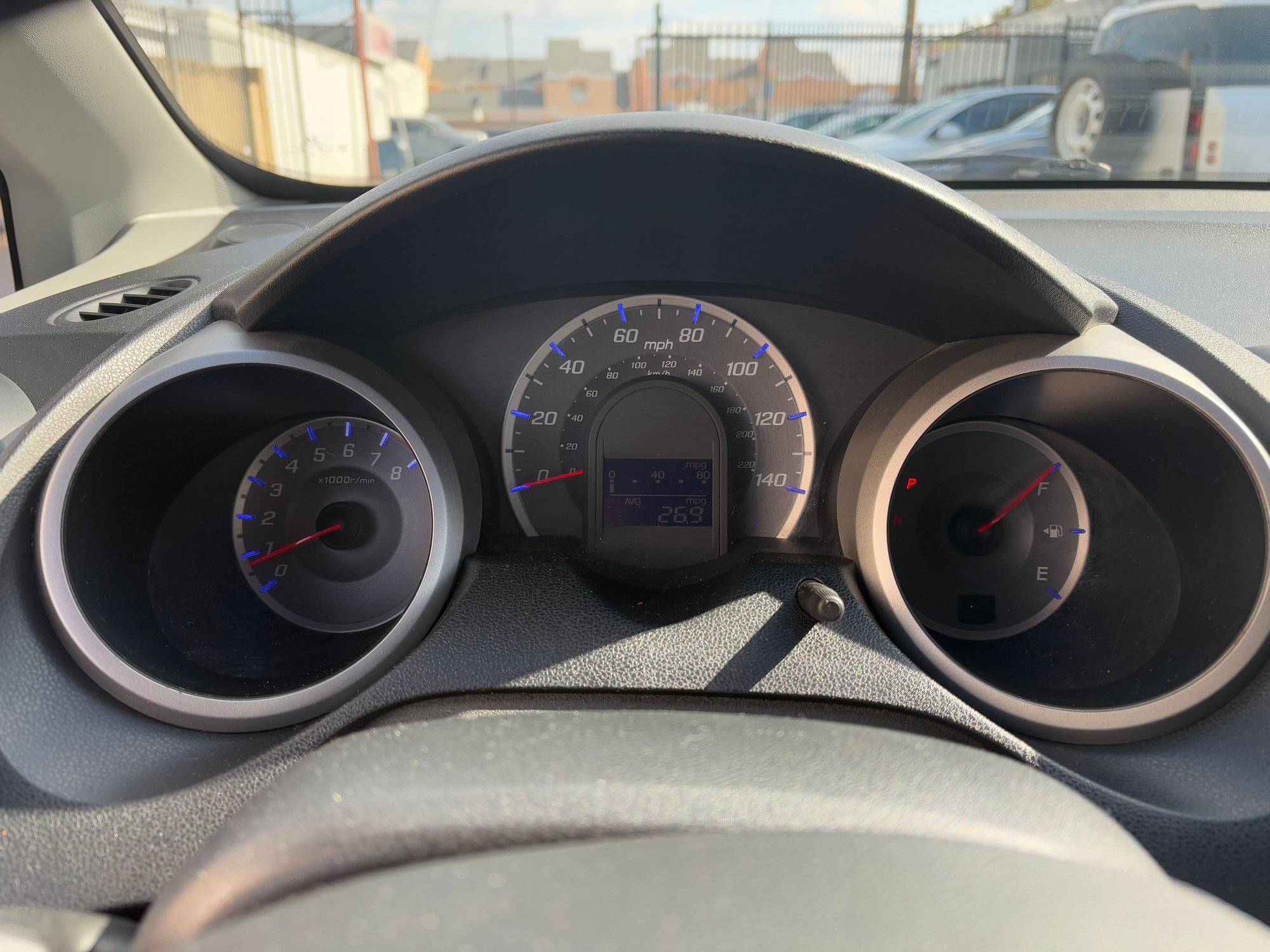

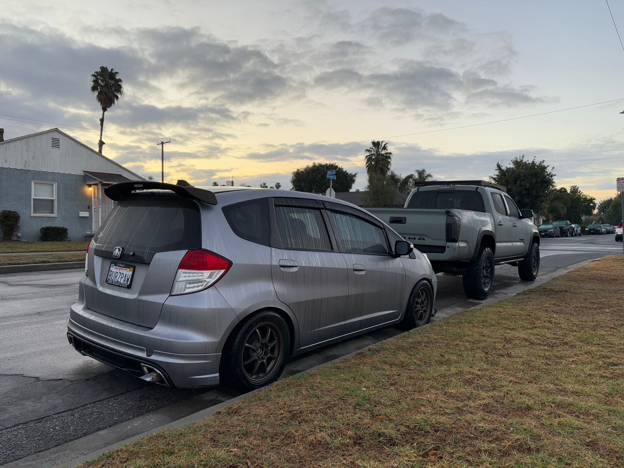

Had lent the Fit to my sister after I got a truck to use for work back in 2017. Sister recently bought her own car and now the Fit is back in my hands! Needs some TLC but so far in great condition being 15 years old.
Got it checked up and everything’s in order mechanically at 133k miles. Swapped out the battery and got new tpms sensors and love seeing not a single warning light on the dash. I’m in search of a passenger side skirt and I’m swapping out the top strut mounts this weekend since there’s some play(assuming the rubber mounts and bearings have deteriorated).

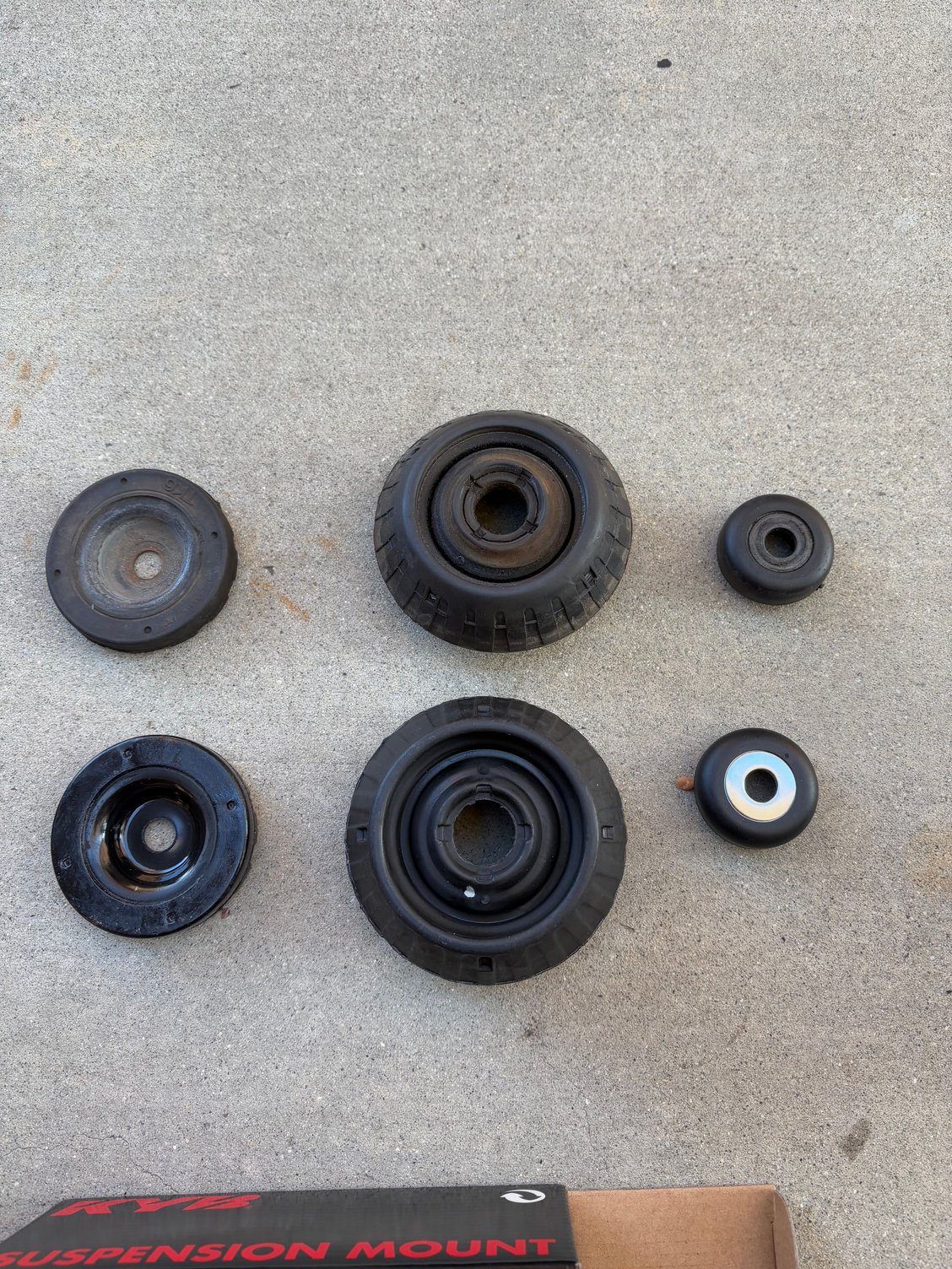

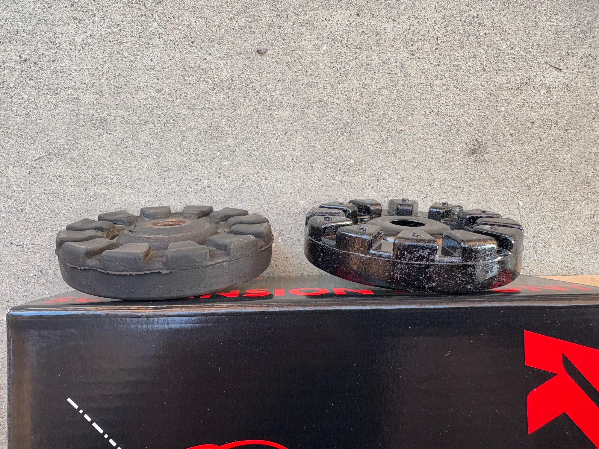

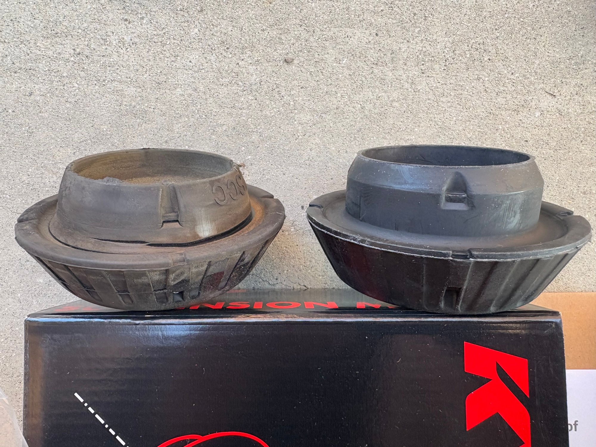

Swapped out the strut mounts this morning! You can see in the photos how much wear and tear took place in a span of about 6 years. The center metal on the top mount was concave and the bottom mount had cracks and worn out rubber. Bear in mind I’m on coilovers so I’m sure it’s not typical for stock suspension. Drives like a dream again with no suspension knocking!

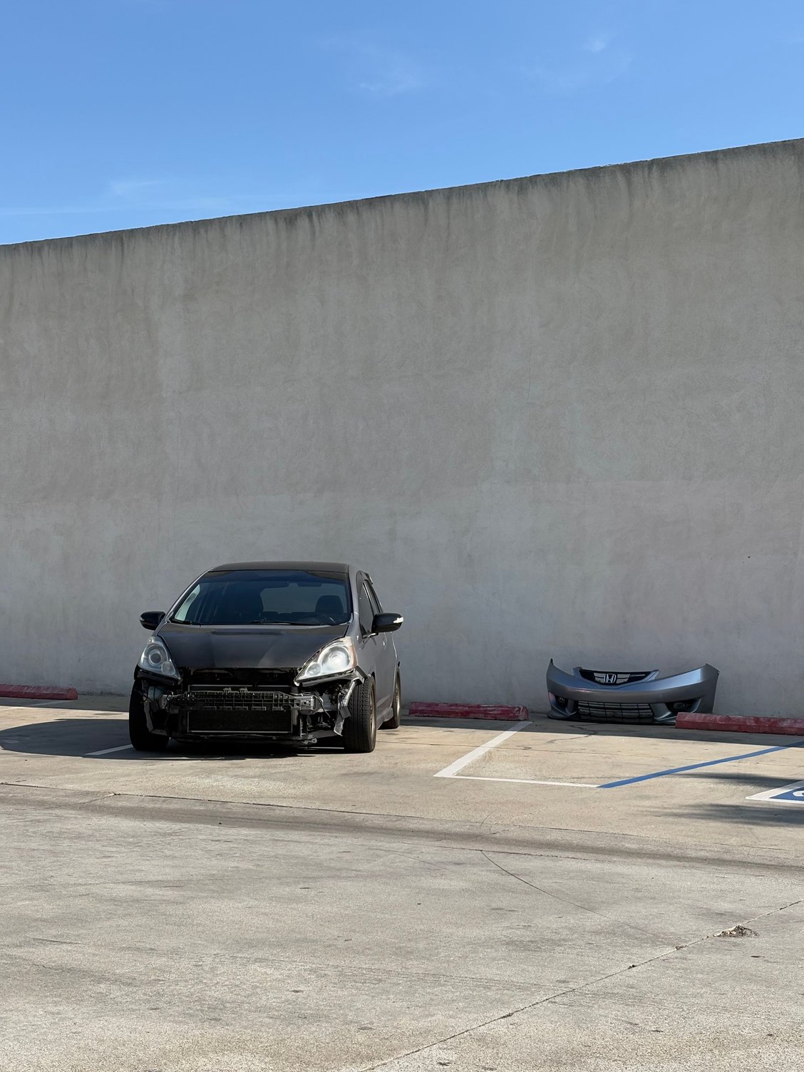

Had to pop off the bumper because my usual alignment shop was closed and I had to go to another local shop that wasn’t lowered car friendly, haha. Removed it pretty quick like I used to back in the day.

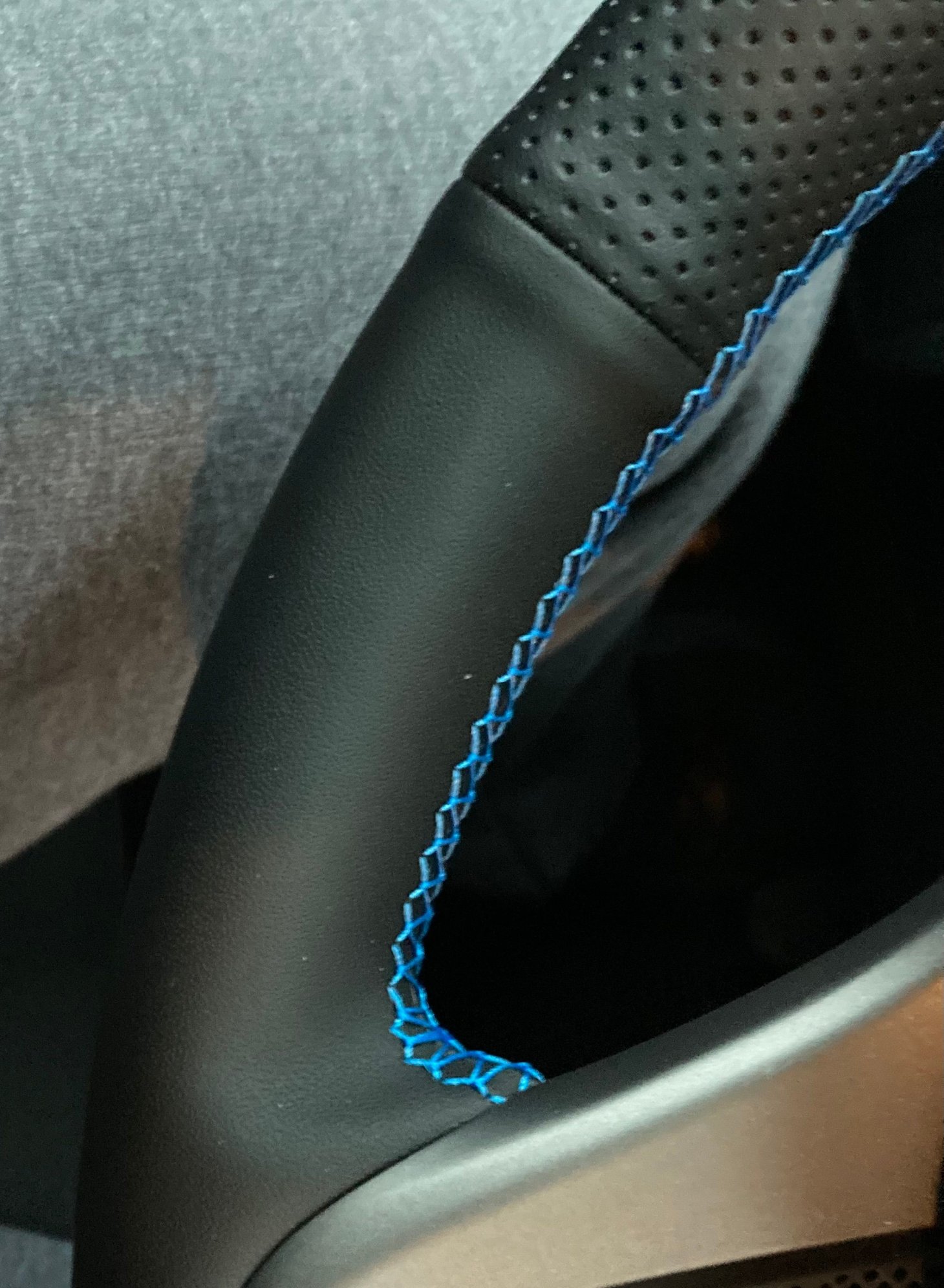

@Burzpaw welcome back. I just did my top mounts, too. What a difference!

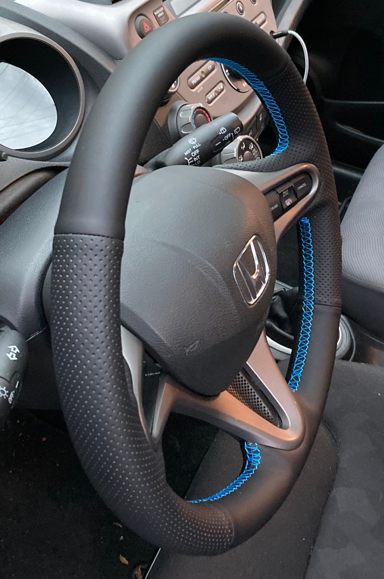

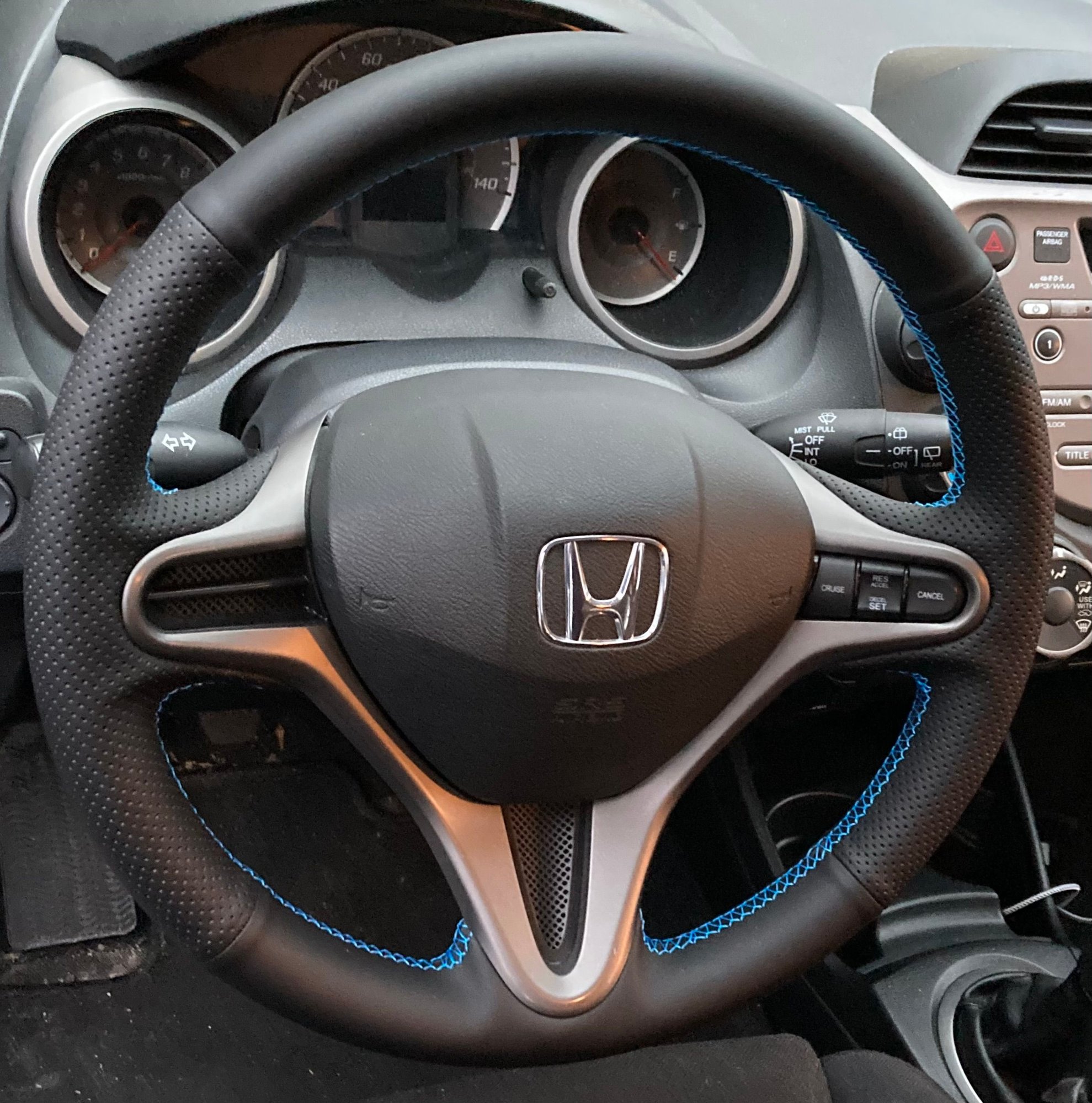

@Chad T that's the best looking wheel wrap I've seen. Is it a kit?
Thanks!
Yes it’s a kit from stitchingcover.com
44 bucks for synthetic leather. I went with the synthetic because I thought it would be thinner/easier to install. Feels really nice. Lots of different colors and materials to choose from. Little bit of a tedious job but comes out nice if you can keep the thread tight.

Originally Posted by Chad T
Thanks!
I'll say, it looks gorgeous, great job.
Thanks @GrE8_Fit! It’s night and day for sure; driving a week with the knocking got me anxious the strut post would snap or the body mount would get damaged haha.

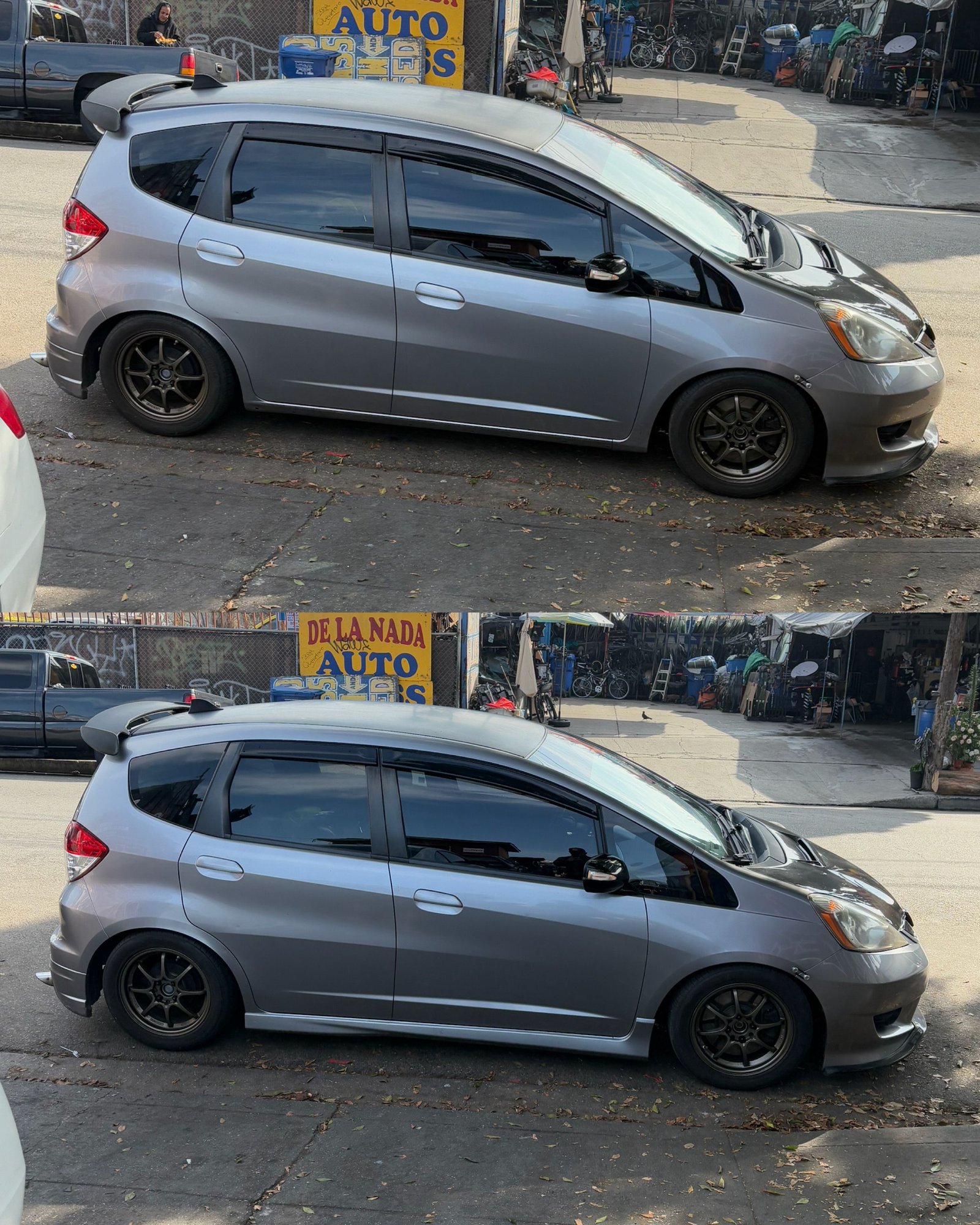

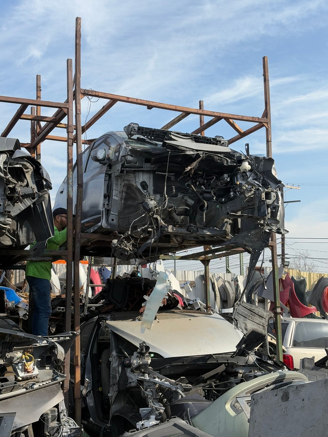

Found a wreck yard in LA that had an SSM Fit Sport with the passenger side skirt— all is right aesthetically again

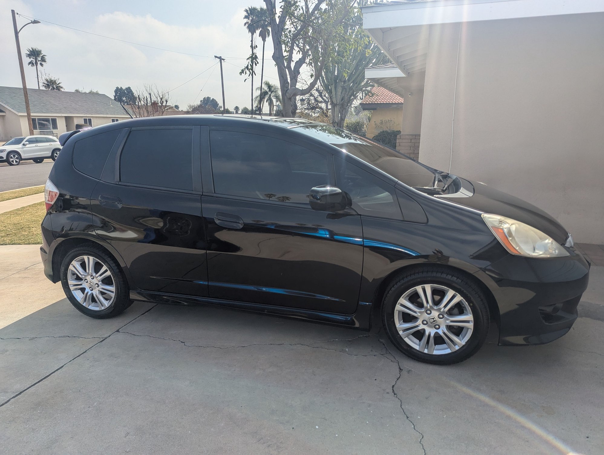

New tires
Got some new Yokohama Avid Ascend GT in 205/50/16, what a difference! The road noise is night and day difference.

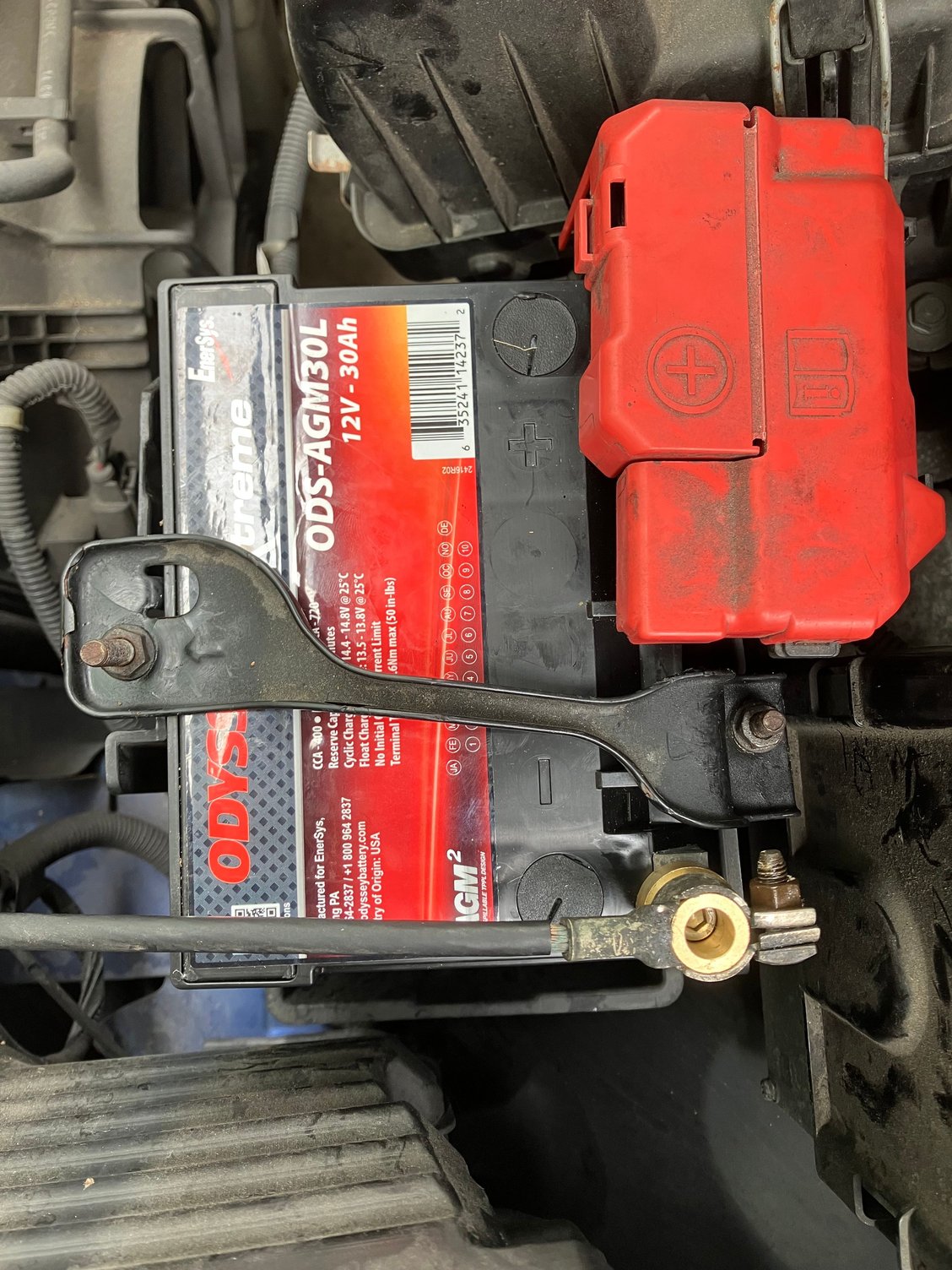

Odyssey battery install
While doing B 1 service noticed Champion (pepboys) battery 5 years old. Car starts fine in this mild climate, but load tested it. Only 50% of rated output so time to replace. I have an Odyssey AGM in my airplane and I trust my life to it, so at the Autozone price compared to a 151R, easy choice. New one is one inch shorter than stock, but plastic padding in the box made a perfect spacer to align positive terminal. Note that accessory terminal posts are necessary, as seen in the picture.
Thanks!

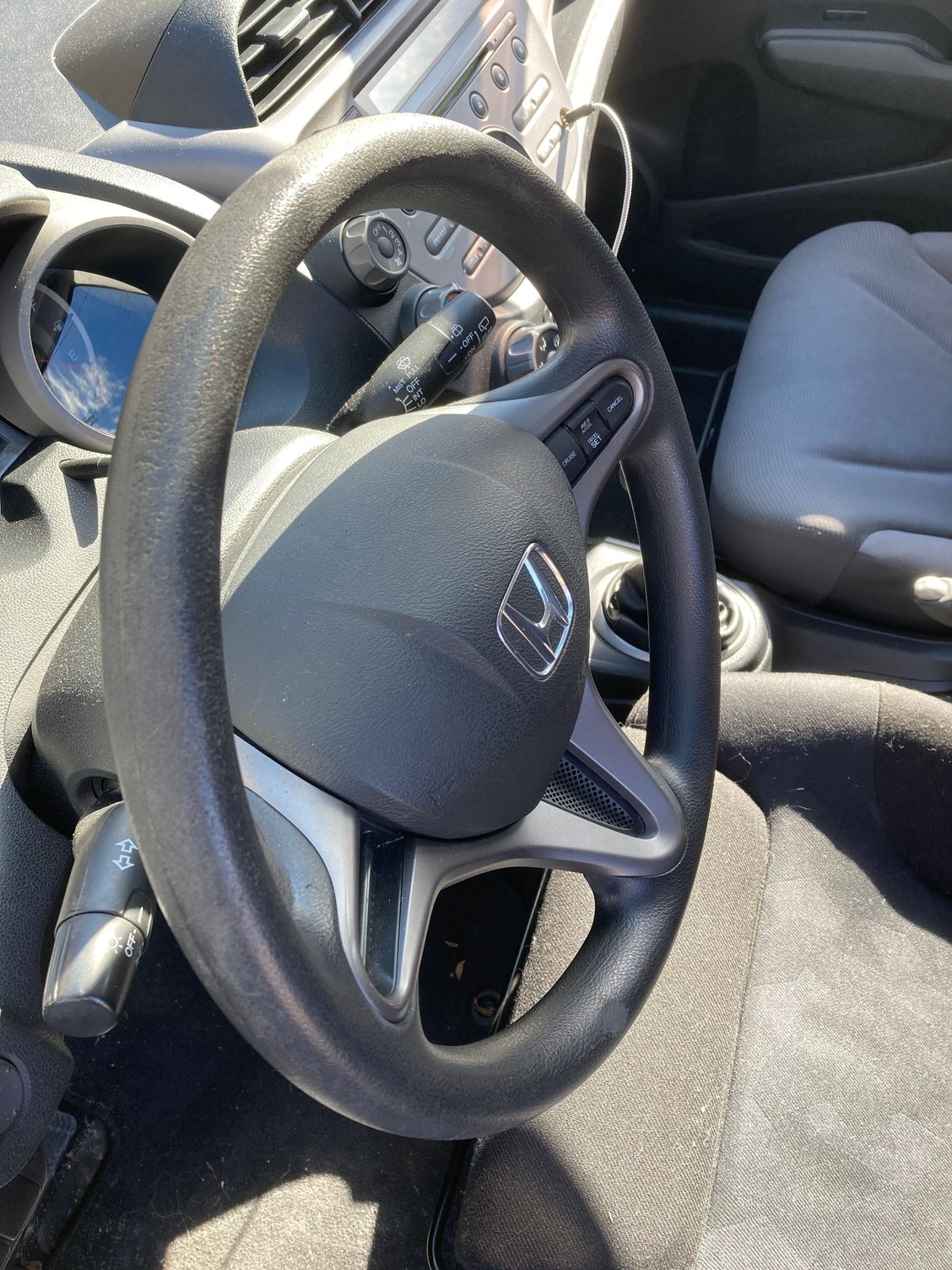

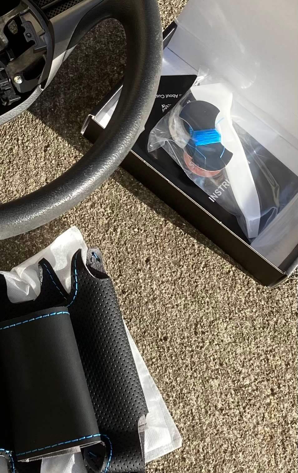

I bought a kit from them and was having problems doing the installation. Any tips?
It's not as easy as they make it look. First thing I found out was the seam between different sections won't line up if you just start on the first loop. You need to line up the seams then figure out which loop will work. You can adjust it a little by doing a double pass through one of the loops. This helps when it gets uneven.
Watched a few install vids. There are tons of them. None of them had a very good detail of how to tie the thread off at the begining and end. You want to go through the leather at these points. I just used basic granny knots to tie it off and seemed to work ok. It gets tucked into the plastic covers so hopefully holds ok.
Keeping the thread tight is key. I tried to do it like the girl in this vid. Note how she holds on to the thread while shes doing the next loop. I was able to get this down but it was a much slower version.
I had the steering wheel off the car and removed all the trim but it can be done on the car. Take your time. I re-did a few sections. They give you lots of thread. Really like this cover.
