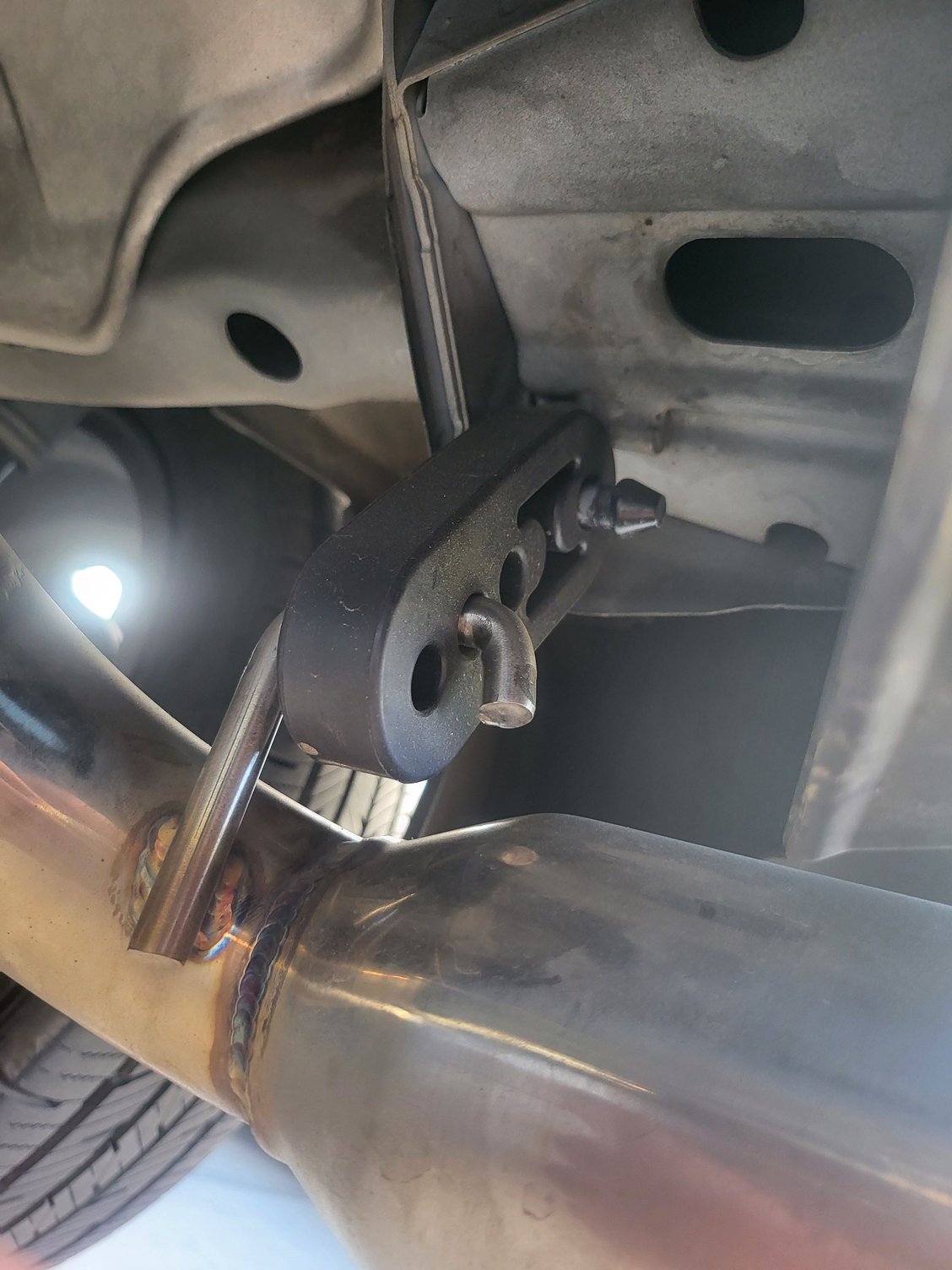

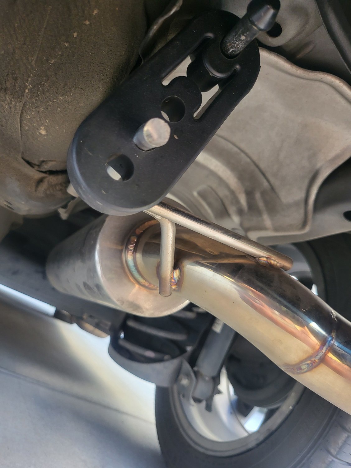

Few days after installing the Yonaka cat back, heard some rattling so went under to check everything again. A few were a little loose, so hopefully that was the cause.

Got the same exhaust, i also have rattling. try using exhaust hanger extentions, got rid of my rattling noise.
ps: make sure u get the exhaust hanger tool, make life easier.

Thanks! I'll give this a try. How long have you had yours?

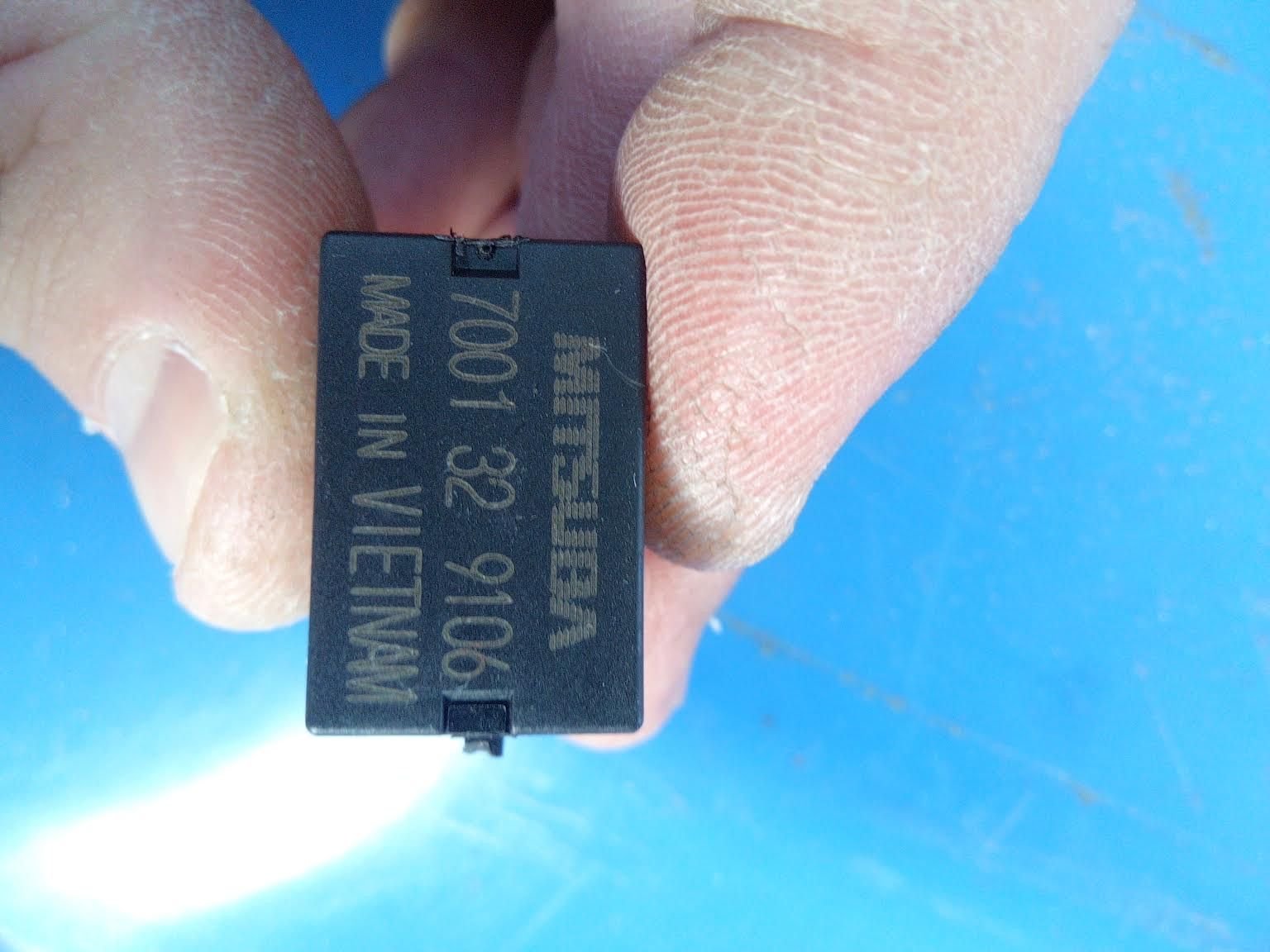

A PNW heat waves this week with no AC so had to troubleshoot and my clutch relay took a poop. Relay box really hard to find on a fit, thanks Honda!

Link is attched:
Exhaust hanger Exhaust hanger

just installed the universal hangers and that did the trick. So far so good.

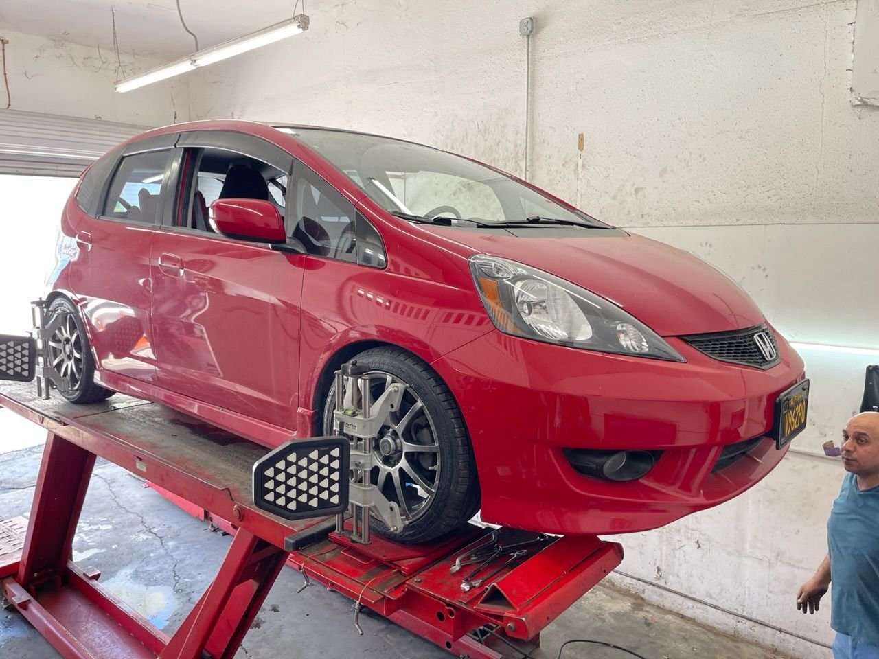

New tires, went from 205/40/17 to 205/45/17. This is on 17x7 +40 and lowered in Tein Basis Z. Raised it up to a finger and a half gap all around, based on the threads of the Tein probably about 1.5” down. Got it aligned BACK to factory specs from super duper camber and I’m happy to report no rubbing unless I really try (went at a big speed bump at 40mph lol) - for reference I’m 220lbs. The ride is so much nicer it’s like a new car.

rolled fenders?

rolled fenders?
nope not rolled

thx. Im 9n 17x7 40 offset too. Might give 205/45 a try
yeah I was really nervous going from 40 to 45 series, but after raising it and getting a good alignment guy that sweated over it with me, I’m pleased with the results. Doesn’t look as aggressive but the drive ability is night and day
