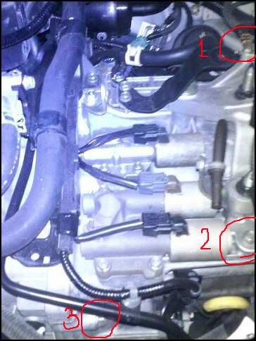

Originally Posted by deleonl1
Anyone find a good spot to attach the cable on an automatic?
in the same boat here. i bought the cable and was about to do it. ...but realized something looked different. here's a pic of what I have to work with:
i was thinking mounting it in one of these three point. #1 seems to have a wire going further in ( don't know where ). i think #3 might be a little to far to reach. what do you folks think?
