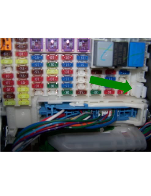

Originally Posted by Virtual
Check the fuses. Use the owners manual to identify fuses.
There is a 10 amp fuse that controls that stuff. I have blown it.
THe arrow points to the fuse puller. The fuse is under the orange square at the top left.

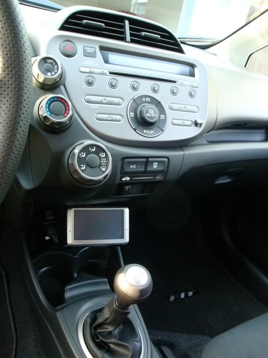

i mounted my GPS here
it's more out of sight, than on the dash or windshield. I've heard so many stories of people getting their GPS's stolen and they were all clearly visible on the Dash or Windshield..
the only downside is you lose the functionality of those two cup holders.. but there is plenty to spare.
out of sight-out of mind..
