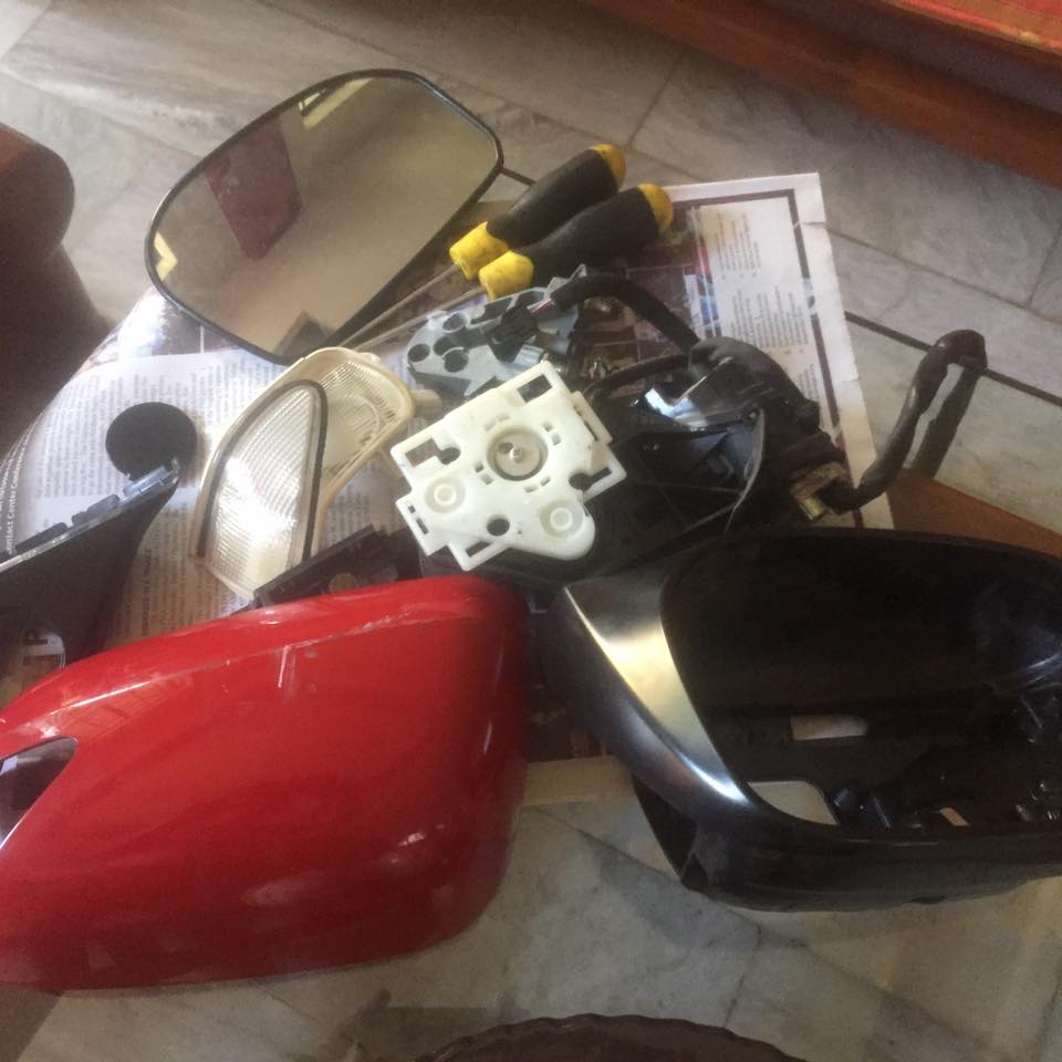

i don't know if this is related but can't locate a topic or thread related so here goes -
has someone took out the whole mirror motor assembly ? my folding (retract) motor seized so I had to replace it. Instead of getting it from the dealer (which is too expensive), I got wind of a JDM driver side surplus unit. It works (in comes with a heater module but I did not use it though). Since it is a JDM unit, the angle of the mirror is geared towards an RHD driver. Although the line of sight is still ok (for me)... I'm a bit OC as the angle of the glass (mirror) is kinda awkward. I'm thinking of re-using the glass motor mount I earlier had. It is still working. However, I don't know if I would just cut the harness and re-solder as the wires are integrated with the motor.
Attached Thumbnails DIY Turn Signal Mirrors (winkers)-mirror-20one_zpsrqrhdqku.jpg
