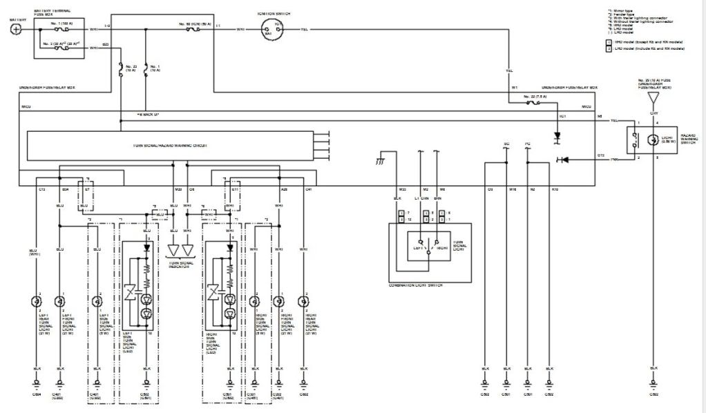

I hope this circuit would help.
Old Aug 16, 2010 | 08:02 PM
  #163
FITMugen's Avatar
Posts: 697
Base on circuit above, you need only a pair for turn signal.
LEFT: BLU / BLK (GROUND)
RIGHT: WHT / BLK (GROUND)
Please let me know if you need further assistant.

Thanks FITMugen. From what I have read I only need two wires as well for the signal lights to work. I have identified those at the fuse box. I will test the three wires on the mirrors and see which two work and use them for the signals. If I cannot find out what the third is for I can just leave it dis-connected. I still think it makes the lights stay on when headlights are on sort of like sidemarkers. Or could be they come on when unlock doors?

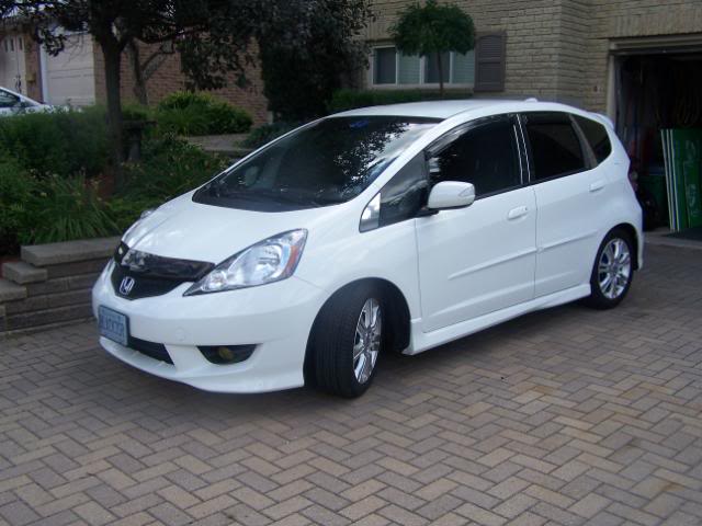

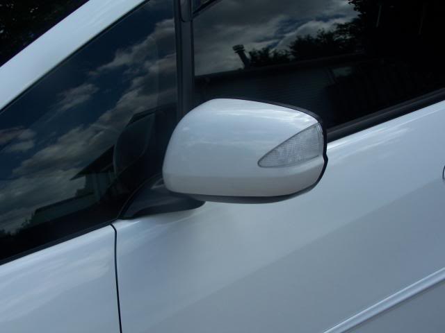

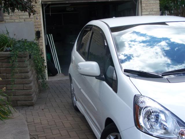

A fun morning.
Covers are on and wires are pulled to inside of car. Tomorrow I will wire them up.
I used a 9 V to test. The third wire lights up a blue LED. I believe they are illegal here so will not wire them up.
It is not the easiest of mods. My fingers are sore from poking and pulling wire. Getting the new covers to snap on was a chore. Snaking a wire from door to pillar was a bitch.
Pics
Here is U-Tube of them in action http://www.youtube.com/watch?v=5nbIjmwYraA
