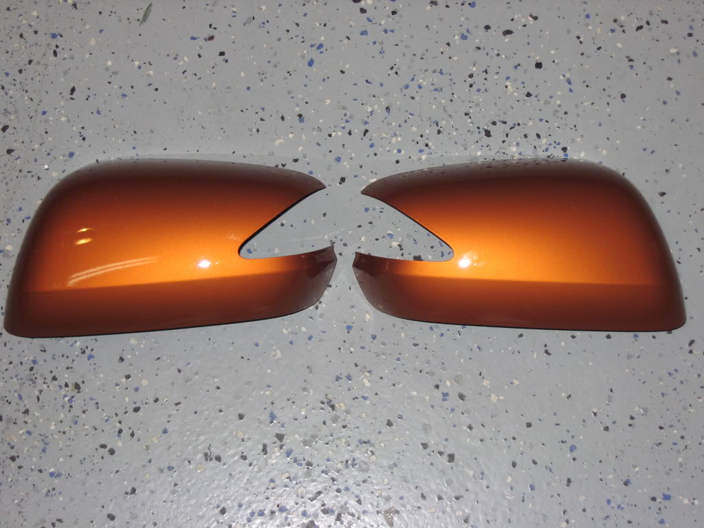

is there anyway to get those mirror covers for the winkers if my Fit is the orange color? This color is not available in Japanese version so what should I do?
Old Apr 11, 2009 | 10:48 AM
  #48
JDM_DOHC_SiR's Avatar
iTrader: (49)
Joined: Jan 2006
Posts: 2,804
From: San Diego, CA
Thumbs up
Nope that is one of the only colors that needs to be painted....... but here is a picture of what they look like after they have been

LOL Dave i have the same floor as you.
Old Apr 11, 2009 | 01:03 PM
  #50
iTrader: (49)
Joined: Jan 2006
Posts: 2,804
From: San Diego, CA
Little do you know I took this picture in your garage this morning!
