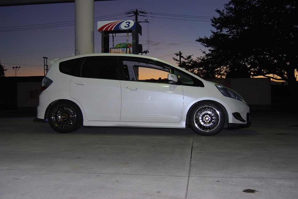

I'll contribute, dropped on J's/Crux. Camber of -2.4 and a slight toe out, 12k front (8 hardness, out of 30) and 8k rear (7 hardness), 45mm drop can go lower still, but completely unnecessary.

About the hardness, I don't think very many people would even want to daily drive this thing, with the solid engine mounts and even just 12k/8k spring and the hardness set to 8/7 it is quite stiff. With the rear shock having a poly insert, it creaks. Not at all a problem for me as I like "RACE CAR". When on circuit I'll increase the stiffness to about 15 front and 20 rear, will make for quite the ride.

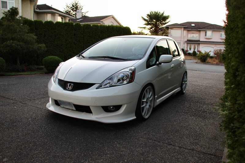

HKS hipermax s-compact's

SICK JOOKY!^^ so thats what it looks like painted......

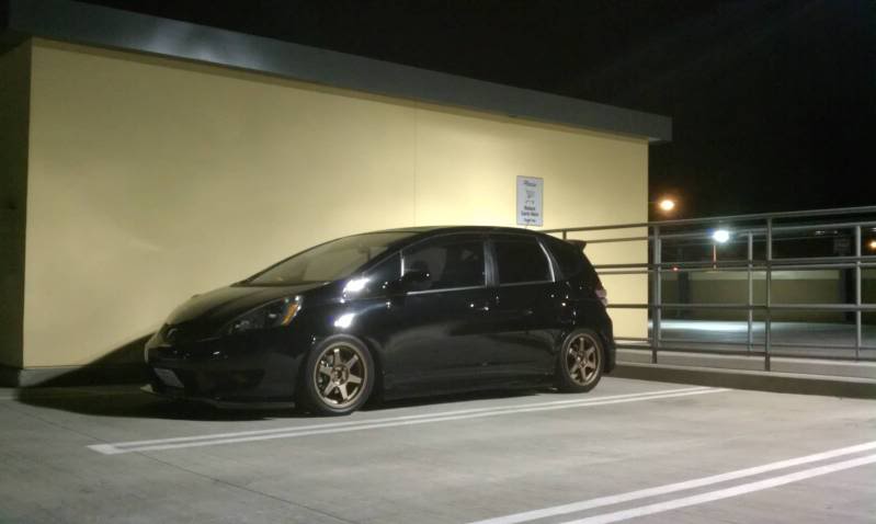

sorry, my camera phone SUCKS.

^ what coils are you on? looks 1000x better in person
