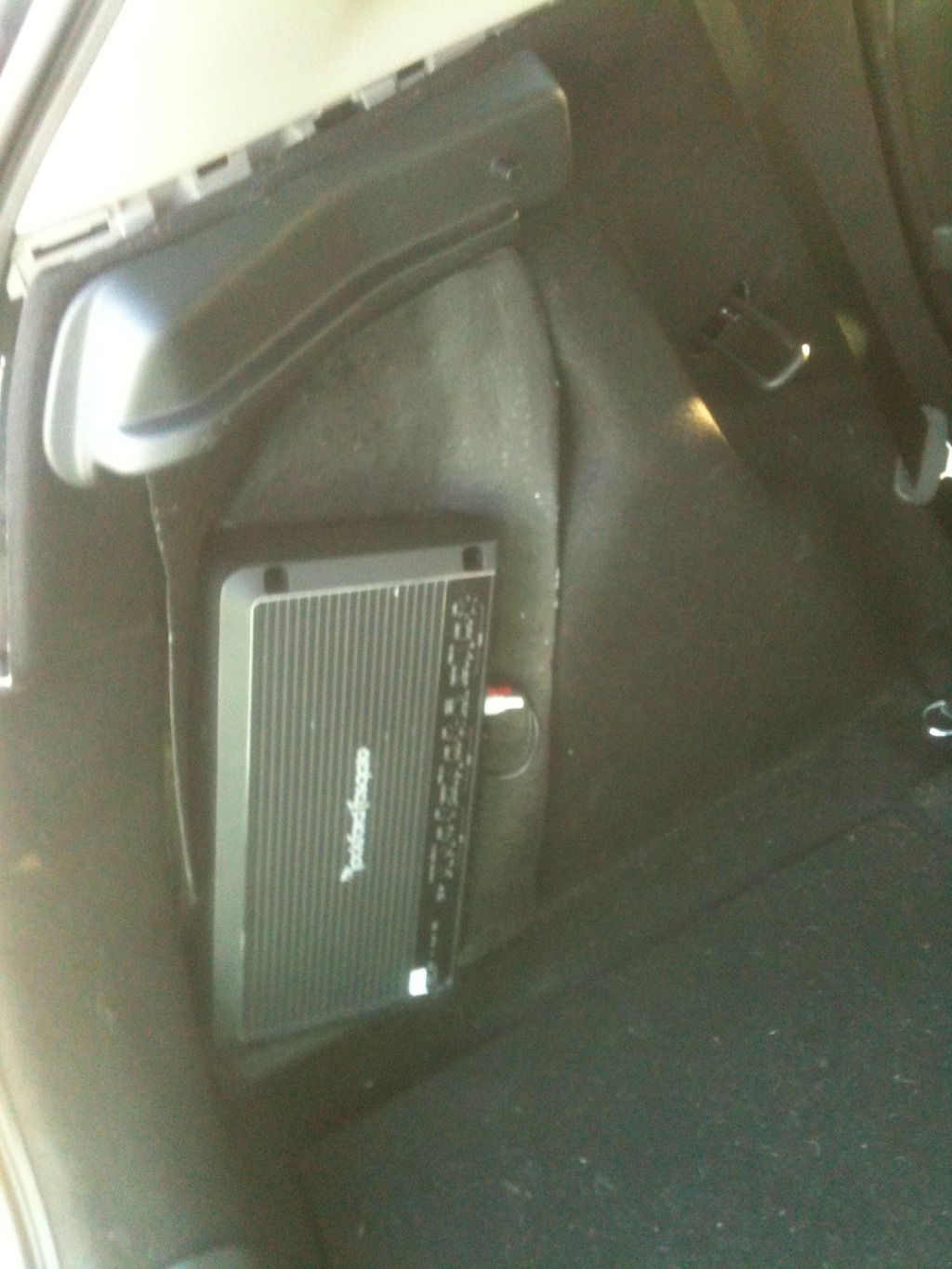

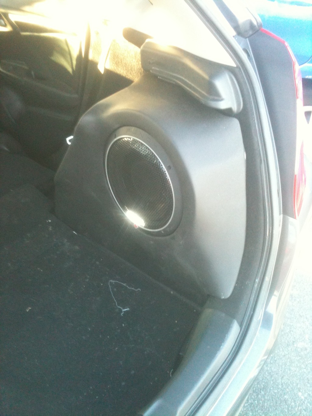

Finally got the sub and amp in and running. The spare is still accessible but the trunk light needed to be relocated.
The amp tucked neatly into the other side, it still needs some fitting but am holding off until I decide if I want to put in another trunk light on that side. Name:  5C18CB3F-08BF-40C9-B987-89DA6DF4727C.jpg

Looking good nicco, and it doesn't take up as much cargo space as I thought it would. Unlike the old days where a subwoofer could consume an entire trunk.

Yes, thank goodness for shallow mount subs. MY old ported 12 inch MTX used to take almost the whole boot of a large sedan. This one is a 10 inch and still needs a little tuning but is making some good bass.
If I did it again, I would probably do the fibreglass with the hatch shut and the parcel shelf in and go all the way to them to get a bit more volume in those directions and slim it down about a quarter of an inch at the front to allow for bondo and vinyl.
I would also do for the sub what I did for the amp which is run the fibreglass up under the parcel shel support to anchor it in from the top as mine is mostly held from the bottom.

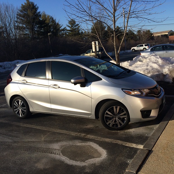

Mudguards, cargo tray and rear bumper applique
After finding a link to BernardiParts.com here and seeing the pricing, just ordered their OEM Splashguards, Rear Bumper Applique plate and Cargo Tray for my Silver '15 Fit EX
Had the dealer tint as dark as ME legal allows and the OEM all-season mats (in addition to carpet) when I just bought it a little over a week ago
This is replacing my '97 Civic that I dynamat'd and swapped a ton of JDM/EDM parts into after I painted the thing- so look out for plenty of mods in the future
