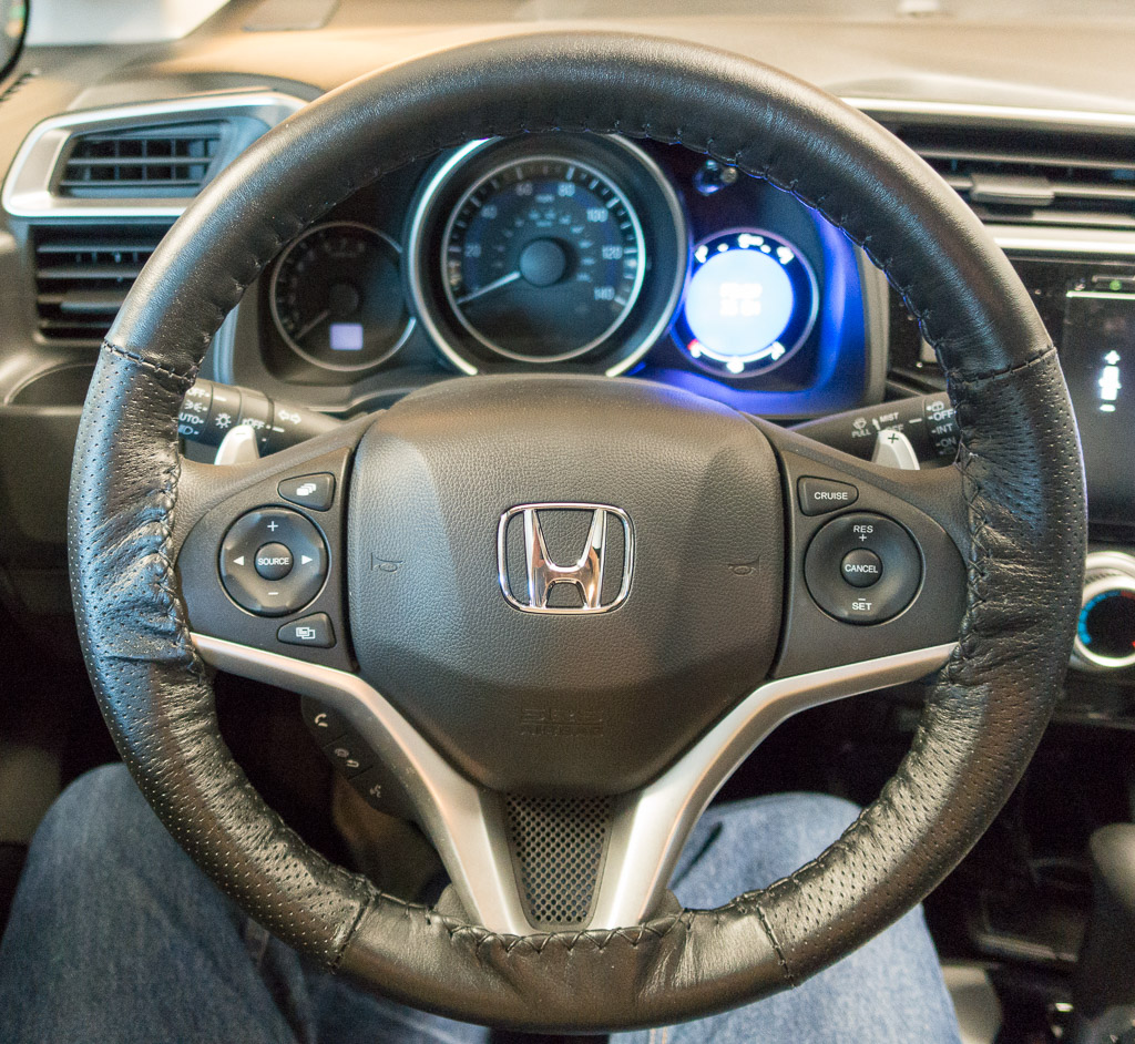

Wheelskins EuroPerf Perforated Leather Steering Wheel Cover
I selected the euro style (which works better on the 3 spoke designs) with perforated sides, smooth top and bottom.
Size for fit 2015 I personally measured was 14 1/2" x 4" which matched the online fit 2013 sizing.
Purchased on-line at autoanything for $57 incl CA tax and 10% promo code, with free shipping.
Wheelskins EuroPerf Perforated Leather Steering Wheel Covers - Sides Perforation
(All Fit models)
Part #: Black/Black Perf 14 1/2 X 4
Took several hours and I used the extra thread to wrap around the 3 spokes to tighten up the fit, especially the backside that otherwise doesn't get stitched. Word of warning... The perforated section is harder to stitch because it is more difficult to find the 'through' holes over the perfs.
'Tight is right' is definitely the case when stitching these and gloves help a lot.
Feels great while driving. A worthy upgrade for those wanting the leather steering wheel without the leather seats.
More pics here of follow up install.

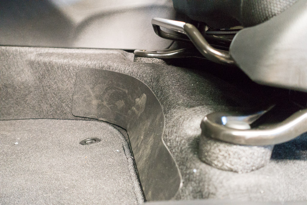

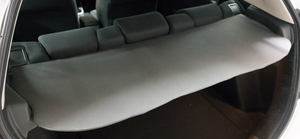

DIY Cargo Cover
Following the $11 DIY Cargo Cover guide, picked up a sheet of black foam board at Michaels for $15 and made my own cargo cover.
I made a cardboard template first, cut to shape with a minor amount of trimming, added some gaffers tape to the perimeter and installed. It bends nicely around the rear middle wiper assembly and fits pretty snug.
It came out pretty nice and it wedges in nicely without any velcro. Just bend slightly in the middle up or down to remove and chuck out of the way for the larger costco runs.
I added some strong thread left over from a previous wheelskin cover for lifting duty and attached paper clips with tape for attachment points on the trunk. It pivots reasonably well when the hatch opens.

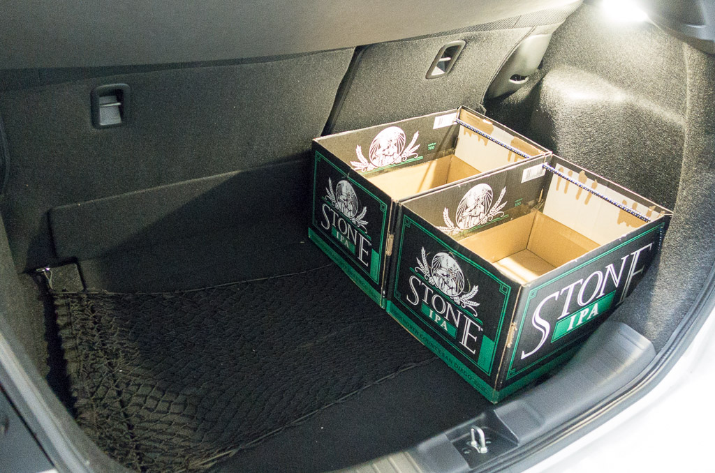

DIY Cargo Organizer and LED light
Two empty beer boxes, and a spare bungee cord. Cost $0 (not including the beer).
I also bought the LED light on Amazon for the trunk which is at least 4x as bright.
@ Amazon, 2 pack for $7
Jtech 2x T10 921 194 24- SMD LED Bulb Super Bright Warm White Jtech 2x T10 921 194 24- SMD LED Bulb Super Bright Warm White
I love the cargo area hooks!

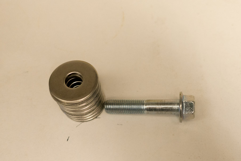

Increased Seat Bottom Pitch- Front Seats
Thanks to the tips from others on the site for increasing seat comfort, I went to Lowes and picked up some parts and raised the driver and passenger seats by 3/4" on the front side.
I'm 5'9" with 34" inseam and found it difficult to get a happy spot in these seats and when I came to a stop, i always felt like i was sliding off the front of the seat.
Raising the front by adding washers was fairly straightforward and most of the time was spent finding the parts at Lowes.
Revised 2015-01-26 - swapped out the Lowes parts and went with class 10.9 bolts and larger fender washers.
The parts I used are available at amazon:
Parts list:
Cap Screws (bag of 10) $8.23
Class 10.9 Steel Cap Screw, Zinc Plated Finish, Flange Hex Head, External Hex Drive, Meets JIS B1190, Flanged, Non-Serrated, 50mm Length, Partially Threaded, M10-1.25 Metric Fine Threads, Imported (Pack of 10) Class 10.9 Steel Cap Screw, Zinc Plated Finish, Flange Hex Head, External Hex Drive, Meets JIS B1190, Flanged, Non-Serrated, 50mm Length, Partially Threaded, M10-1.25 Metric Fine Threads, Imported (Pack of 10)
Fender Washers (bag of 100) $14.90
Fender Washers A2 Stainless Steel - 10M x 30M (10.5 ID x 30.0 OD x 2.5 Thick) Qty-100 Fender Washers A2 Stainless Steel - 10M x 30M (10.5 ID x 30.0 OD x 2.5 Thick) Qty-100
Cost was around $24 for the parts.

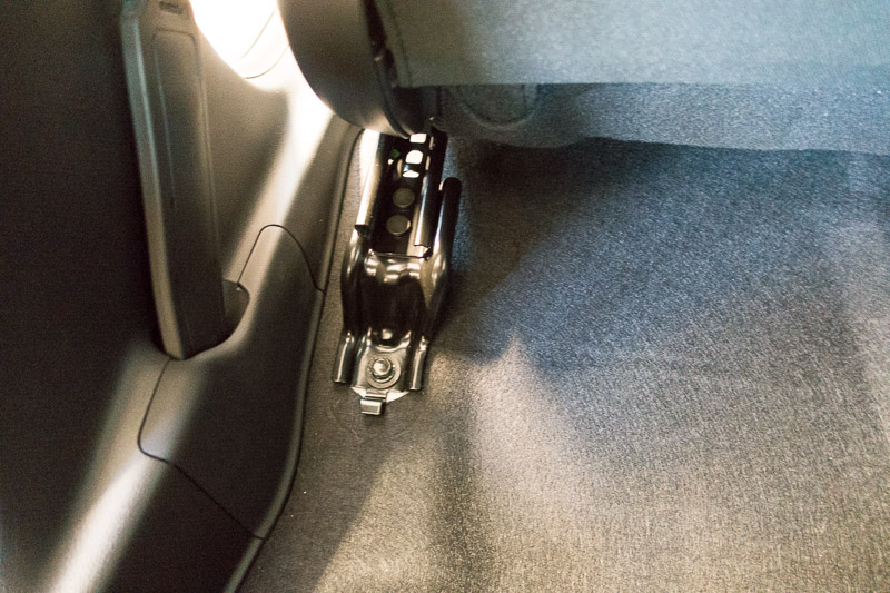

I used black electrical tape to keep the washers together and keep them from falling under the carpet.
To make it easier to get aligned on the front, I filed the front holes in order to get a vertical enough approach on the bolt hole.
The higher you go, the more difficult it becomes to get the proper angle on the bolt hole. I used a torque wrench to make sure I did not strip out the bolt holes!

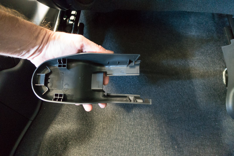

The little plastic cover in the back comes off if you grab it and pull down and to the side and back. There is a tab at the rear that you need to slide under to get it back on snug.

Did you check to make sure the new bolts seat to the same depth into the floor as the old bolts? Even if you did, I would be worried that those bolts are now a weak point if you get in a crash because you've significantly changed the lateral stress load angle.
To understand what I mean, get a toothpick and hold it between 2 fingers with an 1/8" sticking out. Now try to break that 1/8" off by pressing the side of it with another finger. Now do it again using another toothpick that is sticking out 3/4" and it will snap off much more easily with much less force.
These cars are engineered extensively, for crash protection purposes, literally down to every weld point and nut and bolt used. You've raised those front seat toothpicks up quite a bit. From an engineering perspective, 3/4" can be a lot.

Thanks and point taken on the potential stresses... And yes, the depth on the threads went deep through the holes from my testing.
Of course, the standard disclaimer applies to any of these modifications; do at your own risk.
It sure would be nice if Honda put another few $ of parts into these front seats and made them angle adjustable like the better seats in the old days; '85 Supra, 99' Integra, etc.

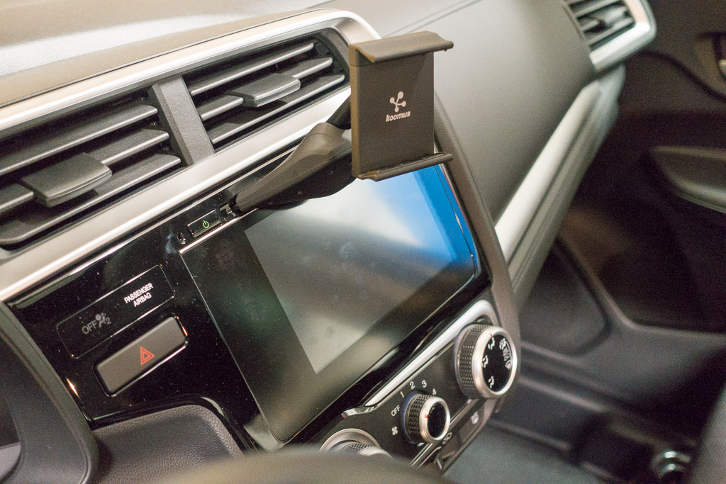

That's a clever product, but I wonder if it will do any damage to the DVD area - inside. Since I use Bluetooth to connect my phone, I don't need it mounted somewhere, but I was trying to think of a way to mount it somewhere easily. That might be the best way.
How secure is it when it's inserted into the slot?

...How secure is it when it's inserted into the slot?
I went out and grabbed it to check fit and shook the vehicle with it... Didn't budge at all with the standard sized grip installed. It also comes with inserts for 3 other thicknesses. It seems very solid.

I'm working on my cover right now, I was wondering what you used to attach the string to the trunk. There was an excellent coupon for Micheal's that ended up working on the foam board, so I got it for $5.50, great deal.

Great deal! I had a coupon but the lady said no worky with custom frame materials; go figure.
Attachment was simple, I used a paper clip adjusted with some needle nose pliers to go over 1/8" lip and some gaffers tape to hold in place.

Thanks! The person who rang it up told me it wouldn't work on the custom framing, too, but I was also buying some thick thread to make the lift, so we thought it would reduce the price of that. But the computer took 50% off the foam board.
