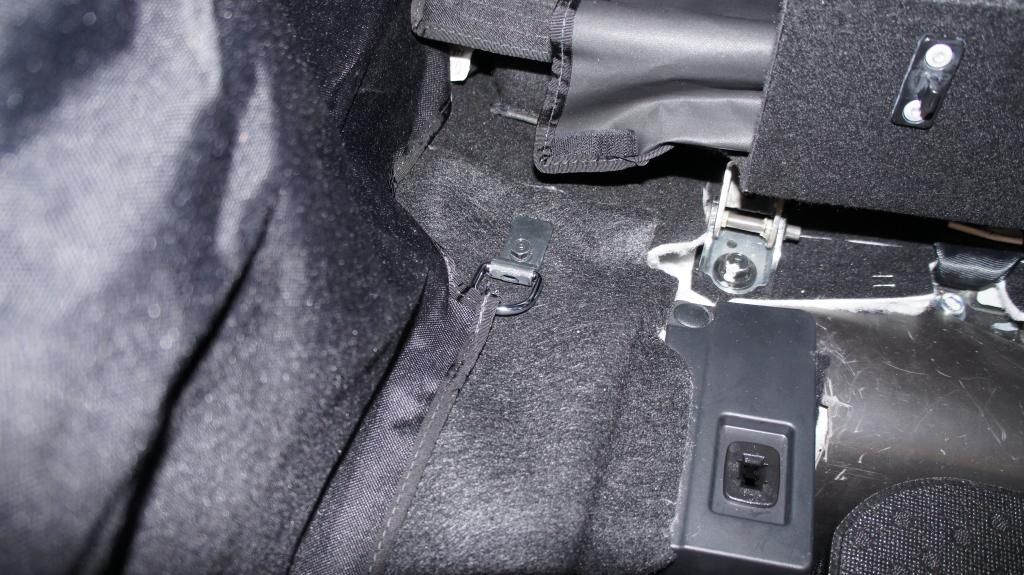

1. OEM Cargo Net
Its been mentioned previously. Get the two hooks in addition to the cargo net. Instructions indicate that the carpet should be cut. Didn't do that. Instead just made holes for the bolt and the front bracket to fit properly. Figured this would hold the carpet in place since there are lotsa of audio cables hidden underneath.

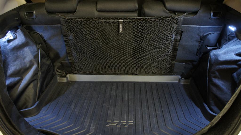

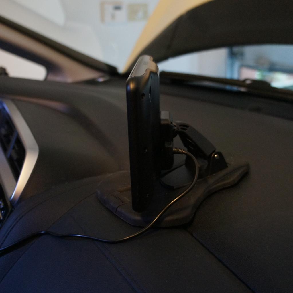

2. Garmin 2757LM GPS mounted using their friction mount

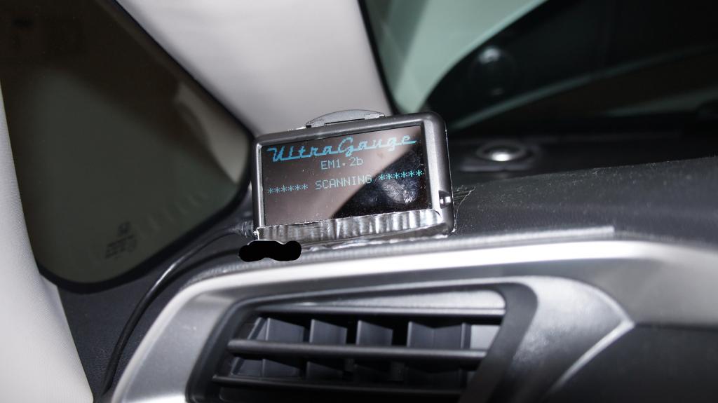

3. UltraGauge finally installed (temporarily)

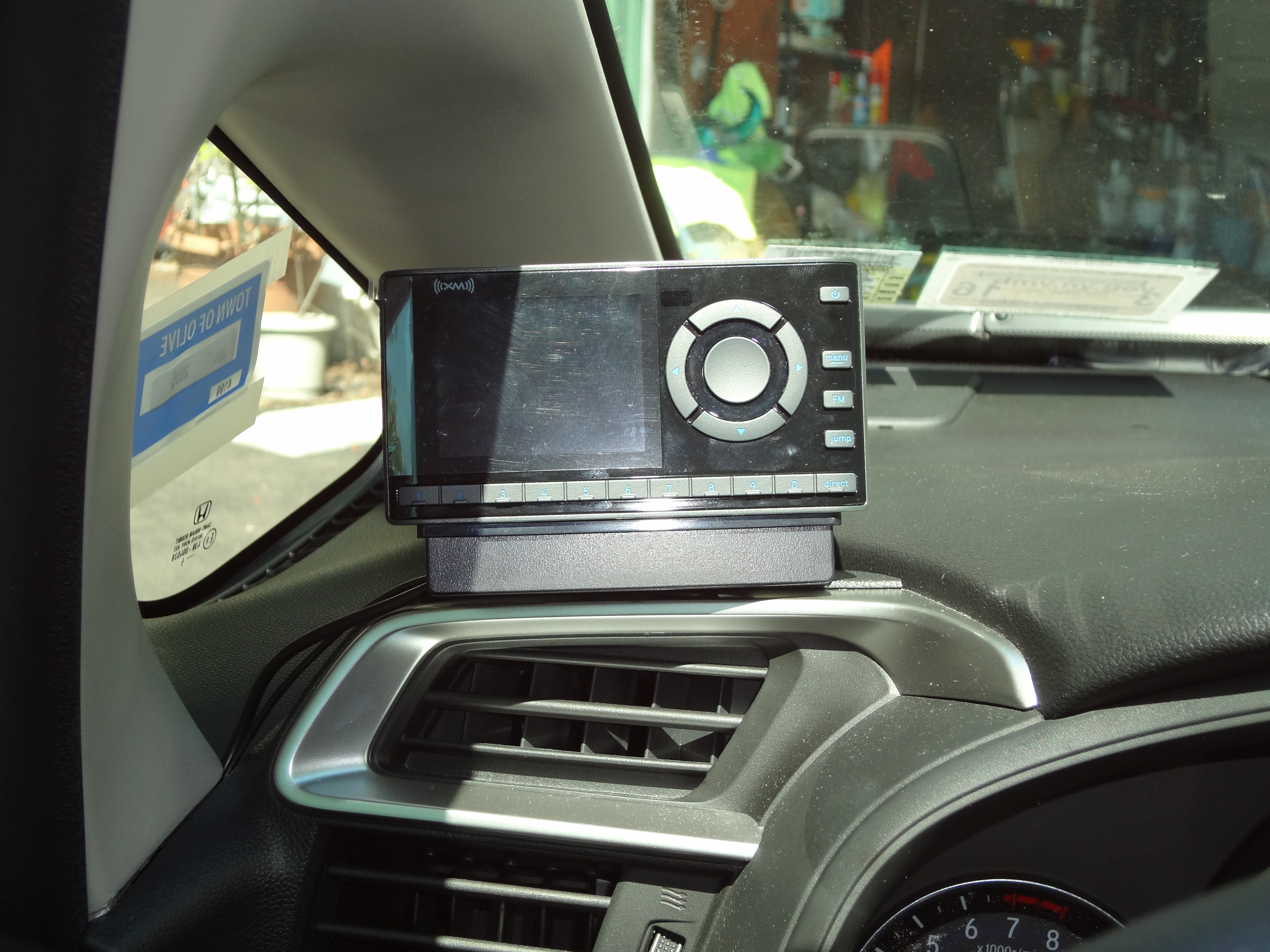

Looks good.
With the cargo net, can you fold down the seats individually?
That Garmin friction mount - why is the GPS mounted vertically?
Did you know that Garmin has a Bluetooth transmitter that connects to the OBD II port? It send all sorts of info to the GPS. I have a Nuvi 3790. I wanted to use a smartphone app for the same type of info, but connecting two devices to the OBD port could cause confusion for the car, at least that's what an informed mechanic told me. I even got an OBD splitter cable to I could connect two devices. If I disconnect the GPS OBD, then I have to go through the installation every time I reconnect it.
I have my XM radio exactly where you have your Ultragauge.

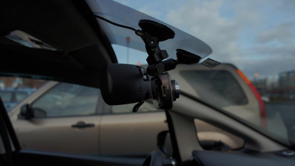

I have the same dashcam that you have, but I mounted it on the far right of the dash, near the windshield I didn't like it near the mirror.

- Cargo net - unhook the cargo net strap from one of the headrests and from a lower mounting hook (respectively) to fold the desired seat individually.
- Garmin is mounted horizontally. The 7" screen, from the side compared to the 4.3", may make it appear vertical but it isn't. Scored this from an Ebay seller (sealed and brand new) for $135.55 shipped. Couldn't control the urge to add another toy. With the LX not having its own Nav, I found my excuse!!!! Before it arrived, the apprehension was finding the right spot for install to minimize any blindspot but at the same time, close enough to access the touch-screen.

After using the Ultragauge on the wife's SUV for the past 8 months, got so used to the instant info. available (and there's a ton of them), finally decided to transfer the unit to the FIT.
- UltraGauge mounting location. Its in area where access to the page/menu buttons at the back are easily reachable. A secondary consideraton was that only one wire (connection to OBDII port) is exposed for the UltraGauge. The Sirius Onyx XM exposes three: power, sat antenna and Aux out cable.
- Dash Cam is directly behind the rear view mirror (on the right side). Can barely see its video screen from the driver's seat (just enough to know its activated when ignition is on).

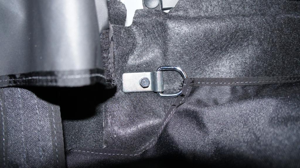

floor mat mod
Well, it looks a little more homemade than I would prefer, but I think it will work well. I just need to do the passenger side next.
COMMENT: Definitely a proactive mod to protect our nice thin cheapy GK carpets. The niece who got my '08 GD had that carpet area on the center console fronting the accelerator pedal (exactly where you have the protection plus the black tape) torn by her big Samoan boyfriend when he drove it the first time. - Thanks for the share!!! - rttby
As for the "home-made" look, maybe, but definitely effective!!!!
I remember why I didn't mount the dashcam on the windshield. With the supplied bracket, I wasn't able to get the right angle with it on the windshield. I got a small GPS mount to put it on the dashboard.

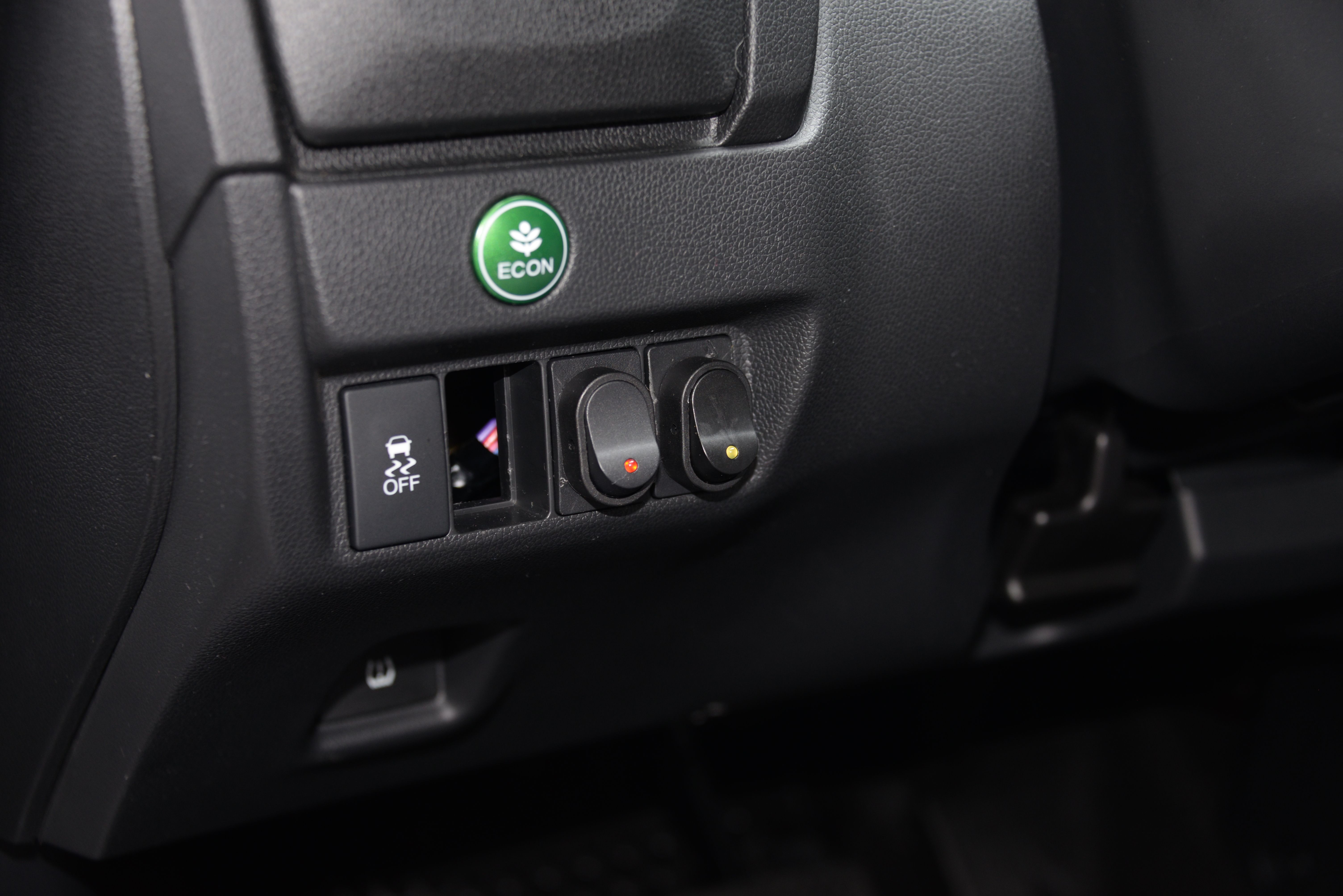

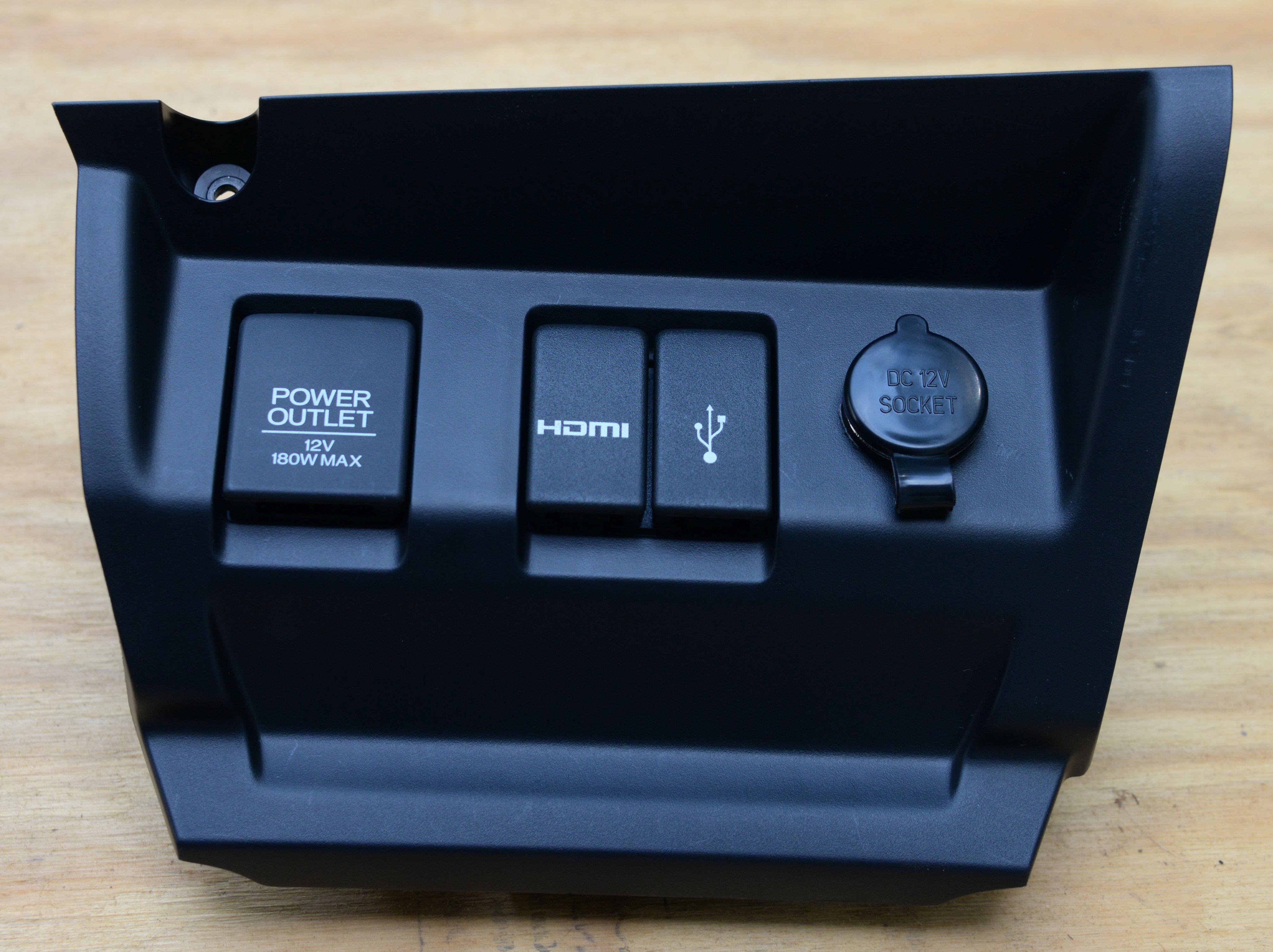

I always add additional sockets. I add a separate fuse block to power additional accessories. I put a switch in one of the blanks on the left to turn the external sockets on and off.

COMMENT: Am scheduling this mod as the first for 2015!!!! Just ordered a power socket on Ebay. Another great share from SilverEX!!!

GREAT PIC'S.....THANKS....To Rottboys pic's....How did you attach the sat receiver there?
On another note; is any one interested in my oil filter study?
REPLY: Used the supplied mount that came with the Sirus Onyx XM. Removed the plastic cubby hole (in front of the cupholders). Once centered and positioned, used a pair of SS bolts and lock washers to secure. Using the sat radio's Aux output directly to the stereo system makes for a non-interferance/static signal - so clear with unlimited variety, that, listening to CD's or the cell phone via bluetooth are now secondary choices.

I wanted to use the bean bag dash mount for my GPS but found it was too slippery my dash. I just took the stalk of the base so the power cord was still plugged in and put it in the corner cup holder. Something to make it a little thicker would help it be stay slightly more upright, but it worked good. I think anything bigger than mine might not fit, but it could go vertical.
COMMENT: The location is nice and close. Looks like that cupholder was designed to secure regular-sized GPS's. Am sure lots may follow your lead.
Good job in posting the pic. - rttby

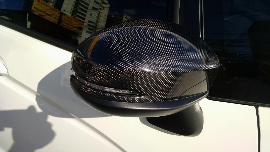

Yesterday i install the carbon mirror cover caps and the yellow fog lights in my Fit 3
