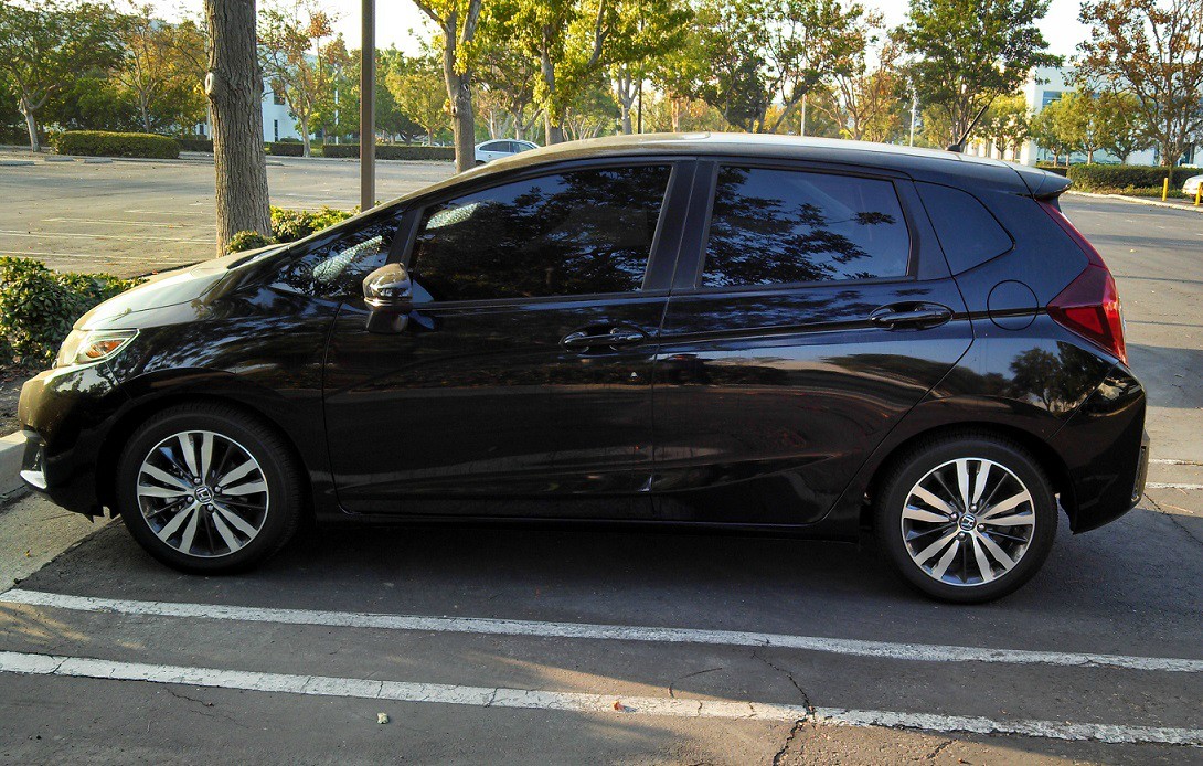

I got 18% tint all around, very happy with the look. Looks great with the black.
Also plasti-dipped the chrome strip above the bumper. Really like how it looked.

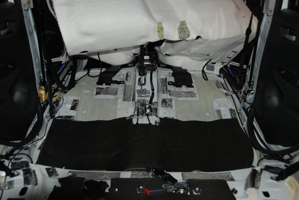

Mod installs cont...........

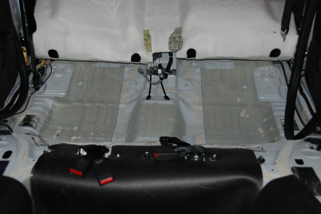

Finally took out the seats yesterday and spent today on the final sound-deadening of the front and rear floors.
The LX has some from the factory so no point in overlapping it. After installing some CLD tiles, proceeded to finish it up with MLV and CCF.
Pic of what LX's rear seat floor area gets from the factory.
MLV and CCF installed rear floor and Front seat flooring with CLD tiles.
Right Front Seat MLV/CCF installed
REar seat MLV/CCF installed - top viewing toward boot area.

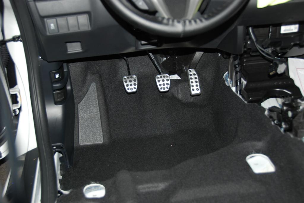

With the wife still in Tokyo, picked up my (pretty) niece who just came back. She brought me a surprise from the better half. OEM Sport Pedels. Had to install them and they turned out pretty cool.
The instructions were in Japanese but had her translate for me. What I dont' agree with is they suggest a 5mm hole for the rivets. I found that too big and used a 4mm drill instead. TIP: This is not an easy task if seats are in the car and I am not a big person. It took at least an hour.

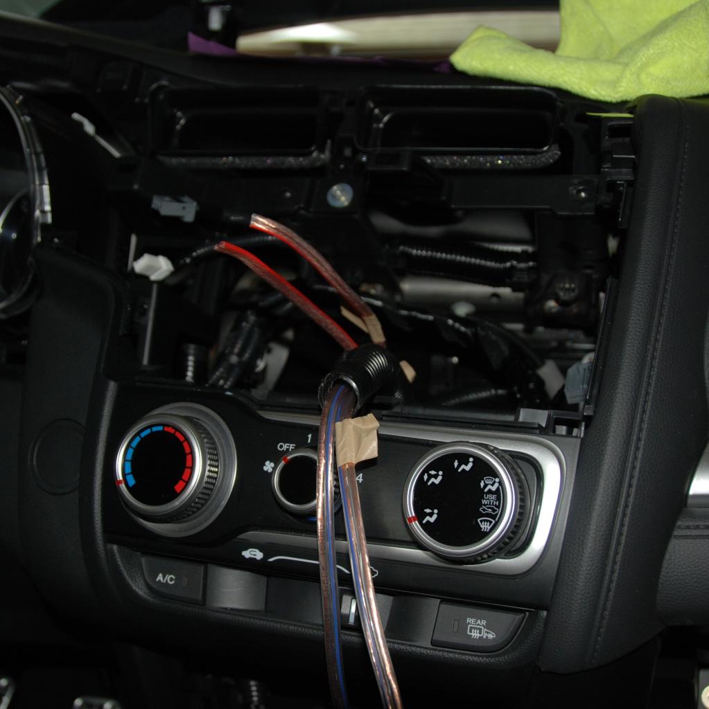

Posts: 1,116

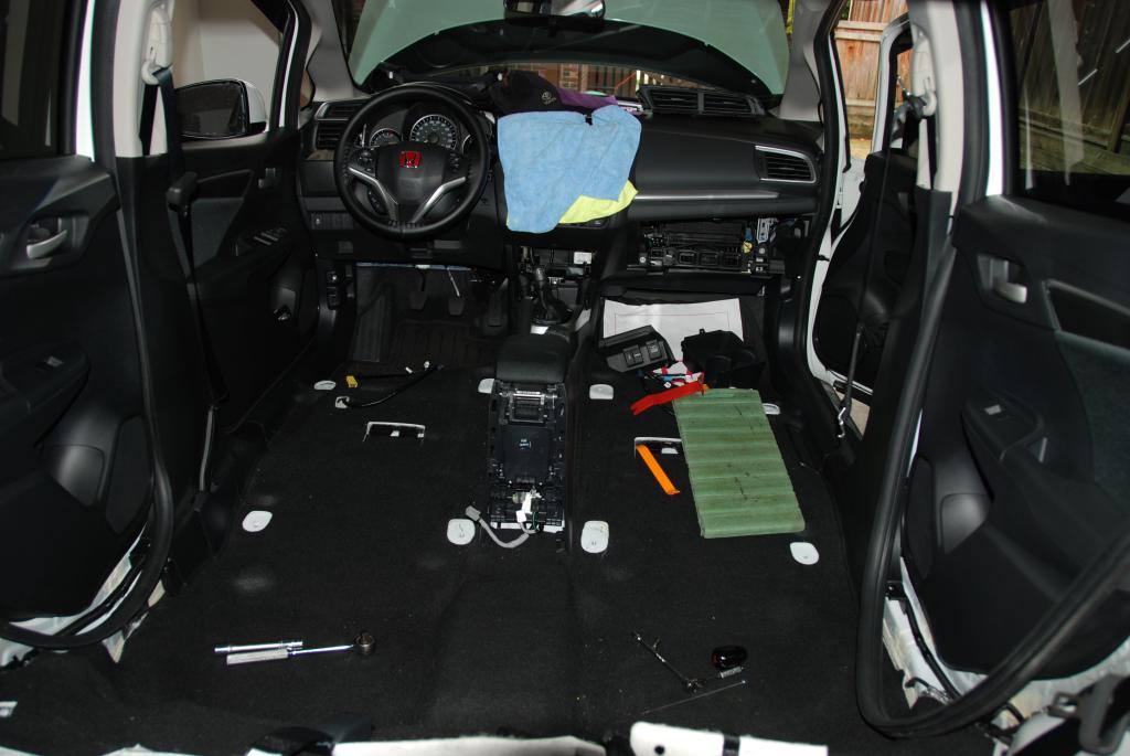

Stereo install started

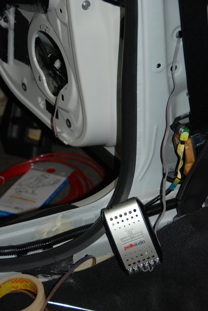

In between the football games today, since a couple of my teams didn't fare too well, decided to drown my sorrows by keeping the mind occupied and started on the wiring from the HU to the spare tire storage area.
HU wires will be connected directly to the OEM speaker connector for both the F & R speaker as well as the tweeters on top of the dash.
Wires in its own harness cover passing through the center console

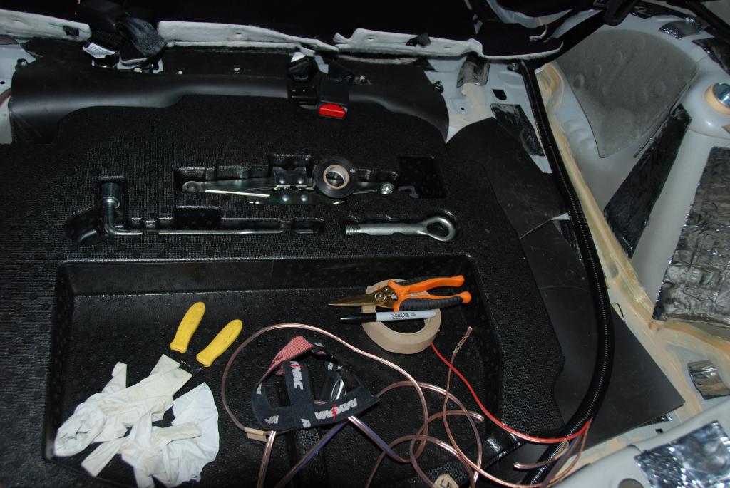

Wires in harness cover to the spare tire cover
Tomorrow will finish up the layout of speaker wires to the doors (finished routing to the left rear door) and to the sub (under the right front seat).

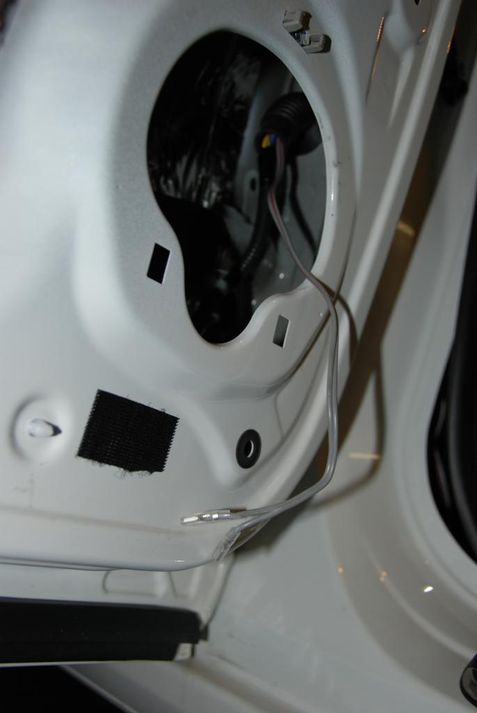

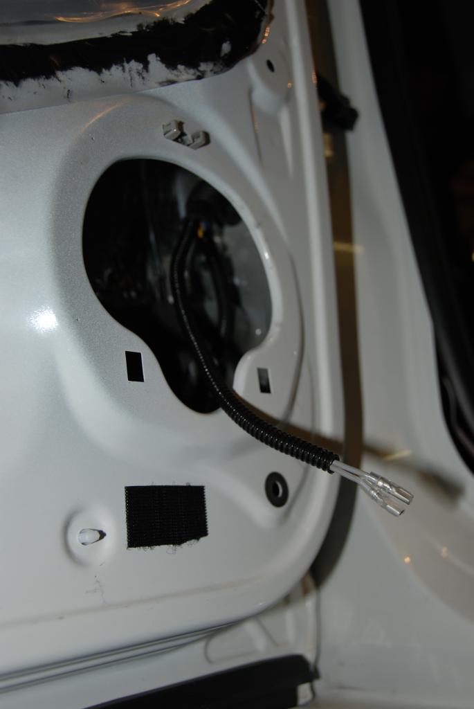

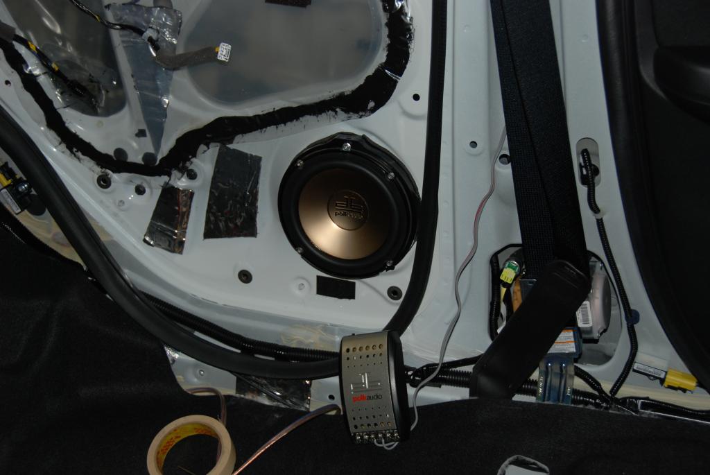

Left rear door wire and speaker install:
Speaker wire from crossover fished through door grommet
Speaker wire through inner door grommet
Speaker wire loom covered

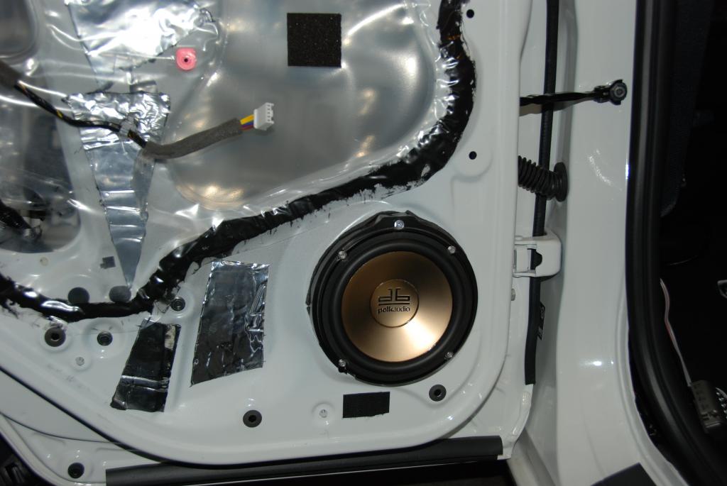

Speaker installed using adaptor brackets.
Speaker and crossover wired. Crossover will be installed on the pillar (middle portion) behind the seat belt. There's lotsa space there. Being very light, most probably will used industrial double-sided tape. Am not a fan of drilling when I don't really have too.
