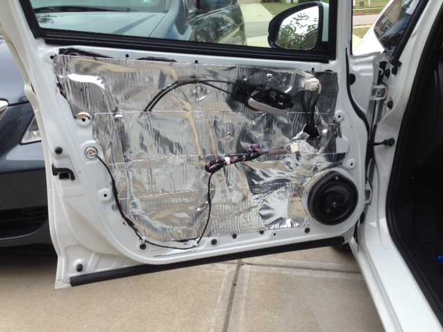

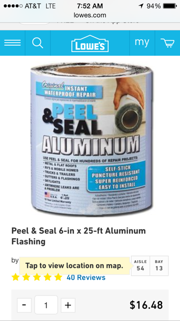

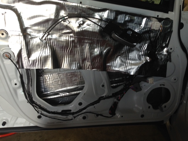

Here are pics of the cheap alternative sound deadening. It's Peel & Seal roof flashing from Lowes.
I did the backside of the outer panels, then the inside panels. I think each roll only weighs about 6 lbs or so. The stuff works awesome. I've used it on several cars in the past. No reason to waste money on the other stuff.

I used to work at a car audio shop and while we would sell dynamite sound deadening material to customers all the employees would use that gutter liner or rubberized undercoating because it works just as well for a fraction of the price.

......alternative sound deadening. It's Peel & Seal roof flashing from Lowes........No reason to waste money on the other stuff.......
Take heed all, this is sound advise if you wanna save. Sadly, found about this a bit too late from Superfly. If I were to do this all over again, it would be a visit to Lowe's!!!!
Another constructive share!! Keep 'em comin boys!!!!!
Originally Posted by HarWeevKllr
......used to work at a car audio shop....would sell dynamite sound deadening material to customers..... employees would use that gutter liner.....works just as well for a fraction of the price.
Confirmation coming from an former audio shop employee. Insider info that counts!!!! (think you meant Dynamat not Dynamite) Thanks!!!
Thanks Superfly! That is a lot easier looking and less expensive to do. We're learning a lot as we go.

For the Aussie's, you can find a Peel and Seal style aluminium flashing at Master's (a JV between Lowe's and Woolworths). It is about $40 for a 20cm x 10m roll. They also carry a product called Fast fix which is about $60 for a 22cm x 5m roll which is getting up there on price but the 5m roll of Fast fix felt a bit heavier than the 10m roll. I opted for the Fast Fix since my speakers arrived today and I hope to do the install this week. The first thing I will be applying it to is the licence plate that rattles already.
https://www.masters.com.au/product/9...ape-220mm-x-5m

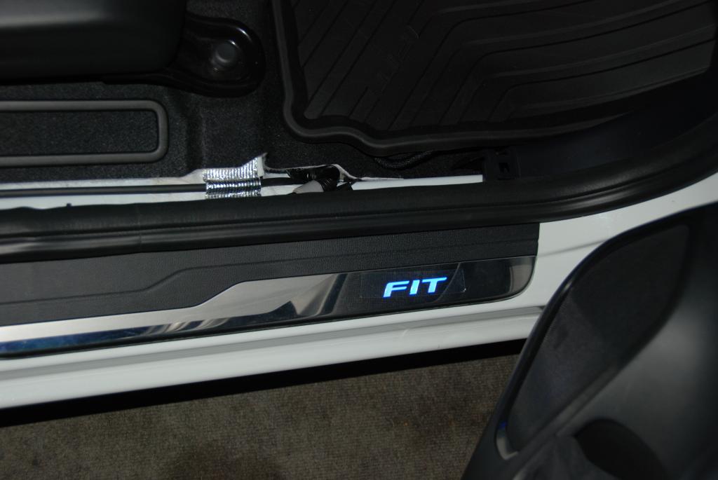

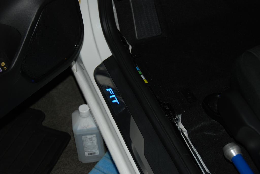

And the Install saga continues
Today, the install of the OEM Door Sills was accomplished. Pricey item, yes!!! ($250 shipped) That's the bad.
The good, wiring harness is complete as well as detailed instructions. Its practically "plug n play". Everything you need (other than tools) are included in the factory kit. Took me three hours but then again, am careful and don't want to break anything.

And the install posts continue!!!
BTW, borrowed my cousin's Nikon SLR, so hopefully the pics generate better quality compared to my phone!!!

Well, maybe if you had used a Canon SLR haha. Just kidding. Those look real good. Good job!

Those sills look SO good. Based on your experience, how difficult would you say the project is for a total novice? As in, someone who has never so much as plugged in a new light bulb into their car interior (up until last week, anyway :P). I'm relatively good with tools and following directions, but I just have no concept of how to rip into a car, and all things electrical, including terminology and use of random electrical tools like crimpers and wire nuts kind of elude me.

I hope to be doing this project myself soon. You can find the installation directions here http://www.bernardiparts.com/Images/...m_AII51167.pdf

If it took me 3 hours, it might take a novice at least double the time. However, if one can read plus absorb instructions, you should be fine.
Definitely proceed to Jupiter Joe's link and read over and over. Over one week-end, before you make any purchase, attempt to disassemble one side (preferably the driver's side -cause that's where the plug-in is located). Once you feel comfortable with that, you know its time to make the purchase.
Here's a tip - get some plastic trim removal tools. e.g
Amazon Amazon
If not for anything else, doing this exercise, will at the very least, make you familiar with the location of the under-dash fuse box.
Please disconnect the negative terminal of the battery before starting any electrical related work. Use a 10mm tool to loosen battery bolt.
YOU CAN DO THIS!!!
Additional input: There is a Bay Area group of FFs that meet regularly. Am sure they won't mind your dropping in. They'll all be glad to help show you what to do!!!! Its basically panel and door weatherstrip removal.
Originally Posted by JupiterJoe
.......doing this project myself soon........ installation directions here http://www.bernardiparts.com/Images/...m_AII51167.pdf
Initially wasn't interested in the OEM door sills (too pricey). This was one of the last items I stocked up before the GK delivery. I did read the install directions (from Bernardi site too!!!!) before making the purchase.
Now its installed, aesthetically, it's a more worthwhile OEM accessory than realized.
One gets to see it everytime you open the door and see "Blue" Fit LED's staring at you. IMO, it does not look cheesy or cheap.
JupiterJoe. You, I, plus all the FF members are gonna continue to assist spaghetina and anyone else who needs guidance.
Good job on posting that link!!!!!!!!

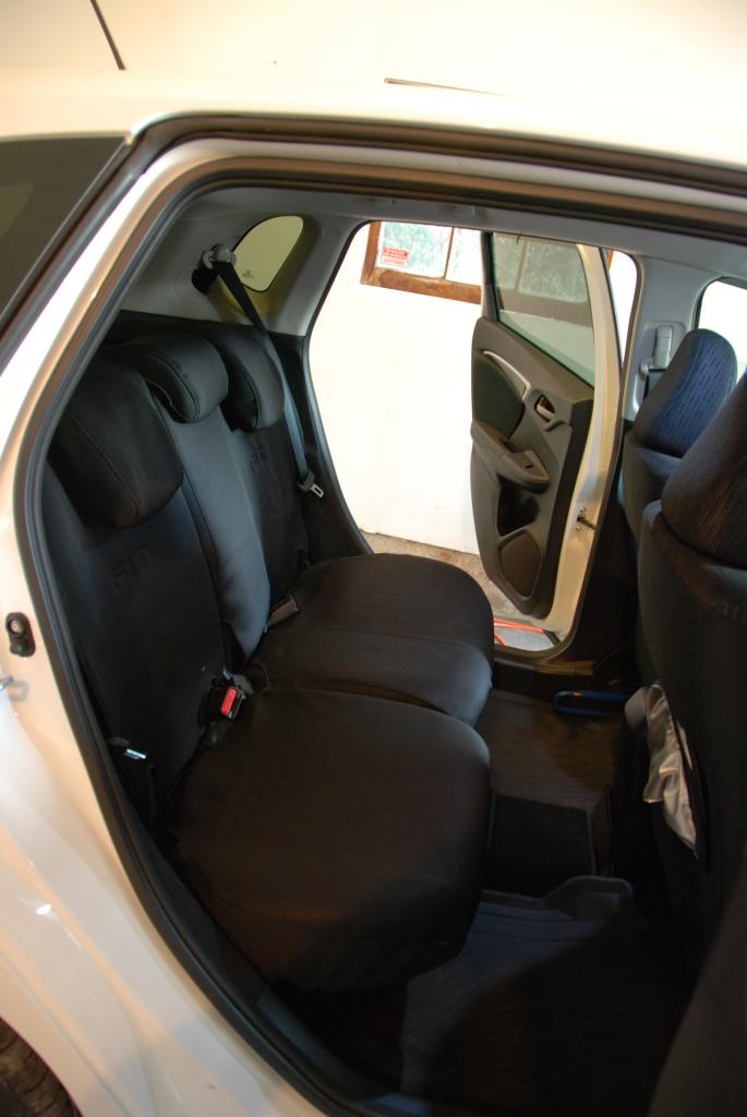

Continuing mod installs
Originally Posted by 15BlkPrl
This thread needs to be stickied at the top....
DONE!!!

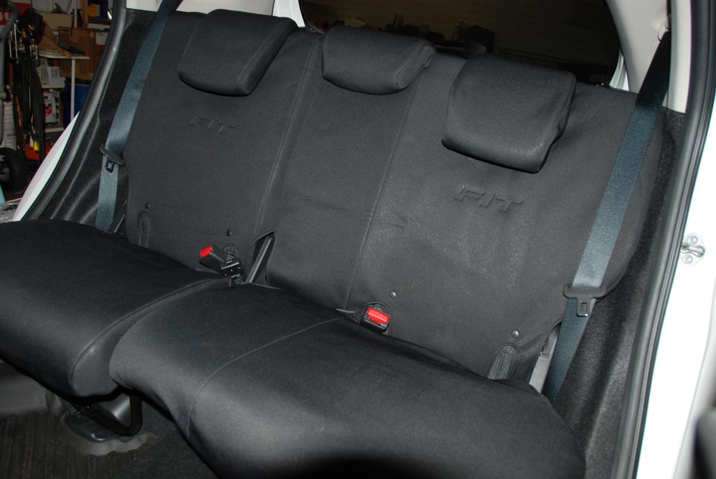

After doing errands had time to install the OEM rear seat covers. Actually came out pretty good. Its neoprene-type material and should suit my doggie well.
Honda should make them for the front seats too!!!
