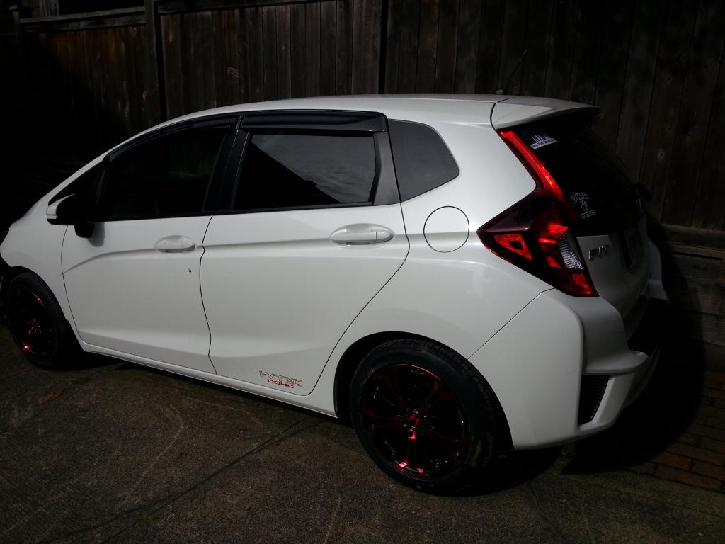

Tint installed

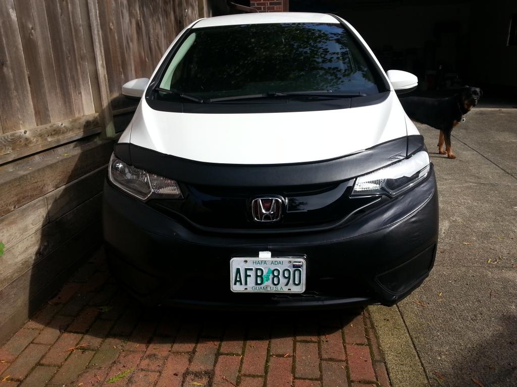

Yesterday was tinting day. Originally wanted Huper Optiks but when viewing the sample, was'nt too crazy about the silvery look from the outside. Decided on 15% Llumar CTX ceramic instead. Pretty pleased with the result. Here's hoping the local authorities don't give me grief!!!!
Size:  82.0 KBName:  2015HONDAFITOct22014Rearagain.jpg
Installed the OEM front Nose Mask.

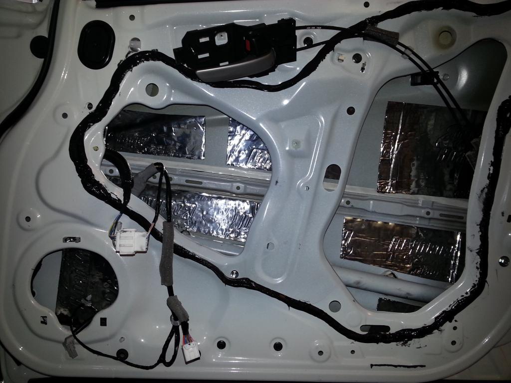

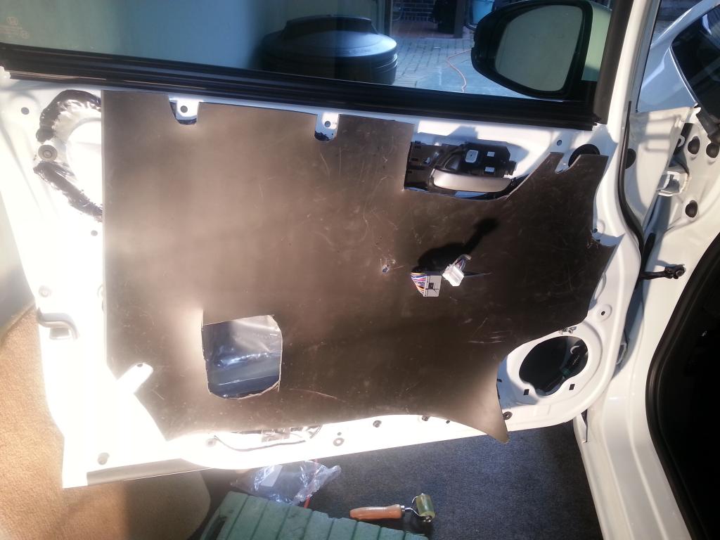

Started with the CLD tile install on the RF door. Sound deadening on the rest of the GK is gonna take another 5 days.
[IMG]http://<a href=http://s925.photobucket.com/user/kimberidpa/media/2015HONDAFITOct22014CLDTileinstallRFdoor.jpg.html target=_blank>Name:  2015HONDAFITOct22014CLDTileinstallRFdoor.jpg
Size:  100.2 KBName:  2015HONDAFITOct22014CLDTileinstallRFdoor.jpg

Looks good and thanks for the pictures. What's involved in removing the door panels? I have Dynamat waiting to go in there. Will you be weighing the sound deadener you install? I doubt that it will make a measurable difference in MPG, but it would be interesting to know.
Old Oct 5, 2014 | 04:03 PM
  #509
noripwr's Avatar
Joined: May 2014
Posts: 340
From: Los Angeles, CA
Silver , each door's window control has a little rectangular notch in the front against the panel that you can put a flathead in and pry up to release. You then take out a screw from the door release and a screw under each window control.
For the front doors just pry the plastic covering off once u got the two screws off.
For the rear, u also have to remove the triangular plastic covering against the edge of the window before you start prying the door panels off.

Please go to Sheepnutz's thread on this knob. He sourced it from Ebay!!!
.....What's involved in removing the door panels? I have Dynamat waiting to go in there.....weighing the sound deadener...... I doubt that it will make a measurable difference in MPG.......
REmoving the panels is much like the GE. Watch YouTube and you'll figure it out.
- Pop up the plastic panel where the power window switch is located. Unhook wire. Remove screw.
- Remove second screw behind door handle (exposed)
- pry the bottom with some plastic tool. Once you get a grip, give it a firm pull for the bottom, then work on the sides to the upper portion. Trim will come off. Door handle stays on the vehicle.
Have got roughly 70 sq. ft. of CLD, CCF and MLV. Installed they will add 150 lbs.+ Add the stereo components and am looking at 200 lbs. easily. Am expecting to lose 2-3 mpg. but only time will tell. For sure to make a comparison once all is done (another 2 weeks???)

Susan, many schools of thought on this issue. Have read all about them and decided to follow the suggestions on this link:
Doors | Sound Deadener Showdown
REad it and you'll understand why most audio people use CLD tiles to augment the factory installed "sorry" sound-deadening. Hope this helps. CLD tiles has to be used in conjunction with other material to provide truth sound insulation.

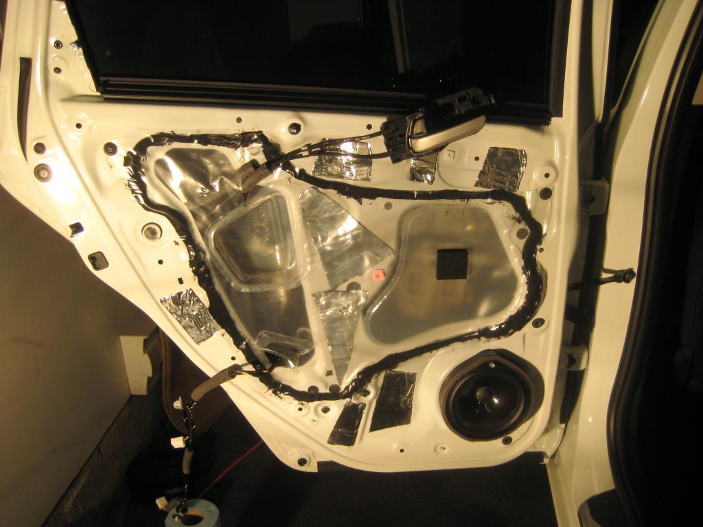

Here's an update on installs done yesterday and early this am:

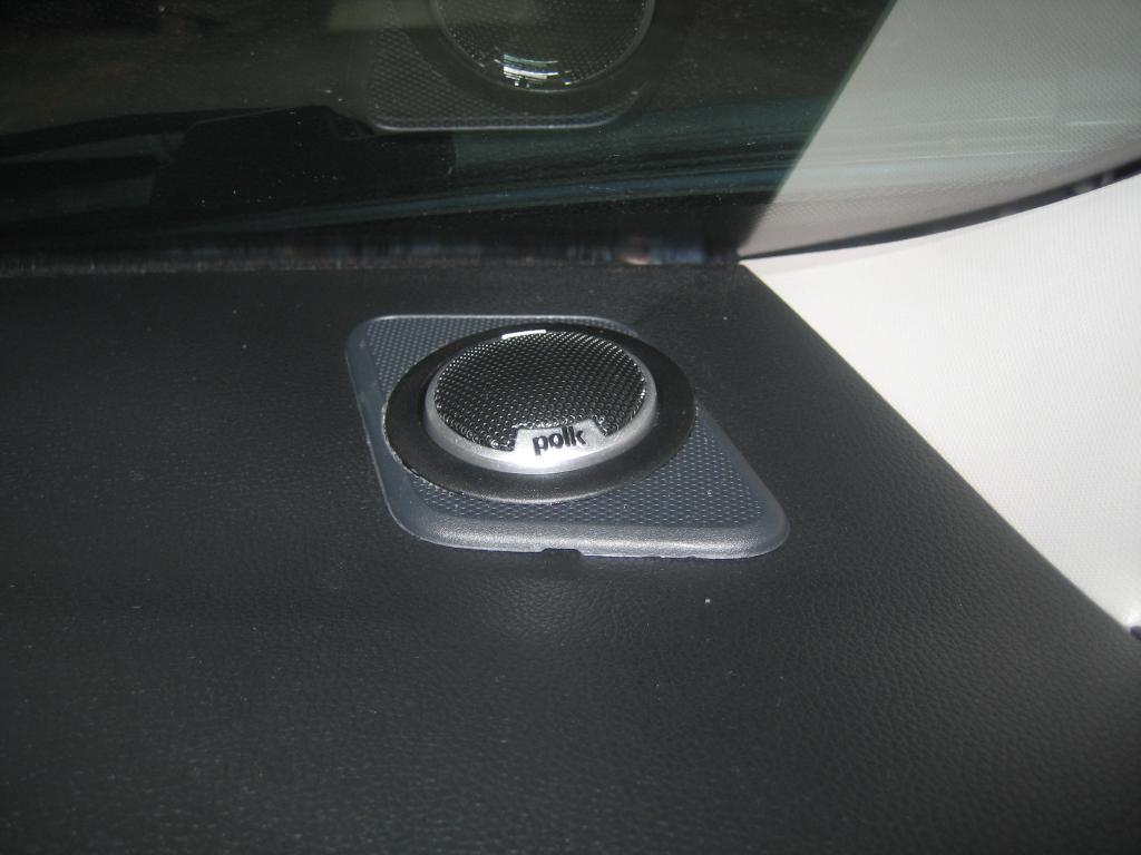

- As part of the stereo upgrade, installed tweeters using the OEM grills. Being an LX these are no factory tweeters. Polk's are too big so I drilled a hole in the grill center and used the Polk supplied tweeter cup. Pretty pleased with the result.

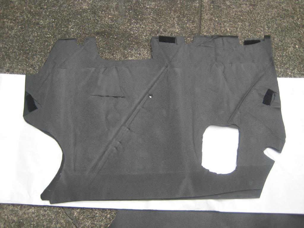

- Cut out MLV and CCF. Bonded them together and installed on the two front doors. The door closes and sounds like a vault. It now has a solid "thud".
- Installed CLD on the left rear door.

Here's a pic of the MLV cut and installed on the driver's door. Used industrial velcro to facilitate any removal.
The clear plastic is an original factory install part stuck on by butyl-adhesive (black stuff). Touching that makes a mess so one has to be carefull if it is to be re-used. Decided to re-use as the white stuff in the center is the factory sound absorption material. Didn't want to throw it away.
Let us know what you decide to do and we're all gonna help each other along the way. Closing my front doors now, are like closing doors on an MB S-class. Soooooo solid. Once I finish up the whole car will post my overall assessment.
