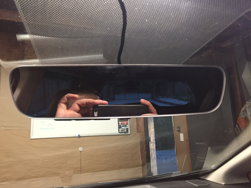

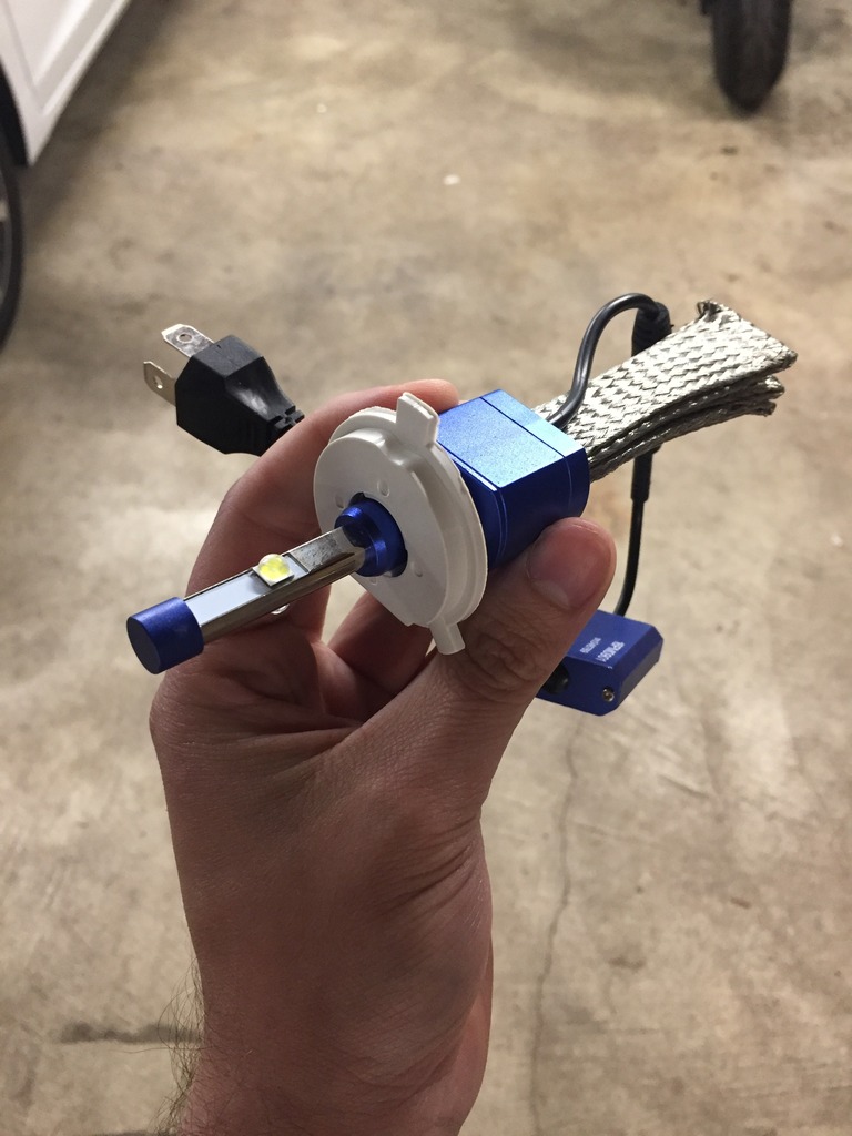

Recently bought my GK Fit, and started modding it out. Replaced all interior LEDs with Superbrightled bulbs, replaced the headlight lights with LEDs, replaced the turn signals with Triton V3s from VLEDs.
Did a detail with an application of Optimum Gloss Coat, added door edge film, the cargo cover, weathertech floormats. Also installed an auto dimming mirror with homelink, I missed that from my Acura TL. Next on the list is splashguards.
Future plans include LED foglights and possibily the Progress rear sway bar. Can you tell I like LEDs? :P

Nice!!! I'm getting a new mirror as well. Where did you tap the 12volt connection? Are the LED headlights hard to replace? Where can I find them?

Mine was homelink and dimming, so I had to do an ignition source and battery source. Ignition was using the accessory fuse location, battery was using an empty spot in the fusebox. If you're just doing dimming then its only going to be one wire (plus ground).
LED headlights are easy to do. The ones I got, I found on Amazon. Search for Amak H4 LED.

I love LEDs - have them in my house, too. What did you use for LED headlights? Any problems?

Thanks. I found the Amak H4 LEDs on Amazon. How do they work out as DRLs? Very bright?

No problems with DRL, they dim when on the DRL setting. Obviously still bright, but I don't think it's too bright.

I too recently switched to LED headlights but after a week they started to flicker. It was due to the DRL's. DRL's run on 6-8 volts whereas the LED's require at least 9 volts to run properly. It wasn't noticeable at first but my dash cam caught it and looked as if they were in a strobe mode. I closely checked my LED's headlights while in DRL mode and sure enough they were flickering.
As suggested by the retailer to remove the DRL fuse I did and all is well now. I use my fog lights as my DRL's now.
