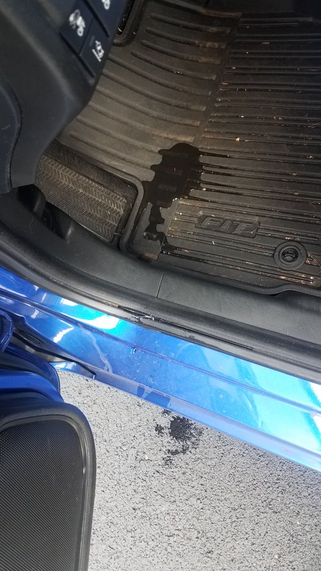

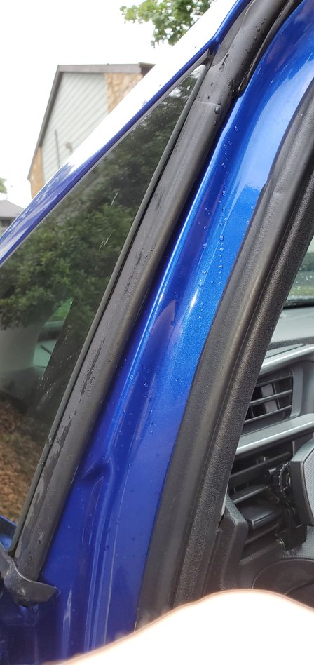

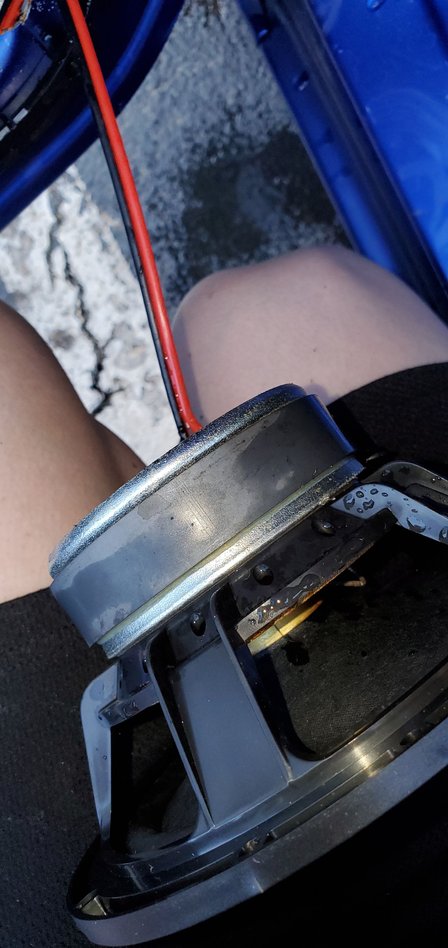

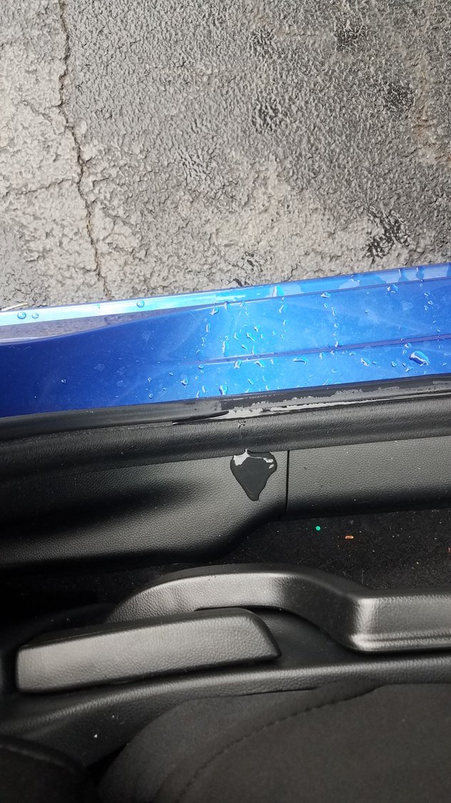

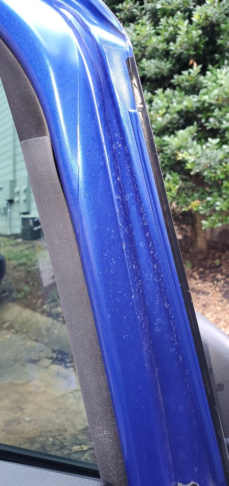

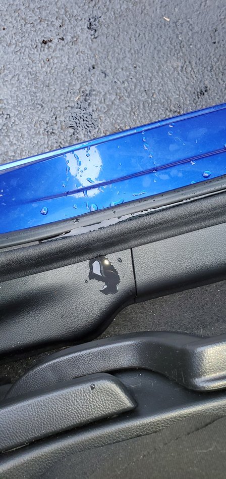

2018 EX, I've had since Dec 2017, have 22k miles on it. And only about a month and a half ago, started seeing this issue. Not a single drop inside before that....
It also coincides with a stereo install and window tint done by professionals (although the stereo install is questionable....but that's another story for another day...)
I'm wondering if something wasn't put back the right way by the installers, or maybe its the sun roof? Anyone with any updated ideas before I start tearing my car apart (of course it's storming hard here now...)

The water on your driver side sill looked exactly where mine was coming into. If it is, take your hand and pull on the door skin just under where the speaker would be and if you have water coming out then it's more than likely coming in through the soeaker. Specifically the mounting ring Honda uses. That ring is just two tabs and a screw. An improper installation or lack of seal beween the ring and the sheetmetal will cause it to drip. The Dealers fix for me was to use a bunch of black sealant for the ring.
The passenger side sill looks like the water is coming by the seat adjustment handle. That would more than likely mean that the plastic weather sheeting is leaking. The Dealers fix for that was to, again, add more of that gooey sealant around the sheet.
As for the rest of the pictures .. the seals around the upper and aides of the door will normally be wet (carwash will prove that).
Good luck!

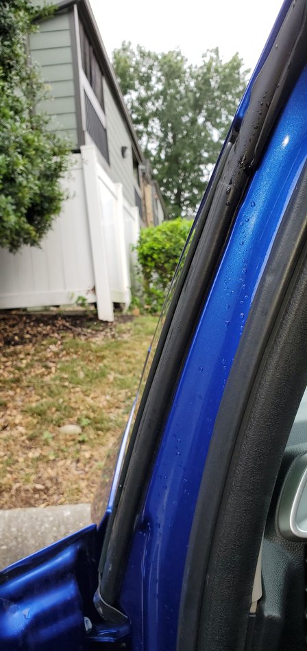

This is all just on the driver's side. Don't have this problem on any of the other doors. I will have to try your suggestions when it stops raining.
I think the water is coming in near the top of the corner window, as you can kind of see where the drips start in the very bottom picture. And I think it is trailing down the door frame, and collecting on the bottom sill, to form what is seen on the sill pictures. It pools in different places in the sill based on how my car is parked(incline/decline/etc), and if it's bad enough, overflows and get the carpet wet

Water will collect through the window as designed. Water gets in and drips to the bottom of the door and runs off into the appropriate drainage hole. The plastic sheeting is also supposed to help keep the water from coming in, but it's really a design issue.
I'm no engineer, but it looks like they expanded interior space by pushing the the door outward and in doing so caused what should have been a normal drainage path to now drip on speakers and inner door sheetmetal. After a hard or continous rain, the plastic sheet can only so much before failing in it's seals and dripping into the interior. The same could be said for improper sealing of the speakers.
When mine leaked in noticed it only happened when my car was parked on an uneven level street - curbside where it causes the driver side to be slightly higher than the passenger side. More rain collected into the door and that's why only the drivers side was affected.

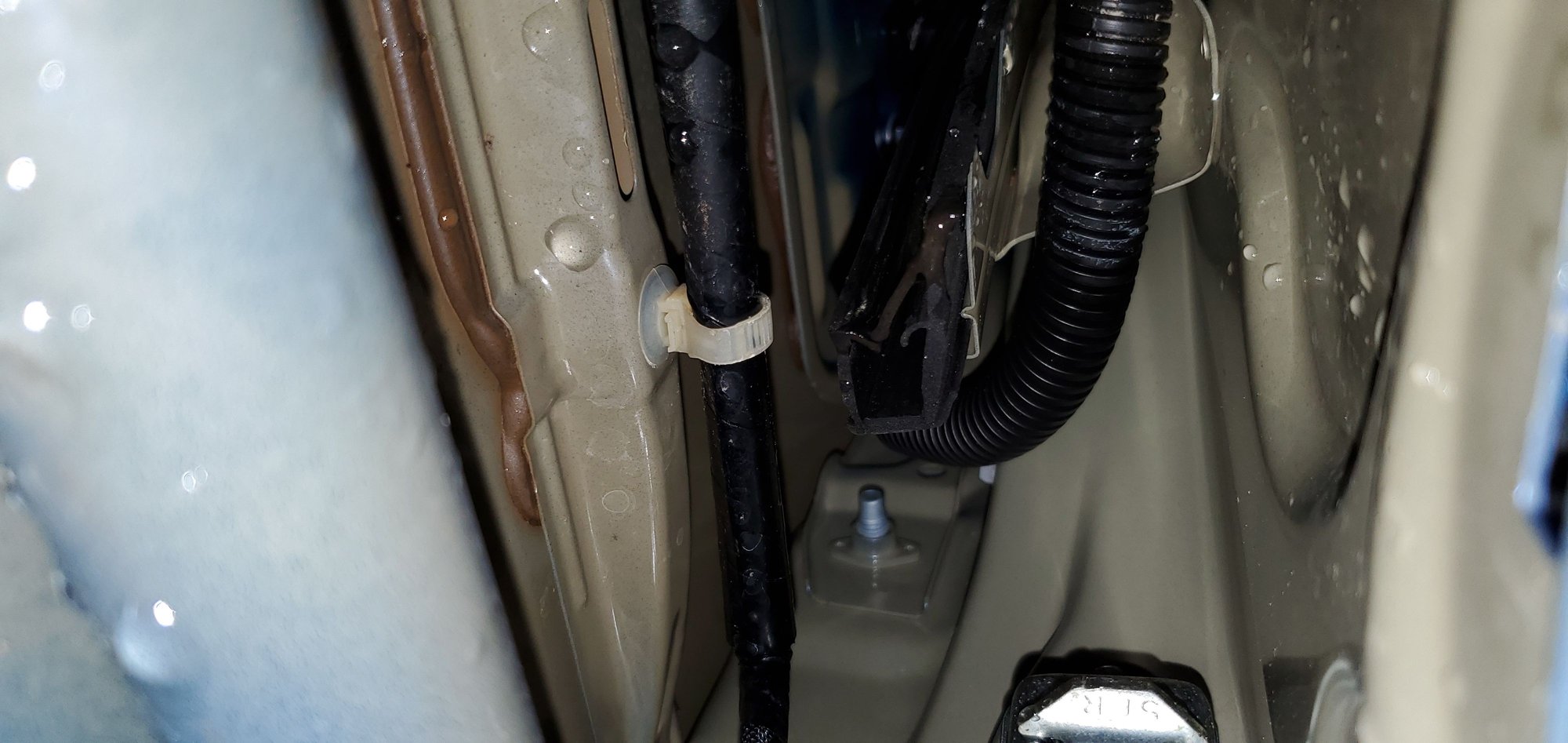

Did some more investigating. And it looks like the leak is coming in on all 4 doors. I tore the drivers door apart, and it looks like it's coming in through the window guide channel.
This only started happening after my windows were tinted, I wonder if anyone else has associated this issue with window tinting.
It was also a couple weeks after a stereo install, which could be why it's leaking from the speaker area. But the initial problem is the water getting into the door frame in the first place.
I also checked the sunroof drain and that seems to be working fine
