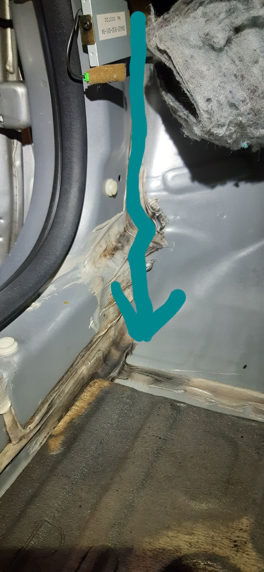

Front seats carpet footwell water leak
G'day fellas.
Here an owner of Honda Airwave 2005 that I bought in 2015 as import from Japan.
I had a rain water leak to the front passenger footwell, that I discovered a week ago.
I expected it to be the door weather sheet sealant being the trouble maker, but it turned out it was the cracked and partially missing seam sealer (obviously after sealing the door weather sheat and spending hours hosing different parts of the car - I recommend using a duck tape to secure the hose to the car and coming back after 10 minutes to check the effect)
Have a look at the photos that show my problem and my solution.
Water leak route.
Issue location.
Cracked seam sealant and missing sealing. The leakage was caused not by the crack but by the missing bits of black sealant.
Got it cleaned, primed and sealed with a window RTV sealant.

Rain water leak to the front footwell
G'day fellas.
Water leak route.
Issue location.

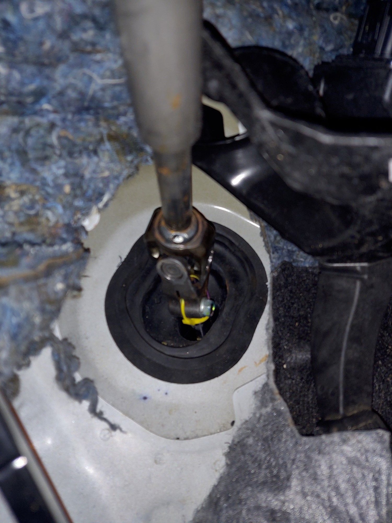

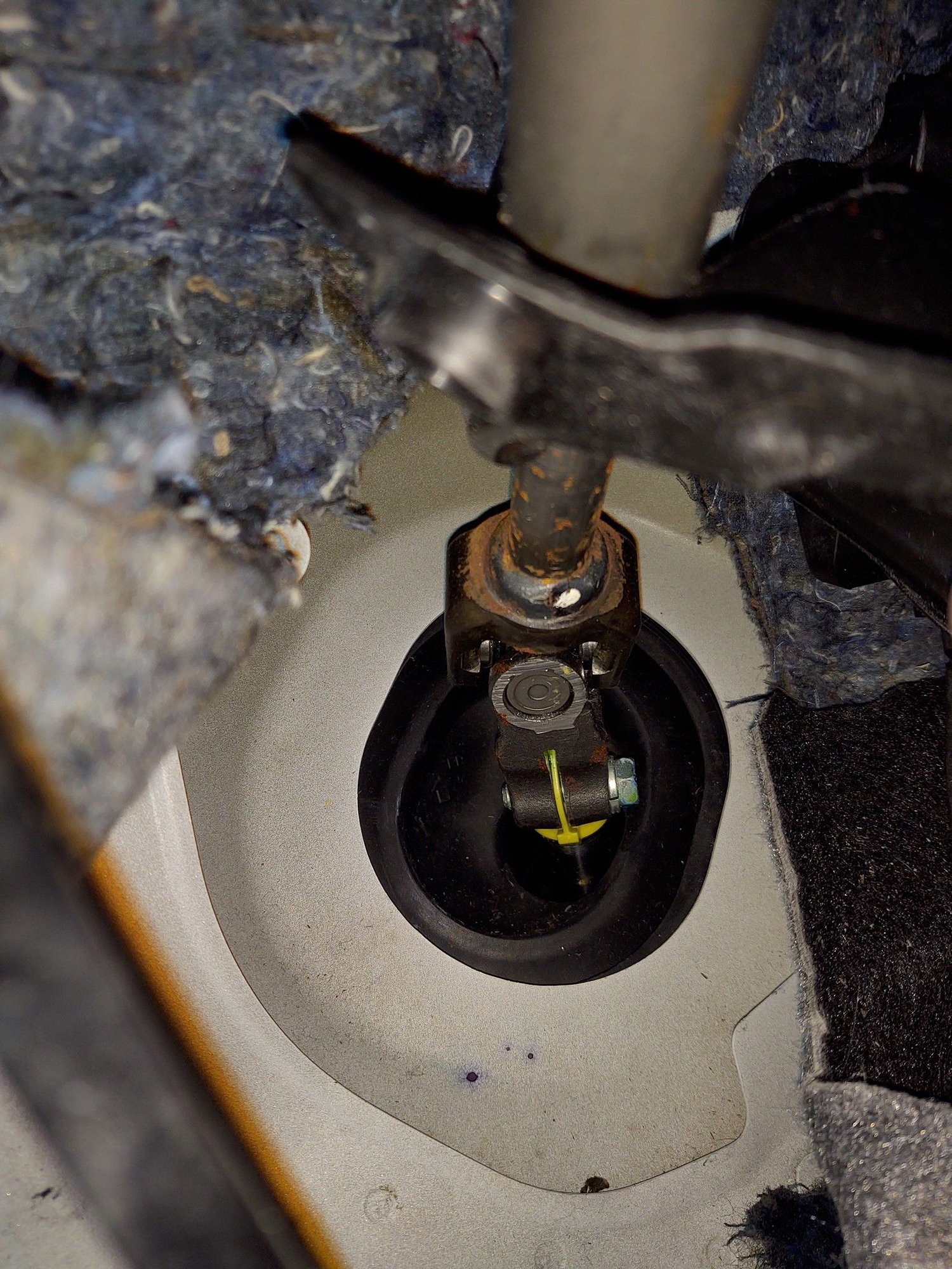

Since getting his license in August, my 17 year old son has been driving the Fit exclusively. Lately he had been complaining about excessive moisture on the inside of the windows. I finally took a closer look at the car tonight and discovered the drivers carpet was soaked. After digging a little bit deeper under the carpet I found this:
In this pic you can see that the big rubber grommet around the steering linkage is not seated around the hole in the firewall. It was pushed thru the hole.
I went ahead and pulled the lip of the grommet back thru and reseated it around the hole. Tomorrow I will put the car on ramps and check the other side to make sure all is well, and to look for a reason this grommet became unseated.

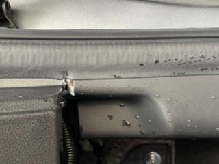

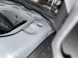

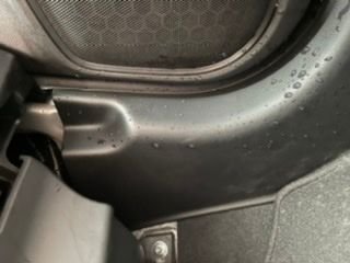

2016 Fit EX Front Passenger side leak
First of all, thanks to everyone so far on this thread for all the advice...great helpful tips.
I've been having what seems to be a common issue with my 2016 Honda Fit EX where water is somehow leaking in to the passenger footwell area and flooding the carpet. It only happens in a heavy rain, which doesn't happen often in Southern California so it's been hard to troubleshoot.
1) It doesn't seem to be related to AC drainage, because it is never wet in the summer when running the AC full blast and there is no rain.
2) I've already checked the vapor seal inside the door and fixed a couple spots where the butyl was not quite sealed completely.
3) I did a water test and the windshield, moonroof, and side gaskets seem to all be draining properly.
4) The side view mirror was replaced after getting hit by another car driving by, but I haven't noticed any leaks from the area.
In the last heavy rain I finally caught video of the water dripping in! But it was from an unusual place which no one else has mentioned in their posts.
You can see from the photos and especially the video that it is behind the plastic trim between the glove compartment and the metal body. It's dropping down from above, and there is a tiny bit of rust residue on the metal frame components above the area. Any idea how water could be getting in here? After the rain, I already dumped a bunch of water into the moonroof drainage hole and it came straight out the bottom of the wheel well.
Any help to solve this mystery would be greatly appreciated!

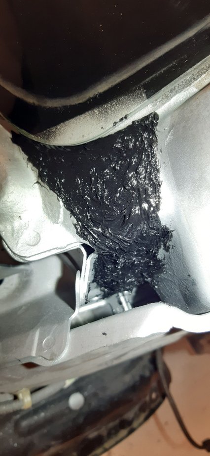

I have read all the reply’s on the vapor barrier water leaks. My leak was water running off bottom edge of window glass especially when parked at curb with drivers side higher than passenger side.
Eventual fix was installing “shower curtain” like pieces of plastic across the width of the 2 metal access openings behind the vapor barrier duct taping at the top directly to the metal inside of the 2 door openings blindly and extending the curtains 2 inches below the openings, so curtains are 18 or more inches top to bottom. The dealer would have never have resolved this. This prevents the water normally running off the bottom edge of glass to get thru those openings, no matter how tilted my car is at the curb.
Resealing the black goo didn’t help me.
The problem is the relation of the door glass bottom with the recessed access holes “catching” the water, especially with car parked right side lower than left side, ie curbside in rain storm.
My car is a 2017 lx Japan made car, no sunroof.
Problem goes back at least to GE models. I have another 2017 fit Mexican assembled that doesn’t leak, yet, in similar conditions.
