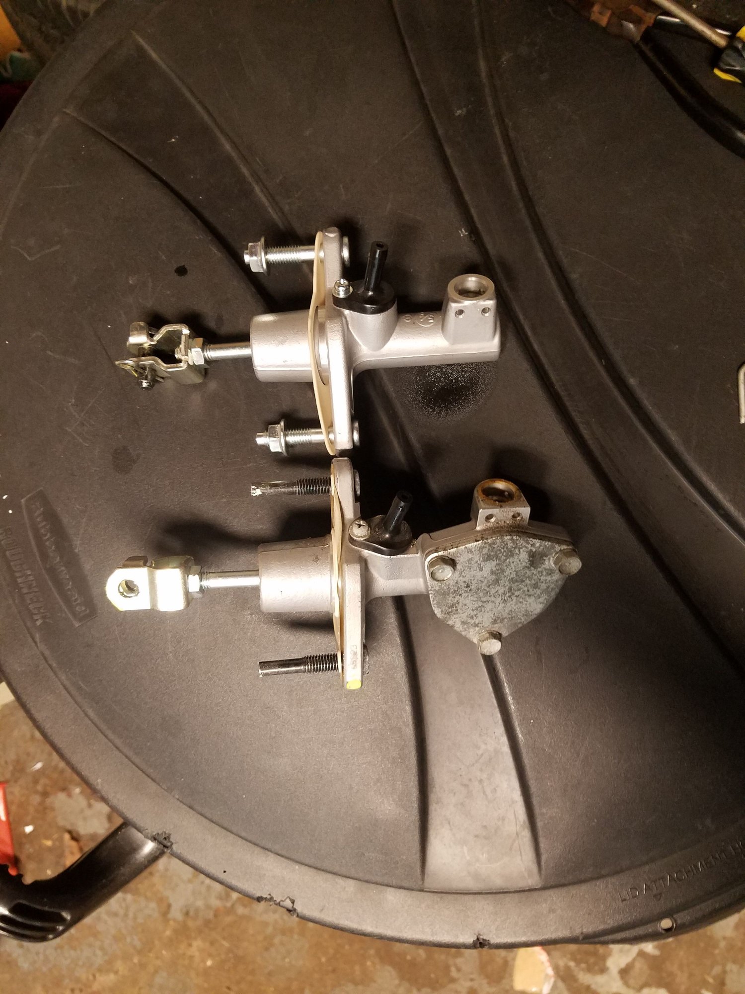

its possible to delete the clutch delay valve, but appears to be alot of work involved:
https://www.fitfreak.net/forums/3rd-...ml#post1420531
Originally Posted by CodemanGK5
Completed the CDV delete on my GK5 the other day. Required only minor modification: slightly widening stud holes and spacing back the mounting nuts with a couple washers. All in all a success and a very worthwhile mod if you like to drive your gk hard. I used an OEM Honda (Nissin) clutch master cylinder and swapped the connector fitting from gk5 to em2 cmc. Hope this helps anyone else interested in this swap.
The two stud holes here need to be filed out just a couple mm wider for the studs to pass through.
GK5 (bottom) EM2 (top)
OEM EM2 cmc installed in my 2017 GK
Closer up
EM2 cmc with GK fitting and line connected
EM2 (left) GK (right) studs are a little different, a couple washers on each one took up the space and its nice and tight.
