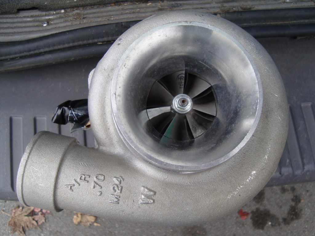

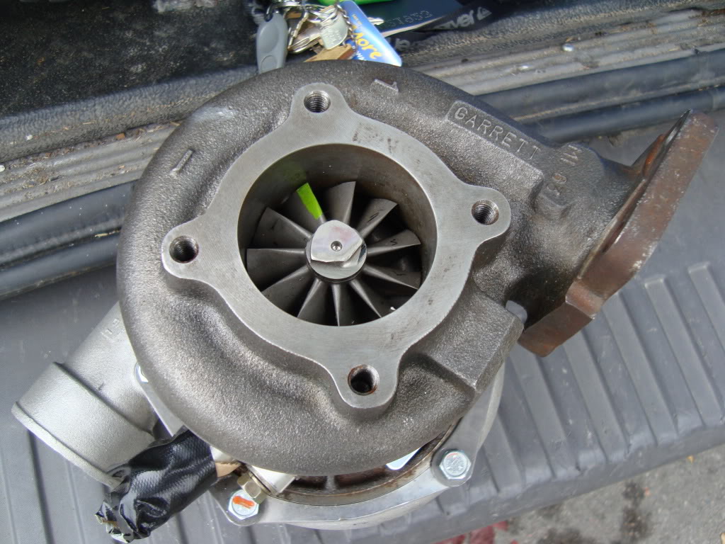

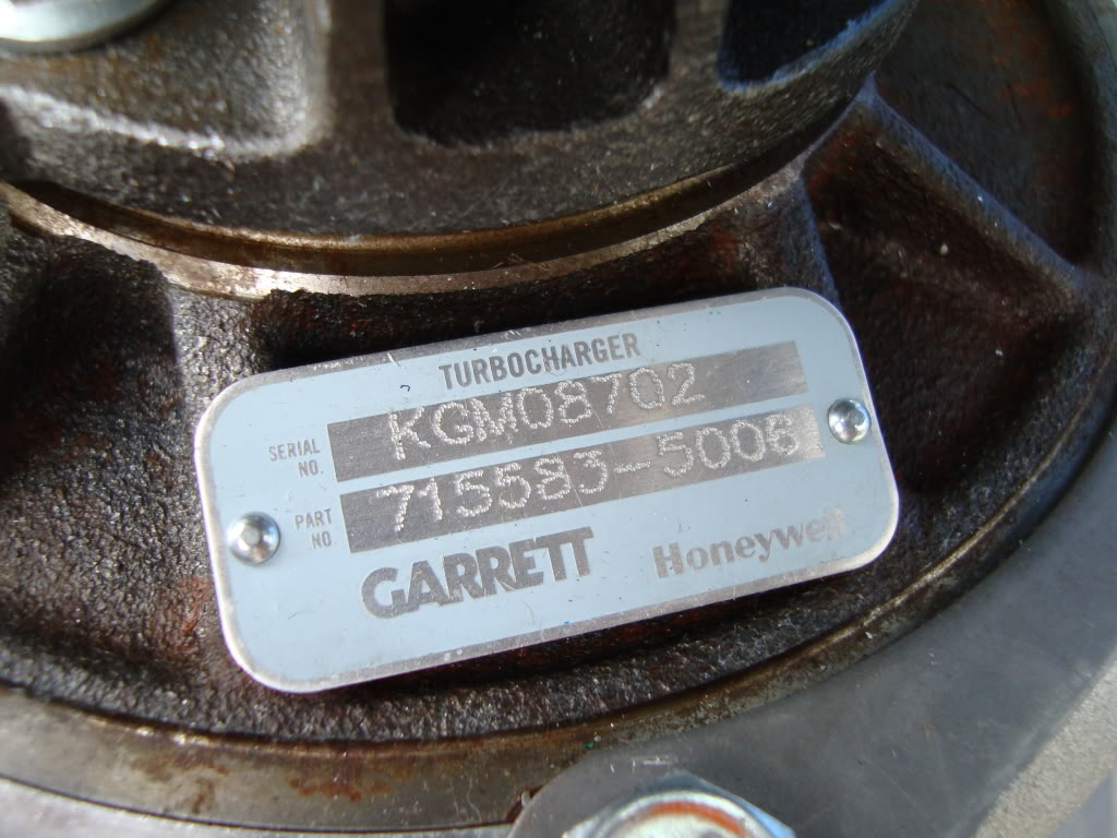

detail of the turbo
Garrett T3 60-1 with .63AR (715583-5006)
Compressor Specs:
- T04S
- Housing flow: 61 lbs/min 781cfm
- .70 A/R housing
- 60 TRIM wheel
Turbine Specs
- T3
- .63 A/R housing
- High Flow 76 Trim Stage3 wheel
- Oil Lubricated Center Section.
- 360 Degree Thrust Bearing
- For external wastegate
- Can support up to 575WHP

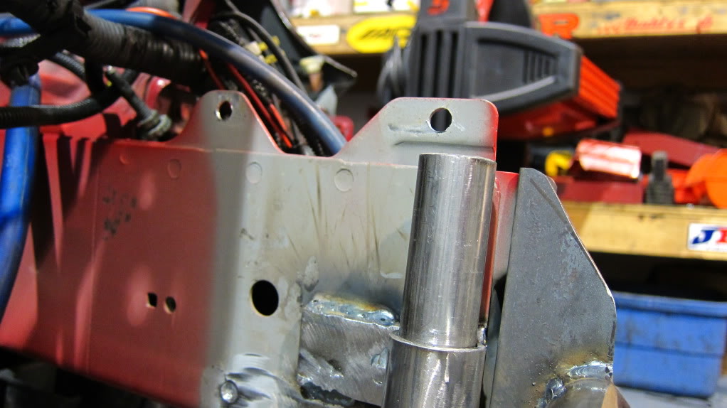

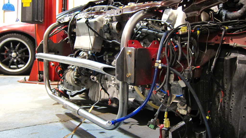

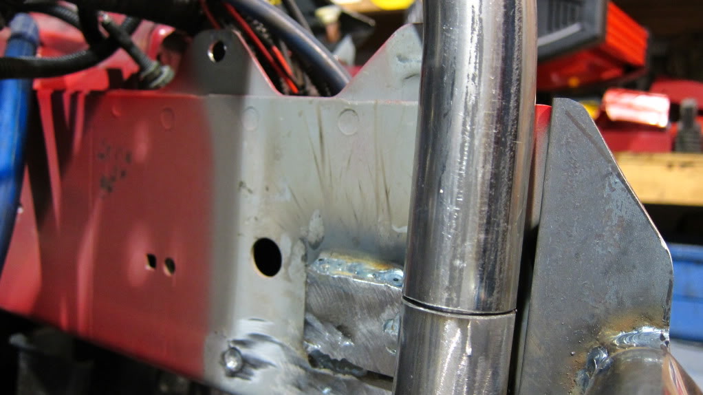

the big plan for the easy removable rad support
there will also be jacking point !
top part of the rad support can be removable to make life easier when servicing the car or removing engine !

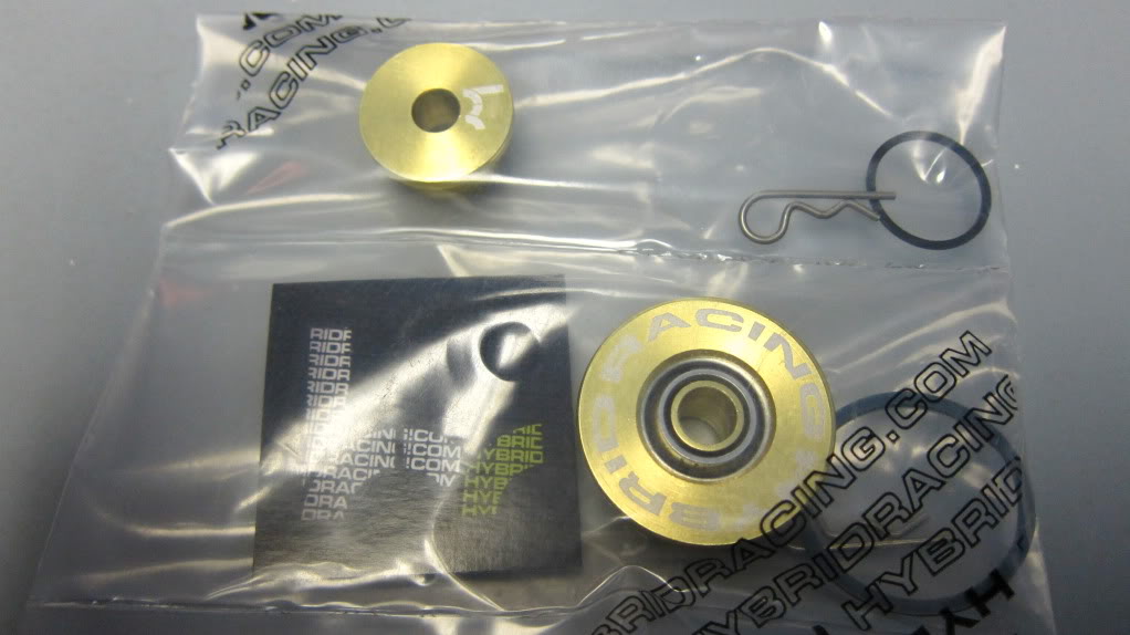

more parts from hybrid-racing, top K20 parts manufacture in USA ...n Thx Tim !!
K20 Shifter Bushing

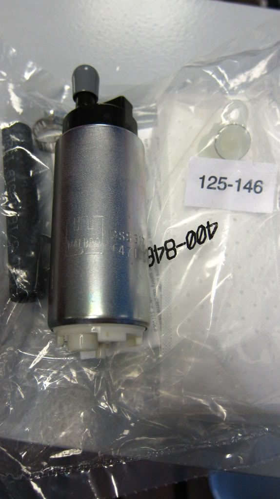

Walbro 255 pump

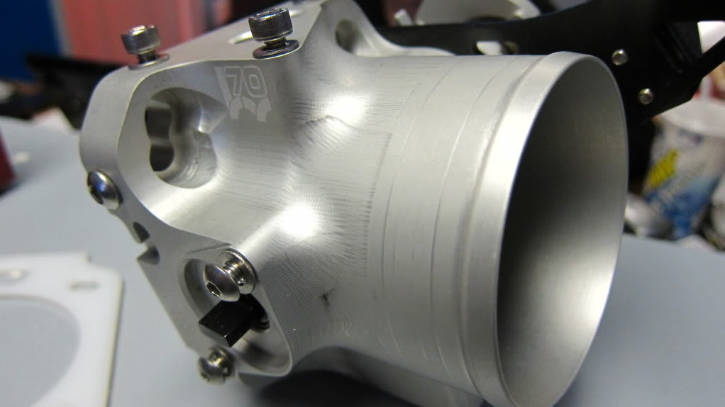

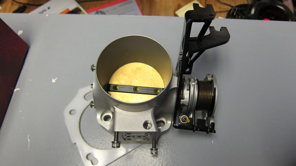

Hybrid-racing 70mm throttle body with cruise control !!

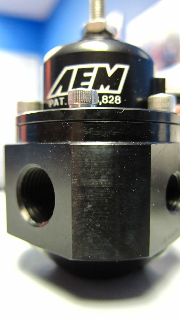

AEM FPR

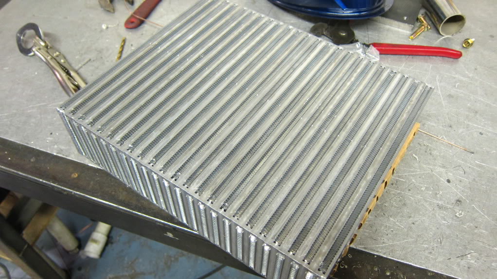

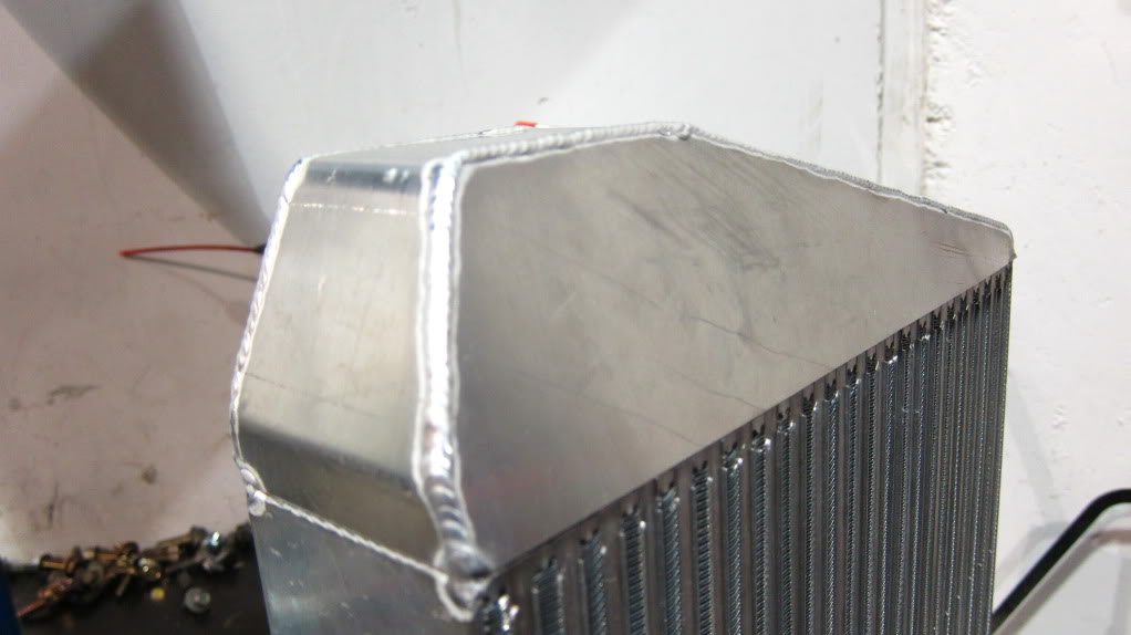

then my intercooler core from Garrett
one side of the custom end tank
