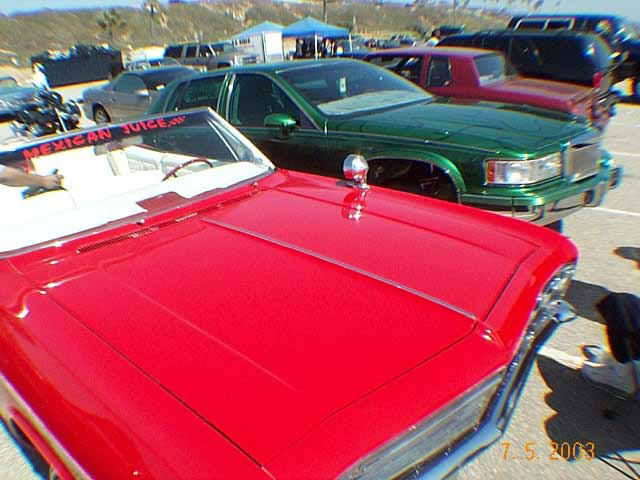

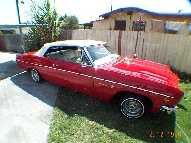

eh not sure if i've posted but here it goes. This is the same process I use to do to my Lowrider paint jobs. The last time I showed a car in a car show was a 65 rag impala and it won 1st place in the paint class.
1st. wash the wheels then the car
2nd. dry with a microfiber towel or chamois shammy
3rd. clay bar the entire car, use some water when using the clay bar of course.
4th. wash the car once again when done and dry.
5th. the car will look scratched when done due to the clay bar taking off all the contaminents, paint will look not so bright.
6th. I use the meguiars three step, very easy to use, the less you smear on it, the better. Once again, microfiber applicator pads and clean microfiber towels to remove the wax.
7th. when done, I usually do not wash the car afterwords, if you want to you can, but its not a must. Your hand or finger will glide through the damn car when you're done. Here is a pic of the car I won 1st place with.
not the best pic of it... but will do.
