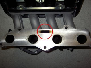

you know our stock manifold has a baffle in it so each of the cylinder will breath the same amount of air, im thinking that with the weapon-r cylinder 1 might get less air than cylinder 4 and cause to lean out

From: plantation,florida
Size:  15.1 KBheres someone elses but mine was worse, dont mind the red ring its not my pic
if this were the case the all the other performance intake mani's would do the same, which they dont. The problem with the weapon r is they probably did no research into the correct runner length or plenum volume to make any kind of power.
