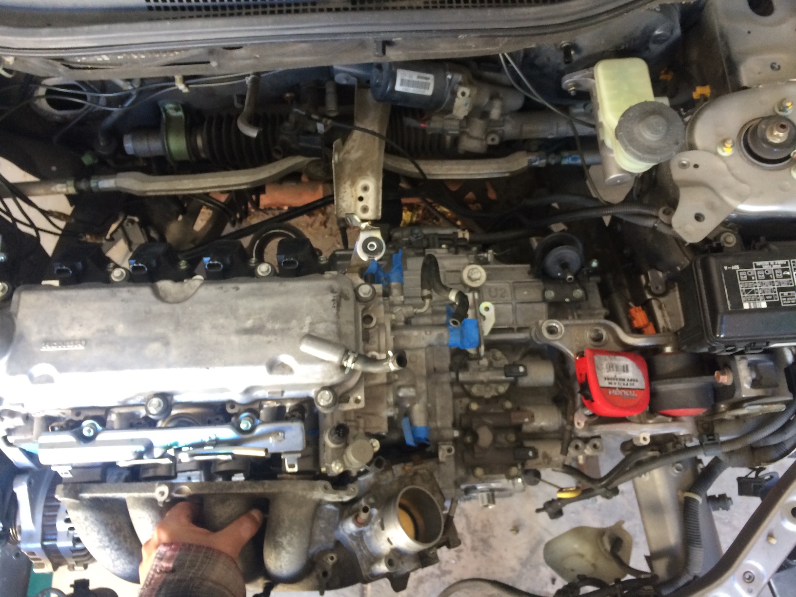

Did you bypass the stock AT cooler or do you use both? Did you have Flashpro? Im getting rid of EGR simply because is doesn't fit and hondata lets you delete it.
Here is where my head has been, k24 manifold and TB all because the intake doesn't fit, will have to "lower" the oil cap too. I am getting the Garrett GT2554r and a 6psi wastegate, and air to water intercooler for a nice short intake track.
Attached Thumbnails Kraftwerks A/T @ 10psi?-img_6659.jpg
