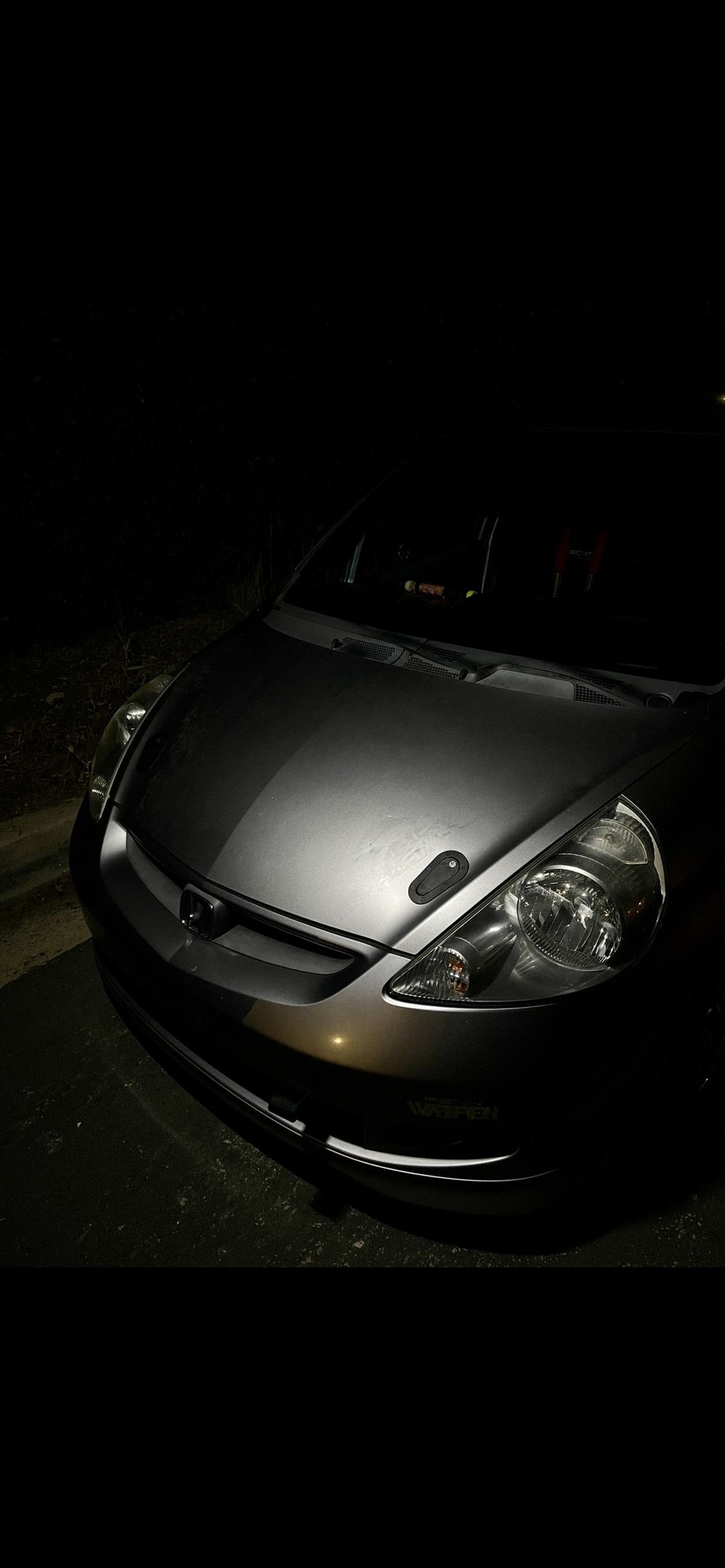

Forgot to share these here. I've partially finished installing AeroCatch hood latches on the Fit. The latches are installed—just need to install the hood pins/rods. The rubber bump stops for the hood alignment are kind of a super convenient place to install these. Just need to put them on and adjust fitment for smooth open/close operation. Other plans include gutting the hood skeleton once I install hood vents and installing my Hardrace rear beam bushings (this will likely be in a few months).

Small update—AeroCatch hood latches are completed. Clutch disc should be getting replaced this week.
